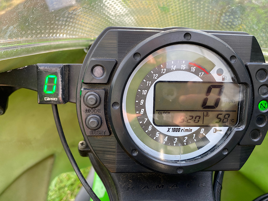

My next project for the kawasaki is to ditch the original clocks as they're terrible.
I have no idea if it'll run without them so that's the first stop I guess.
Then I need to work out how to get signals out for low oil, fuel, the engine light to leds if that's possible but the most important is a big easy to read tacho.
ETA, having watched some videos it transpires that I have no backlight which is why it's so difficult to read so I'll investigate that.

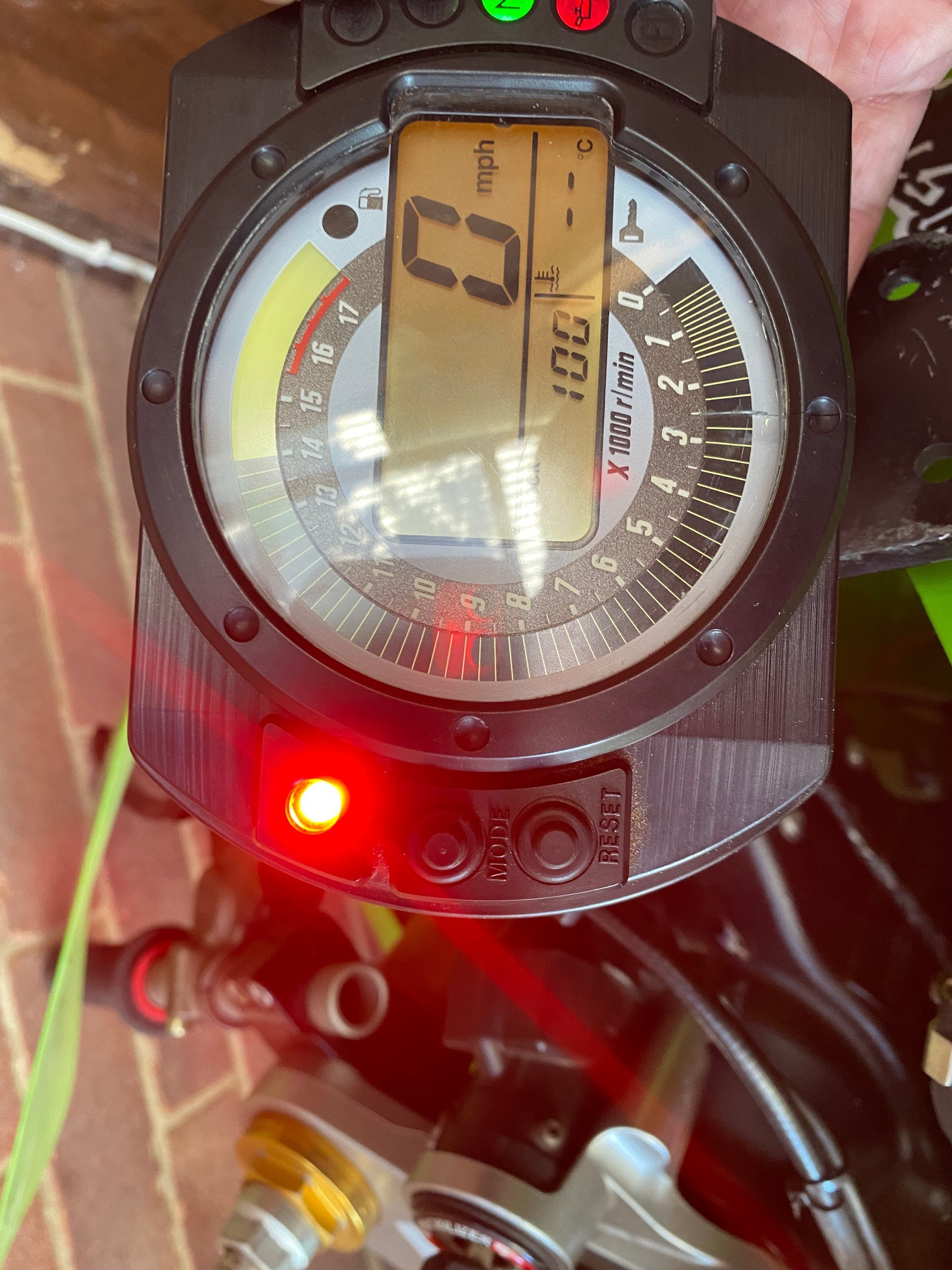

Took the dash apart last night and the backlight does work, it's just a very dim orange colour. I spoke to a guy selling upgrade kits on ebay and have order a set of surface mount LEDs in white which should increase the contrast. It was only 15 quid so cheaper than binning the whole lot and starting again. Will report on how that goes.
I also unplugged the whole dash and the bike kept running so I'm pretty sure that I can simply replace the whole lot with a new tacho and some idiot lights. The only one that would be problematic would be the temperature but putting in an inline sensor and gauge would be relatively trivial.

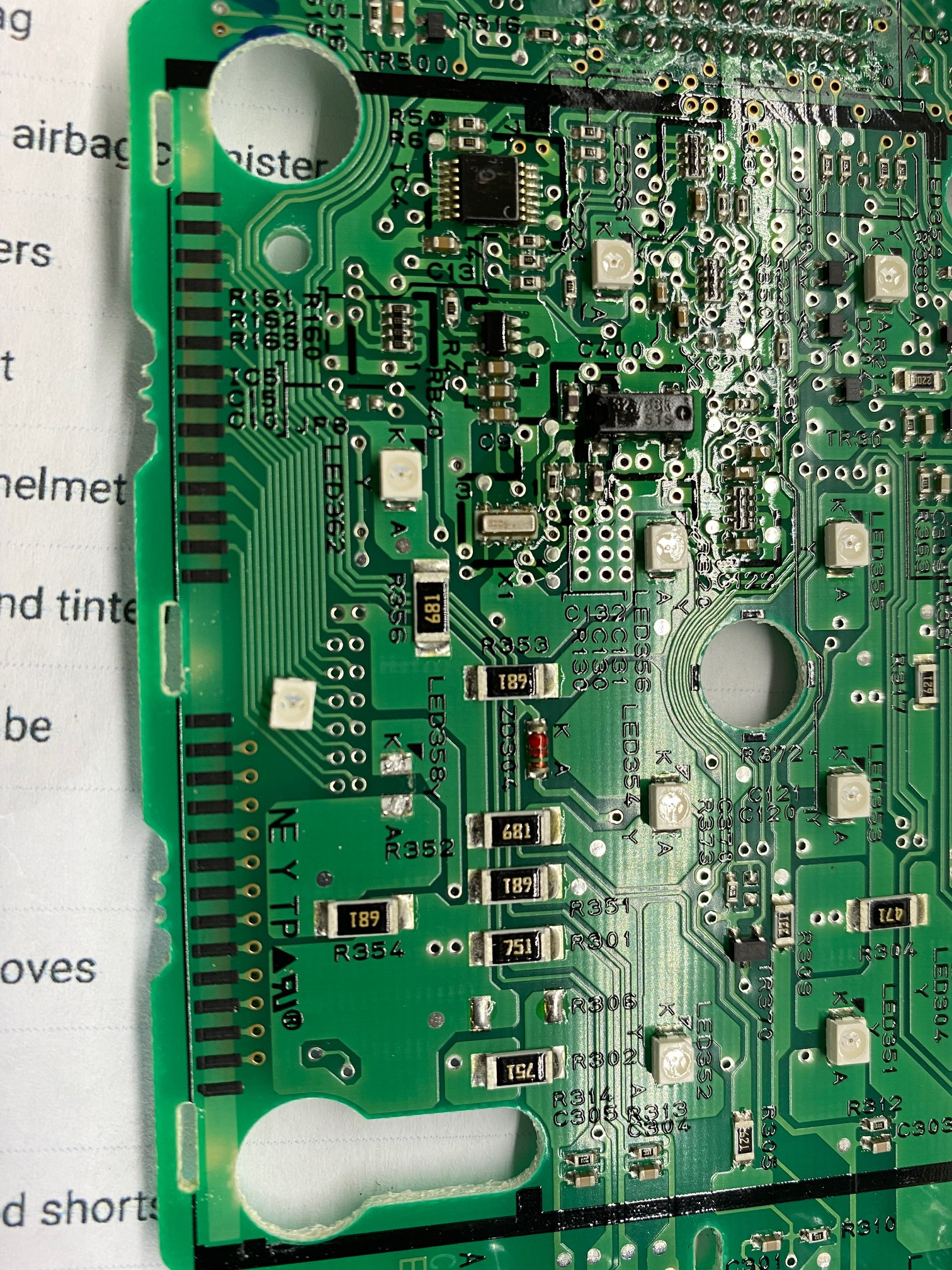

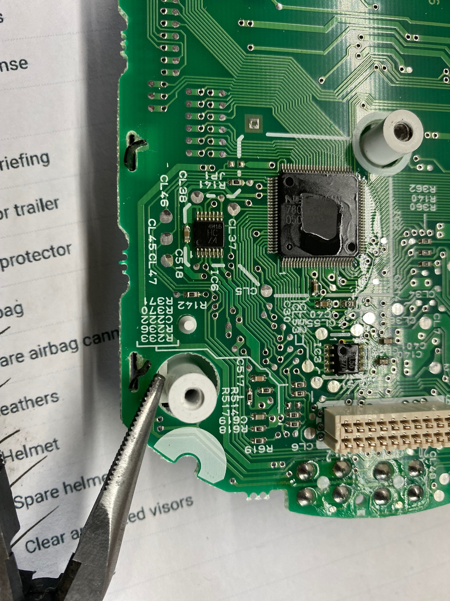

First step is to take the clocks off and take the case off (I don't know why some of these pictures are upside down)...
Then separate the two boards...
Then lever flat the little black tabs to remove the led box and remove the box. Be really careful with this, don't drop it or be tempted to take the plastic bit out to see what's in there, it'll stop working if you do. Place it face down on something soft out of the way.
The little white squares on the board are the surface mount leds. The ring around the outside and the two at the top illuminate the rev counter and the six in the middle the speedo...
You have to heat the solder on the pads under the leds from the ends of the led and prise the square away with either tweezers or small pliers. This shows the first one removed. Use a solder remover suction thing or braid to remove the solder from the pads or soldering the new leds in place will be much more difficult.

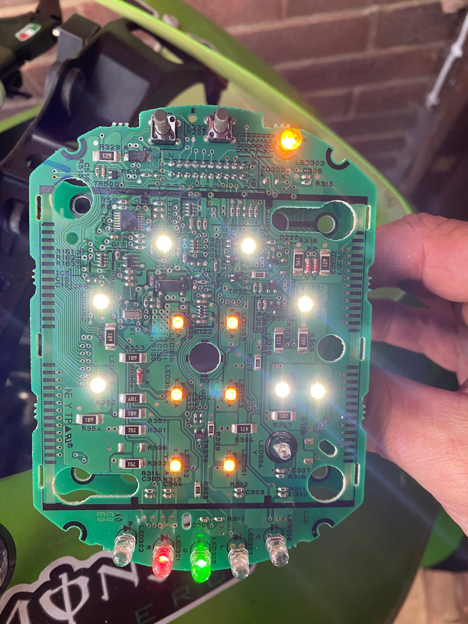

Place the led in place in the right orientation (you get instructions) and heat the pads sticking out from the led and apply solder. If you apply too much heat the led will melt and won't work. Here's the first one done and you can see how much brighter they are.

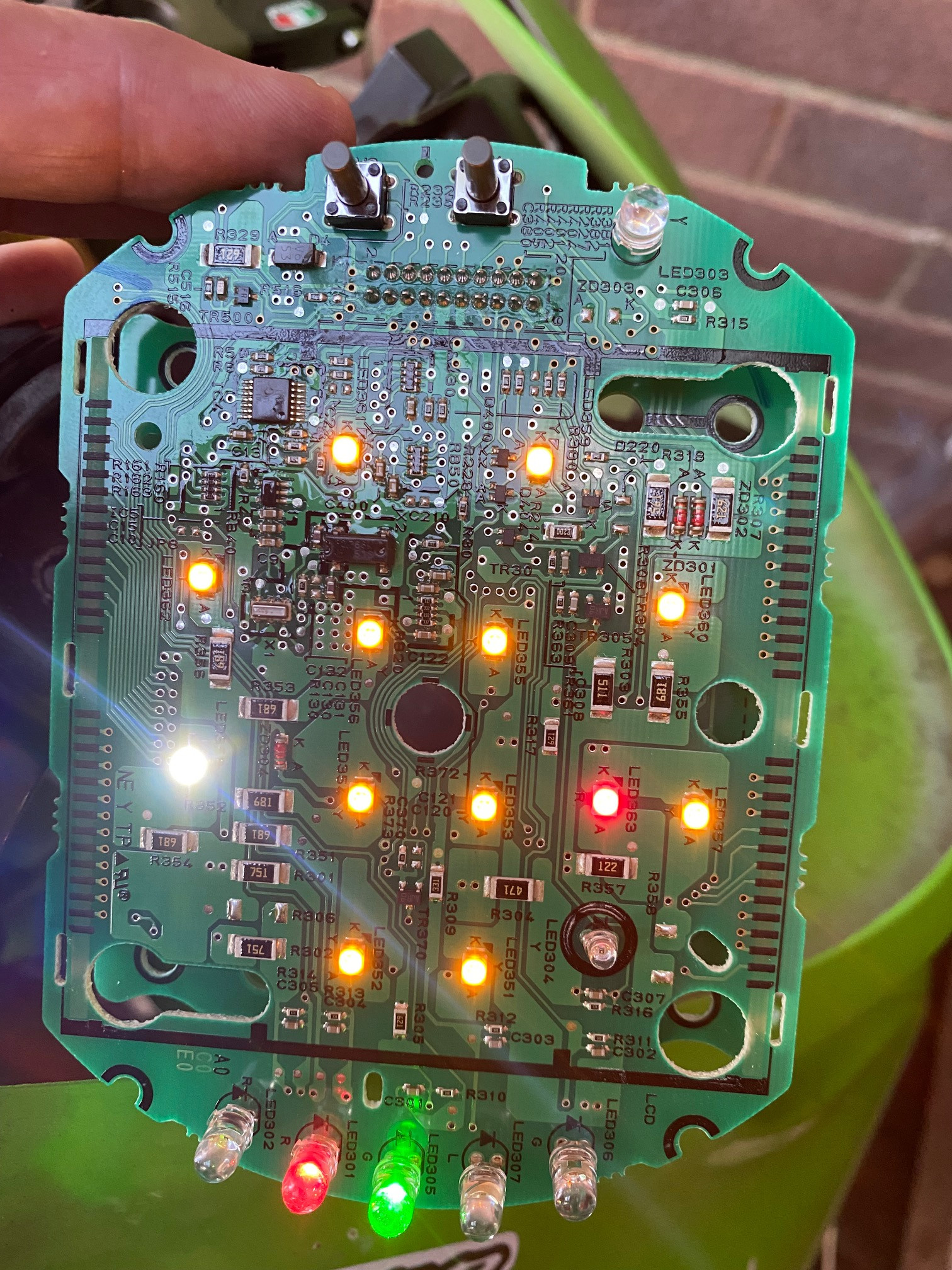

Here's all the rev counter ones done. I didn't bother doing the speedo ones as I stick tape over it anyway. The orange led at the top of the board is the shift light.
I then replaced the shift light led with a bright one the guy sent me when I asked his advice on making this brighter...

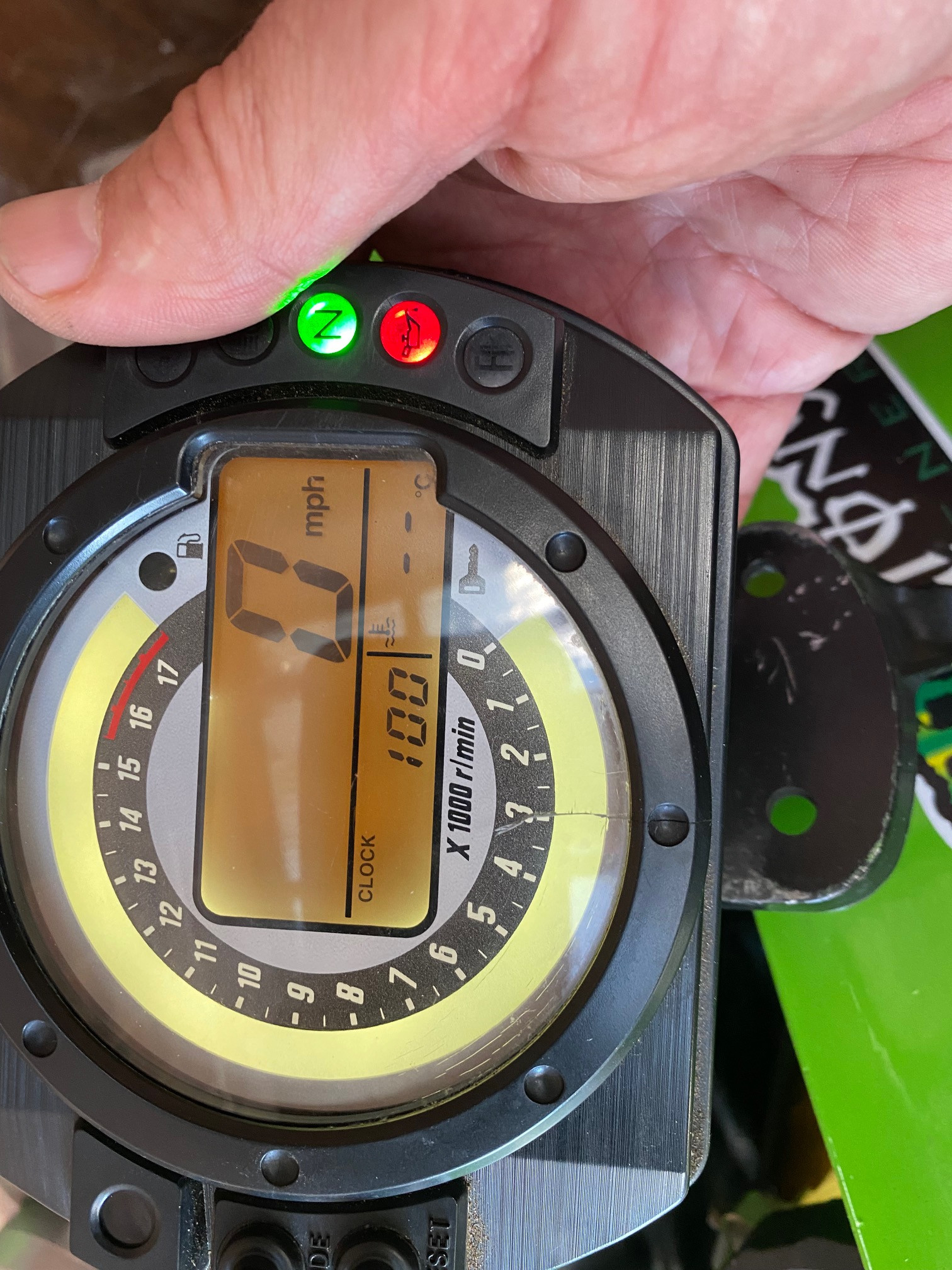

This is the rebuilt clocks with the brighter outside ring and the dimmer speedo. You'd replace them all for a road bike.
This shows the brighter shift led...
If you're going to do this job buy the kit from the ebay link I posted above. The advice I got and the instructions were superb.

No worries, you’re welcome. If you get the kit from the same guy I did then ask him if he’ll supply you with the same Red shift led as he sent me. Let him know that it was the larger of the two he sent me. My id on eBay is dernian so you can let him know what you’re talking about.

Lead low temperature solder and a fine tip iron running at a high a temperature as it would go, about 400 I think. I wanted to flow the solder as quickly as I could.

One thing I should have said… when you’re rebuilding the clocks and bending the tabs back, push the metal box against the board so that they’re fully through before bending them. The contact between the board and the control edge of the lcd panel is just a contact fit held by the pressure you get when those tabs are bent. You’ll see what I mean when you do it.

In daylight the effect is less pronounced but still better.
