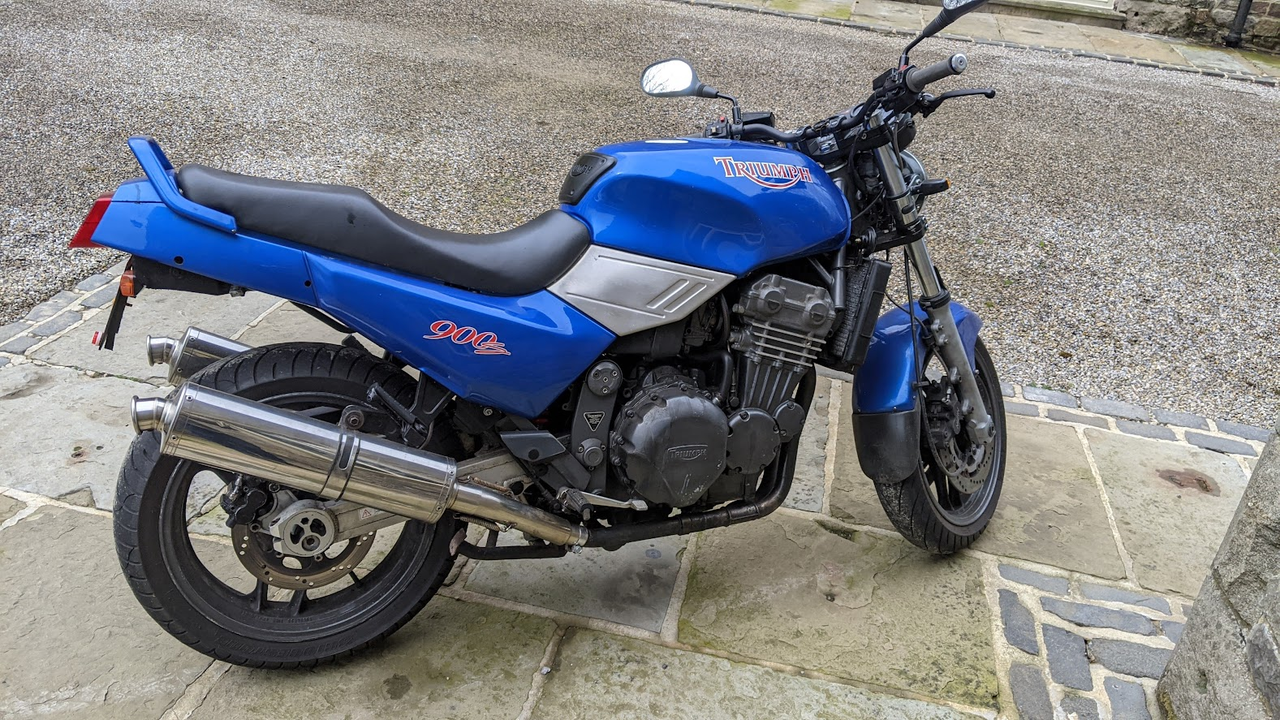

**Update**
Taxed and insured it when a dry day showed up on the forecast for 2nd April.
Rode it to work, about 6 miles on a/b roads. Didn't check tyre pressures before setting off so steering a bit meh.
Engine warmed up on choke in 2 mins and pulled cleanly through the revs with no misfires except the odd pop on the overrun
Next job is the neutral switch so I can ditch the centrestand which I can barely lift it on to anyway
Weather forecast has duly resumed normal service of wazzing down for weeks to come

Re: Making a Triumph a bit less ugly
Bar swap done, hands in a much more comfortable position and bars closer to my so my Yorkshire arm length is less of a problem
Back end is still a bit wallowy so a smidge more preload and wind on some damping to try.
I suppose at some point I should consider cleaning it
