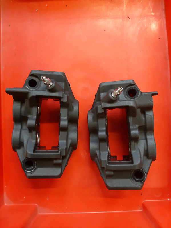

Going back a few weeks when I removed the front brake calipers it became obvious as soon as I popped the first piston out that the dust seals had swollen and would need replacing.
This is how the old dust seals looked ...
This seal was from the left side caliper which is the same side as the leaking fork seal so theres a fair chance they've been contaminated, the right side weren't as bad but Yamaha have brake caliper seals as a 24 month service item along with brake fluid so I would say they were over due anyways.
A few hours work and there all back together and the pistons are operating freely. Just need fitting and bleeding up.

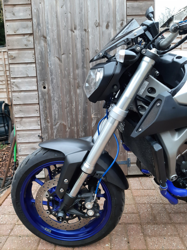

Spent a part of today fitting the previously serviced calipers and bleeding them up. All bled and the brakes work fine but I'm still not impressed with amount of lever travel , maybe I'll have to give them a chance to bed in properly with a quick ride when we're allowed, but I've already ordered a master cylinder service kit just in case.
Added a front axle slider and a screen... I doubt the screen is very effective at directing much air but it fills in the gap between the headlight and clocks nicely.

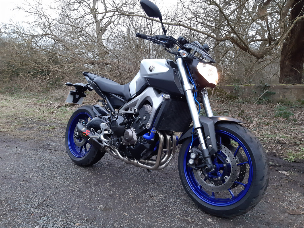

Well I've only gone and managed a bit of a test ride on the 09 :wtf:
After changing the front master cylinder seals, quick brake bleed , fit the exhaust system and quick check over of a few bolts with the torque wrench it was action stations.
A steady 5 mile run with a couple of stops to check a few things but it felt good to just get out on a bike for 10 minutes.
Brakes now have a good bite even though I'm still not 100% on the gap between the lever and handlebar when you get it. Some of which may be my fault for having large hands some if it maybe the handlebar is possibly bent on the right hand side, but that needs further investigation.... Luckily that friendly chap @Beancounter sent me some Woodcraft bars so they'll be going on maybe sooner than I thought.
Something else I noticed that I hadn't spotted on the test ride at purchase time was the speedo is not reading speed correctly.. 150 in 3rd gear type of optimism with more rev range to go :lol: :lol: .... Speedo healer required me thinks. Another £85 but its only money , right :wtf:

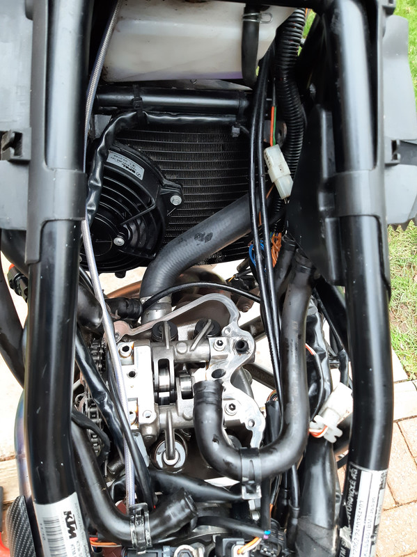

Enough time for a valve clearance and rocker arm check on the 690 and a proper check over of everything else.
Oil change and its ready for another year... oh and an indicator bulb :thumbup:
