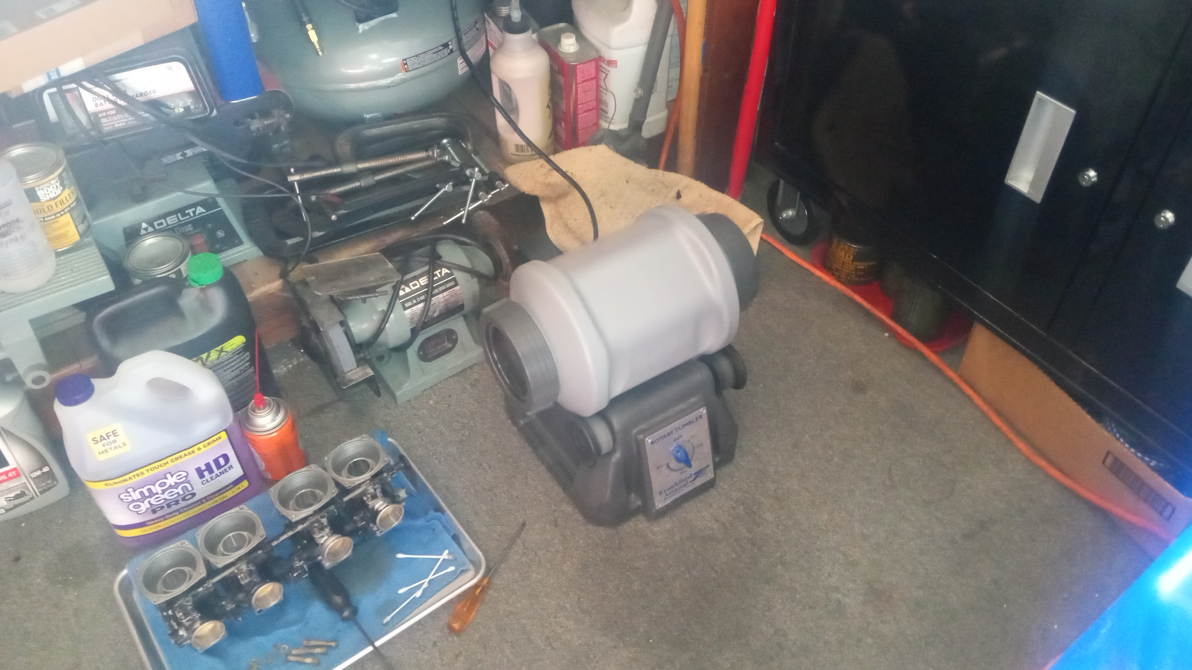

Still no movement on the rear brake lever pivot. If I had my press set up I'd just put some pressure on the doodad & walk away for a week. :angry-cussingblack:
Maybe an hour in the ultrasonic would result in some progress. :think:
Rear brake lever is in the tumbler which is using stainless steel pins as the media, timer set to 90min.

Bunch of hardware is in the tumbler, set the timer for the max 3 hours.

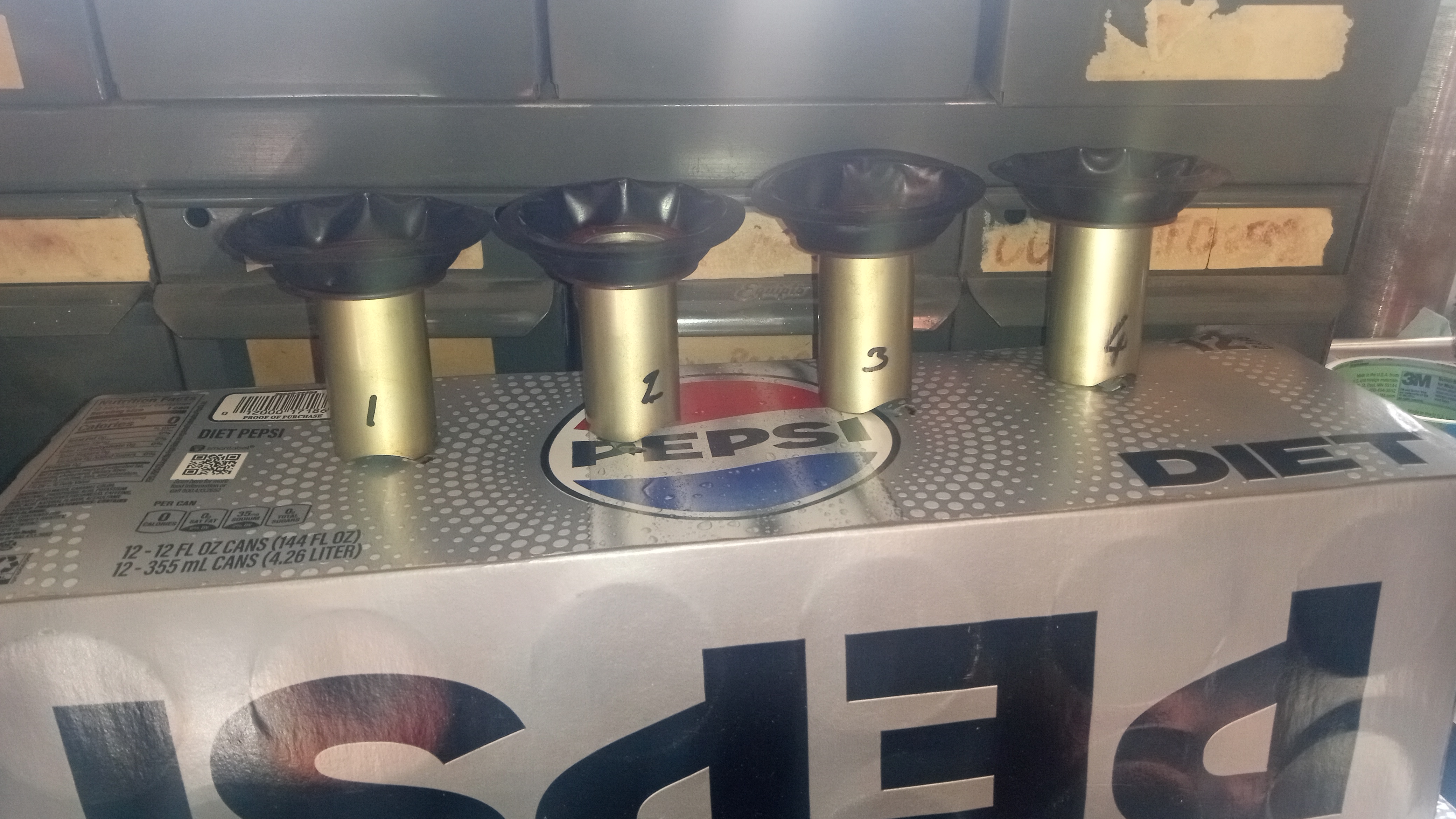

Slides with the needles poked through the box so they're not resting on the diaphragms...

Had a look in the tumbler after 2 hours, reset the timer to 3 hours again, will probably do that again before I go to bed tonight.
