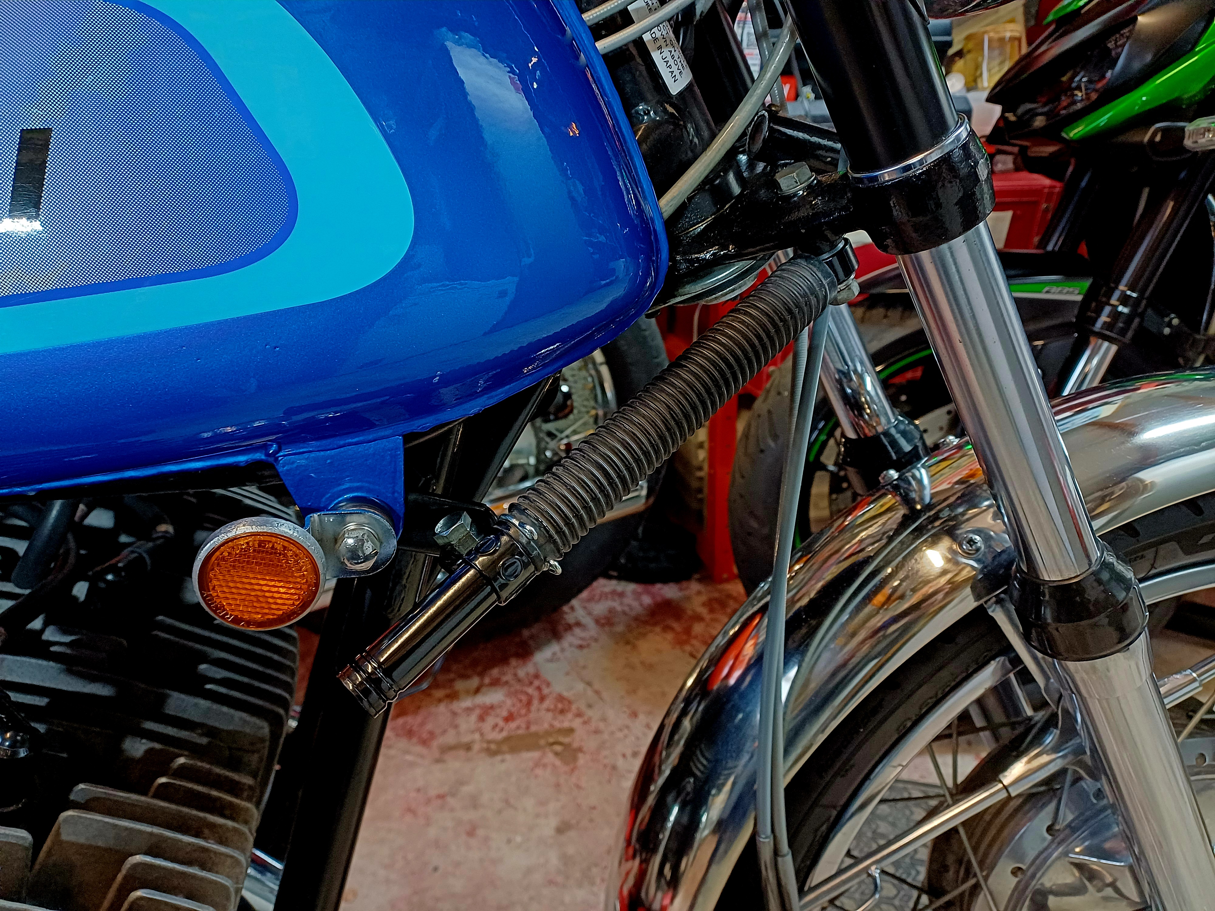

You should be more careful with that polishing mop...

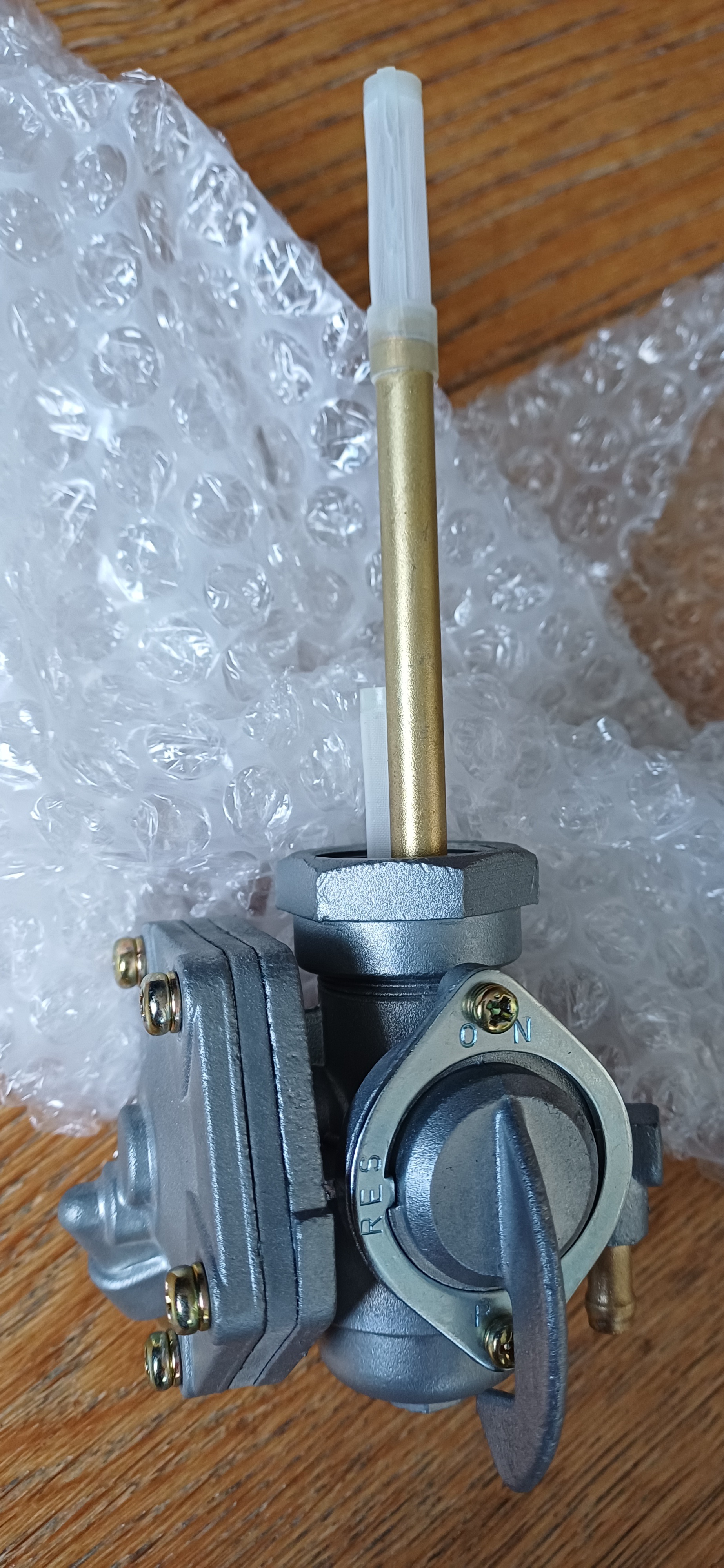

Refurbed vacuum tap de-vacuumed and prime position converted to off. 8-)

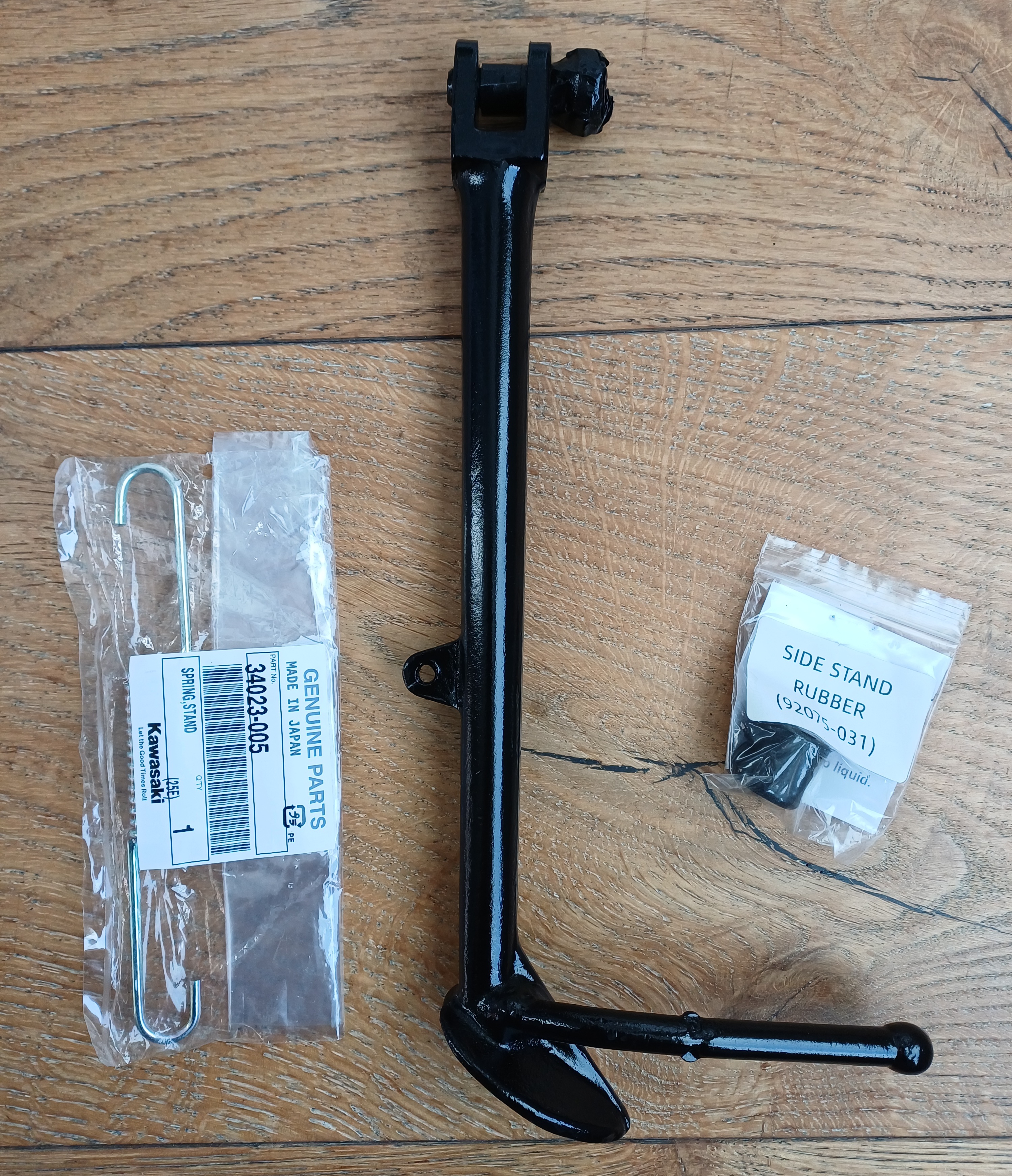

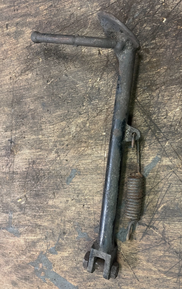

The bike has always had a steep lean on the sidestand,which makes me kinda twitchy,so I use the mainstand mostly when parked up. A common mod is using a sidestand from the S series bikes (250/350) as it's about an inch longer. I managed to blag one of the evil-bay last week. It was pretty rough,but sound and came up as serviceable enough.

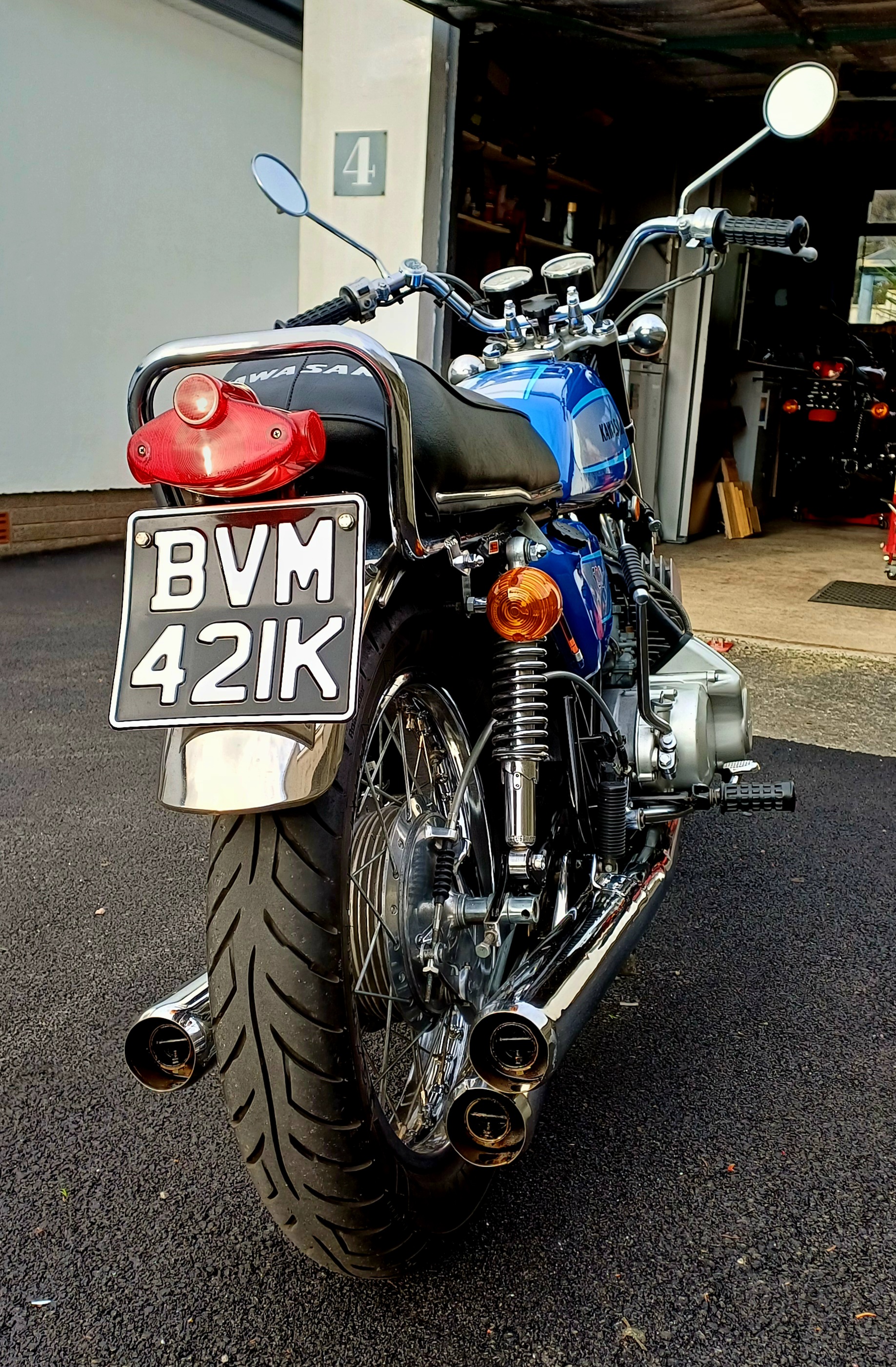

A fair bit less lean with the new sidestand.
