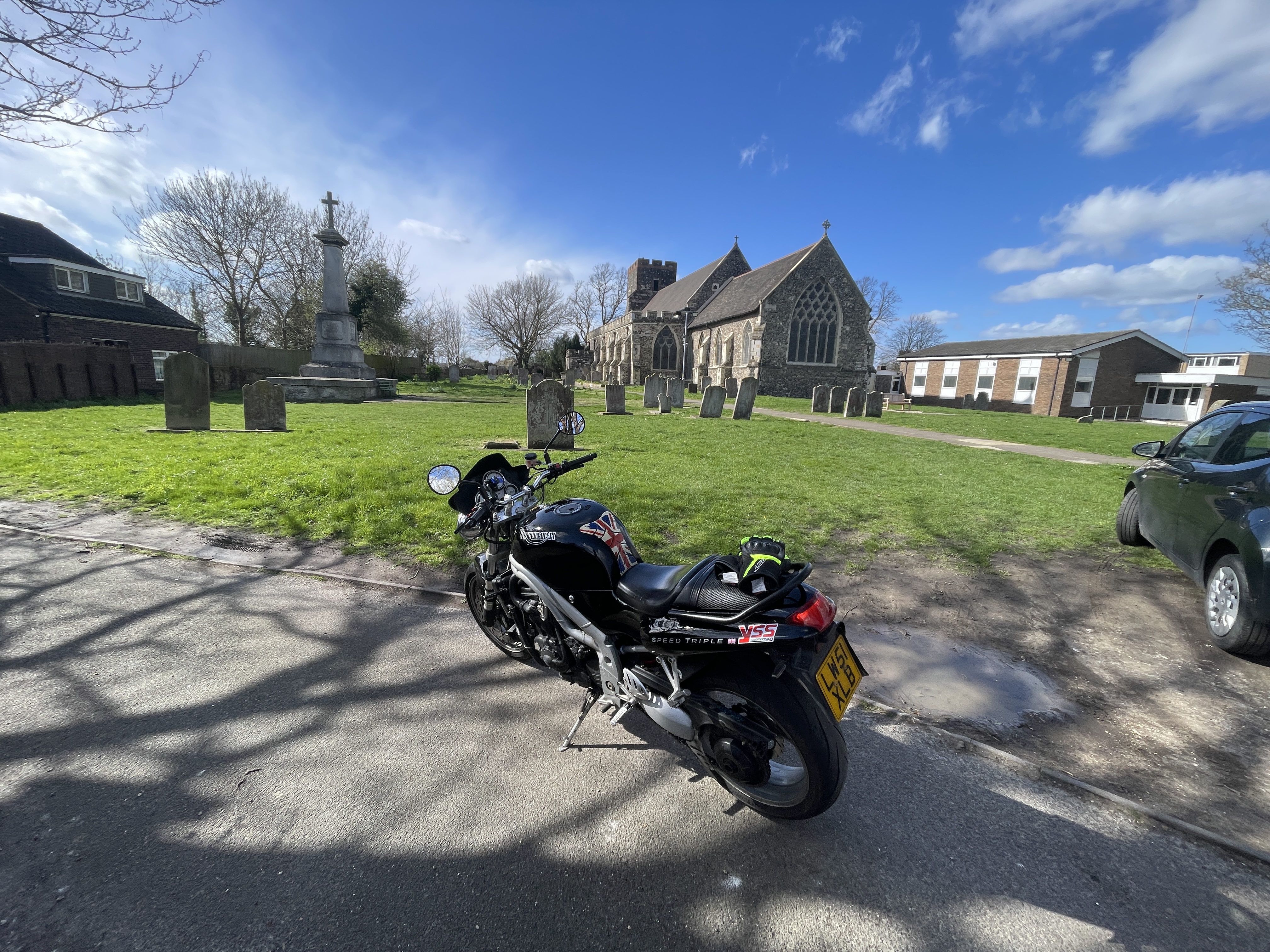

Obligatory shot of the bike with my church in the background after a ride to Paddock Wood for Diocesan Synod. Beautiful cool day for a ride and the bike was flawless in performance. The changed speed drive is remarkably accurate, with cable driven speedo at 70mph being just about spot on with the GPS reading as well.
