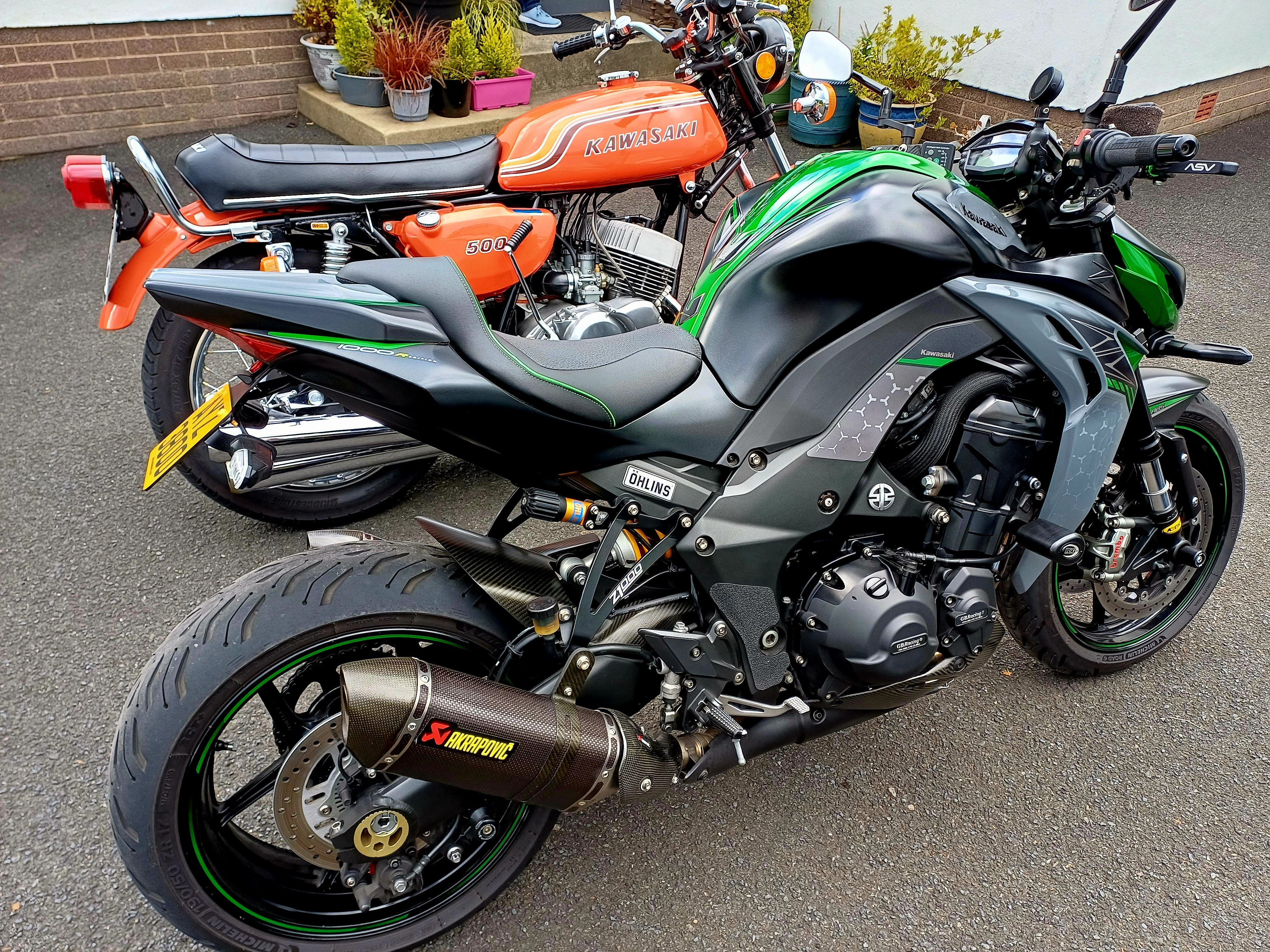

They are quite a bit scaled down from modern stuff in some respects. Things such as the fuel tank are more dinky because they're not half airbox!ChrisW wrote: Mon Jul 22, 2024 9:18 pm I always expect these bikes (excuse the generalisation) to be smaller, and then you see them with the rider on for perspective.
Not the best comparison,but you can see the fuel tank sitting much higher on the Zed. The seat height is similar on them both,an easy both feet flat on the ground.

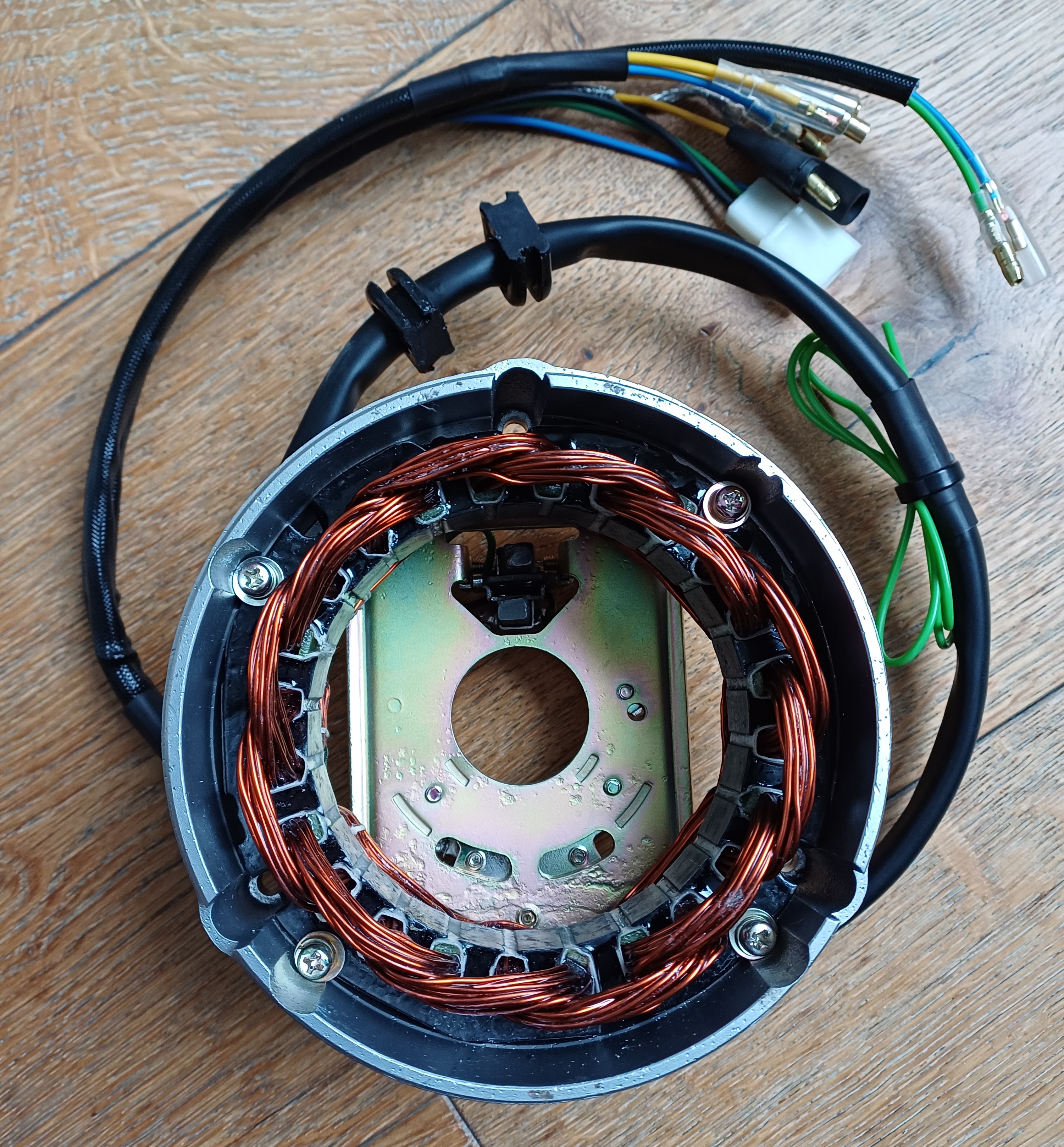

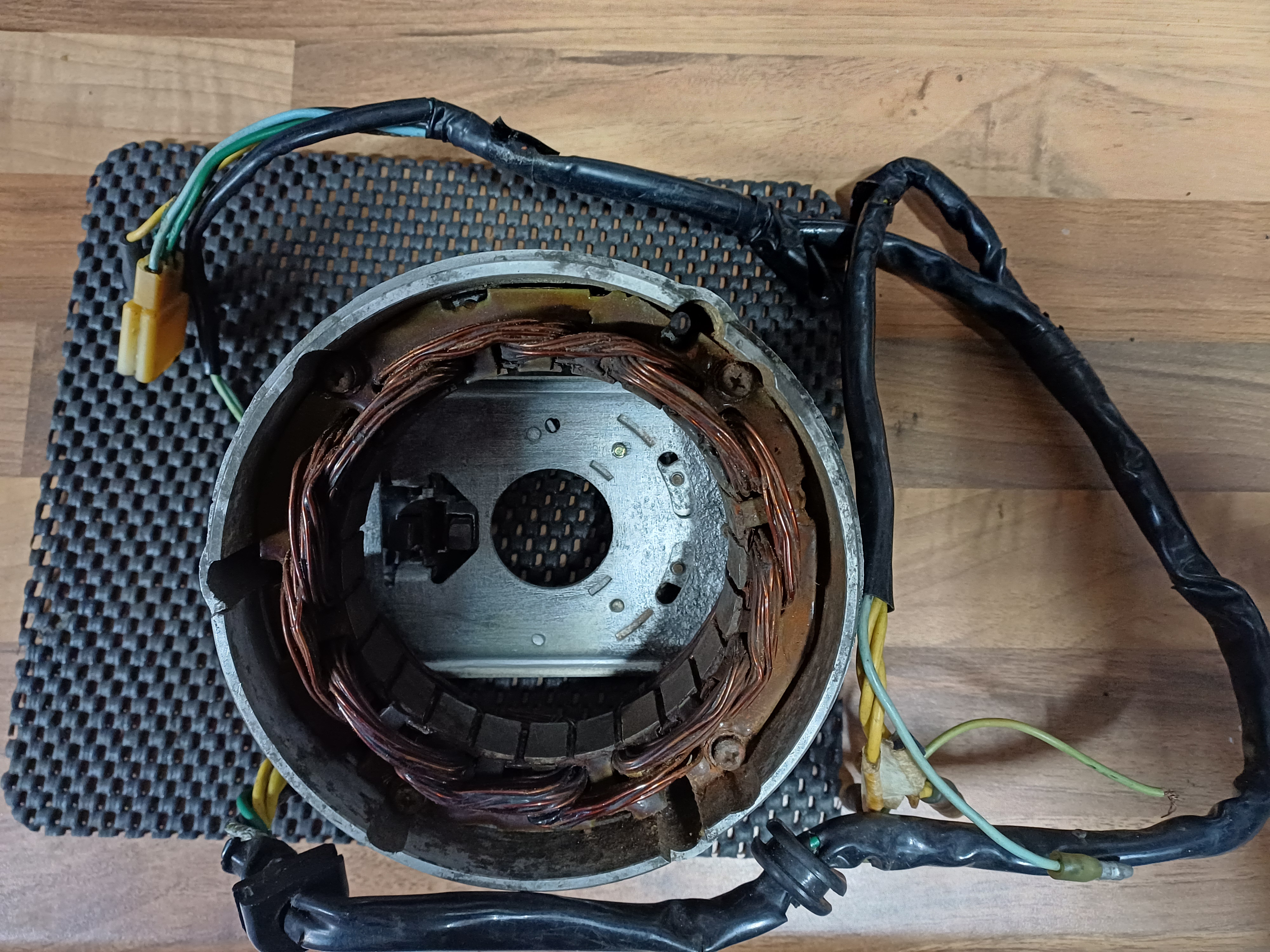

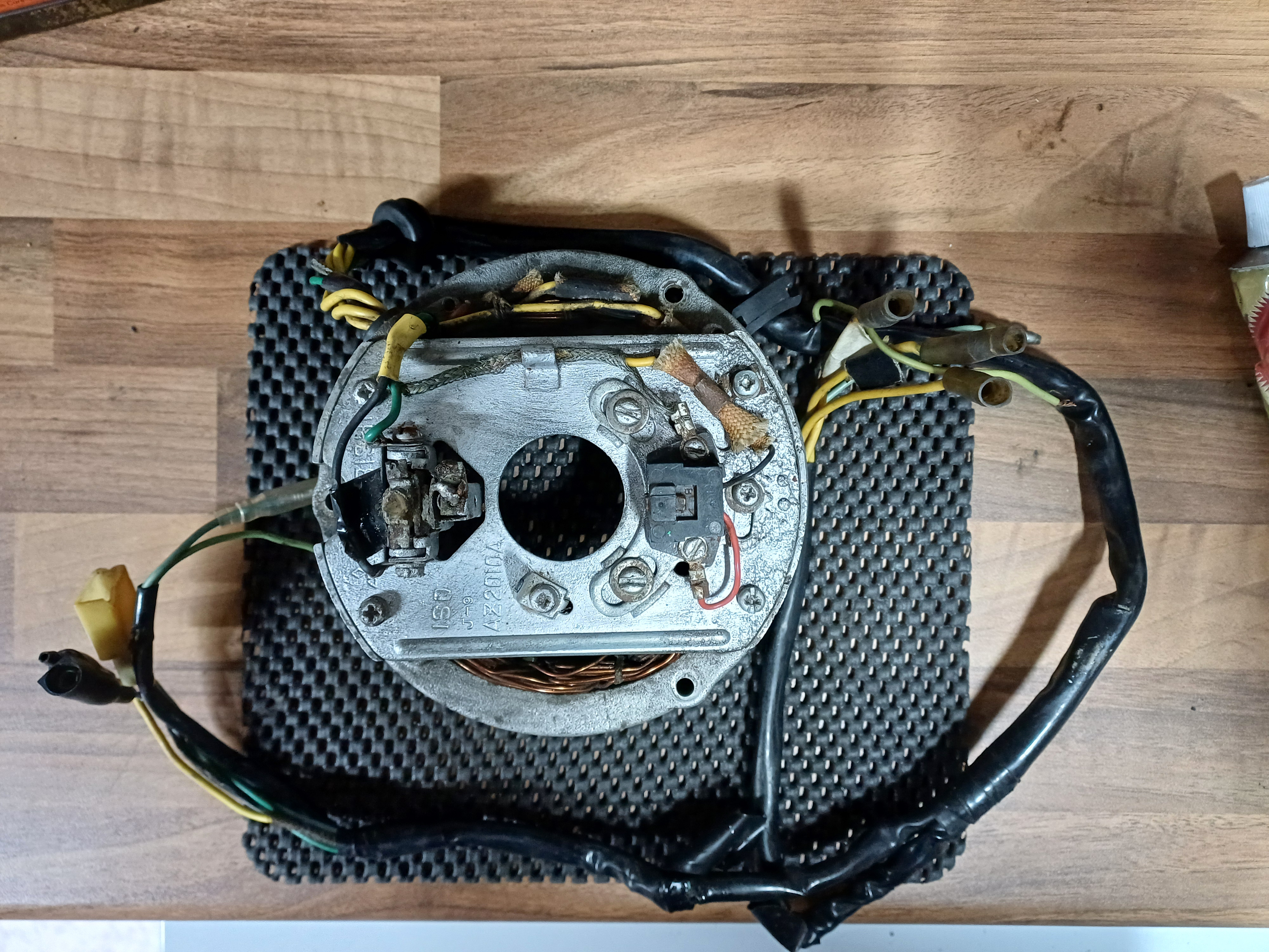

It took 10 months of waiting,but I finally got my refurbed stator back from a triple specialist. Some before and after pics.

Cracking job - he's had the base plated blasted and zinc passivated and done a lovely job on the rewind and the wiring. Better than new, I'd say.

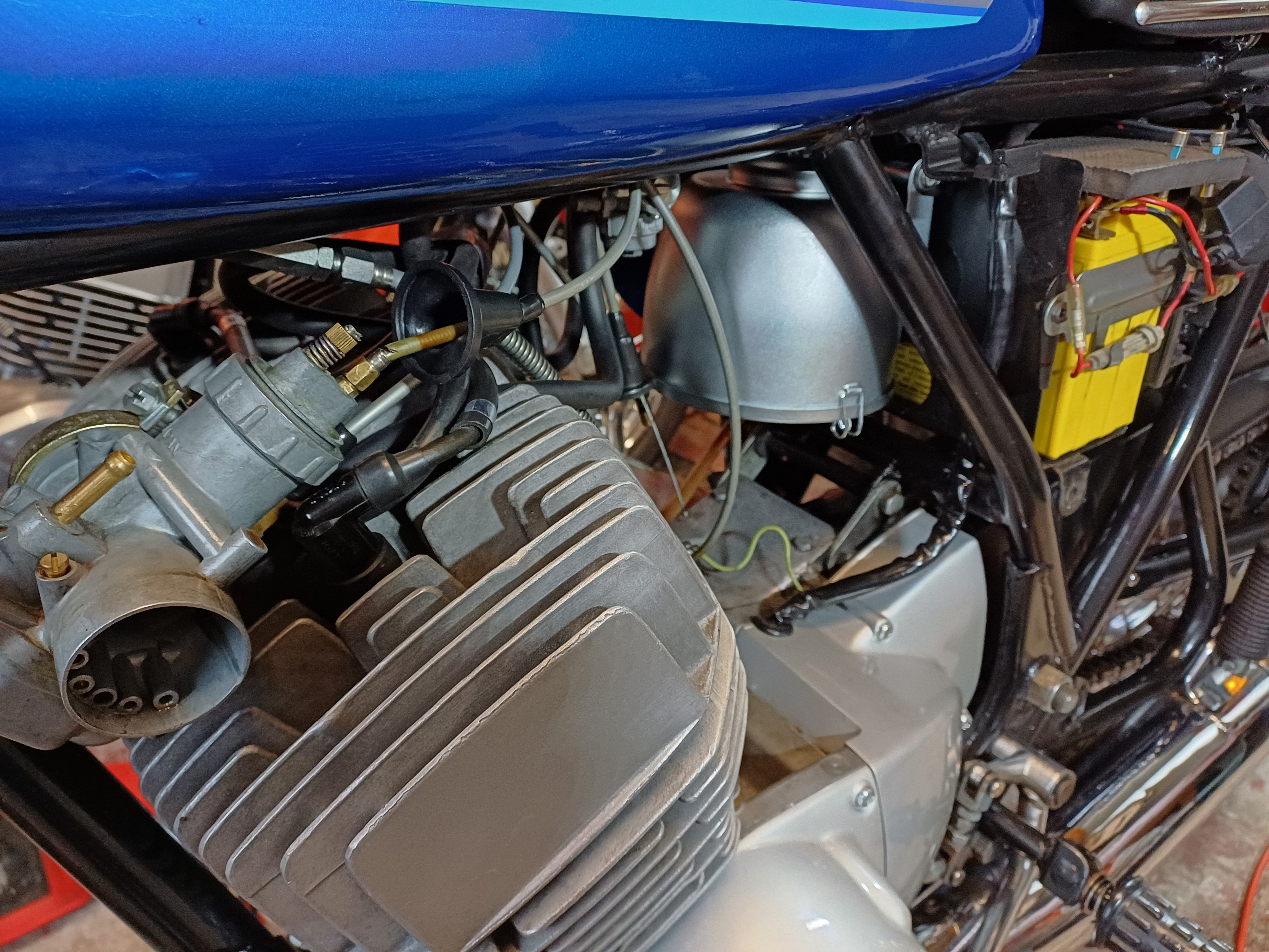

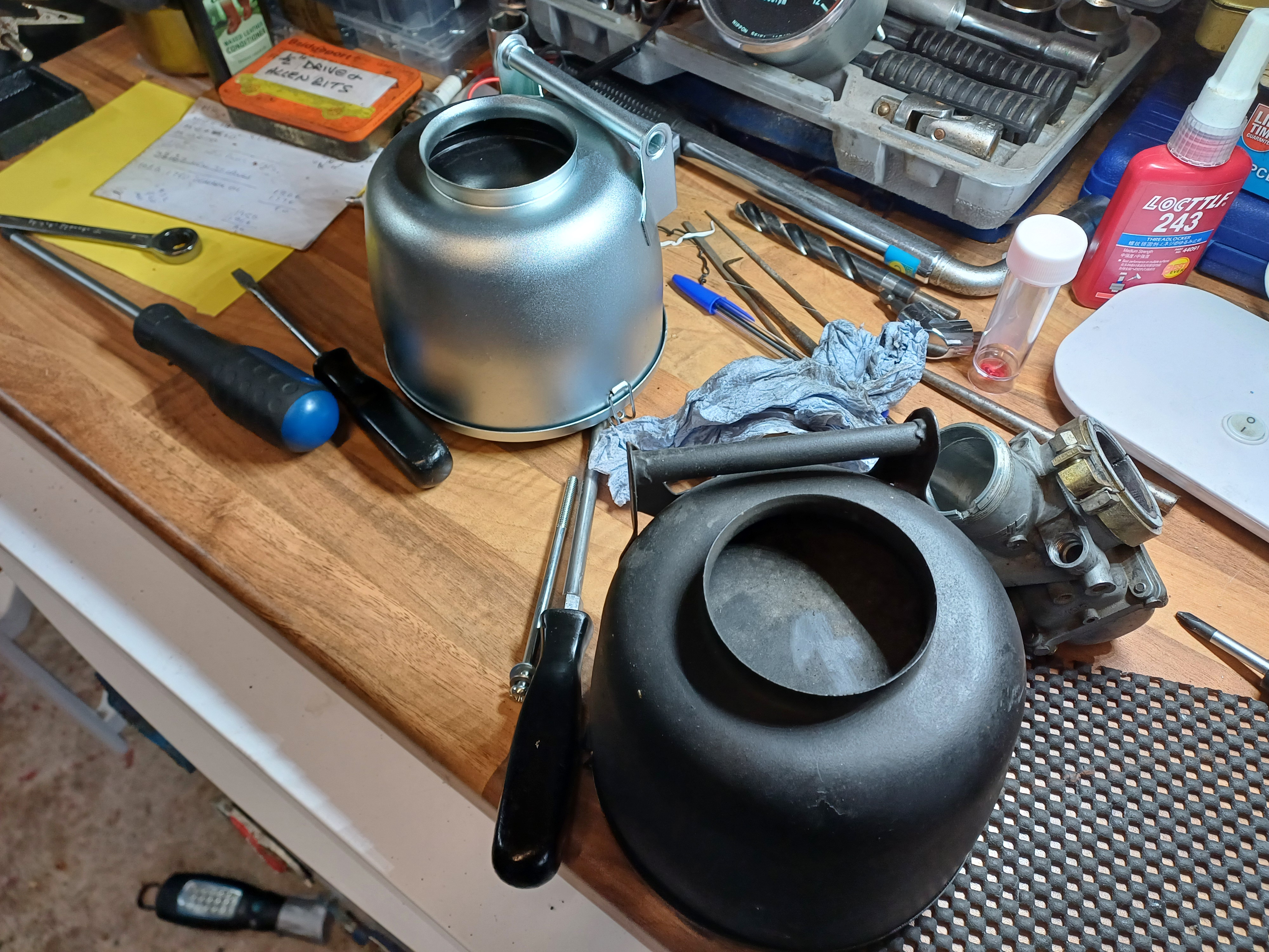

I've had an original plated airbox to put on for about a year now,but two carbs have to come off to get the box in and out,so since the bike has been consistently running sweet,up to now I haven't bothered to fix what isn't broken.
Lately the centre pot has been slower than the other two on cold starting,it chimes in after about 10 seconds or so. The bike runs perfectly when warm,no low speed bother,so I suspected the cold running/choke system. There's a very fine hole in the float bowl which allows extra fuel when the choke plunger is raised. I didn't see anything obvious,but poked a 10 thou E string down the hole and gave it a good blowing out with compressed air just to be sure. Hopefully sorted,or I'm looking elsewhere for the problem. Too late and too wet to drag it out for a start. Maybe tomorrow.
I checked the carb sync while I was in there and happily it was spot on.
On the early 69-71 H1s the airbox rubbers come in 3 sections with metal inserts and clamps. This is a job best tackled if you aren't in a hurry anywhere,or if you very much enjoy a challenge. Twat of a job. It's a bit easier on later H1s as the rubbers are one piece.
72 on airbox - black and 69-71 airbox - plated. Job jobbed.
