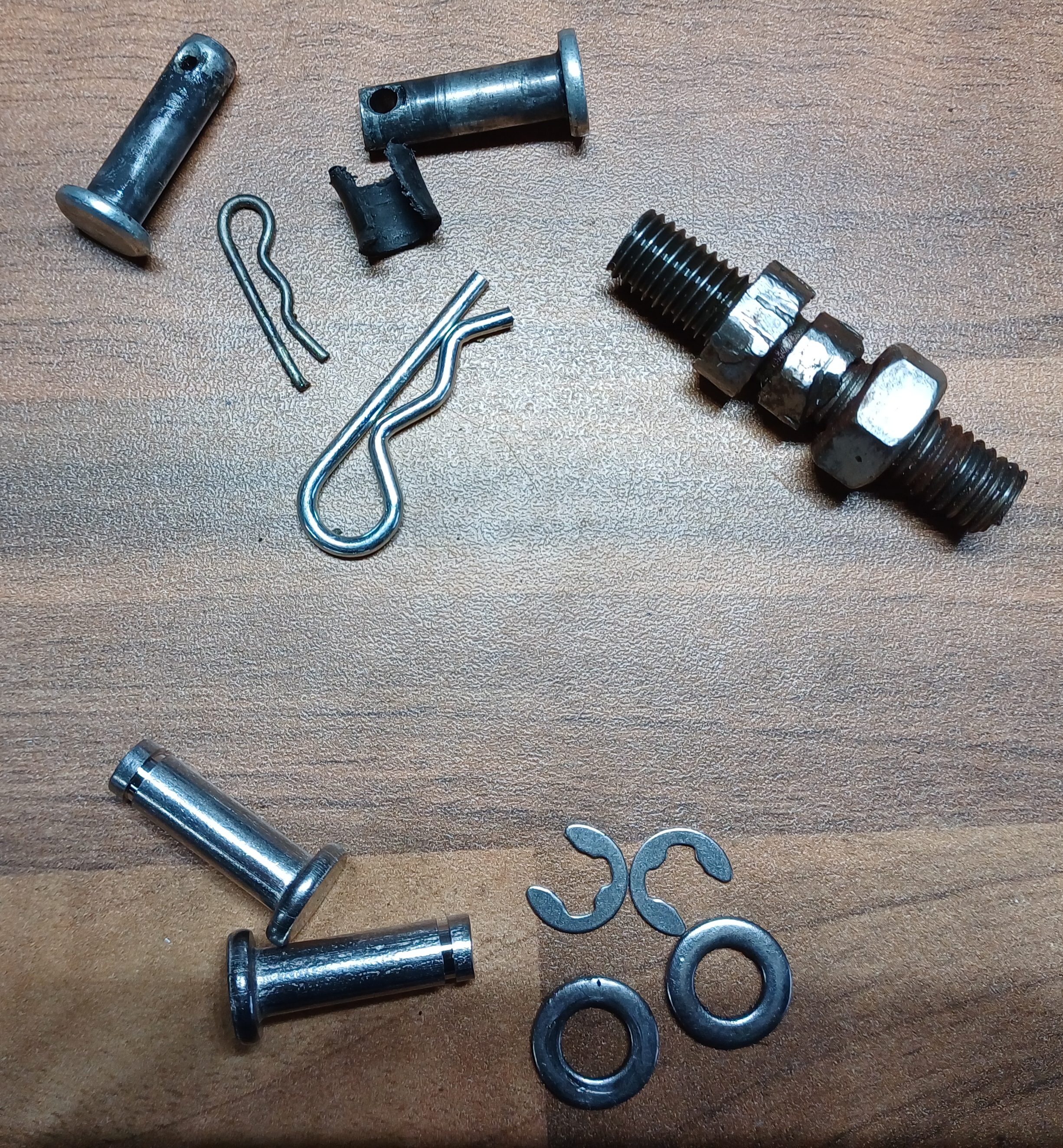

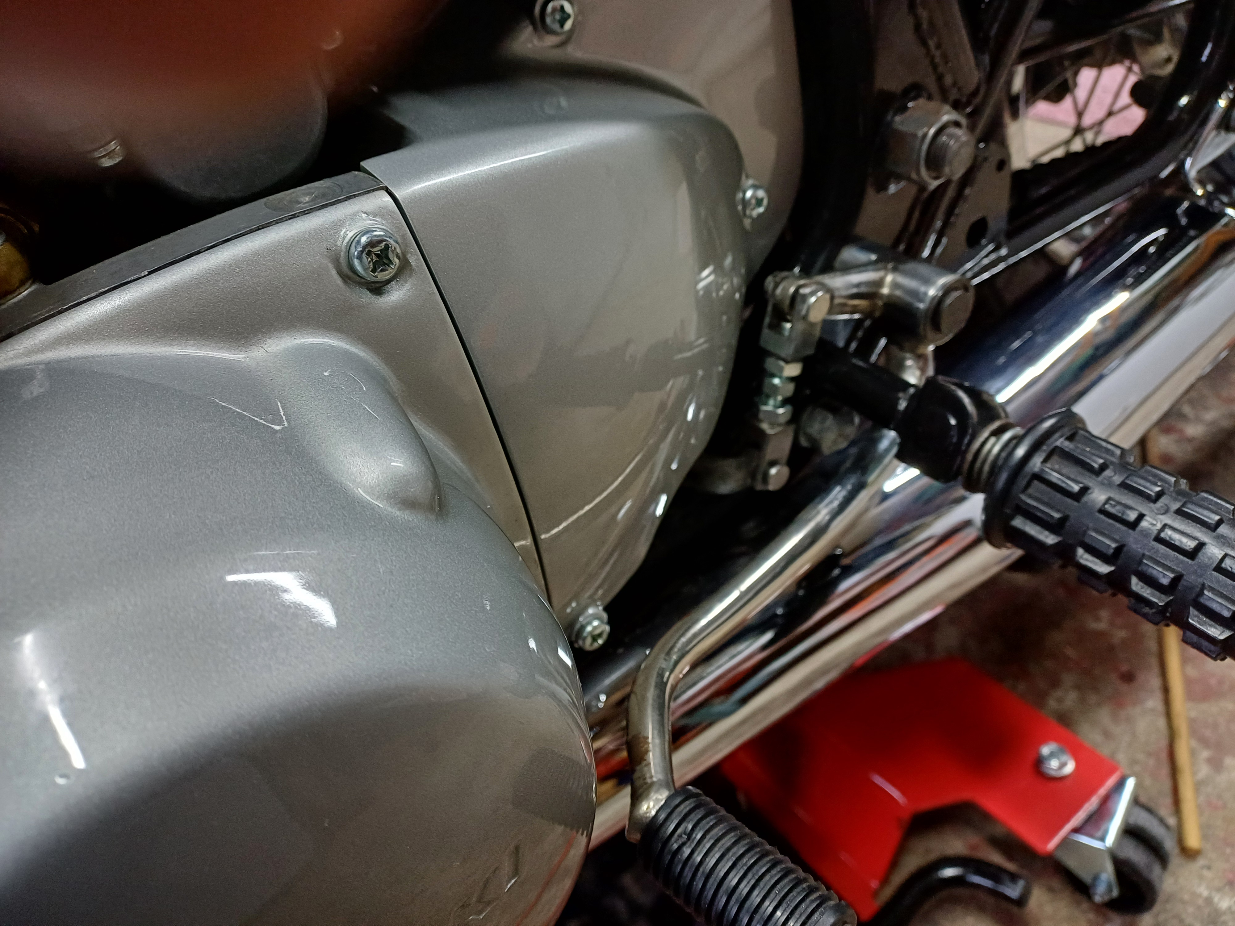

A little garage time today.
The little adjuster for the gear linkage was pretty well bodgered and the locating pins were a mix and match,so I treated it to a new adjuster and pins with a little circlip as per original.

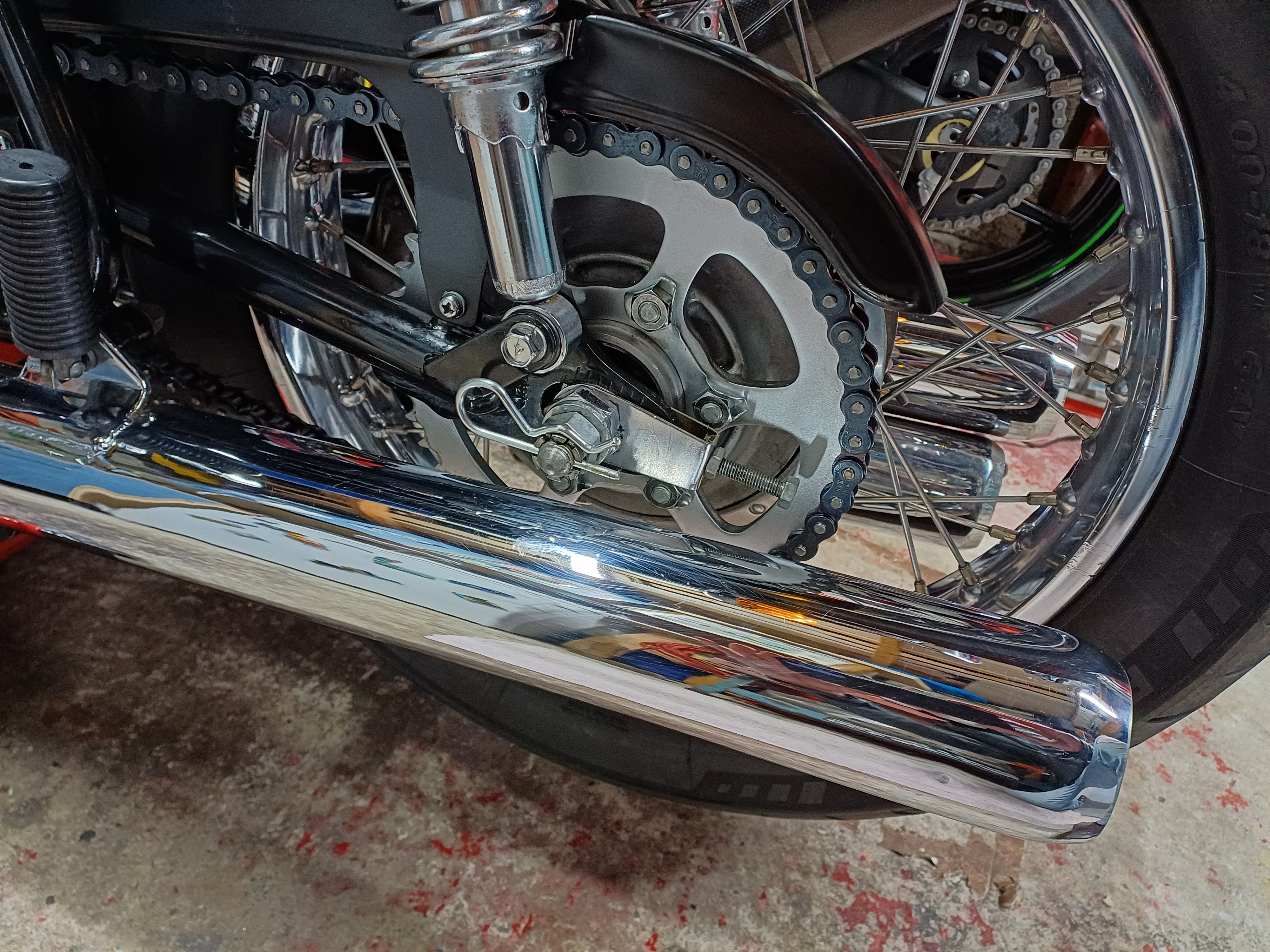

I replaced the chain,as it was a bit ropey,the sprockets seemed fine,so I cut that corner for now.

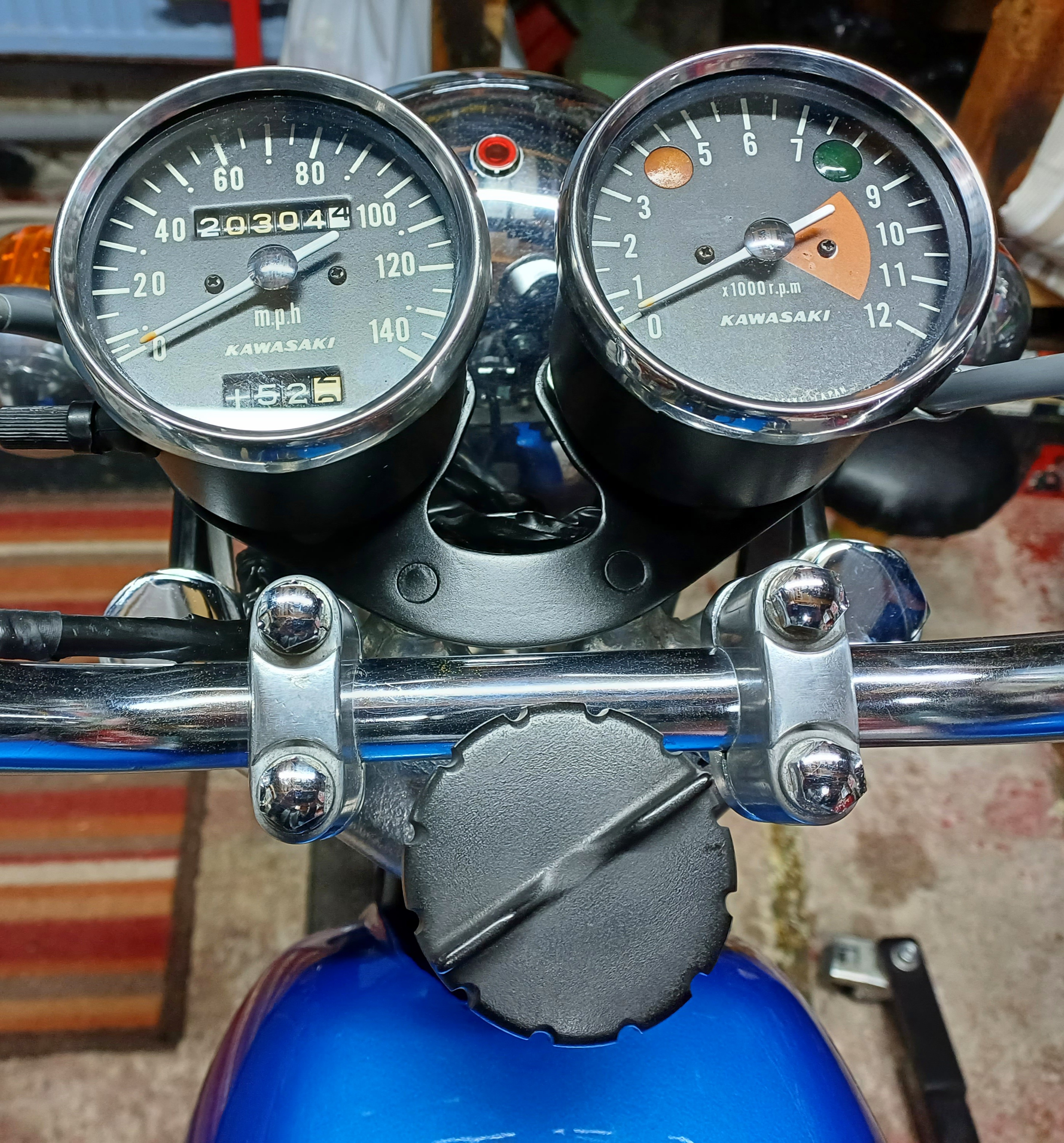

Your H1 has done almost exactly the same miles as my 350LC. Just checked and the LC is showing 20,332.
Re: Kawasaki H1 1971
mangocrazy wrote: Sat Dec 30, 2023 3:07 pm Your H1 has done almost exactly the same miles as my 350LC. Just checked and the LC is showing 20,332.
Pretty much the same as the Zed too,but 49 years younger!

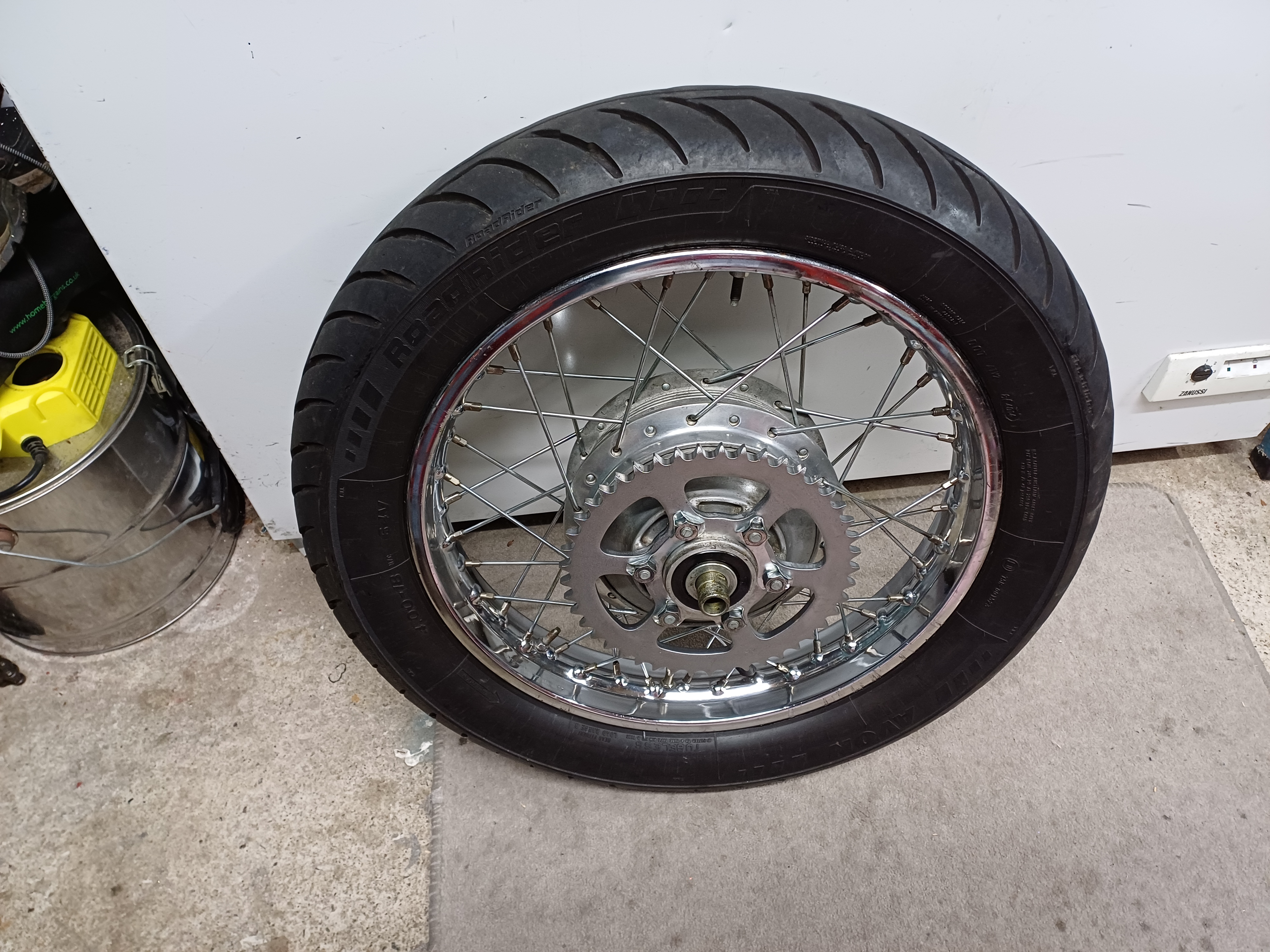

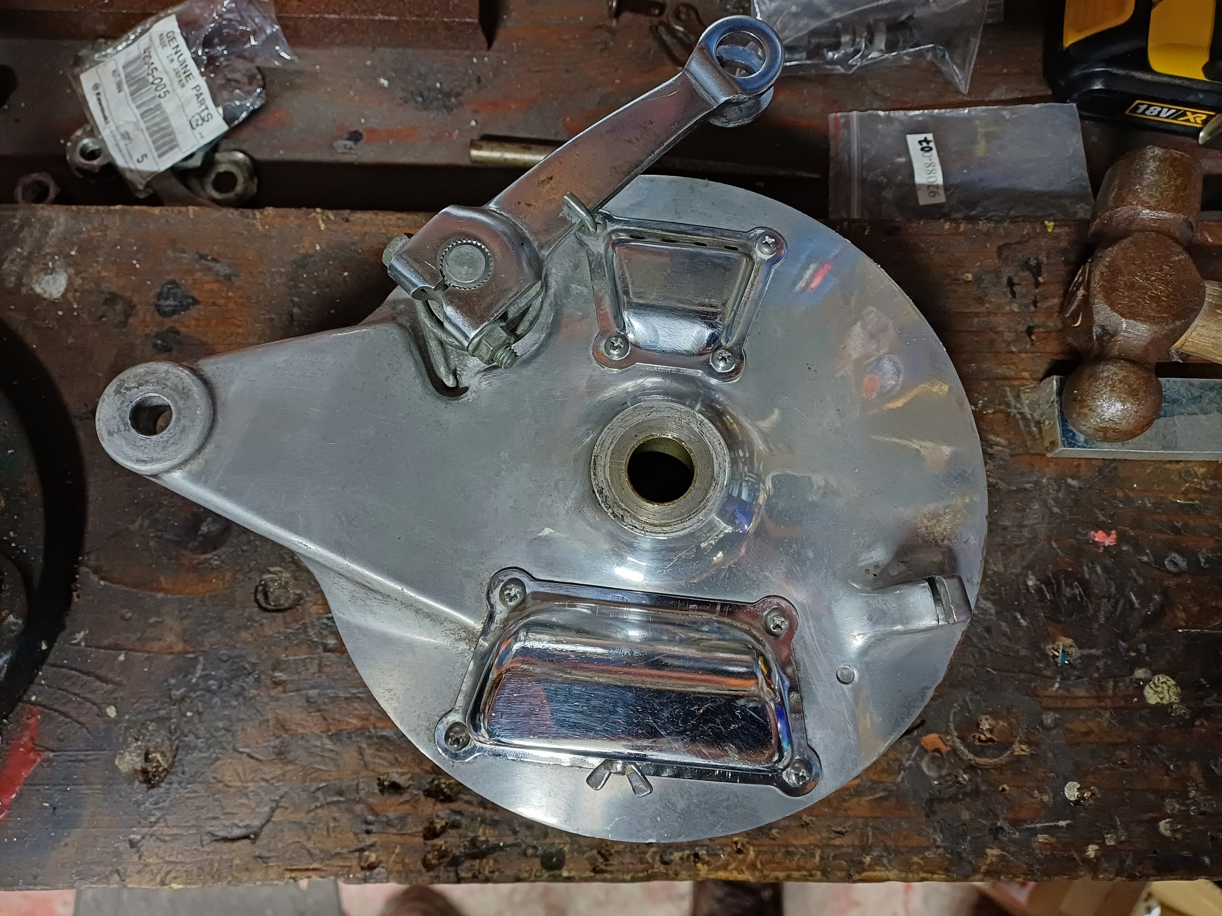

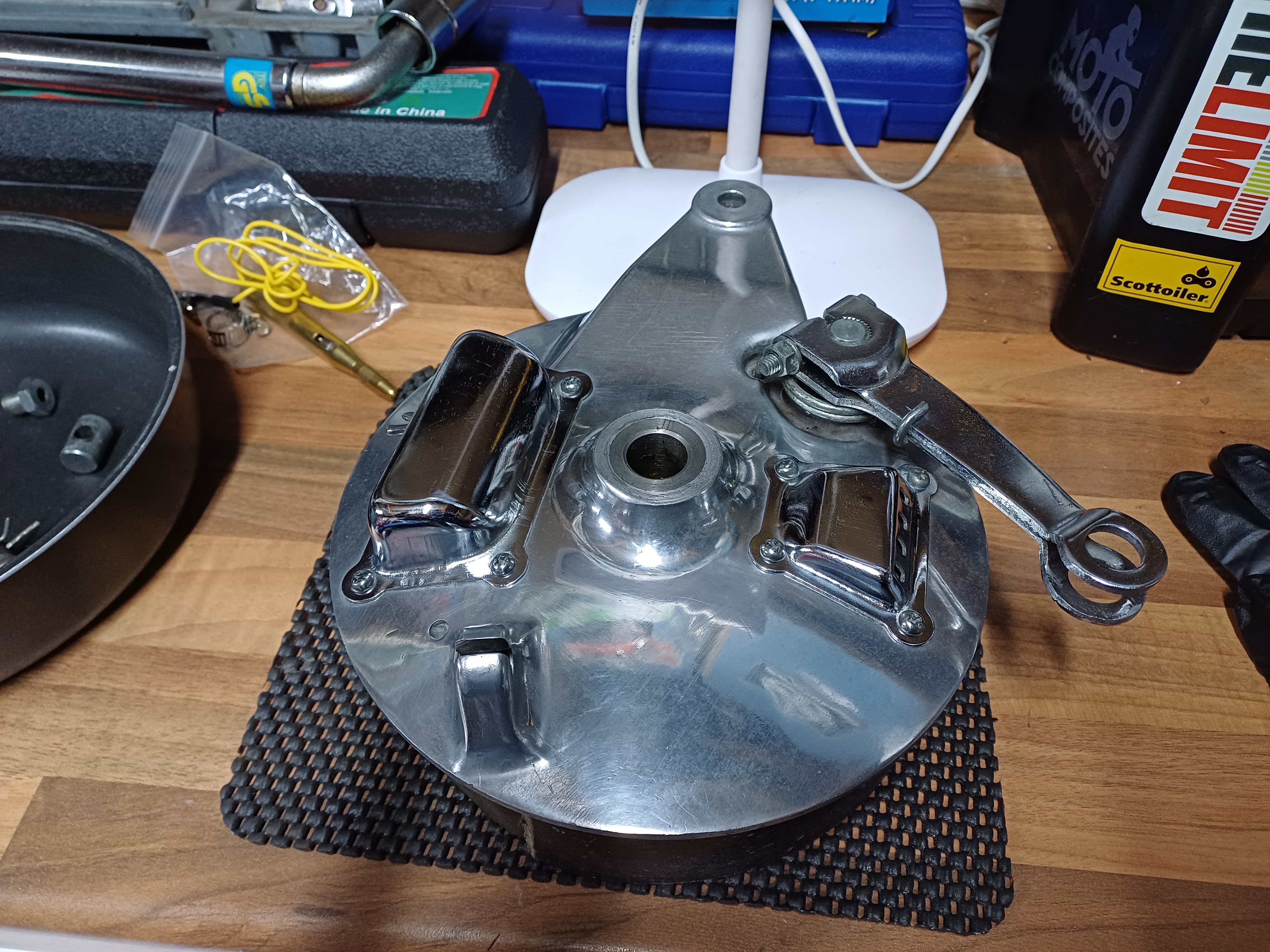

I decided to replace the sprockets after all,for all they cost it's daft not to really.
It gives me a chance to clean all the hidden parts while the rear wheel is out too.
H1a part 2 - Imgur.jpg (1.39 MiB) Viewed 668 times

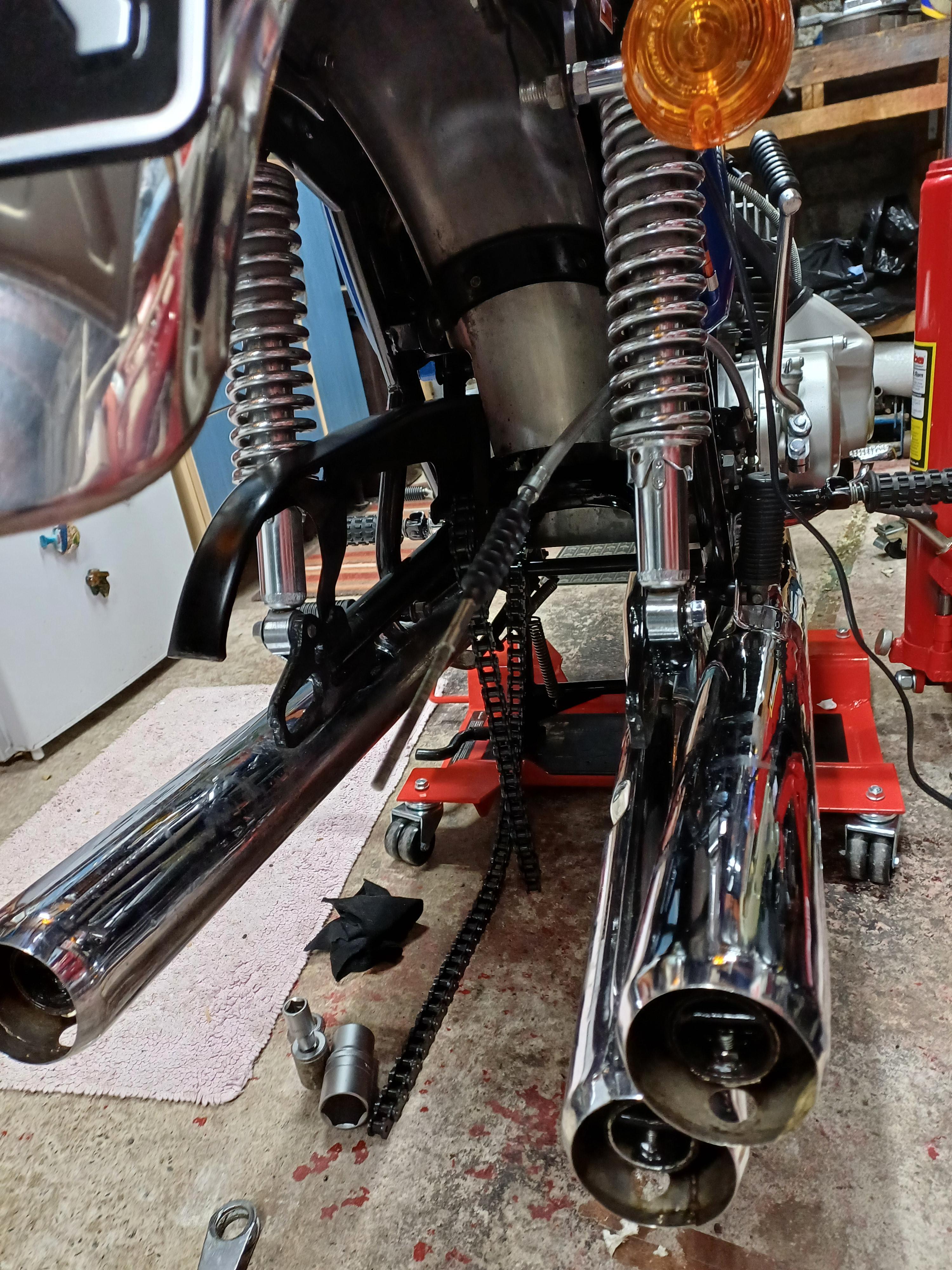

I'll get busy with the solvol on the rear brake housing. It's hard to get at on the bike.
H1a part 2 - Imgur (1).jpg (3.33 MiB) Viewed 668 times
My cush drive rubbers have a little more play than I'd like,but it's one of the parts which isn't readily available as a reproduction. Does anyone have a hack? I remember using bits of inner tube rubber to pad it out on my Z1 in the 70s,but it spat them out in no time!

I still use strips of inner tube on my Tenere cush drive when it gets a bit too much play and cable ties through the the sprockets and round the spokes to pull it all tight together for refitting.

Skub wrote: Mon Jan 08, 2024 5:22 pm
Took me a second or 2 to find the swingarm, it's no bigger than the chain guard :lol: I'm too used to modern bikes

Gregor wrote: Mon Jan 08, 2024 5:45 pm cable ties through the the sprockets and round the spokes to pull it all tight together for refitting.
That was a very handy tip. Like all rear wheel removals and refits,there's a knack and first time is usually a cunt. With the exhausts running tight to the rear wheel there's not much room for juggling,so the cable tie trick was one less thing to balance.

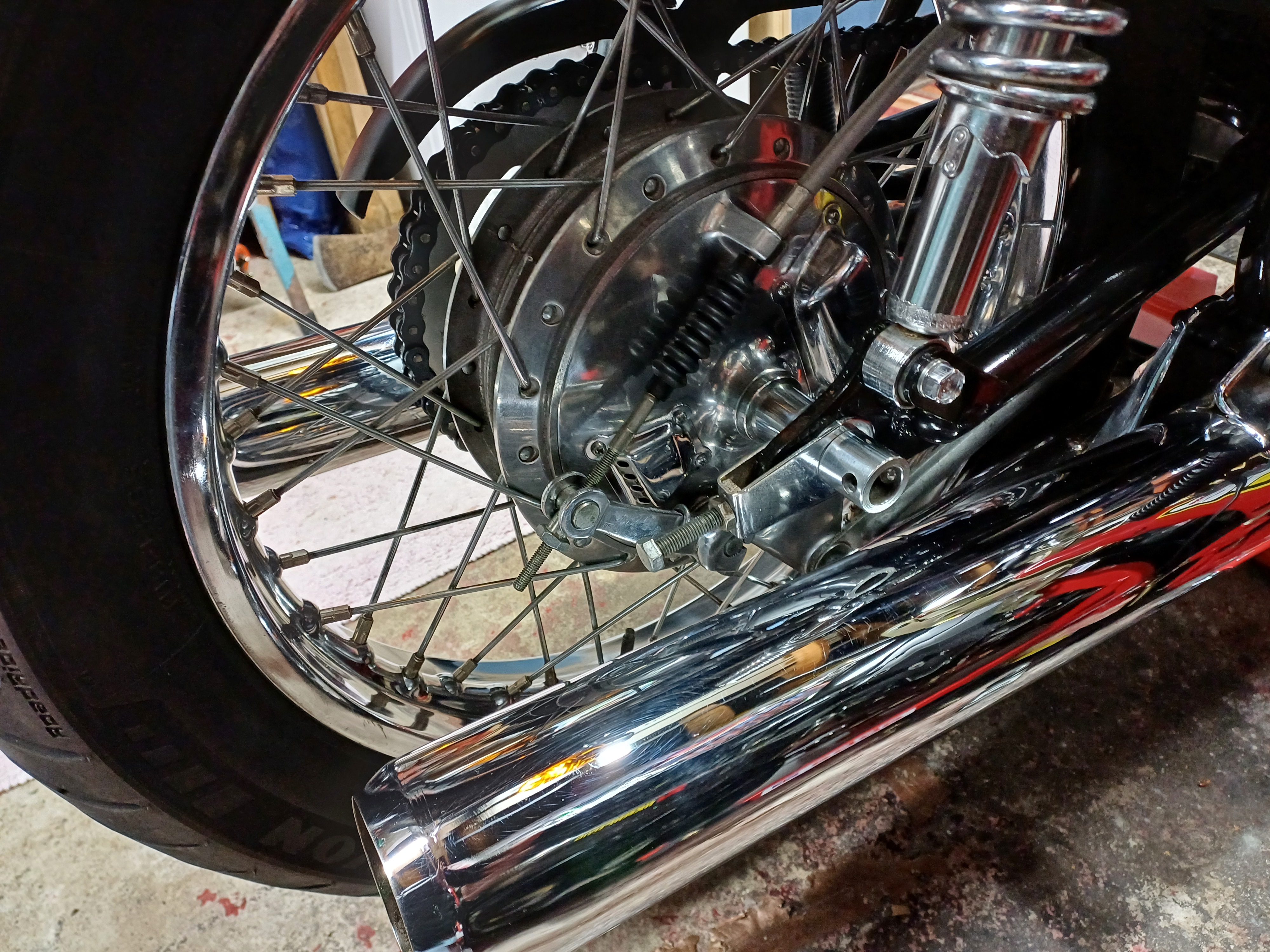

Buttoned up again and ready to roll,it's bloody freezing in the garage tonight,so I'm done. Looks well though.
H1a part 2 - Imgur (4).jpg (3.8 MiB) Viewed 666 times
H1a part 2 - Imgur (5).jpg (3.52 MiB) Viewed 666 times

Skub wrote: Mon Jan 08, 2024 5:22 pm I decided to replace the sprockets after
Cut up a plastic milk bottle?
Taipan wrote: Wed Jan 10, 2024 5:30 am Cut up a plastic milk bottle?
In the end I padded it out with strips of rubber,we'll see how long that lasts.
