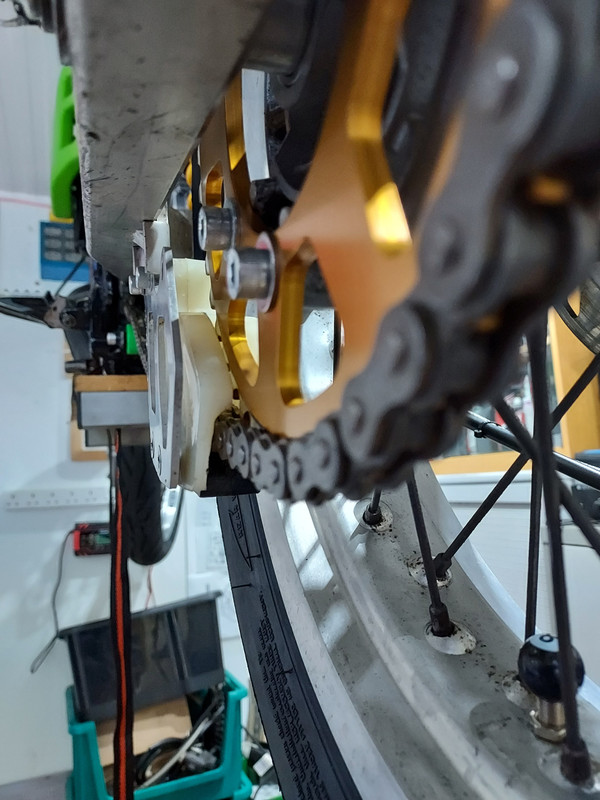

Mine should be ridged, but they aren't avaialble so I made these out of thicker flat with countersunk bolts.weeksy wrote: Wed May 05, 2021 1:58 pm out of interest, why are yours flat and more modern bikes ridged in the middle ?

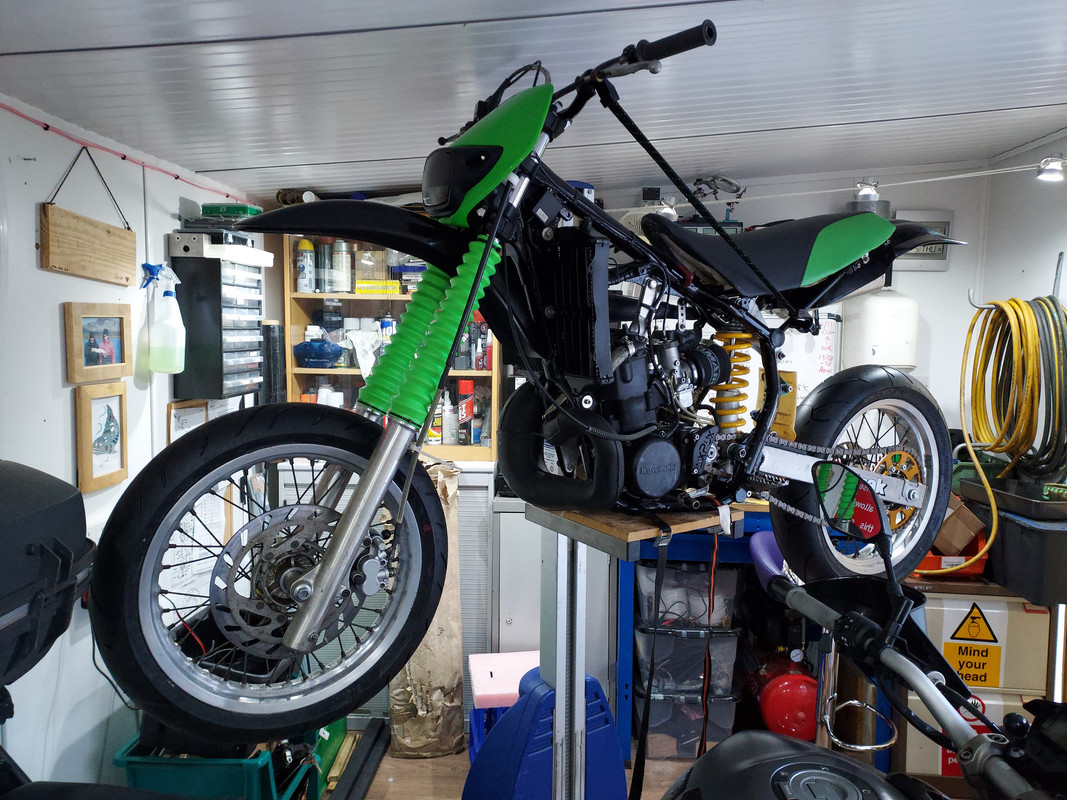

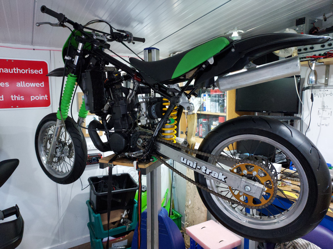

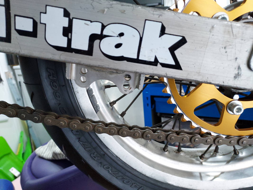

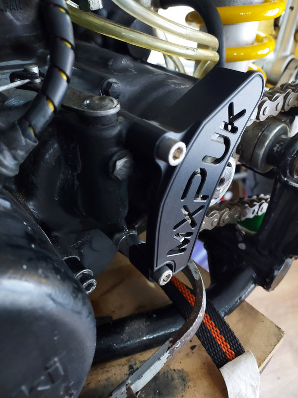

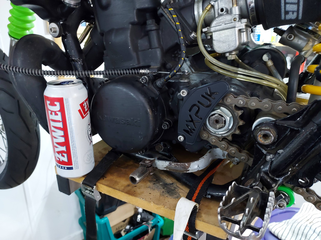

The sprocket guard is the same on the 85-95 cases so I picked a billet one up on eBay. One of the previous owners had snapped off the bottom lug so it meant some epoxy and a couple of filed down spacers to bring it back in line with the top mount.
Next is the rear chain guide, I'll probably just make something out of alluminium plate and some of the acetel bar that I used for the swingarm sliders.
And finally a couple of shots of it up on the lift looking menacing.
Now it's got a front brake I'm going to spend my time sorting out the roller starter (in the workshop thread) and then I can at least get the engine spinning for more than 5 seconds using the kick start.

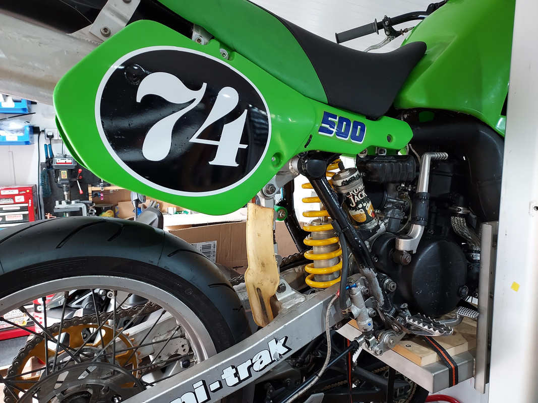

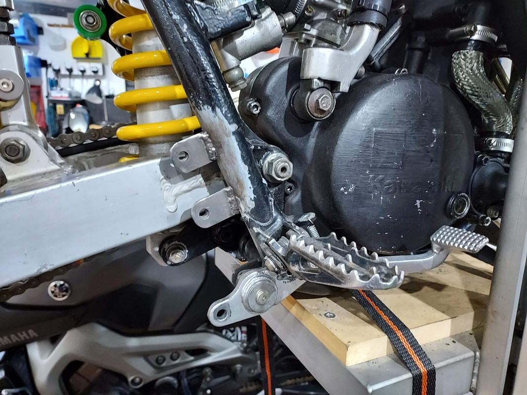

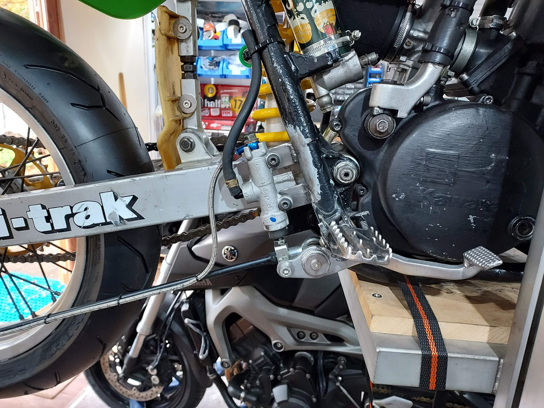

Mounting brackets for rear M/C done. 5mm steel with nuts welded to the rear.
I found a decent lenghth of ally rod for the torque arm and fitted a new rose joint to the frame end, the other end will be clevis fork connecting to the caliper bracket.

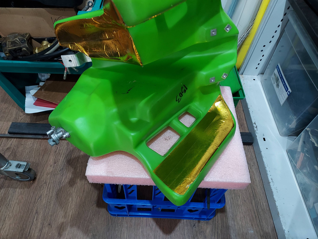

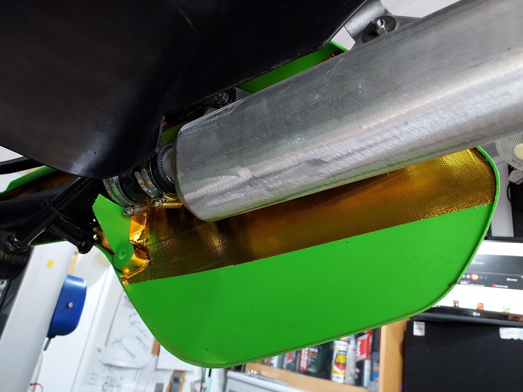

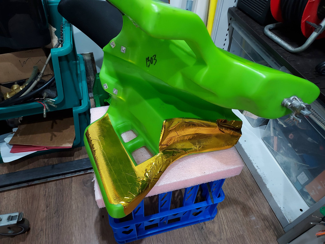

Heat barrier tape applied to the tank where it's close to the spanny and the rads, plus some on the rear panel where it's near the silencer.
A couple of decals arrived so I applied them too, the RHS one is a horrible compound curve so it had to be slit in a couple of places to fit.

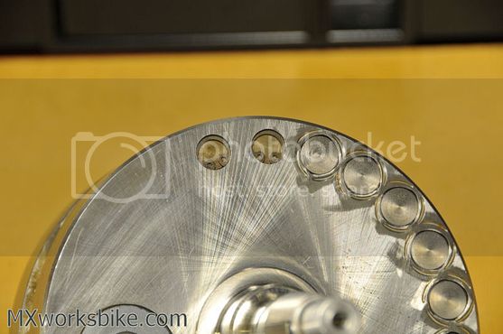

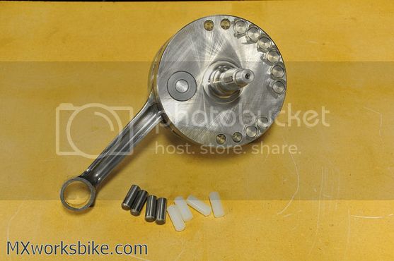

Bit of a random one but I found these pics in amongst various big motocrosser info I have.
Crap pics and somewhere I'll have better versions but I thought you might like this clever detail.
Tunable crank weights for different rpm applications.
I'm pretty sure these were on a works CR500 but you'll get the idea.
My guess is Tungsten*, Brass, and plastic. All held in place by circlips.
I'm not suggesting you do it, just thought it was an interesting detail to show the guys.
*Could be steel but thats basically just standard isn't it.

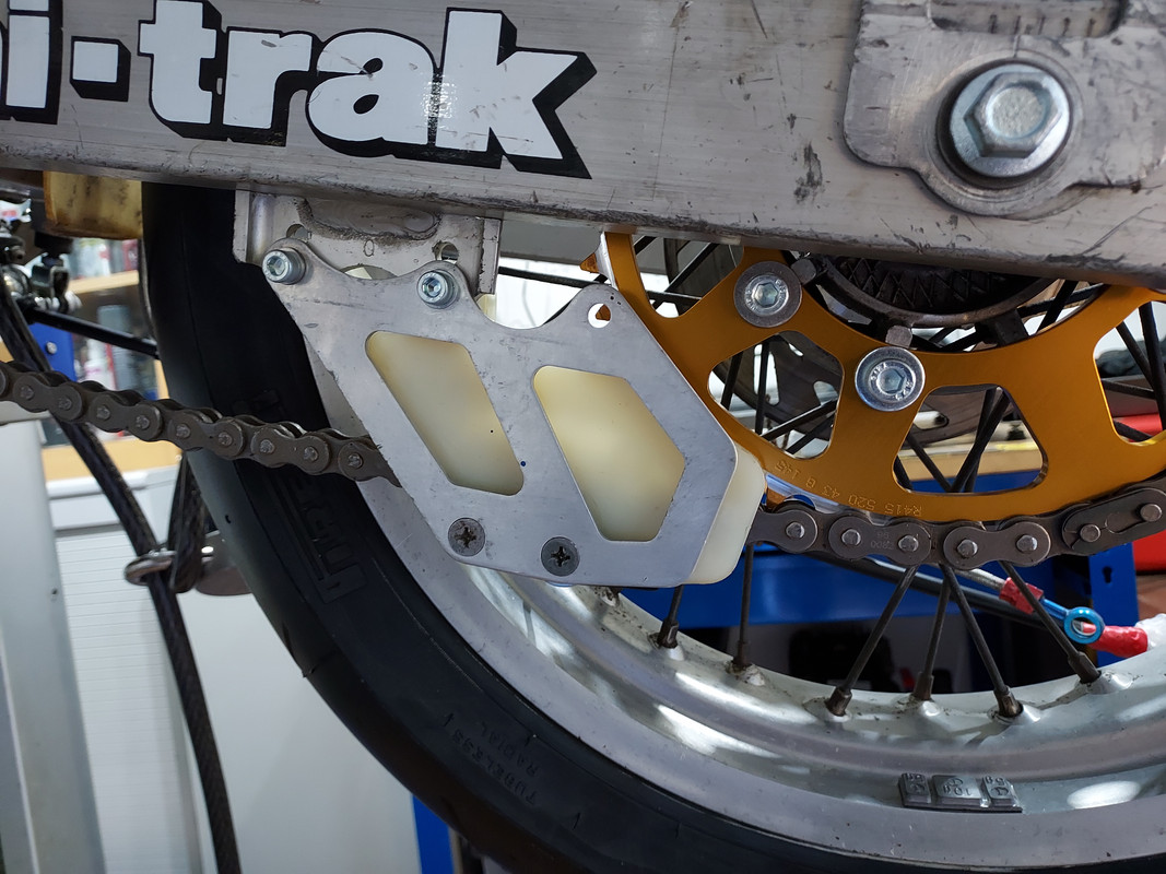

Re: The 10+ year KX500 rebuild thread
Picked up a CR500 swingarm at Kempton for a tenner. I only wanted the chain guide. Had to take off a 4mm notch of the nylon with the dremmel to align it properly, but it fits.
