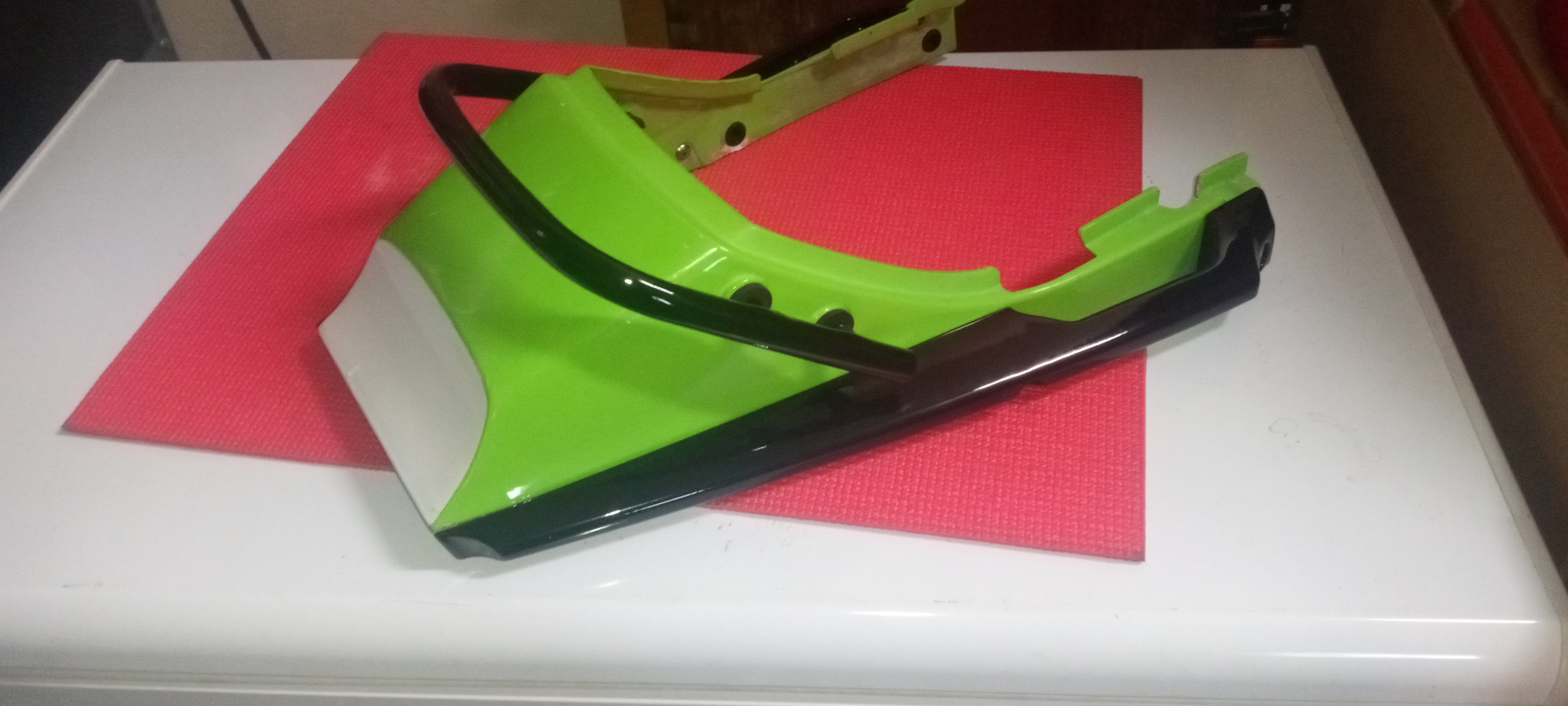

In other news.. Progress!!
Ok, I cheated a bit, the metal sleeves that fit inside the rubber grommets for the grab rail are sitting in the Evaporust right now, so it's not bolted on...
and there are still two small cracks to fix in the tail doodad.

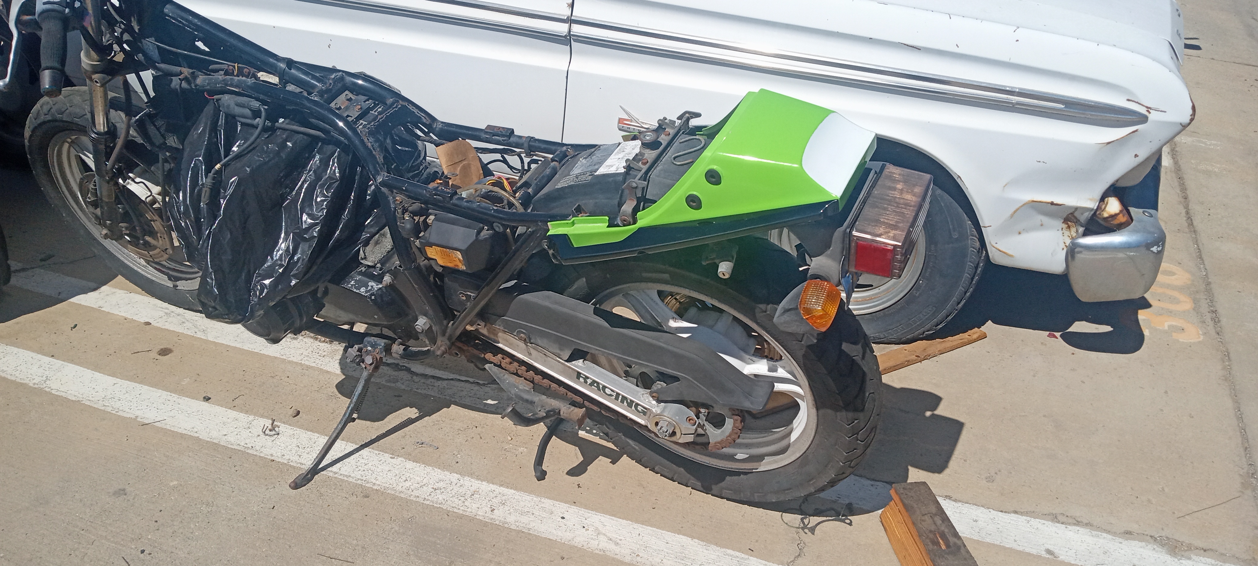

Put the tail on for a pic..
Put the tail back in the car

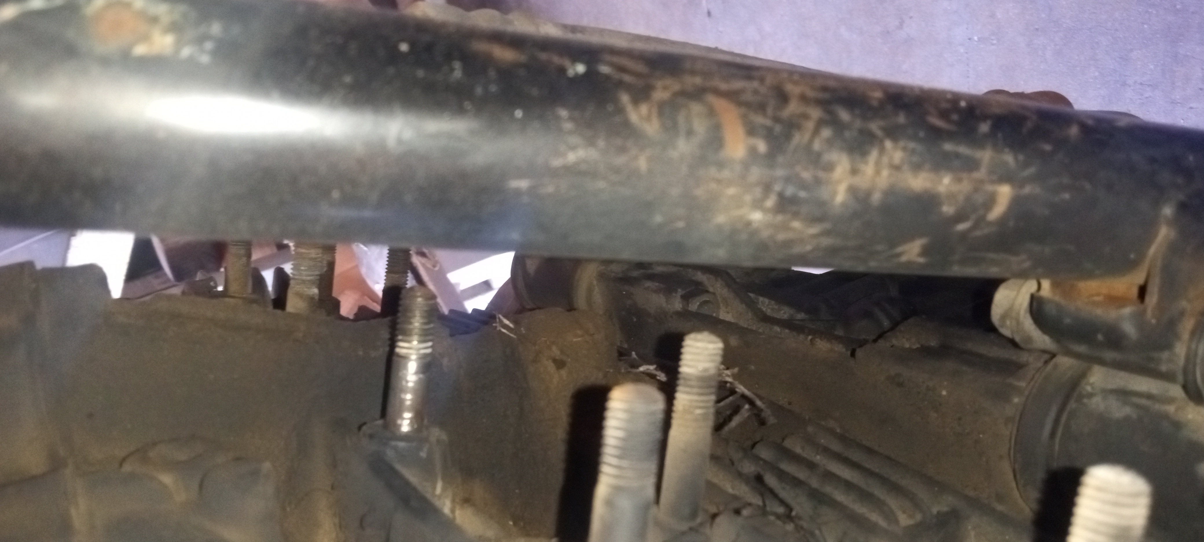

Installed the stud that came out with the nut when I took the exhaust off.
Installed ignition cover
Discover the manifolds don't fit...The engine side is the right size, the carb side is the right size, but the fucking holes for the M6 Allens that bolt it to the head are too far apart...
Came home.
So now I need to drive out to APE in Rosamond next week & see if they have the right manifolds. Probably keep the wrong ones because they will fit other Kaw heads.

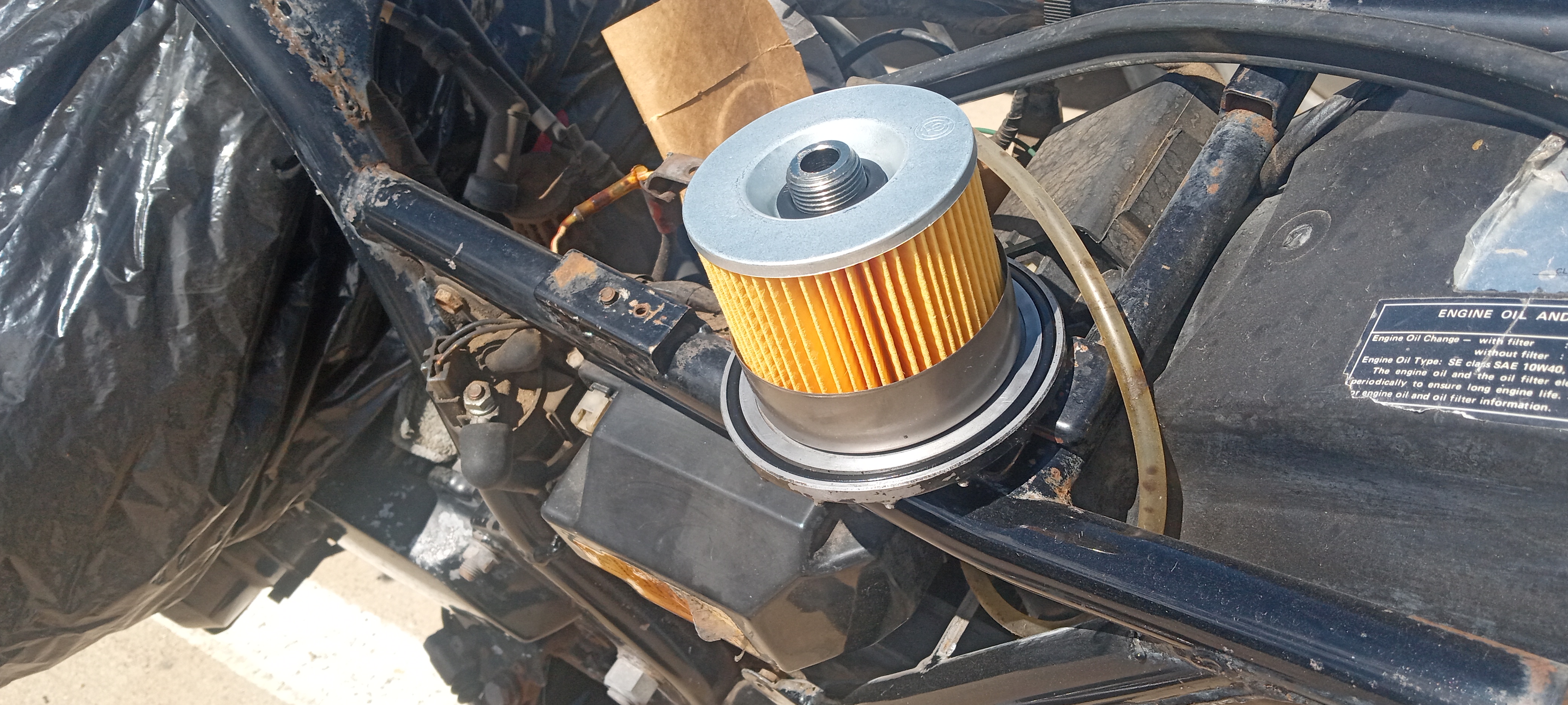

& Yes, the oil filter gubbins is assembled correctly.
Most Kaw's are: plate, spring, washer, filter, cup
These are: plate, cup, spring, washer, filter.
