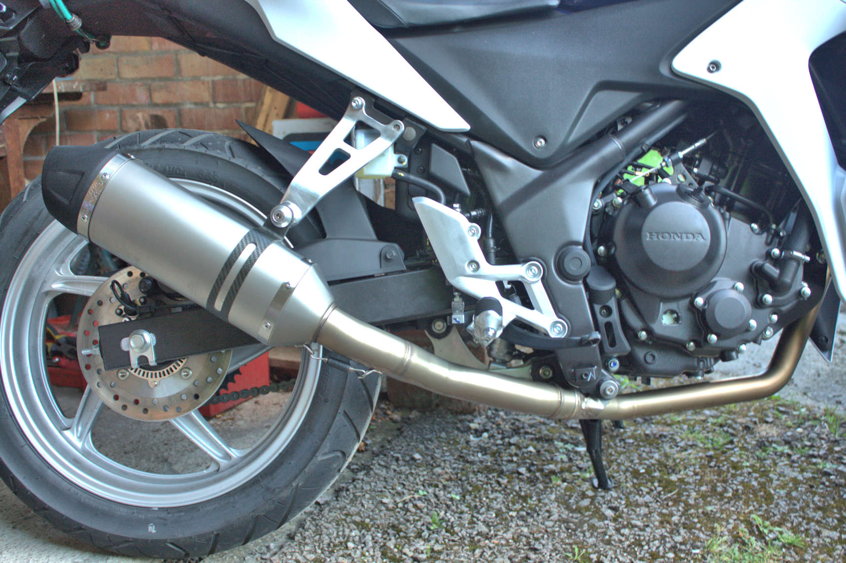

Finally the biggest news for this post: a new exhaust.
It's a used item from a breaker in Poland of all places. 150€ not the cheapest but it looked decent and gpr is a reasonable brand. It is, predictably when you realise the volume of the can, a bit louder than I'd like.
Here's a video with a few seconds running with a catalyst from a KTM dirt bike shoved between the link pipe and the silencer, then just as it comes with the dB killer in the outlet.
You can definitely hear a difference, albeit you may need headphones and or to visit my garage to hear it clearly.
The catalyst is maybe an inch too long so I'll look at cutting it down to size. But for now, I'm rocking it like it is. Brraaaapppp

I also fitted up a Quill silencer with an AliExpress link pipe, and added a KTM dirt bike catalyst between the two.
I still need a 55mm clamp to hold the silencer to the link pipe, but the fitment looks good to me.
Well, except for the fact I don't have the correct strap for the Quill. Quill make their oval cans 104mm*137mm, or they did back then, which means you need a longer strap. I don't have one. I'll figure it out... but for now that spacer will do, I just need to find a longer bolt.
Sounds good; less raucous than the GPR.

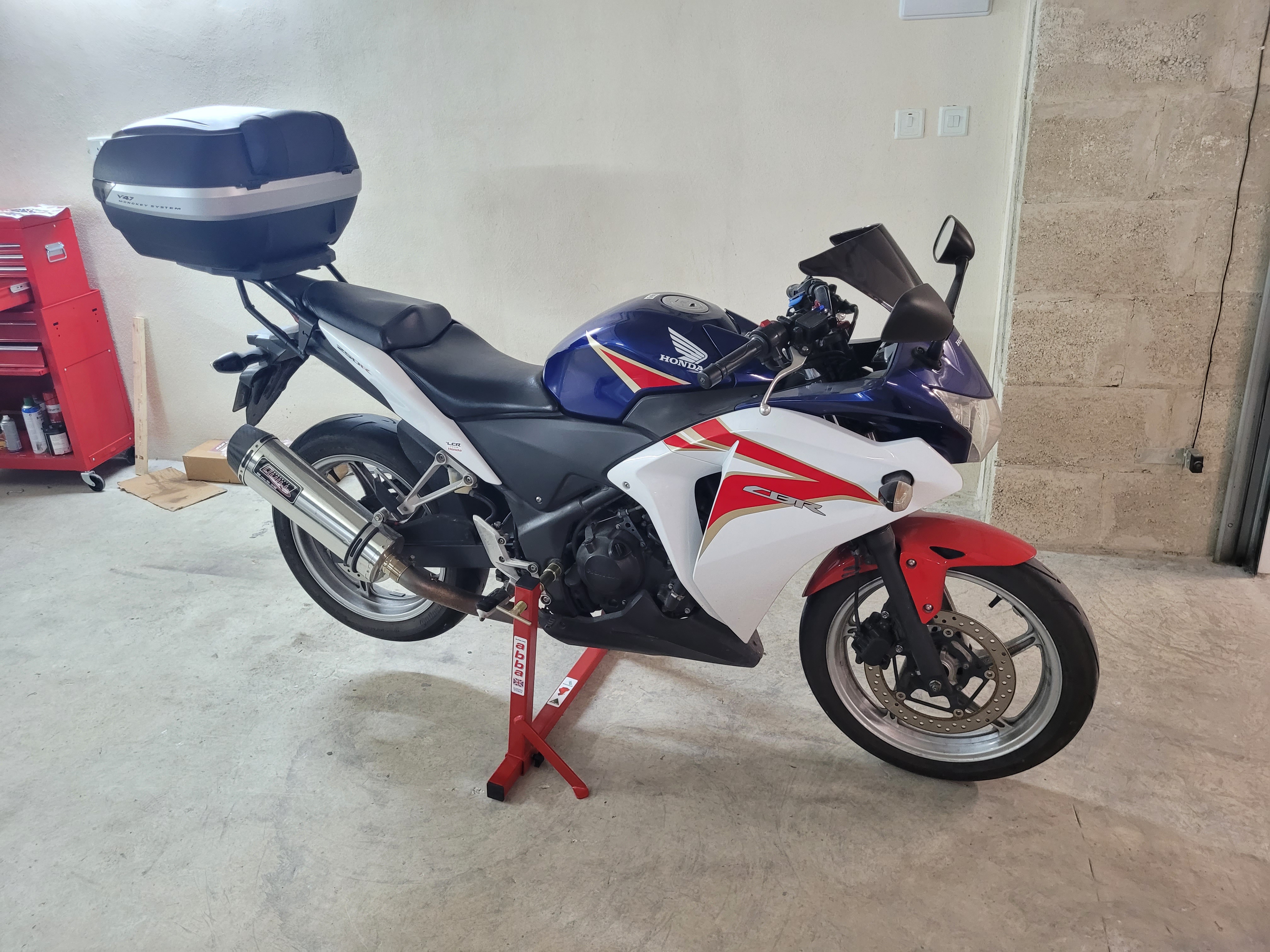

It's been a while since I updated this thread, but the little CBR has been ridden 4 days a week most weeks in the meantime, without any signs of trouble.
The fz6s has now been pushed out, and the CBR is my main and only squeeze. So, time to tinker!

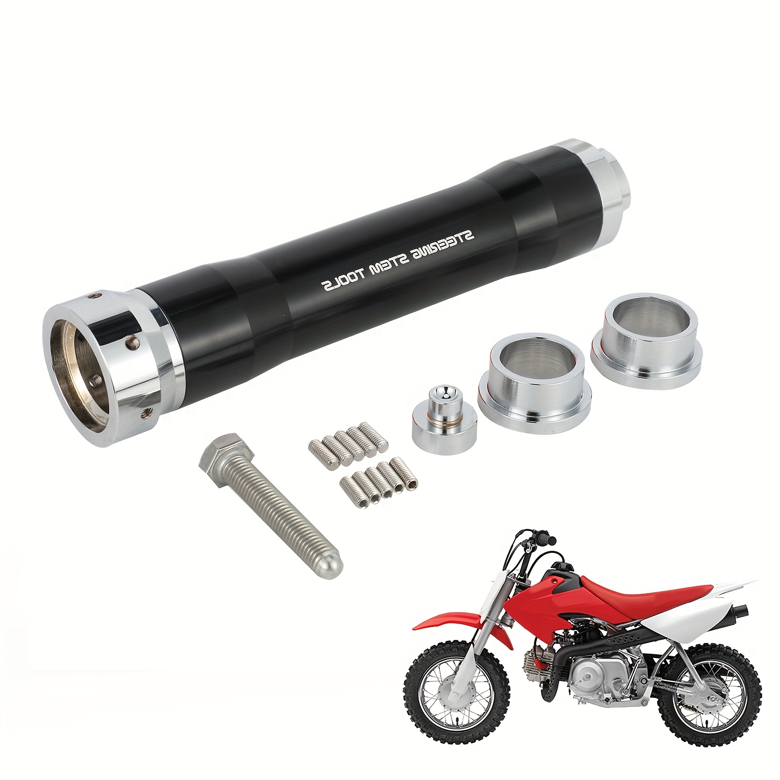

The neck bearings needed sorting out, and as there's no centre stand fitted nor available I finally (after many many years of thinking they are a brilliant idea) bit the bullet and bought (a half share in) an ABBA stand.
With the front lifting bar and bike specific adapter, it made quick work of the neck bearings, well relatively anyway.
We'll eventually get around to using it on Jules's VFR800X, to free up the rear hub adjuster.

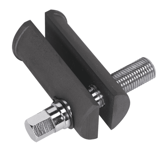

I bought some tools from TEMU for the job, that was my first ever purchase direct from the motherland.
This one is a drift which locks in behind the bearing cup, but it's only really useful where you can get behind the bearing.
It helped, but only so-so, as it couldn't really lock behind the bearing cup. Still, it was a lot better than a long screwdriver in this case.
I think the other kind might be more useful for a lot of bikes including my CBR.
I also got one of these, which is a copy of a motion pro tool.
It can't help remove OEM ball bearing cups off the lower yoke, but it'll have taper bearing cups off in a jiffy with those grub screws locking on and a forcing screw to pull it off. Then you have a nice solid drift to hit or press the new bearing on with.

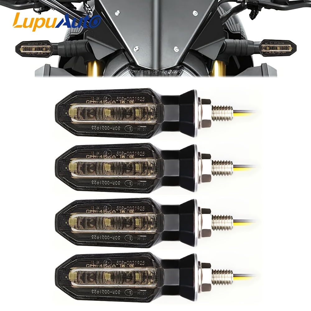

I never really liked the OEM indicators, plus one of the rear ones was a bit bent in such a way I couldn't bend it back.
Amber bulbs behind clear plastic just don't do it for me.
So I bought some of this type from China.
But they were very dim, perhaps 5w equivalent. Also at the front the stalk wasn't long enough to clear an indentation in the fairing, meaning it barely stuck out in the breeze. So that was a swing and a miss.
Again from China this time via eBay I think, some replica CBR500 indicators.
A little smaller, and with smoked lenses this time.
Looks nice!
But as it turns out, when you buy cheap, you get cheap.
The bulbs were meant to be 21w, but they were marked 10w. Even then 2 of 4 were lower than that, as they caused hyper-flash with a 10w "analog" relay. I decided to try and fit the bulb holders from the OEM indicators to use those 21w bulbs, but they wouldn't fit. It was then I realised that the replica's ground wire was just bare wire wrapped around the bulb spring. Also the nuts were 17mm instead of 14mm, and the threads were drilled off-centre. The lenses weren't a great fit, but as the bodies had no drain hole and the lens gasket was missing, water would be able to get in but not out again.
The lenses skipped the metal spacers of the originals, and also had thinner plastic, so they were already cracked on installation.
Here's a comparison, and a reminder why you have to be careful with Chinesium, if you're going to risk it at all.
Solution? A set of used OEM Grom indicators.
Orange lenses are a style choice I guess, but at least they won't cause fuses to pop or fires to start.
It's also given me 3-wire front indicators so I could, at least in theory, eventually fit some running lights in there.
Looks nice!

Then it was back to the exhaust.
When I bought the Quill pipe that's on there now, I thought it was going to be a T3 silencer with clever non-removable baffles like I had on a 400 back in the day, but it's an Evo2 which is just a basic race can, albeit a bit bigger so it sounds slightly smoother. I also didn't get the correct hanging strap with it, which is shown up there in some pics hosted on imgur (honest).
So when a T3 in good condition came up on eBay, I grabbed it. Even if it had a 54mm inlet cap. Figure that out later...
I got the correct strap and it fits both cans, so at least that's a win.
Fitting the new silencer itself is a bit more tricky.
I also have a link pipe from GPR with a 54mm slip-on connection, which I hoped would fit the new Quill with 54mm connection. And it kinda did:
Enough for me to run the bike and hear it; it's quieter than the shiny one I think, but still pretty loud without a catalyst as that is for a 51mm connection and just flops about in the 54mm connection space.
But, the GPR silencer is very small and this one's very big, and it's not possible to get clearance to the swingarm.
I have a link pipe from China with a 2" slip-on connection, I've shimmed that to meet my 52mm Quill. I'm thinking maybe get a 50mm to 55mm graphite gasket for use as a shim, but I don't know how durable they are, and it would need some scraping which sounds like a messy job and hard to end up with it still being round.
Or perhaps a 51mm to 54mm converter?
I'm just not sure how much length that would add to the whole assembly, considering the exhaust already kinda makes the bike look like it's wearing its dad's shoes.
TBC - we'll figure it out

Re: CB"R" 250
Here is mine ( about 14 years ago) with Leo Vince.
Quiet and more or less legal at the time.
Bracket from scrap bin has two bolts and a dowel so is fully constrained! ( Original had pillion footrest). I was a bit obsessive about getting more out of the engine but in the end swapped it for a Duke 390 and that was far less civilized.
