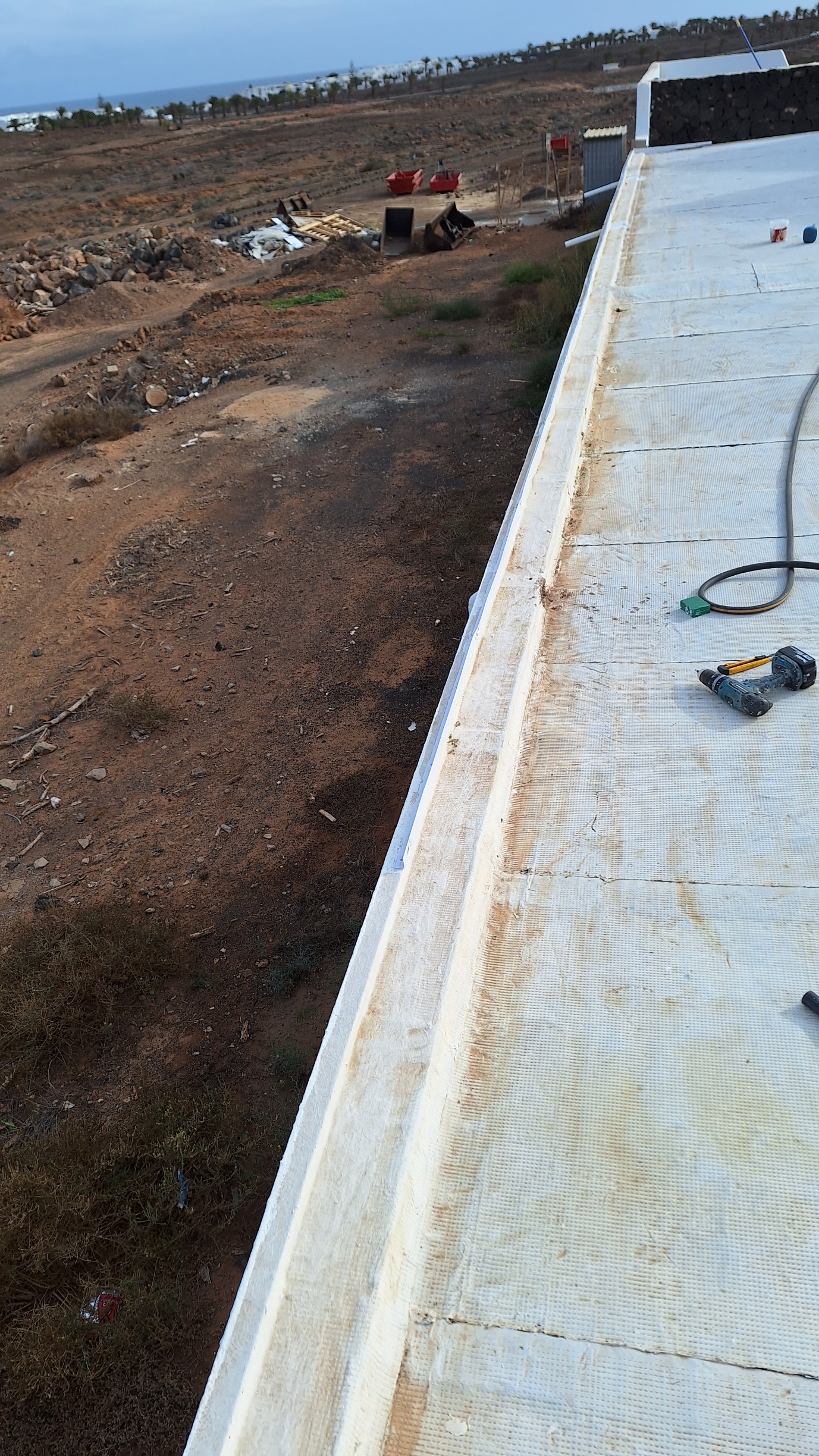

Yorick wrote: Wed Dec 06, 2023 1:47 pm Gonna give roof a day to dry out.
The lip on the outside wall wasn't high enough so in big rains, it overflowed onto outside wall. Making it filthy, but more importantly, damp came into garage.
I put on 25mm batons, but still went over.
So been advised to use these 20mm x 25mm plastic angles as well.
What's the diameter of that outlet and how many of them are there?
That one's about 30mm. Other 2 are about 20mm.

I'm no expert but seems small given the outlet size of "normal" downpipes. But it might explain why it backs up so much? And possibly blocks relatively easily? Roof coverings are much more likely to show signs of failure if you've effectively got a lake up there. (Guess who's also recently had roof problems? :) )

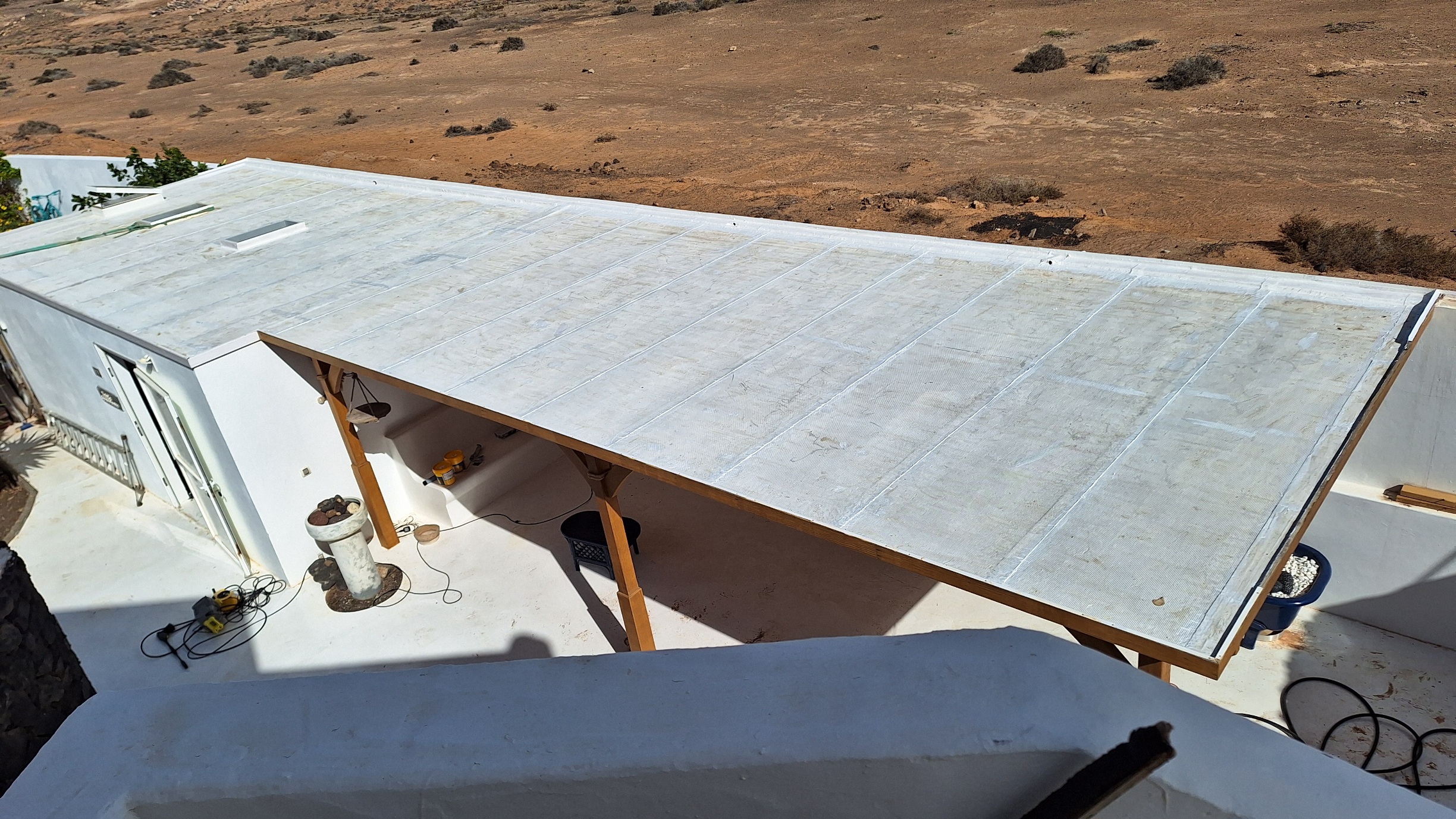

Ran out, 3 short. Forgot the pergola is 11m. Garage is only 8m, which I doubled

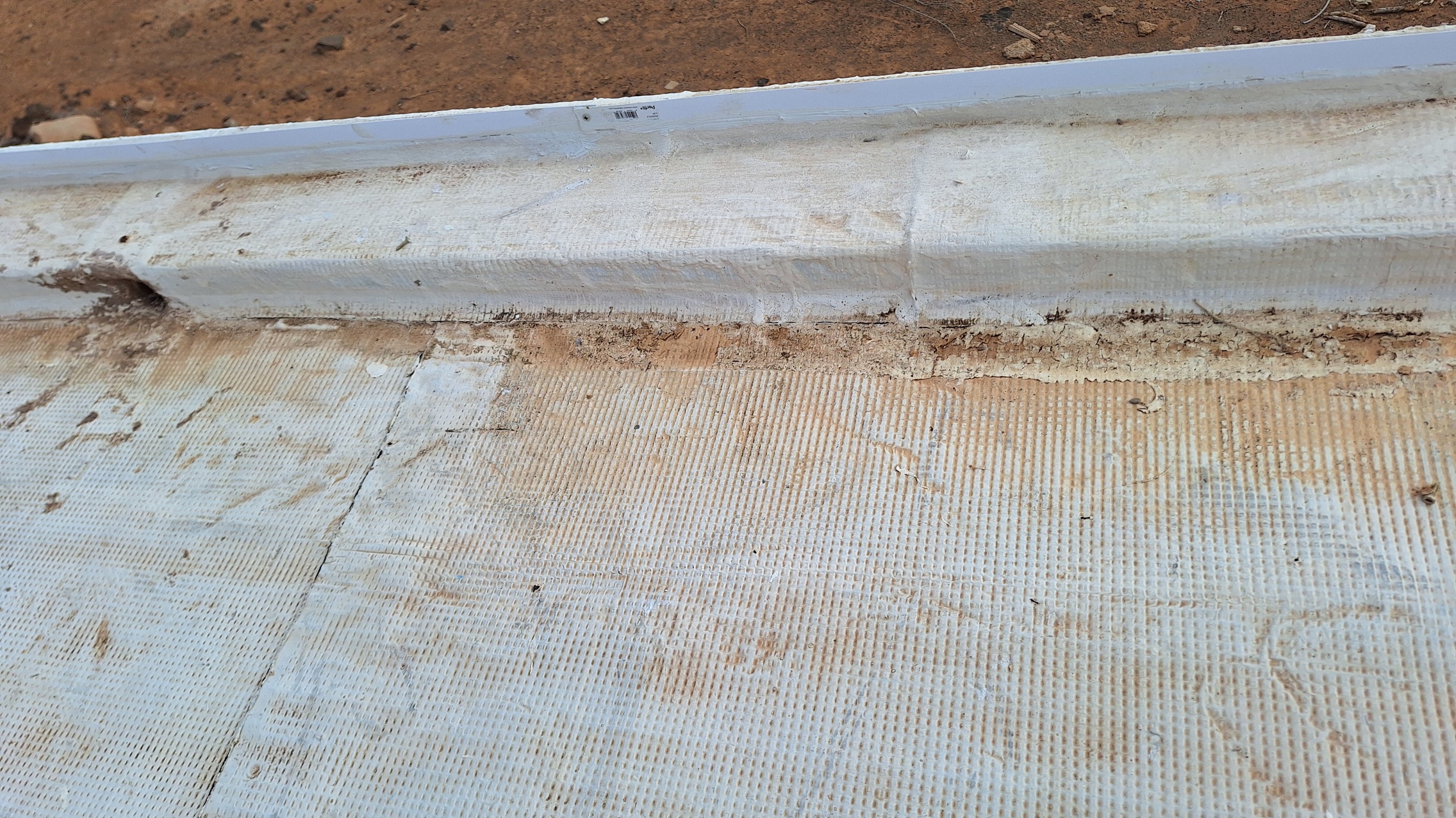

Can't change the outlets, but they're clear on the drop, so no blockages.
The covering has suffered a bit where the water dregs linger. Gonna give it a good coating.

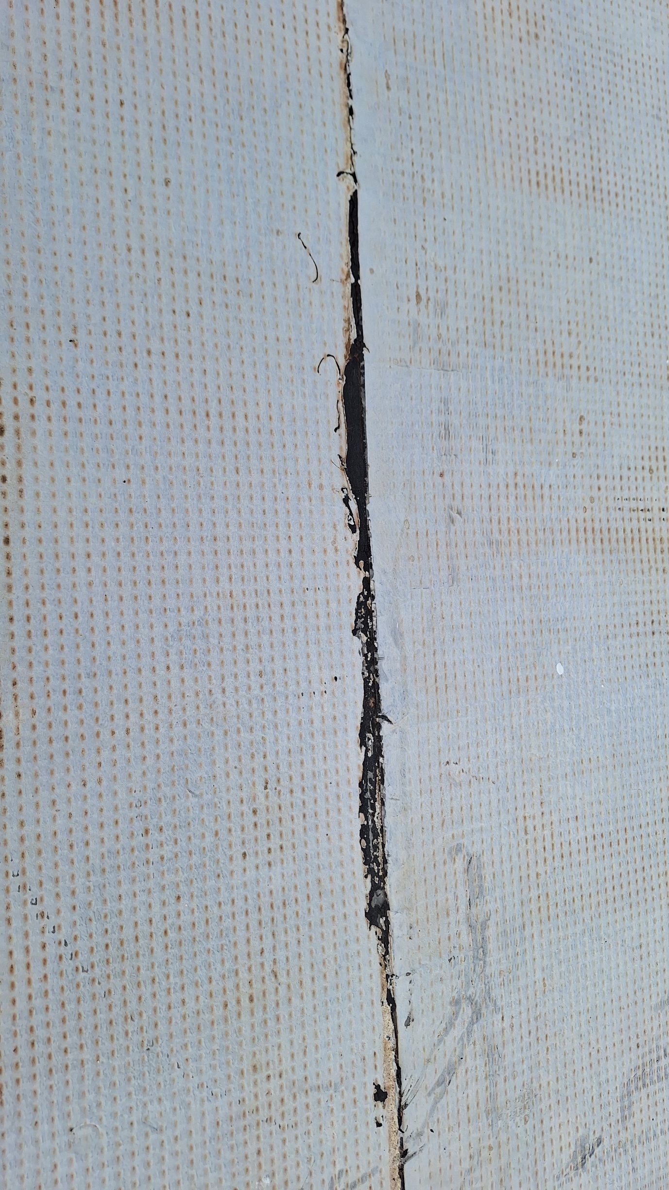

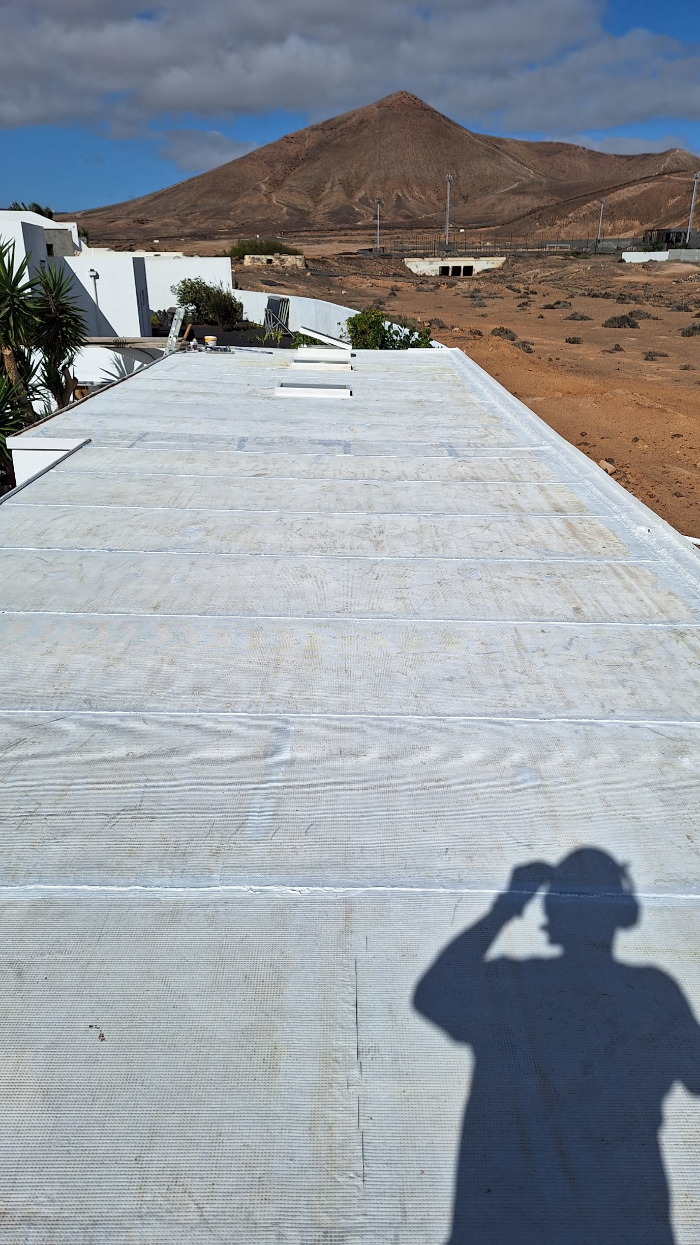

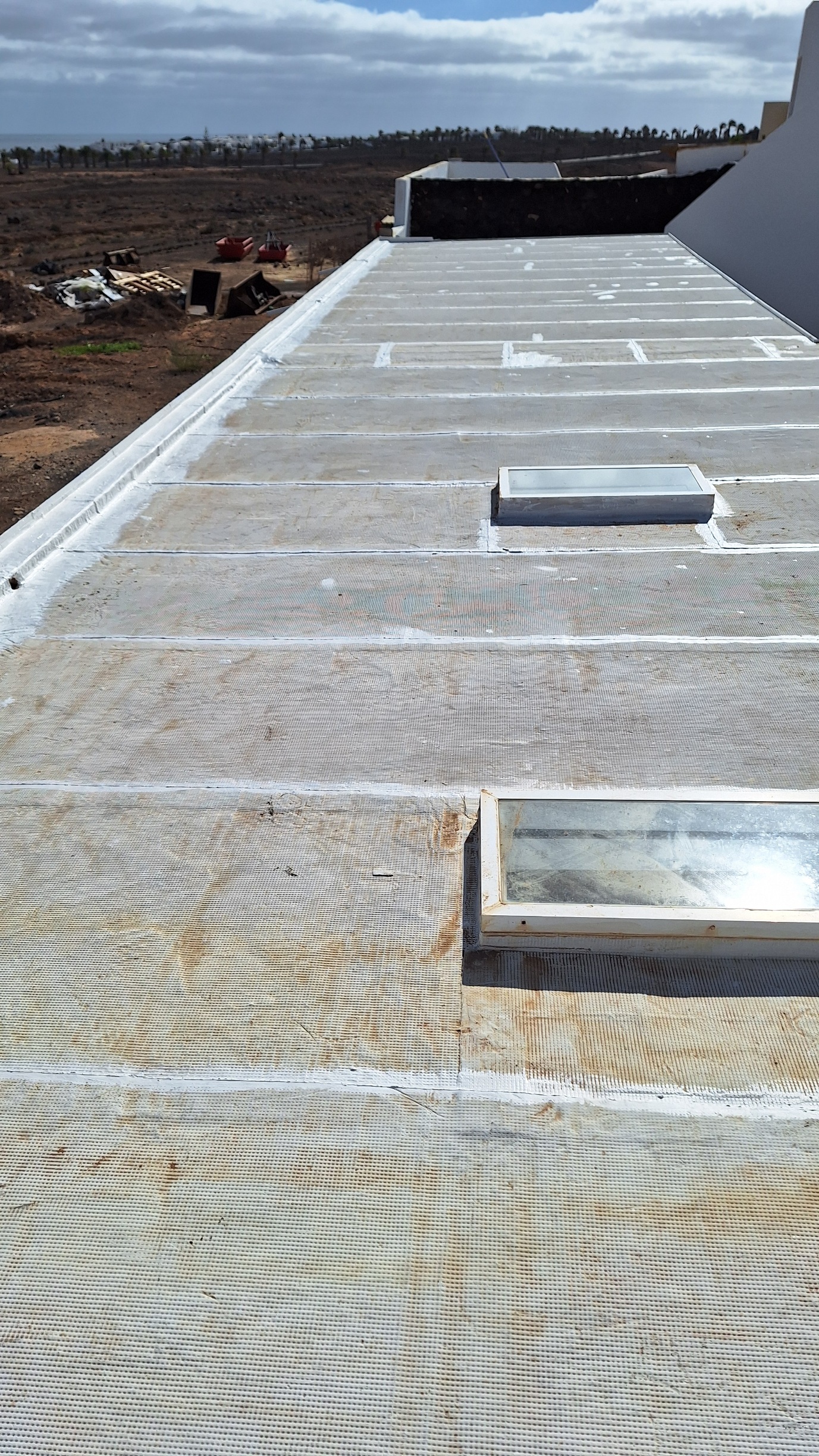

Some of the seams need flattening/trimming before I start.
And need to get the trusty Makita 18v sander on the gulley.

Fark. That was tough. Kneeling and squatting made my old legs ache.
That's the seams done. Too windy to do the patching with the tissue paper stuff. Will just blow away :D

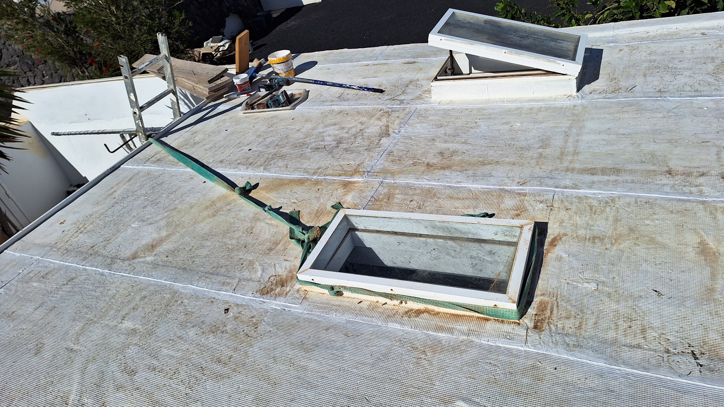

I'm shit scared of heights and freeze when getting onto ladders. So I've tied it off to the roof light ;)

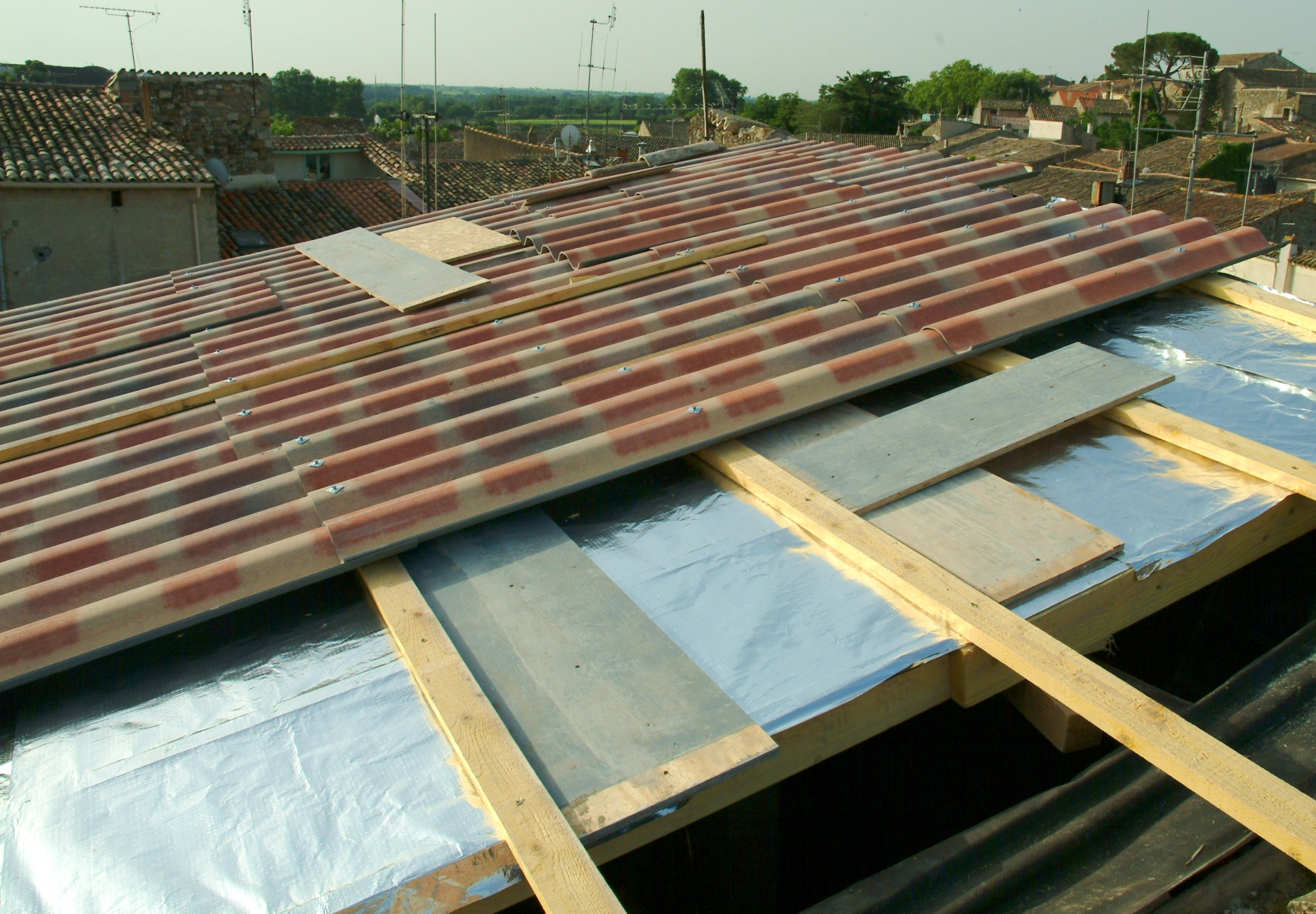

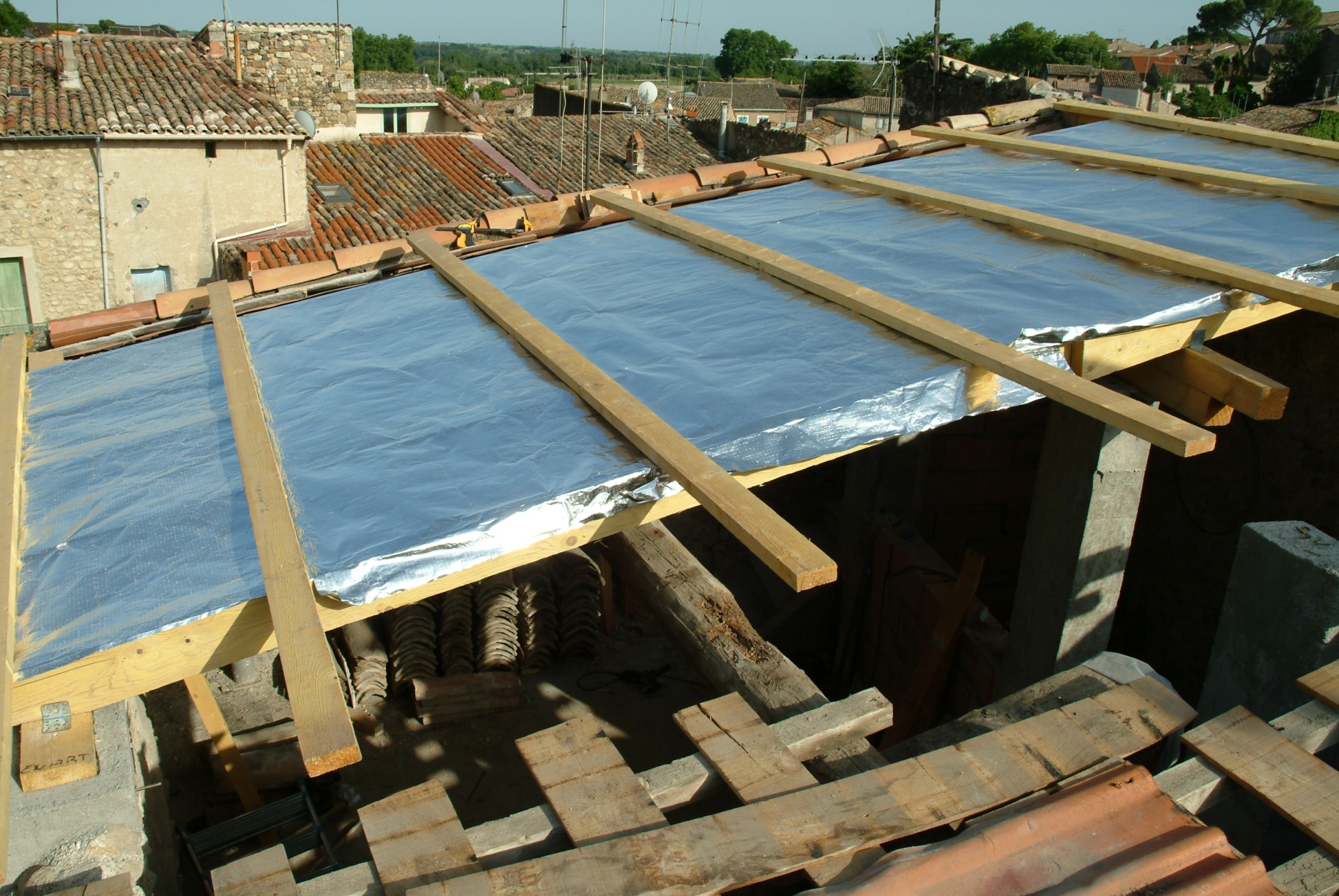

About 15 years ago we put a new roof on one side of the gaff in France. Instead of using roofing felt (as was done in the UK) we chose a reflective roof lining to combat the heat from the sun. What we hadn't reckoned with was the blinding reflection from the lining and the amount of heat it reflected when we were working near it. Thankfully most of the weather was unseasonably cloudy and cool while we were doing it, otherwise we'd have been in real trouble.
This was the stuff we were using instead of felt:
And this was the roof with the roofing sheets on top of the reflective lining:

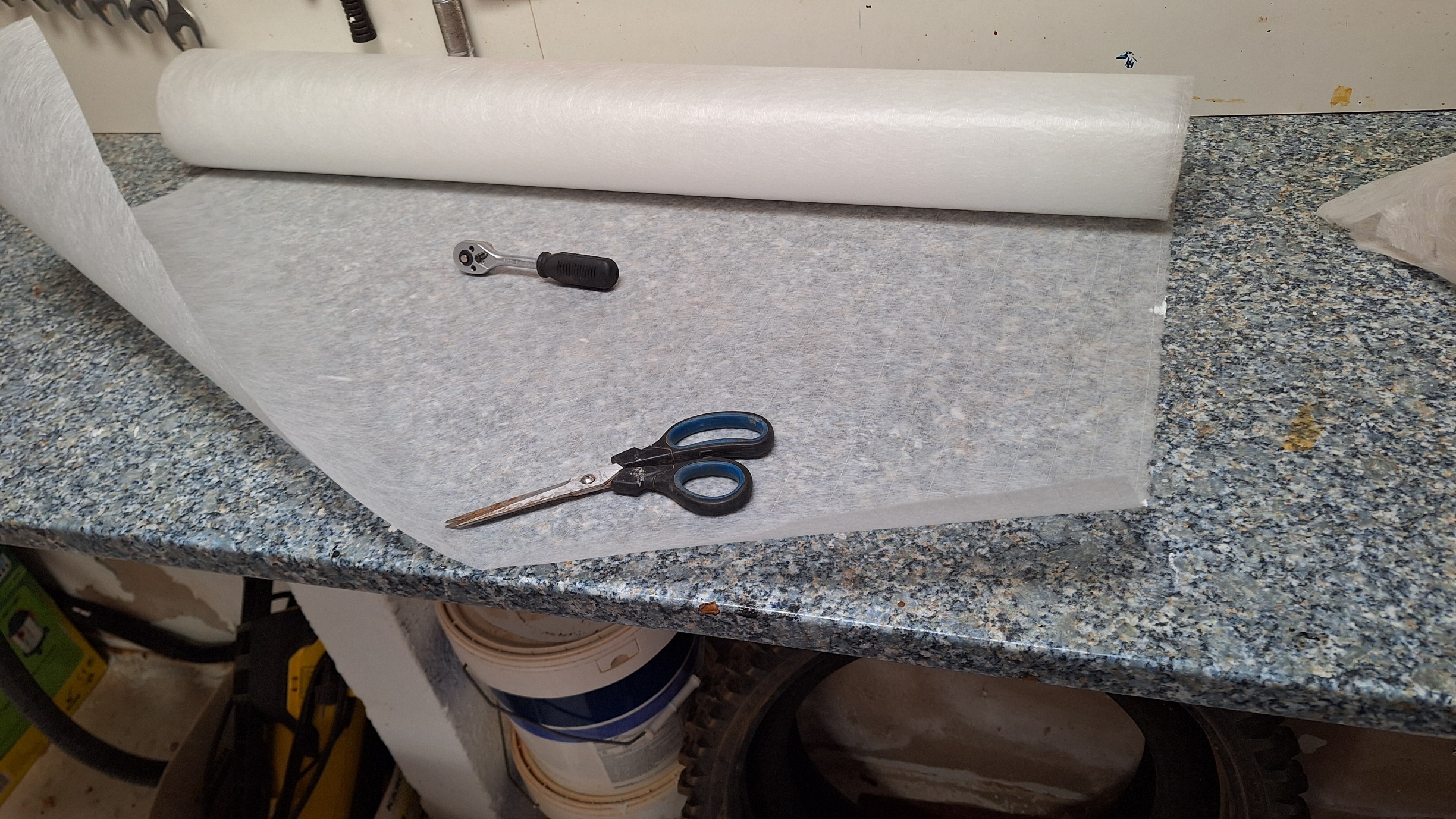

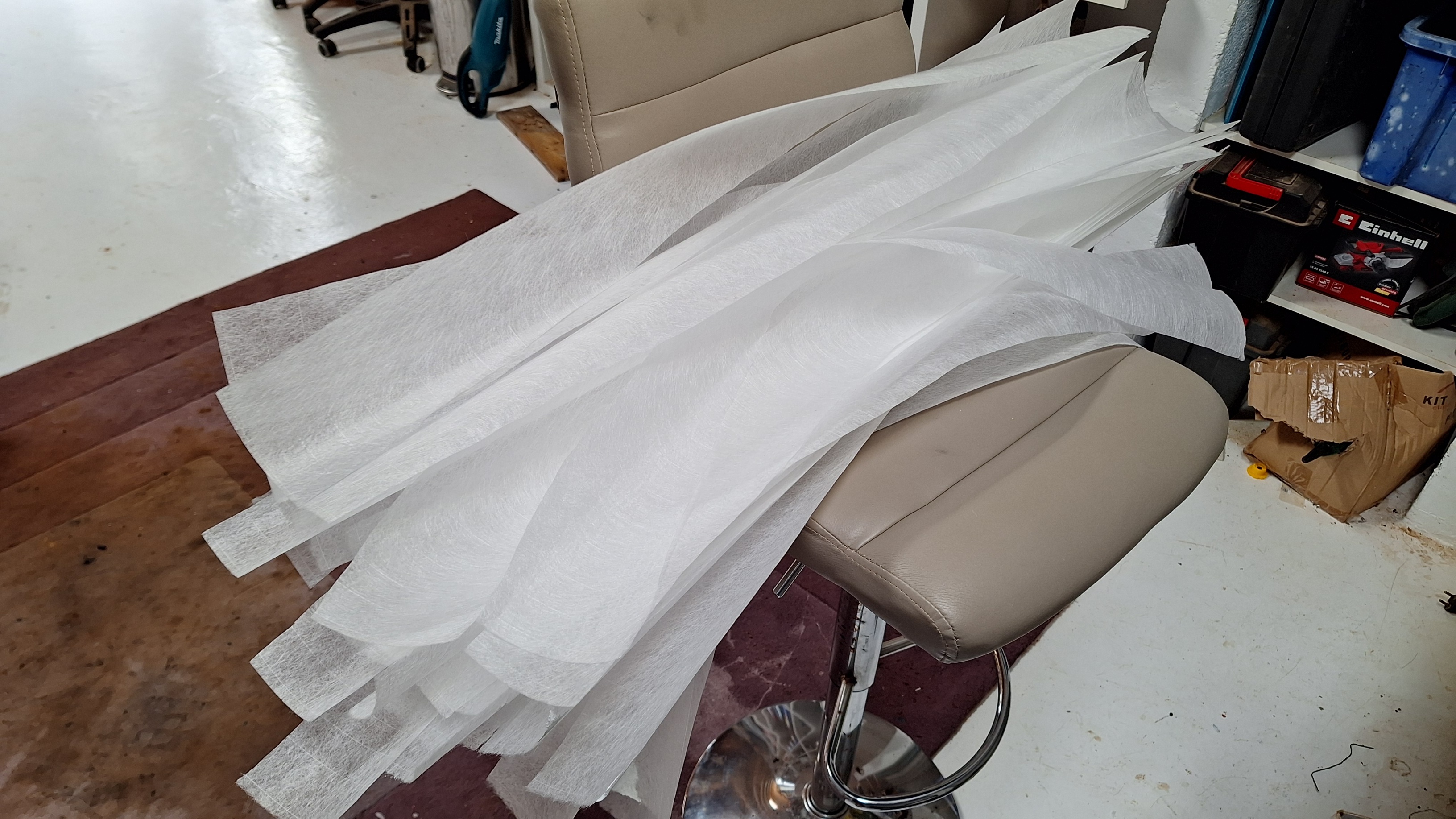

Cooler hazy day forecast so early start.
Had to cut 50 strips of the mesh stuffs.
Achey fingers now
