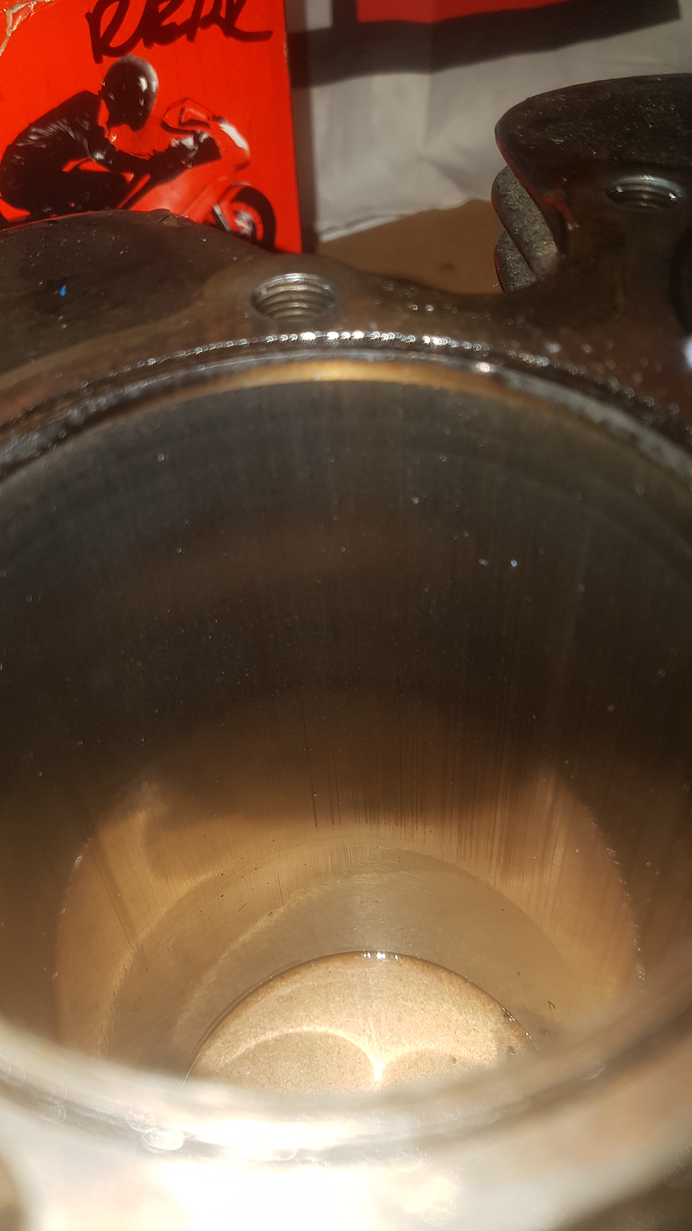

I took the cylinders off today and nothing fell in the casing, hooray!
The pistons have got definite marks on front and back...
And the bores look mirror shiny. There's a distinct step in the last milimeter or so at the top with loads of thoroughly baked on stuff. On closer inspection the bores have lots of vertical lines which you can see but you can't feel....
The rods have a little bit of rock on the bottom end. I dunno how much is OK. You'd expect plain bearings to have a bit of clearance....
So yeah...rebore/rehone and new pistons required!

You can’t tell from “rock” on the rods.
It’s straight up and down play that betrays wear.
And that isn’t easy to feel unless it’s very bad.
If it has an oil pressure light, did it ever come on at idle when the engine was hot? That would probably mean worn big ends. Maybe you never got the engine hot though.
That piston skirt looks ok, just looks like a used piston.
The scratched bores are odd. Maybe the pistons aren’t as old as the bores.
You get vertical scratches on the bore when honing grit has not been washed off properly. It requires hot water and soap and a sponge and you keep washing and rinsing until the bore does not leave a dirty mark on a paper handkerchief.
There’s a strange tidemark near the bottom of the bore. Could it have been parked so long it rusted?

Re: Classic Triumph Bonneville
I think the tide marks are just from the flash on my camera reflecting from the bore. They're like mirrors.
It's entirely possible the pistons are newer than the bore, the bike had high compression pistons but these are "medium" 9:1. I believe by FiL turned the compression down cause he couldn't kick it at 11:1.
Oil pressure is fine, pretty steady at 70psi (or is it 90?
whatever the spec is) across the whole temperature range. It has no oil in the sump.

I think the spec is 60 psi. If it’s holding that oil pressure once warm, and it still has a plunger type oil pump, the big ends can’t be worn. Triumph 650 big ends don’t really wear at all anyway, unless something goes wrong with their oil supply.
I suspected the bore photo would be a bit illusory. They often are!
But if it’s like a mirror, a coarse hone and new rings are probably on the cards, if the bores measure up ok. I see measuring bores as an expert’s job and I let the rebore guy do it.

The head is going to a specialist machine shop, they also do rebores so I'll give it to them. I don't actually know if it's been rebored before so I'll let them tell me what size rings I need.

The head has been delivered to the specialist and they're gonna weld/remachine the guide holes and press in new bits. The valves are pretty good, but I'll need new springs cause they're all mismatched.
The same lot are now gonna also re-hone or bore AND hone the cylinders, depending on what needs doing. I'll buy new pistons once I know what size the bore is gonna be.
Dropping off the cylinders next week.
I'm also gonna repaint the cylinders with high temp black. I need to get a tappet block removal tool first though.

You may find they have left washing honing grit off the bores to you.
