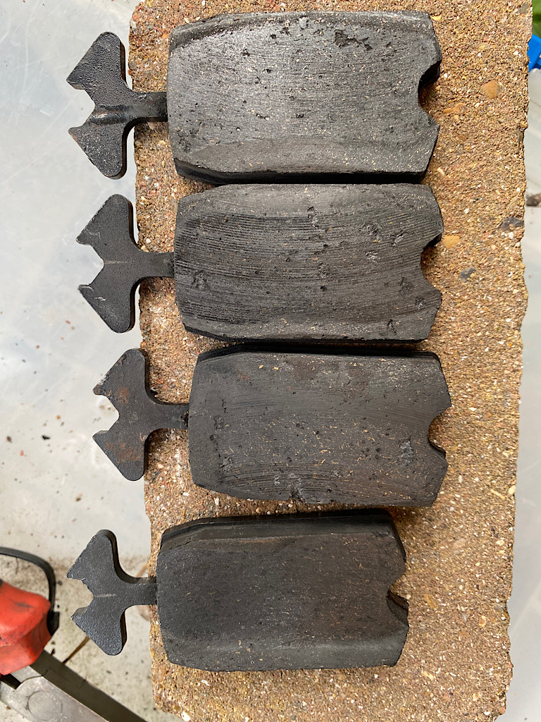

I found out what the problem was with the brakes. New discs had been fitted but I guess new pads weren’t available so the old ones were refitted. To be fair they looked virtually new but they were no longer flat due to the worn old discs I guess. Anyway, I set of new pads have sorted the problem and I also adjusted the rear shoes so the brakes are excellent now. There was no sign that the pistons in the callipers were sticking and it all looks virtually new. You can see from the pads that the third from top wasn’t touching the disc in the centre of the pad.

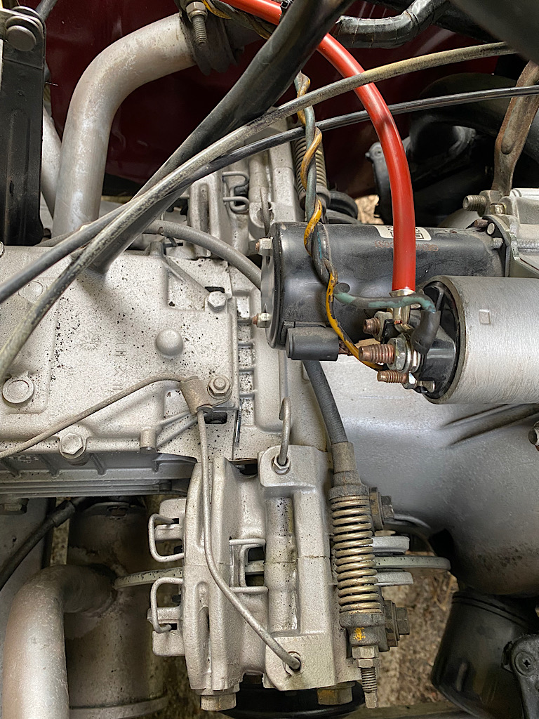

The whole thing looks incredibly clean. You can see how the brakes are placed inboard bolted to the gearbox and are therefore sprung weight…
It also means you can change the pads In a couple of minutes, tops.

I'm guessing those two big springs are something to do with the handbrake? So the parking brake also grips on those discs.

Mr. Dazzle wrote: Wed Jul 26, 2023 7:14 am I'm guessing those two big springs are something to do with the handbrake? So the parking brake also grips on those discs.
Yes, they return the handbrake from the disc. The handbrake pads are small discs that fit in the arms that the cable and those springs attach to.

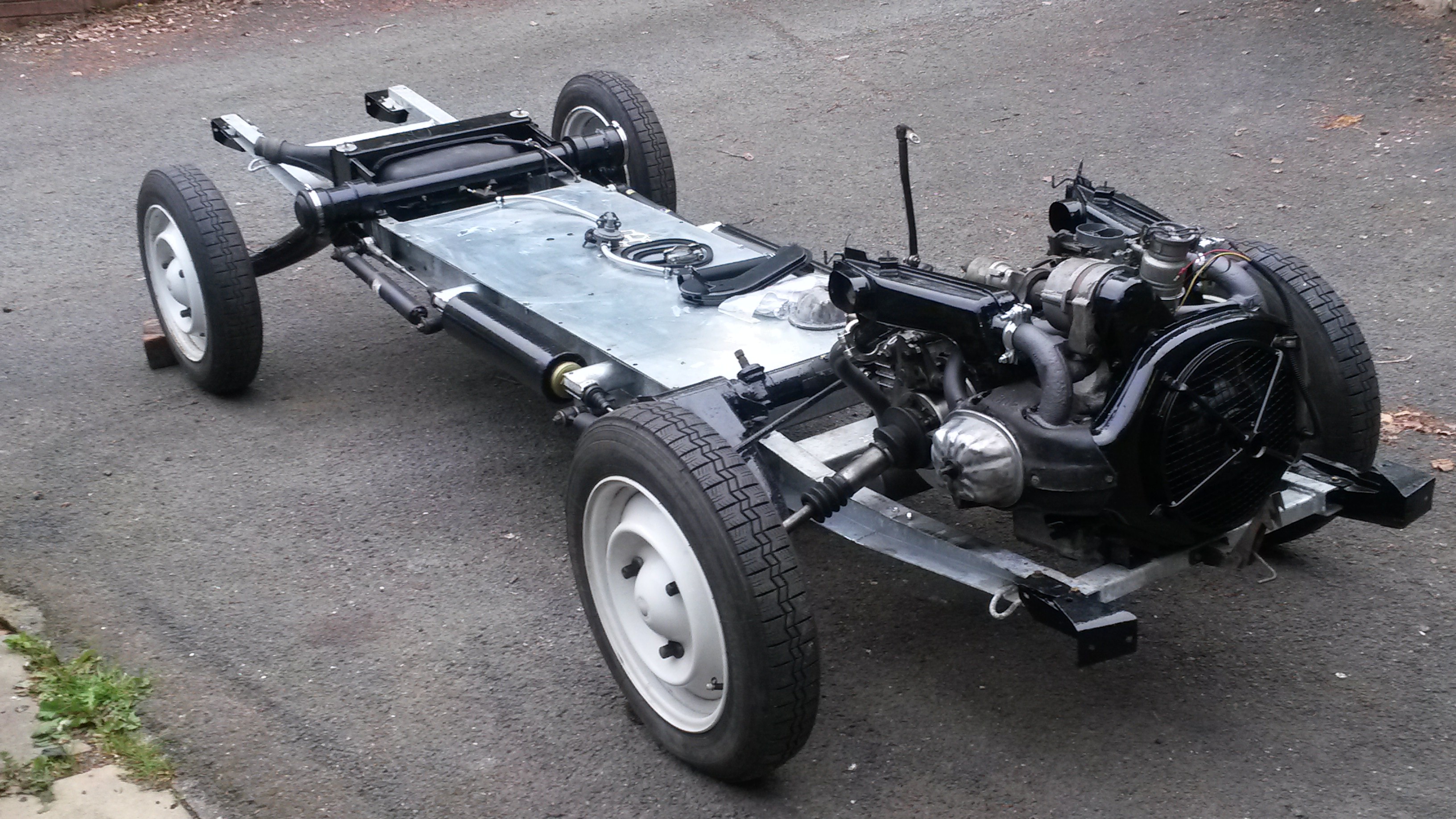

You have. I think it might be tricky to be honest. If you took a fwd engine and used the gearbox I don't think that it would fit transversely in the engine bay and I don't think you'd have long enough driveshafts to allow the suspension to fully articulate if you were to use the current forward 'trailing' arm arrangement. If you were to change the suspension I'm not sure where you'd hang it off as there's no monocoque to attach uprights to.
This is the way the chassis and engine look without the bodywork...
2cv chassis.jpeg (1.27 MiB) Viewed 1563 times
There's no structure in the bodywork as such that would help with engine/suspension mounting.
You could install the engine lengthways but the engine isn't very long and it would probably stick out the front. It would also put an awful lot of weight out the front that would make it really badly understeer.
It's a cool idea but packaging will be the issue.

dern wrote: Wed Jul 26, 2023 2:47 pm This is the way the chassis and engine look without the bodywork...
I swear that looks just lilke an 80s Tamiya RC car chassis!
