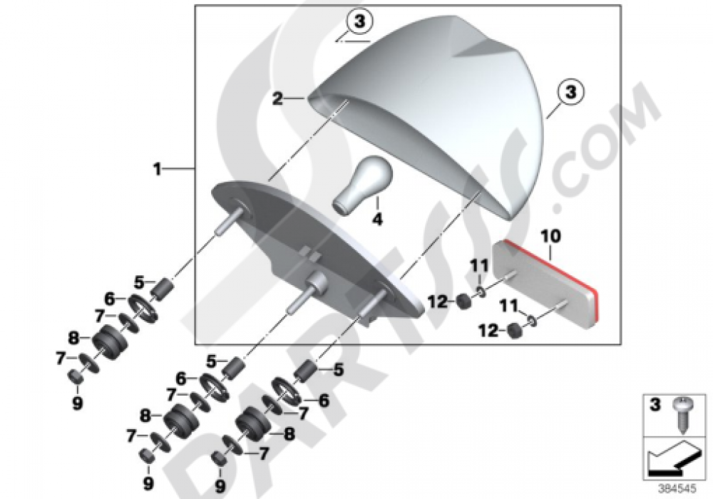

I had it apart a few weekends ago.
There are 3x M6 studs coming out the brake light, spacers #5 go inside rubber grommets #8, with a washer #7 on either side, then nut #9 secures that to the plastic tray.
Part #6 is some kind of split plastic washer, I guess it's to soften the edge of the plastic. Can't remember seeing it on mine but then I didn't know it was meant to be there so I wasn't looking for it.
There's two problems with the assembly. First is that the rubbers are sort of hollow, and so allow too much movement. You can see it on this one: https://www.ebay.co.uk/itm/272576358562
Second is that the whole lot is bolted through a plastic part, which itself flexes. I'll replace those washers first since they're no good anyway plus one is split on my bike. Probably that'll be ok, if not I'll look into mounting it from something more solid.
The commonly suggested fix is to add spacers such as M10 washers over the spacers to compress the rubbers more or grind the spacers shorter, but where the rubbers are hollow, there's limited success to be had there.
