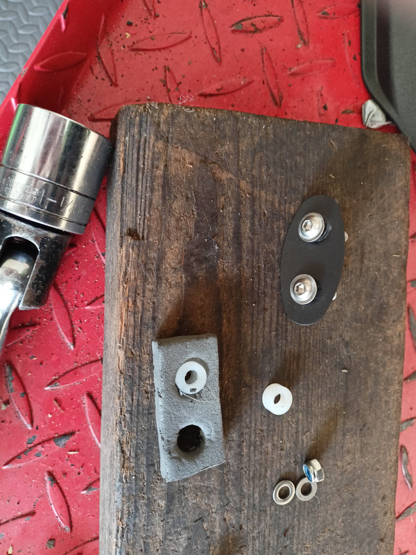

Re: NBT- I've gone Green!!
Is a good question- it looks to me like a shitty casting or pressing mark , don't think it was a crack but I wouldn't bet that it wasn't!BBB wrote: Mon Mar 07, 2022 10:20 pm Is that a crack through the brembo racing text on the copy lever or is supposed to be there?

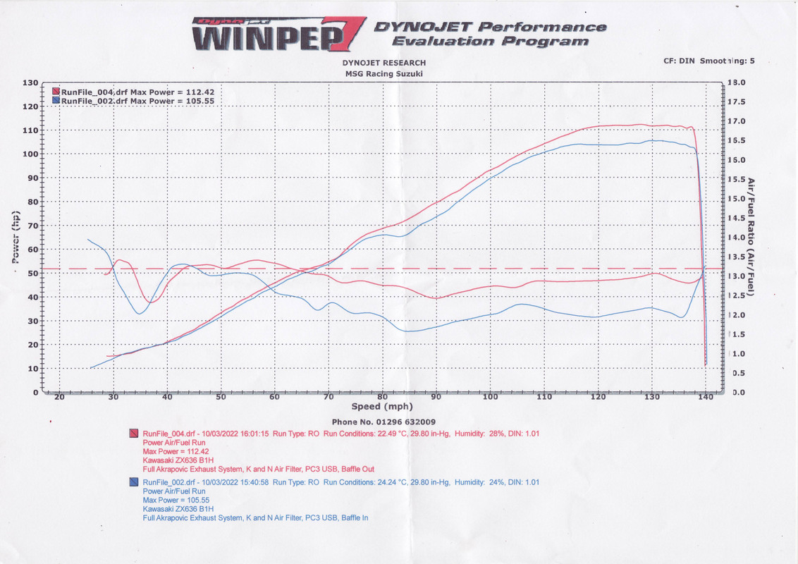

I stopped in at MSG Racing on the way home to see if Gav could fit me in for an hour or two on the dyno before it goes next week to get a view on power and whether any tweaking or other attention is warranted, they are flat out at the moment with 10 or more engine builds on the go between the two of them for the start of the season so next week was out but he agreed to cut their sandwich break short and do a couple of runs for me today, and this was the result.
A very healthy 112hp and nice AF all the way up with the baffle out but what is really quite impressive is how long it has that for at the top end 110+ HP all the way from 12k to 15.5k- not bad for a 19 year old 600 with over 30k on the clock
We also did some runs with the baffle in, knocked peak down to 105hp, and gave it a noticeable dip in the mid-range ( 7k-8k on this bike), mainly I think as it fecked up the fuelling and was running overly rich with the baffle in, so it's something that could be improved, but TBH there really isn't any point for me as I don't anticipate it will spend much time (if any) time on the road, due to that silly sportsbike riding position
I think Dan there took a real shine to it, despite all of the arguably much more exotic and higher-powered stuff there, he got quite excited about it as have I- roll on Cartegena , two weeks time I'll be there !

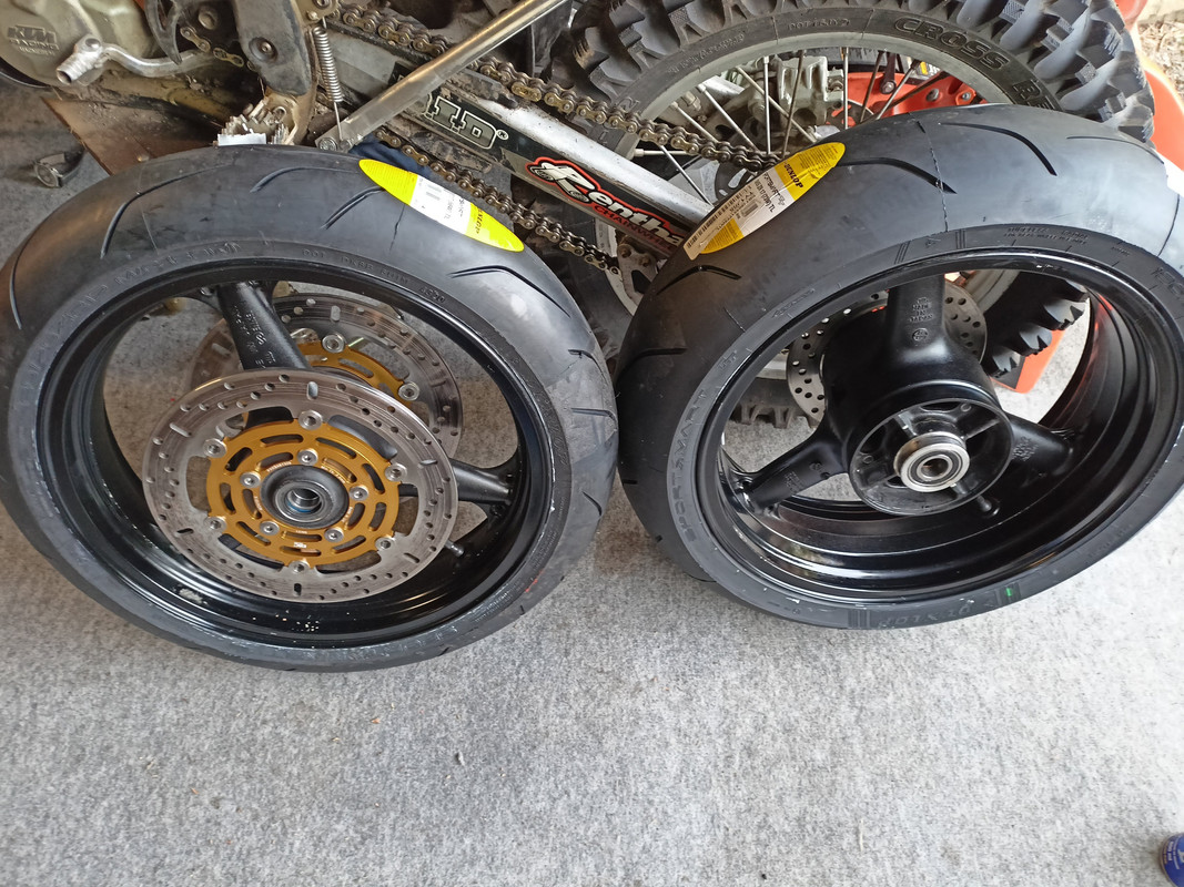

Minor update- the nice new sticky tyres arrived so got those on today

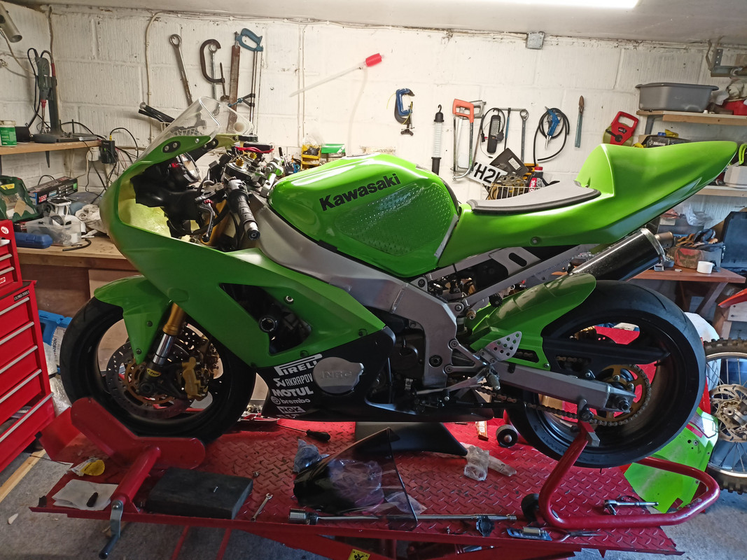

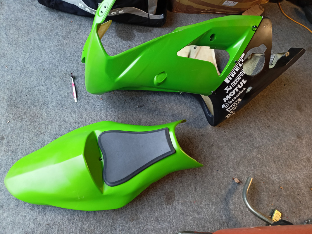

I've got out on the greenie a couple of times over the last week or so, and riding position aside, have to say have been enjoying riding it- it is of course no 890R, but it's fun and brings a different twat out in me than the 890 does.
Anyway, it has to be dropped off at the depot tomorrow in readiness for it's visit to Cartagena next weekend, so yesterday I set about getting the standard platics off and getting the scabby SH race stuff on.
Thankfully, the standard fairing fitment is nothing like similar age ZX10 ( which has to be one of the most frustrating bikes ever to remove/ replace the fairing on ), and it was all on the floor within a few minutes.
The already drilled holes in the race fairing lined up niceley with my standard mounts so all good there, but rather than bolt it straight to the metal brackets I took a few minutes to fabricate some soft mount spacers for the top, as fibreglass is a lot more brittle than plastic and I could see it very easily cracking there if I just bolted it straight up.
The seat took a bit more effort, and I see what the matey I got them from was saying- it's a very tight fit over the subframe, and the way he's fitted the Dzus sockets, it wasn't possible to get the fibreglass undertray to fit when you had the seat on, so I drilled them out and fitted them to the seat unit rather than the undertray, which although still a tight squeeze, allowed the seat to line up and the undertray to be fitted.
I'm not completely happy with having the seat undertray on the outside of the seat underside but to make it really fit how I want it to will require me to take a hacksaw to the standard Kawasaki underseat plastics- not something I'm prepared to do at the moment, but I will find a secondhand one over the coming months and sort it.
In the meantime, it's secure and the underseat gubbins are protected from the elements and flying stones etc, so we're good for next weekend, and now it's just a case of getting my kit and tools etc together in the van and loading it onto the stillage tomorrow.

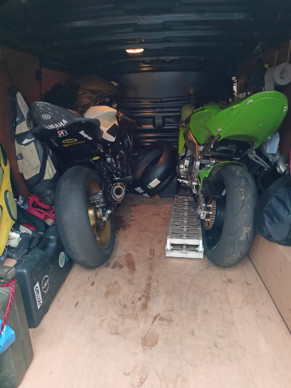

All packed (including wets on wheeels
) and now on the back of a lorry , shortly to be setting off for Spain
After I bought it I did toy with the idea of taking both but decided that would be extravagant, and if it's just the one then the ZX is it for this adventure on the rationale that I reckon I stand more chance of keeping up with my mate on it than I likely would on the 890- ( not that that is important of course
), but in all seriousness, this will be a slightly different trip for me so I am going to see if I can re-kindle some of the old mojo, the ZX should be a better bike to be on for that and not that I'm expecting to go mad, but if I do have any mishaps, then it's on an old inexpensive bike
But having said that, seeing this whilst loading up today, I welled up with 890 love again and was wishing I was taking it- this was proper lovely close up , had very shagged slicks on it and a very pose-y sharply dressed Japanese owner , so I'll be watching it with interest

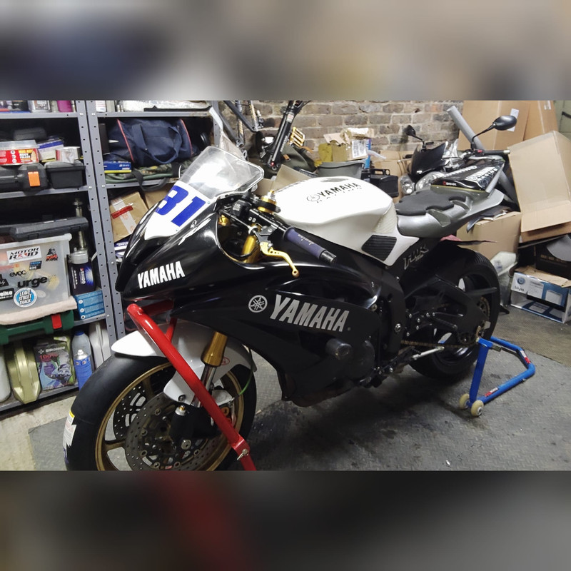

My TD/racing obsessed mate's R6 has been in my garage since Cartagena, last Weds he rang up saying he had a free day tomorrow, the weather reports were looking good he fancied doing a day somewhere, had scoured all the available tracks and choice was either Brands Indy (MSV) or Donington (NL).
Distance is roughly the same to either from where we live, cost was the same at £165 so there really was no question- Donington it was, and so I loaded the bikes and kit and 0530 the next morning we headed north and arrived to a very foggy and not particularly warm Donington and set up in a garge alongside a couple of Panigales and a really nicely prepared CBR600RR that even @weeksy wouldn't have been able to make any cleaner
It was a full event and we'd got the last 2 places in with the big boys, I will admit the first session I was feeling very very old and slow, being blitzed everywhere and wondering what I'd done, but by another couple of sessions I'd fully pulled my finger out, regained a little speed and was starting to really enjoy myself.
I still getting shown the way by some proper fast boys, but I was also getting by a fair few in the group too, especially down through Craner and into the old hairpin and Melbourne.
The last session of the day was one of the most enjoyable I can remember for a very long time with me and matey with the CBR in our garage having a real decent ding-dong for the whole session, both pulling each other along in the mid 1:40s- that's not in any danger of troubling too many runners in most 600 club races I would think but it was a step back up for me, and top fun with us both pushing hard and being so evenly matched - I think I've talked him into coming along to Bedford next month too- didn't take much!
And the icing on the cake was looking at some of the lovely old cars that started appearing throughout the day- I think there was a historic type meeting on over the BH weekend, so loads of tasty American muscle cars and some Cortinas and Elans etc that were simply immaculately prepared and gorgeous IMO- I should have taken more pics as there were loads of them, but here's the couple I got

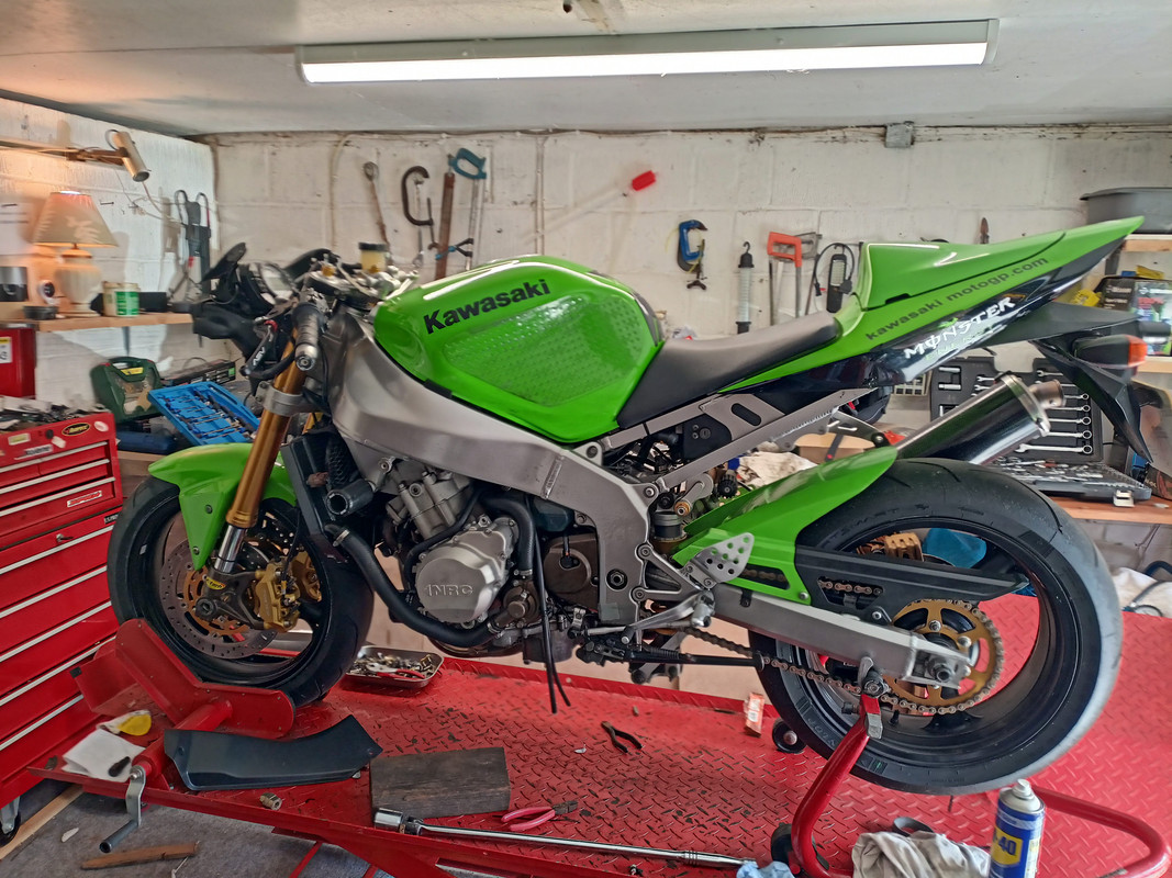

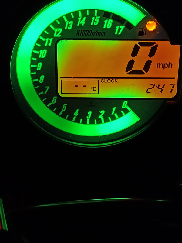

Didn't realise how long it's been since I updated this thread, but I guess the updates on it, such as they are, have been in trackday specific threads, as that's all that's happened really- aside from some new oil and filter and a new 60 profile ( made a BIG difference to the feel of this bike) rear tyre last month at Donington , ther's been nothing to report, it's been great.

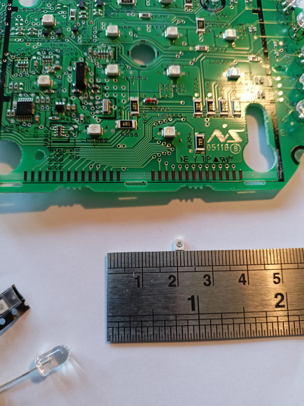

I was however insipred by @dern 's clocks fetting on his one (see here http://revtothelimit.co.uk/viewtopic.ph ... 38#p173938 ), so thought that I'd do the same, only I went full tarty and picked green rather than white LEDs
Feck me, what a job though- really brought home to me how old my eyes are - I never quite realised from his pics just how diddy the LEDs are-the pics below gives some perspective- they are tiny!
Not a job I would tackle again, as the contact area that the LEDs have on the board is so small, and the LEDs themselve are easy to melt if you're not careful, definitely not a job to attempt if you don't have any previous PCB/soldering experience and/or patience
Anyway, clocks are back on the bike now with a lovely green glow- I too didn't bother doing the speedo area- the revcounter bit took me long enough

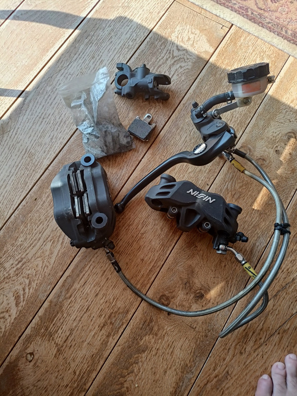

And something else that I'll be doing before the next outing is bolting this little lot on
It's the calipers and MC from a 2016 ZX6- as may be seen from earlier in this thread, the (OE) calipers on mine at the moment have been refurbed and braking massively improved with an S1000RR MC, but this lot came up at what I thought was a bargainous price on another forum and the calipers are a definite improvement on my era ones so I thought why not.
The nice thing about it is I have the complete system including lines, so I could take both systems to the next TD and swap them in a couple of minutes if I wanted to do a back-to-back, albeit I suspect once the 2016 lot goes on, it won't be coming off - more to follow after the next TD, which as it stands will be Pembrey in Sept, although I am currently thinking of maybe getting along to the Bedford one in August with @dern and @Dodgy knees -we shall see
