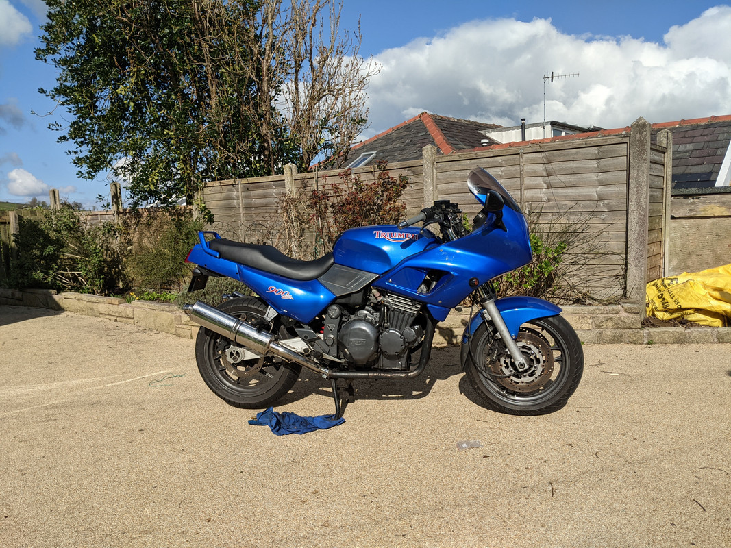

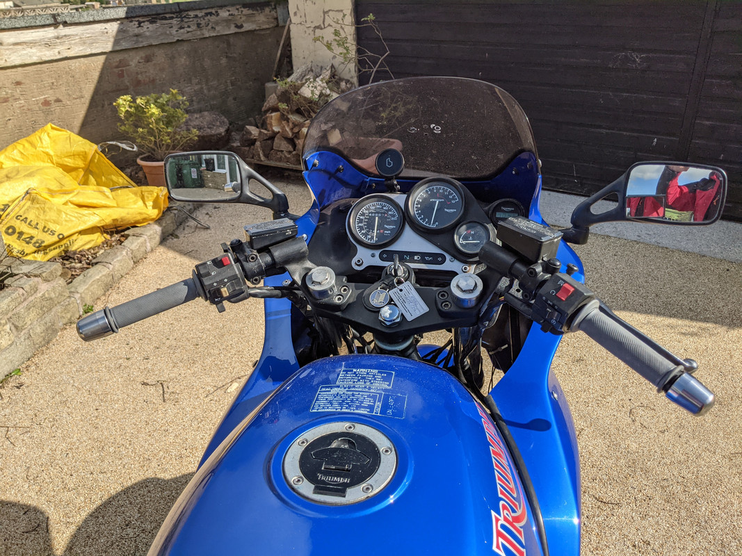

So this is what the old bus looks like at the minute.
Note the uber fat grips which are going to be changed for some skinny renthal ones to suit my fat-fingered lady hands :oops: and the raised edges of the old stickers which resisted heat, thinners and acetone. :flame:

You want to speak nicely to Trinity and see if she fancies cleaning those headers... :mrgreen:
Re: Making a Triumph a bit less ugly
mangocrazy wrote: Thu Mar 10, 2022 8:15 pm You want to speak nicely to Trinity and see if she fancies cleaning those headers... :mrgreen:
Yes,yes,I heard somewhere she'd become rather adept at the job. :thumbup:

If ever a bike didn't need to sweat the condition of it's headers it's this one, would be the definition of putting lipstick on a pig

New grips on and new exhaust clamps to solve the leaky exhaust.
A lot less popping on the overrun now and bottom end pick up is much better.
Grips have made a bit of a difference but I do prefer a flat bar.
