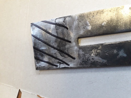

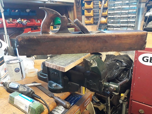

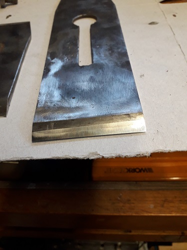

Got a bit inspied so went of finished WFH went out in the garage and spent a couple of hours playing, wire wheeled the metal bits, filed the burrs off.
Flattend and sharpened the blade. Started off at 400 -1000 -3000 and then leather strop. All at 25 degrees got a nice mirror finish on the bevel. having cleaned it up I can make out the make, James Howarth, Sheffield. There's on on Ebay for £25.
blade 1.jpg (79.69 KiB) Viewed 3706 times
This is the back I put the felt tip lines across than work on the 400 diamond stone till it disappears, did the same on the other side. Only the bottom 2 inches though.

Hopefully you can see the nice shiny bevel.
Then re-assembled and oiled the metel bits and treated the wood with BLO. I've noy planed the base though, maybe that will be the first jib if I ever use it.
oiled 3.jpg (121.83 KiB) Viewed 3706 times

Yep, can see the nice shiny bevel and yeah I put a marker on them to see where I'm abrading the as well.
In the bevel pic I'm not sure if its another bevel angle but it looks like I can see the forge weld line where the harder metal is a very slightly different colour?

demographic wrote: Thu Apr 02, 2020 9:09 pm Yep, can see the nice shiny bevel and yeah I put a marker on them to see where I'm abrading the as well.
Yes there are two bevels. There was just one before I started, about 10-15mm deep and slightly rounded, I was buggered if I was going to take all that out
