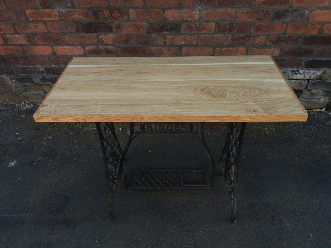

Oak tabletop for my granddaughter.

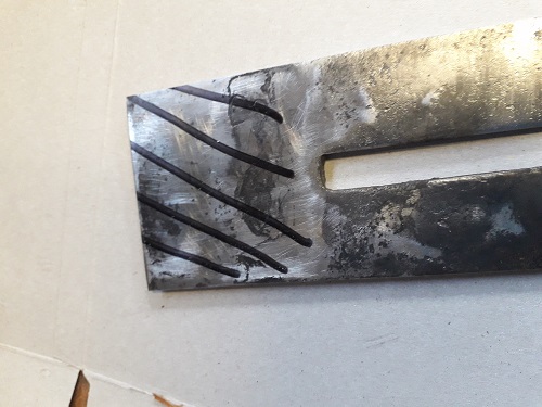

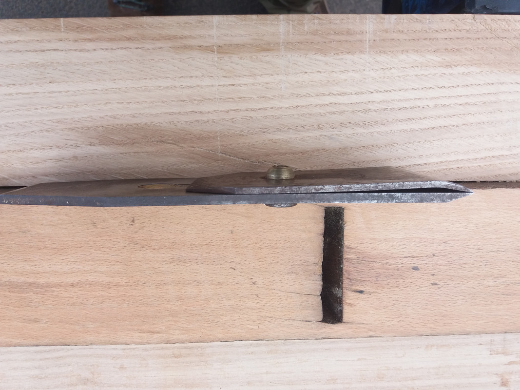

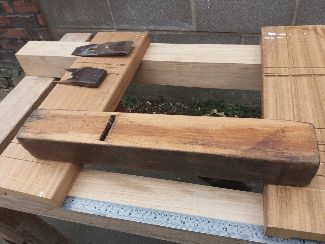

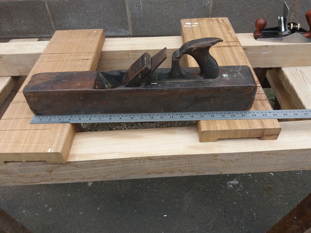

Mines as near as dammit the same as yours, its actually 22" long not the 23" I thought it was.

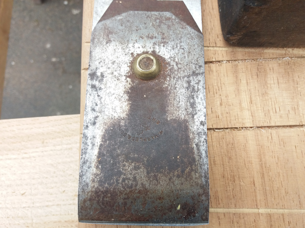

The cap iron says Marples but they made blades and cap irons for several other manufacturers (as did Sorby) so it doesn't always mean Marples made the plane, plus these things have bits swapped over during their long lives so often end up being Frankenplanes.
Then its not as flat as I thought it was, which on a metal plane is a massive pain in the arse but if a wooden plane isn't flat enough, you plane it flat. Don't go crazy as that widens the mouth but thats how the old joiners did it.
I've started to sort this out before I took a photo because it neatly shows the darker area in the centre of the plane where it's been jointing long boards by the way its worn.
Also I dont think it shows it properly but its either warped over the years or been used by a left handed person because there were two diagonally opposed low spots.
As people often skew the plane slightly and right handed people generally skew the opposite direction from lefthanders it could be that.
Maybe.

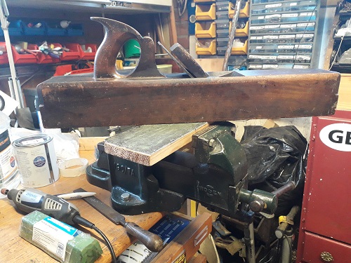

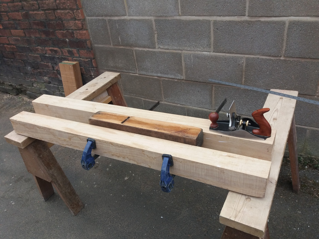

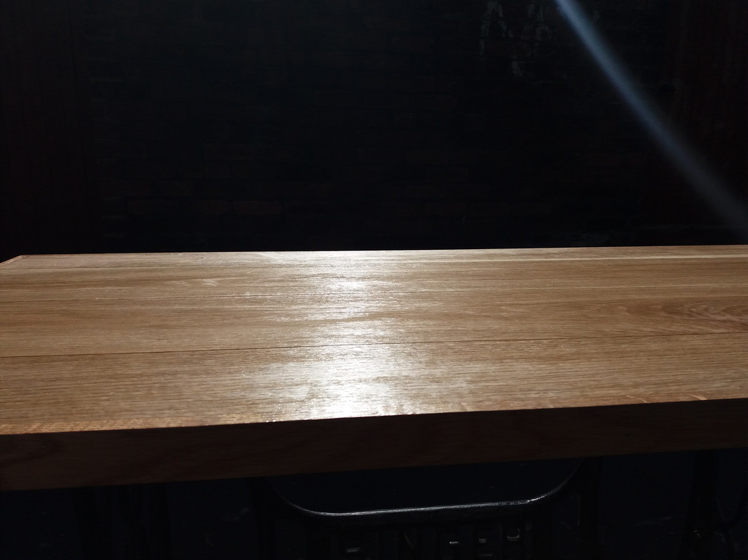

Anyway, clamped up for planing the bottom, I didn't finish it totally in the end and left a little bit behind the mouth to level, this shows when I stopped cos my bench isn't ideal for all this. I was getting slight chatter and my sawstools weren't helping matters.
The picture showing the side of the blade and cap iron shows where I stopped planing the bottom.
I found some Danish oil in my shed today as well cos I thought I only had Boiled Linseed Oil to finish the tabletop. Nothing much against BLO for inside usage but I've not used it anything like as often as Danish oil so I'm not sure about it.
As the tabletop is destined to be covered in snot/chocolate/Crayola I do know its going to be ugly in no time.
I could use Yacht varnish but again I just don't like varnish. For me it takes an ugly finish and keeps it forever.
I'd rather it started out nice and can live with it getting ugly later on.
Not put the Danish oil on yet, I'll get to it.
Maybe.

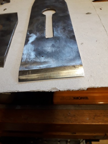

Got a bit inspied so went of finished WFH went out in the garage and spent a couple of hours playing, wire wheeled the metal bits, filed the burrs off.
Flattend and sharpened the blade. Started off at 400 -1000 -3000 and then leather strop. All at 25 degrees got a nice mirror finish on the bevel. having cleaned it up I can make out the make, James Howarth, Sheffield. There's on on Ebay for £25. This is the back I put the felt tip lines across than work on the 400 diamond stone till it disappears, did the same on the other side. Only the bottom 2 inches though. Hopefully you can see the nice shiny bevel.
Then re-assembled and oiled the metel bits and treated the wood with BLO. I've noy planed the base though, maybe that will be the first jib if I ever use it.

Yep, can see the nice shiny bevel and yeah I put a marker on them to see where I'm abrading the as well.
In the bevel pic I'm not sure if its another bevel angle but it looks like I can see the forge weld line where the harder metal is a very slightly different colour?

From my point of view the reason I wanted some was because a metal jointer plane costs a bloody fortune and I think I can do the same job with a fivers worth of wooden one.
The wooden toothing plane was dead cheap and I just wanted to see how I got one with it, again it does some things that my normal metal handplanes and lecky powerplanes don't.
With a few decent handplanes I can potentially flatten big slabs, I'll make a router sled to flatten off large slabs but I'd like to compare it to just using a handplane.

Yes there are two bevels. There was just one before I started, about 10-15mm deep and slightly rounded, I was buggered if I was going to take all that outdemographic wrote: Thu Apr 02, 2020 9:09 pm Yep, can see the nice shiny bevel and yeah I put a marker on them to see where I'm abrading the as well.

As the tabletop is near enough done, it just needs the tiny pin holes filled in the lipping and Danish oiled so I've mostly just been pissing about with handplanes today.
I have a Lervad beech bench top from a school that closed nearby, its got the usual scratched in pupils initials, random sawcuts and bits where the gormless little shites have been stabbing it with a compass.
Its got a few areas where the grain is reversing and a normal angle plane causes tearout so toothing plane it is. Oh and anyone who thinks I'm just dicking about now? Yup, I am.
Started out with the toothing plane, the bench top is in two sections which split so I've unbolted them so its nicer to move about.
This is both sides just set on top of my sawstools.
One section including the tail vice set into it.
Few mins later on, needs checked with winding sticks [just two bits of straight timber really) but looking a lot better. I'll never fully get rid of the scabbles cos some of them are too deep but as long as its good enough to work on I'm fine with it.
Then this if what the shavings look like when its going with the grain, kind of stringy if I go across tge grain its almost dust.
This is the underside of one half.
Then at some point I basically started pissing about, mostly because its ni e working off a decent benxh top thats got bench dogs to hold the work steady.
I have a bit of birdeye maple flooring that I saved from the skip, its a right bastard to plane as it tears out at the "eyes" so tried that.
Oh and I have a few bits of Lignum Vitae with wild grain. This stuff is one of the worlds densest woods and the grain goes all over the shop. Its defied all my other handplanes and the toothing plane does it nicely, it needs a go over with a scraper/scraper plane but its not getting the usual massive tearout.
Bit of Birdseye Maple held in place by the benchdogs.
Bit closer.
Basically I've just been looking around for something a toothing plane can't manage, I very much doubt it will be good on endgrain which generally likes a far lower blade angle. I've got something else for that.
