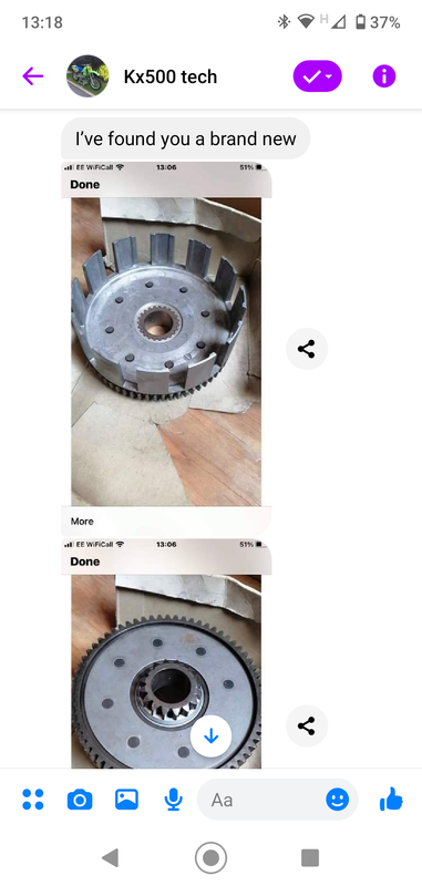

I'm kind of stuck having dropped the clutch basket and broken a pawl off...which I have subsequently lost/thrown away. It's a discontinued part and I've not seen one pop up on eBay in the last 6 months.
The 1985 clutch basket shares the same steel and friction plates as the 1986 and others but it has a 16T crank gear and the later ones have a 17T so I bought one thinking I could press them out and swap. Unfortunately they have a different number of splines. The large gears are the same in both.
So, it's an engineering shop job. My thoughts are either cut a pawl off the 86 basket and get it TIG welded on to the 85 basket and machined up, or press out both gears and build up the 86 basket with weld and rebroach it for the splines of the 85 crank gear.
Anyone have any other thoughts?
Re: The 10+ year KX500 rebuild thread
I'd probably make a new middle bit with the gear off one and the spline off the other, IYSWIM
Cutting gears and splines is a bit spendy though if you're not in the habit of doing it.
Why is it a spline? Does it have to be?
Edit: Ah right, it's an aluminium basket and a steel gear innit...makes sense. That's why it's splined. If you did it another way you'd chew through the basket.
So yeah. Make a new 'hybrid' centre bit or build up and remachine as you say. If it were me I'd have more faith in the former than the latter.
- derek badger
- Posts: 1176
- Location: Surrey Hills
- Has thanked: 1090 times
- Been thanked: 1752 times
Well fuck my hat. Just found a KX500 specialist on Facebook, pinged him a message thinking he'd get back to me next week. Replied straight away...turns out not only is he 20 miles down the road from me, but he's located a NOS basket in Holland for £250.
