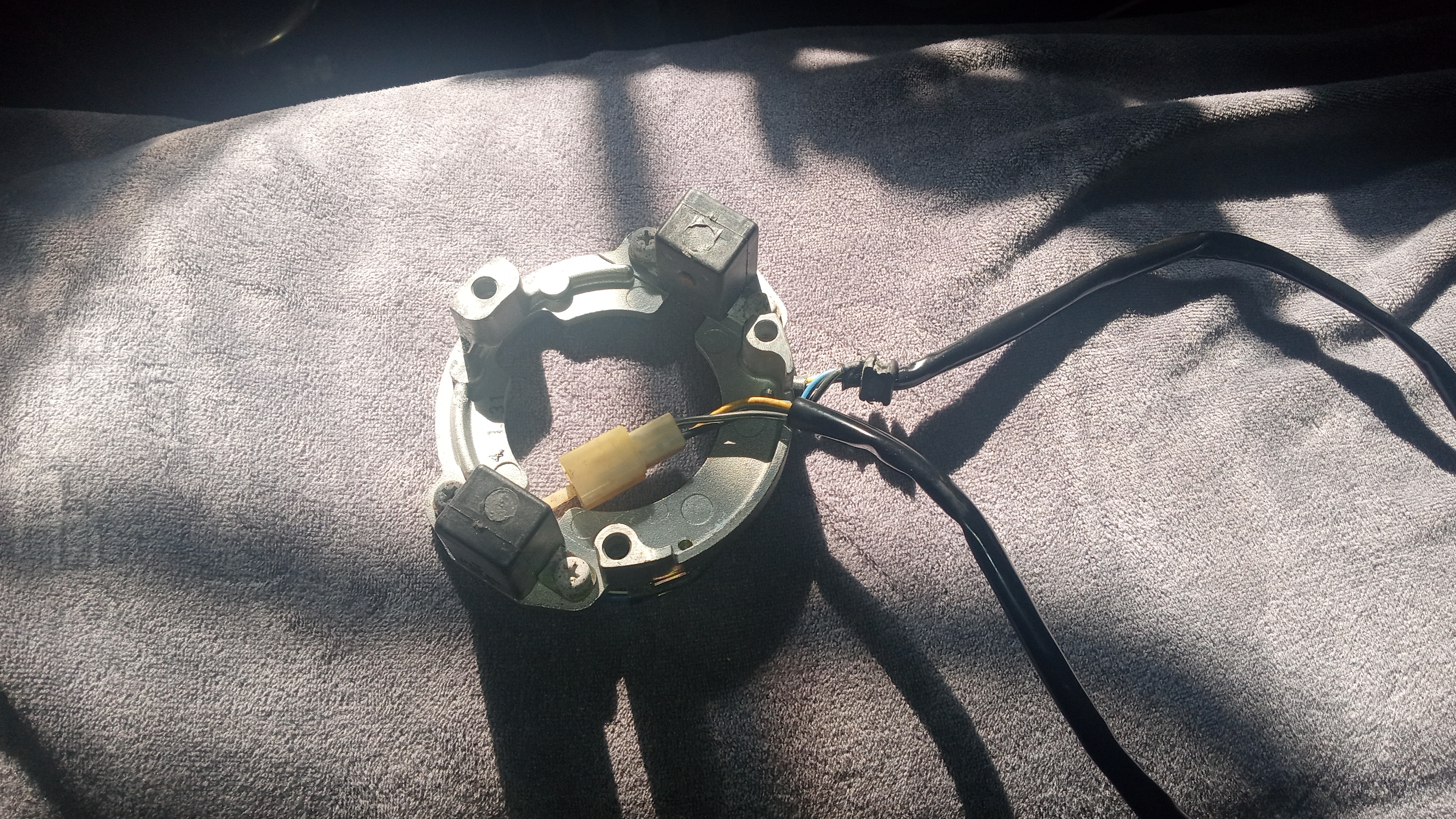

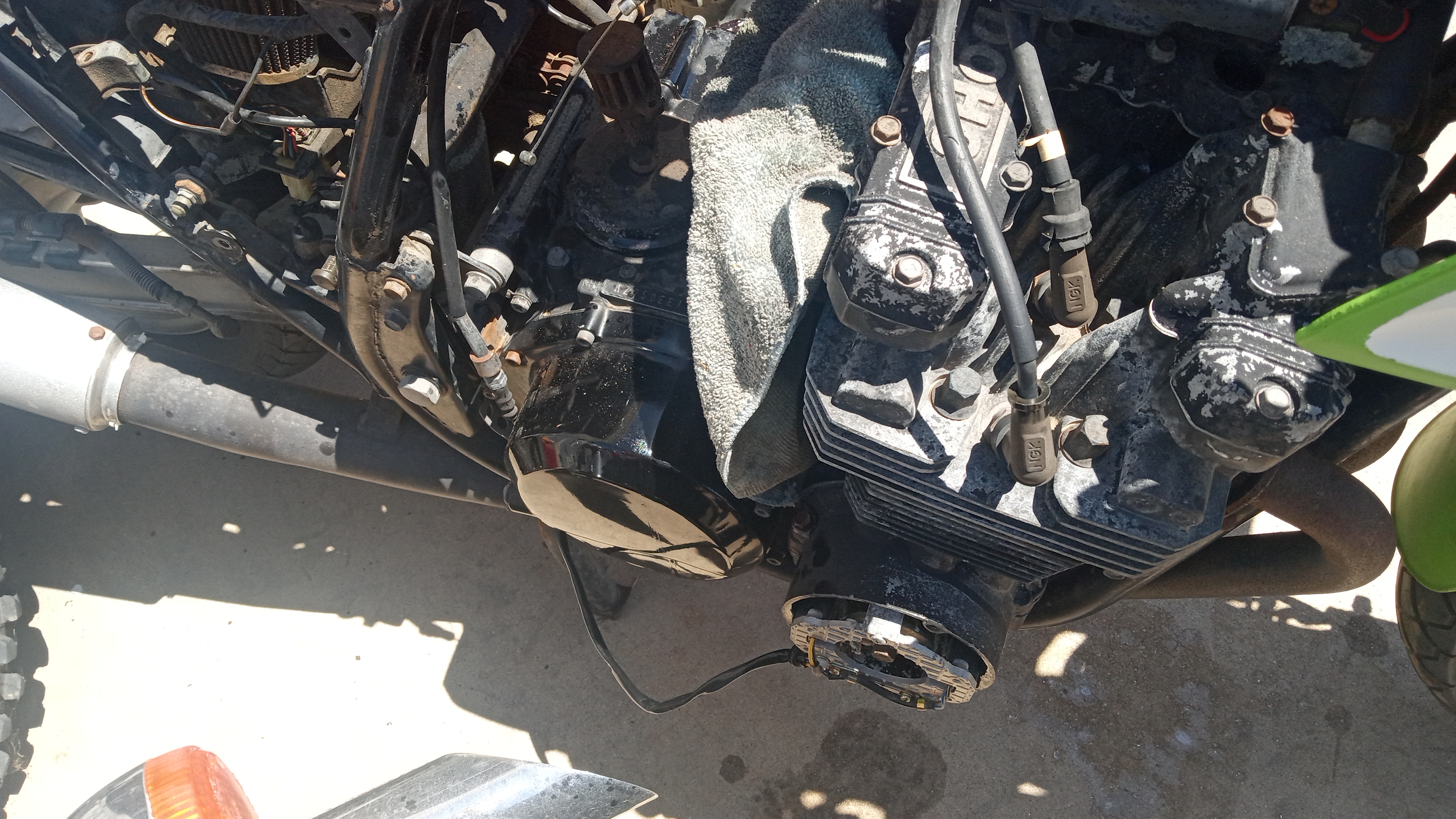

This just showed up, which will be a major contribution to getting it to run... or at least spark... hopefully :)

Huge progress today!!
I swapped out this:
For this:
Re: '83 GPz750-A1 malarkey.
Posted: Thu May 14, 2026 9:00 pm
by ZRX61
oh, & I installed the new ignition gubbins & got the fucker to fire up!! albeit with a squirt of ether down the carbs... which I then removed & bought home for o/h. Two slides are stuck open & two are stuck closed.. but at least now the butterflies move, everything was locked up this morning before it all got a spray with Tiger Piss.

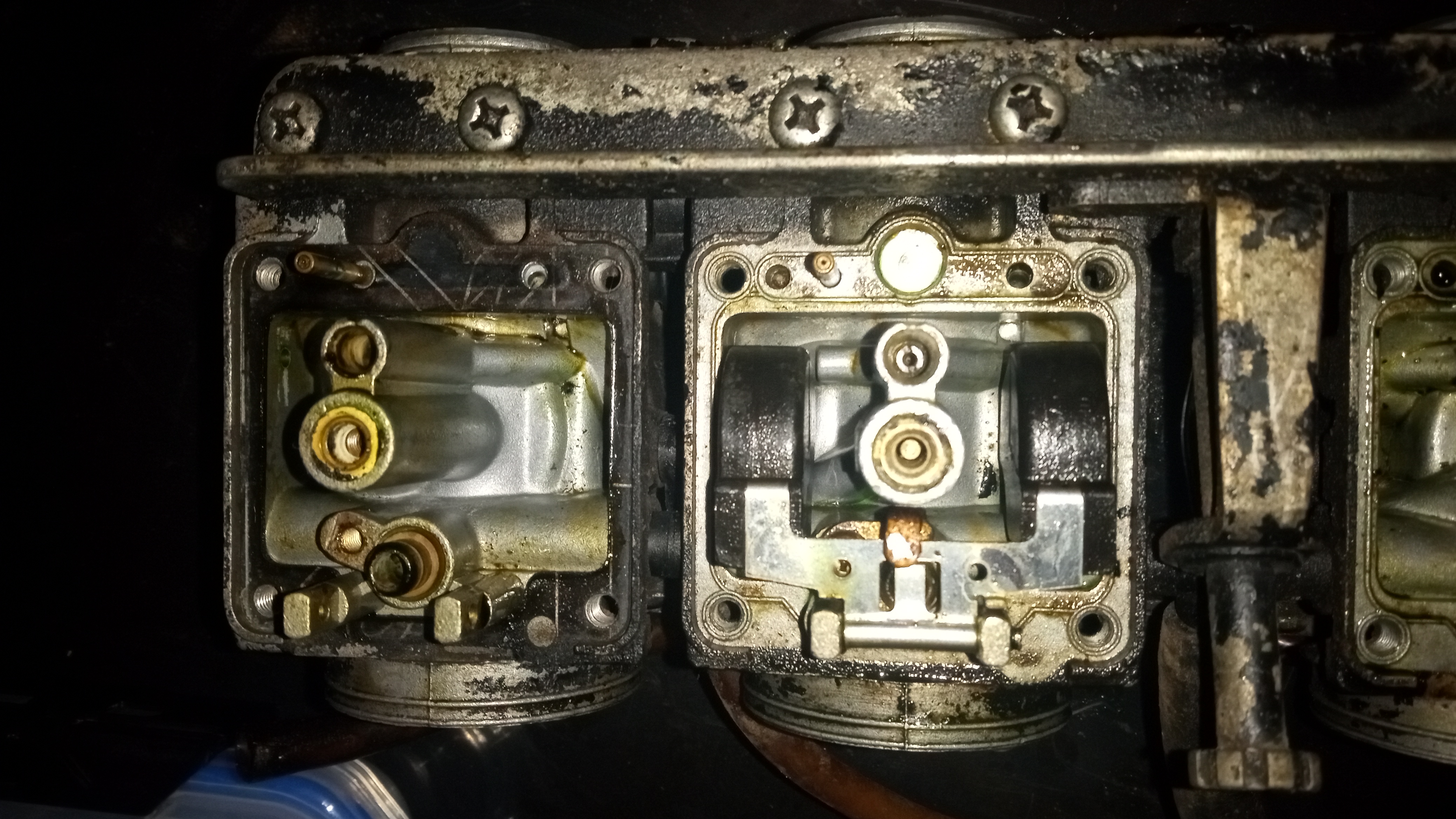

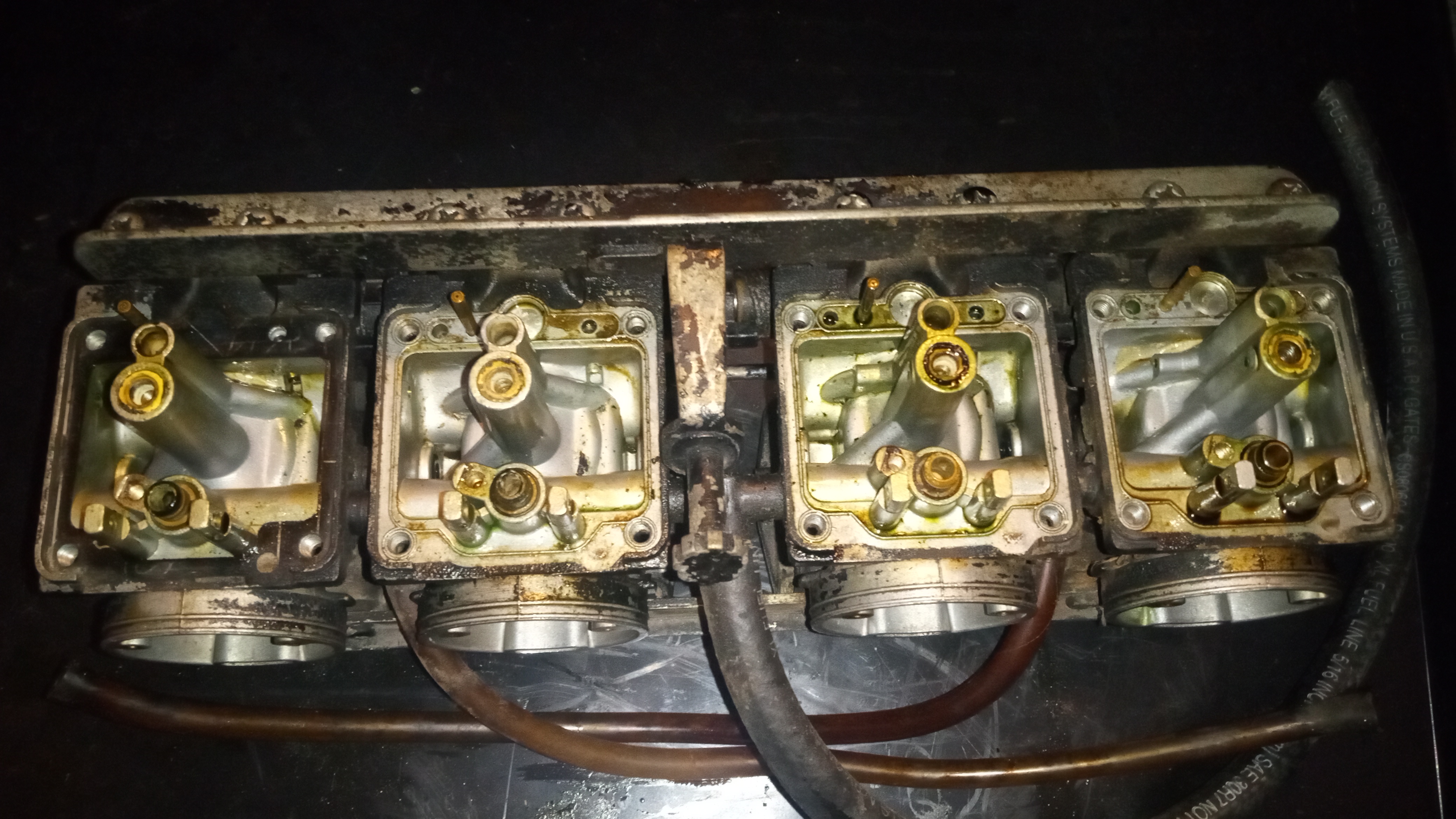

Delved into the carbs... dear god what a mess.
This morning NOTHING moved. Gave it all a spray with Free All which is a lube/penetrant/rust buggerer.
Managed to get the butterflies moving first & then worked them a bit so they're moving freely now.
Removed float bowls, cleaned them of the varnish.
Removed 3 of the 4 floats, can't get the pin out of the #2 carb. It got sprayed with lacquer thinner, brake cleaner & then Free All, will try again tomorrow.
Removed three float valves.
Removed the main jets & poked them to remove the solid varnish that was completely blocking them. #1 main is probably buggered, will assess when they're clean.
Flipped carbs over & started on that side of the clusterfuckery.
Diaphragms are all OK, Needles were all munged up, but they cleaned up just fine with lacquer thinner & a paper towel
Reassembled top side of carbs for now.
Got the choke shaft freed up & now all that gubbins is moving easily.
Need to get some carb cleaner to spray through various orfices (orifii?) etc.
Given how bad the carbs were with regards to butterflies & slides not moving I'm surprised it fired at all :wtf:
Pretty sure I would be 100% justified in getting a bigger ultrasonic cleaner that could take the entire carb rack... Will be home alone & unsupervised for 11 days starting Monday :shhh:
Edit: 30L ultrasonic will be here next Wednesday. Would have been almost $250, but I applied for an Amazon Visa & immediately got $150 credit, so $94.64 WIN!! 8-)

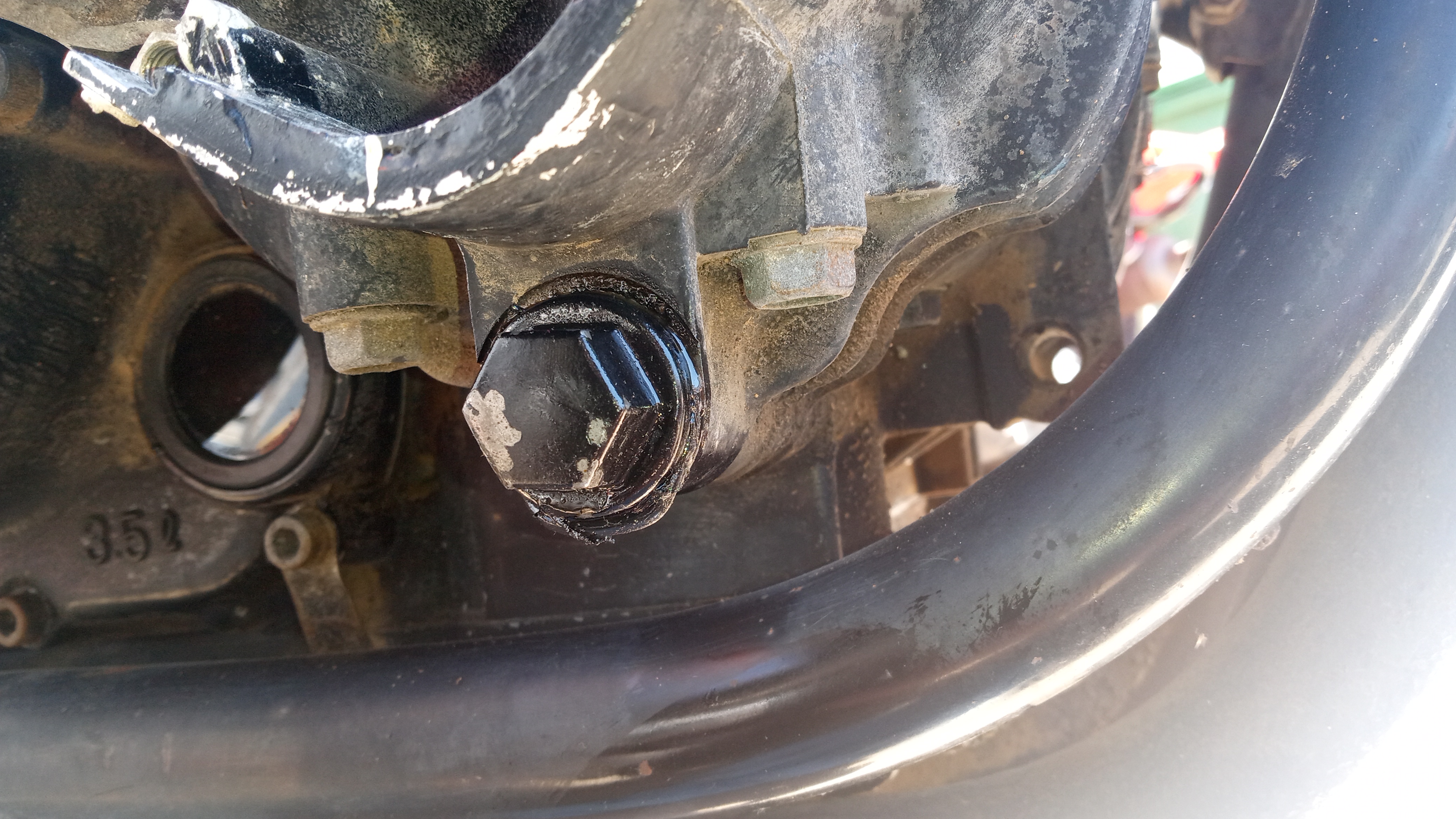

Still couldn't get the gas cap open today.

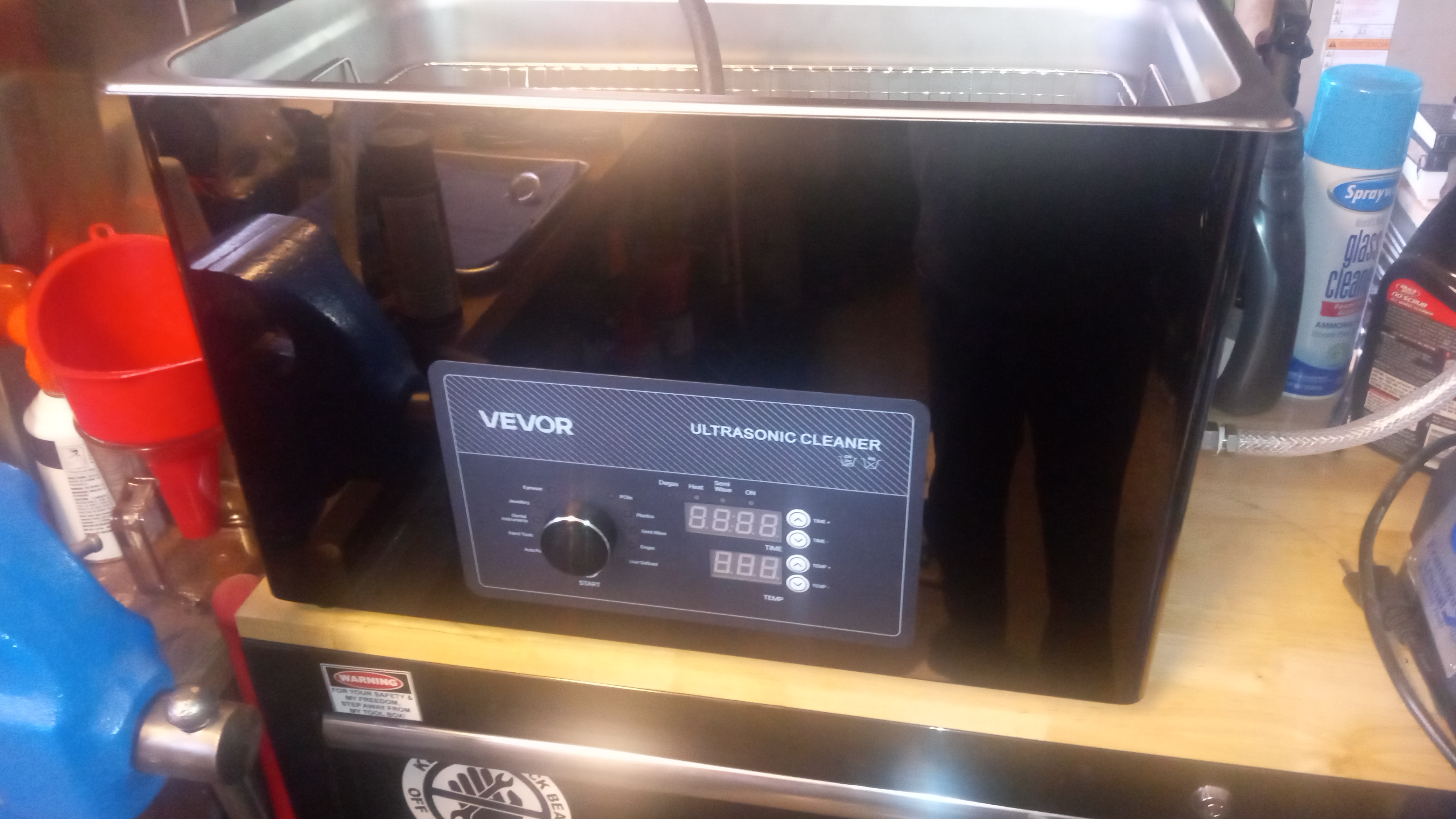

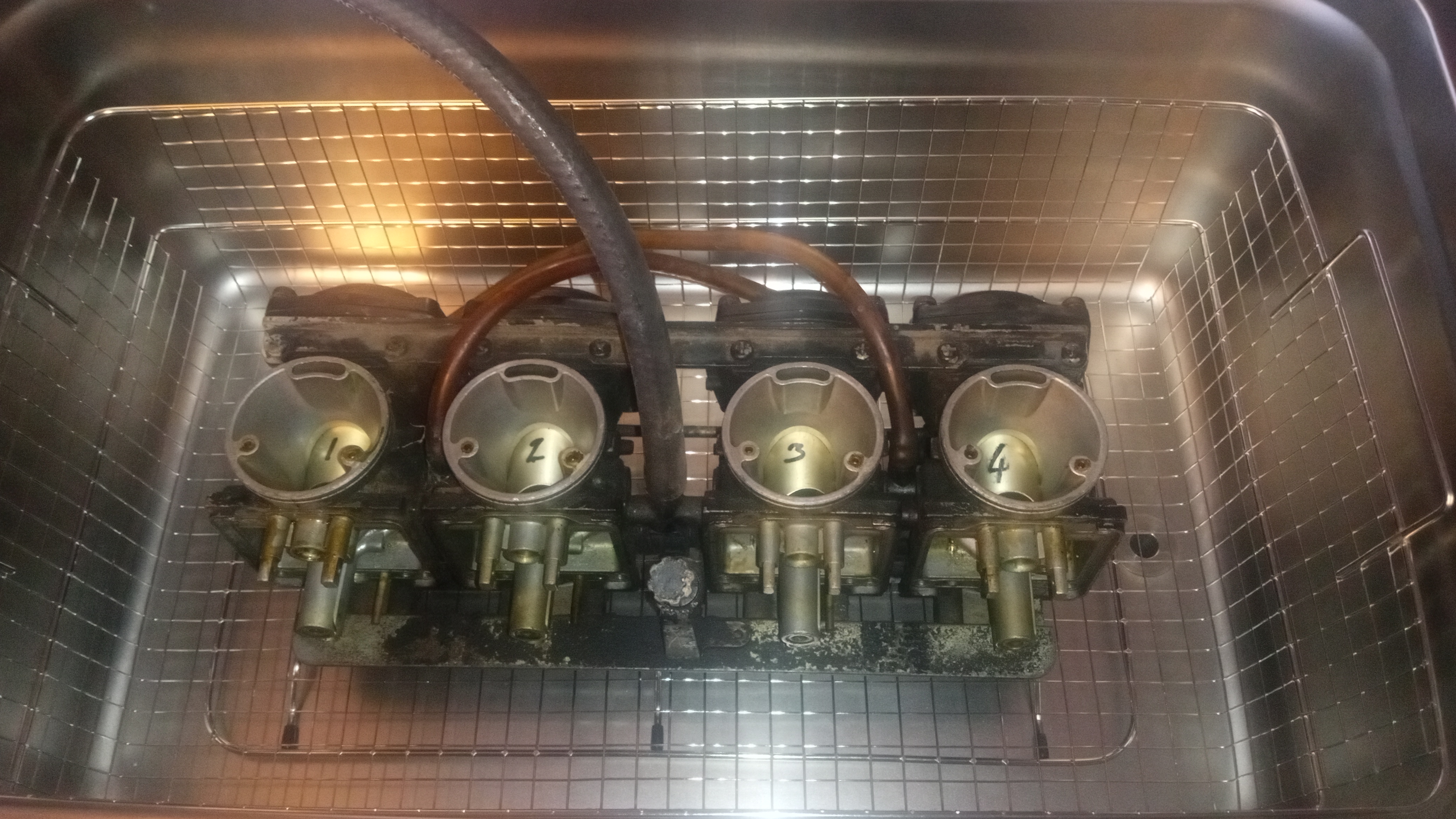

New toy, er, tool showed up. Carbs easily fit, guess I know what I'll be doing tomorrow... It's a tad bigger than I expected (that's what she said....)
Cage for small doodads is REALLY tiny. Usual method is to use those metal mesh pen holder/desk organizer thinigies though.
