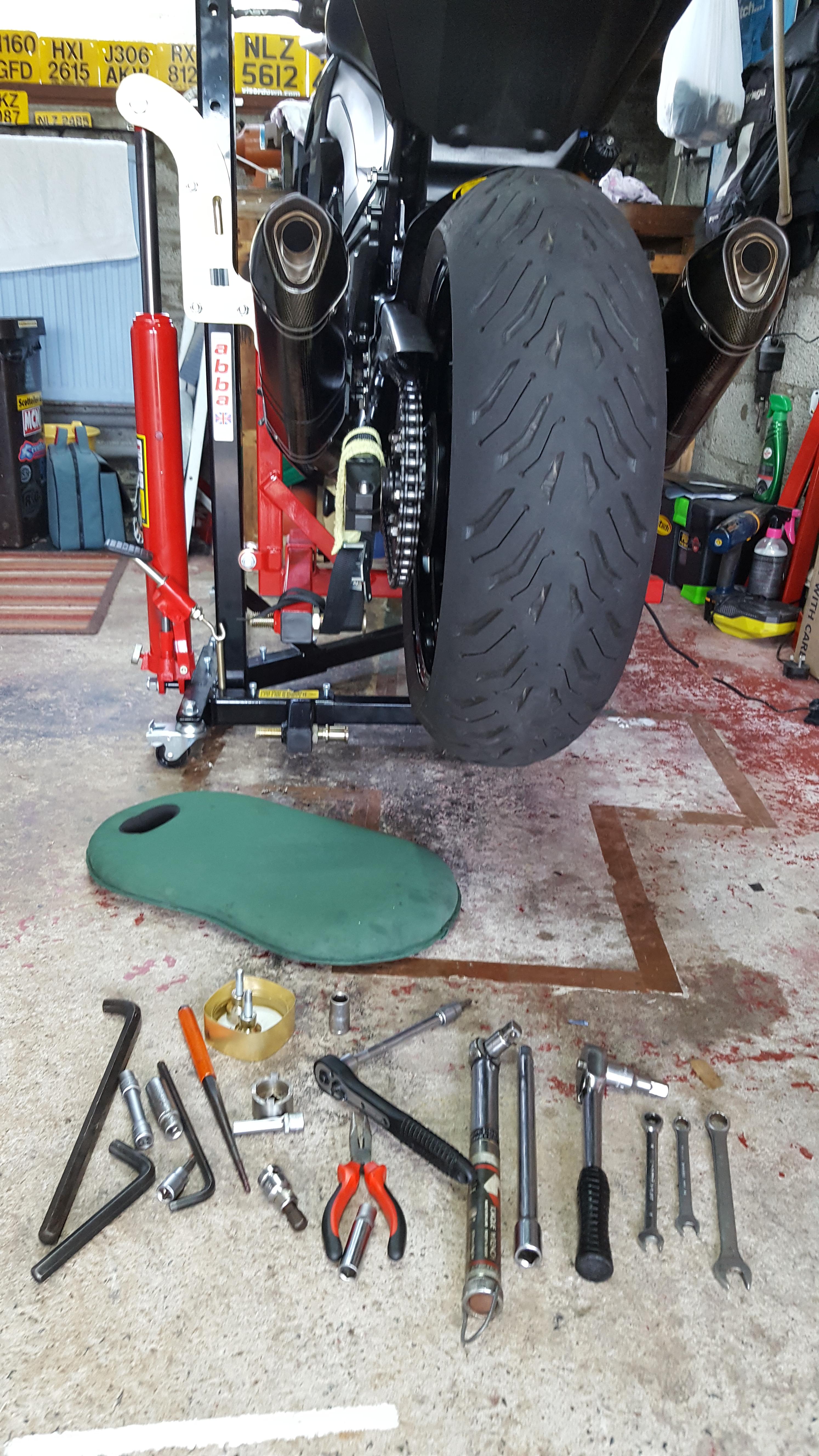

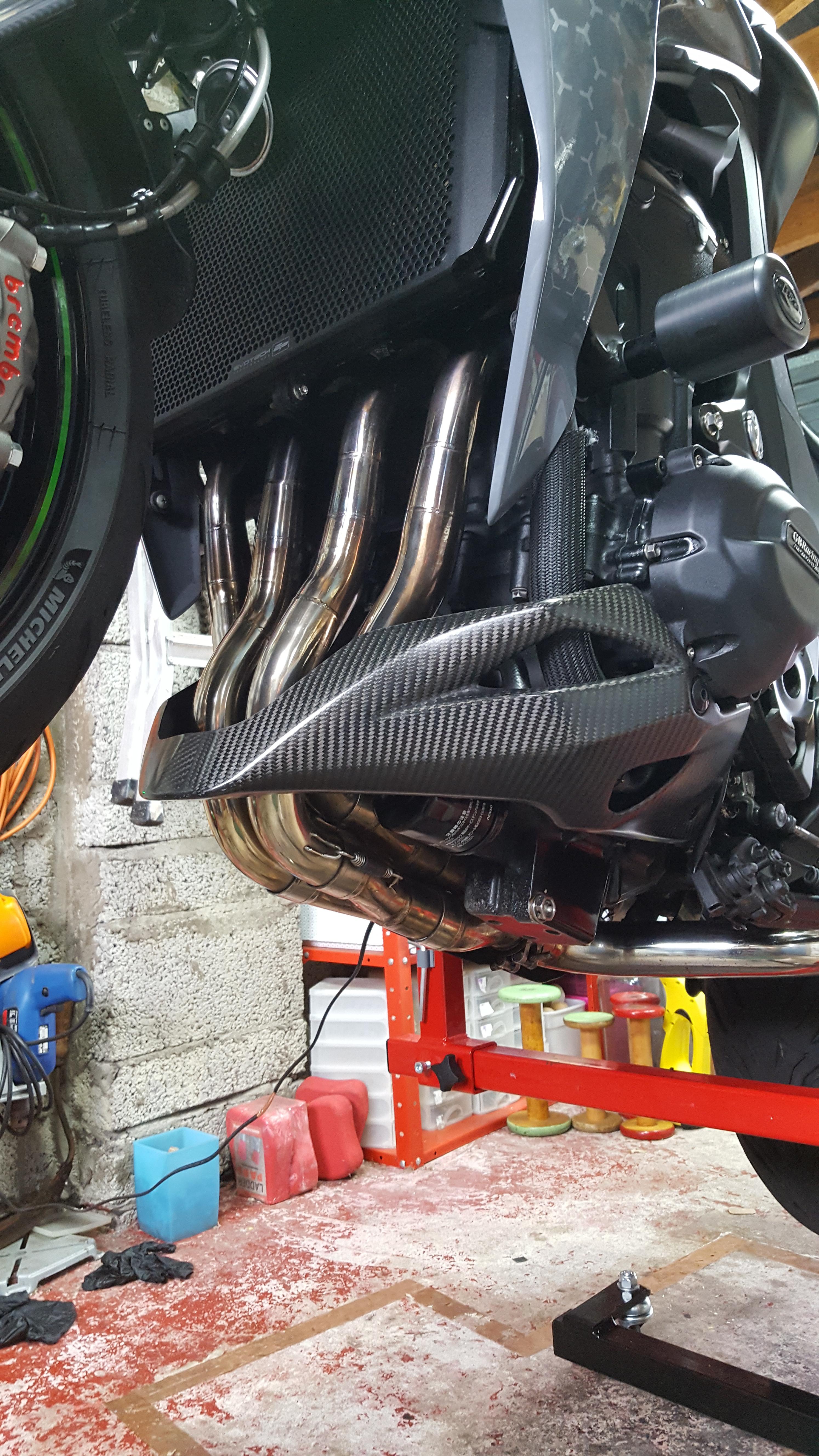

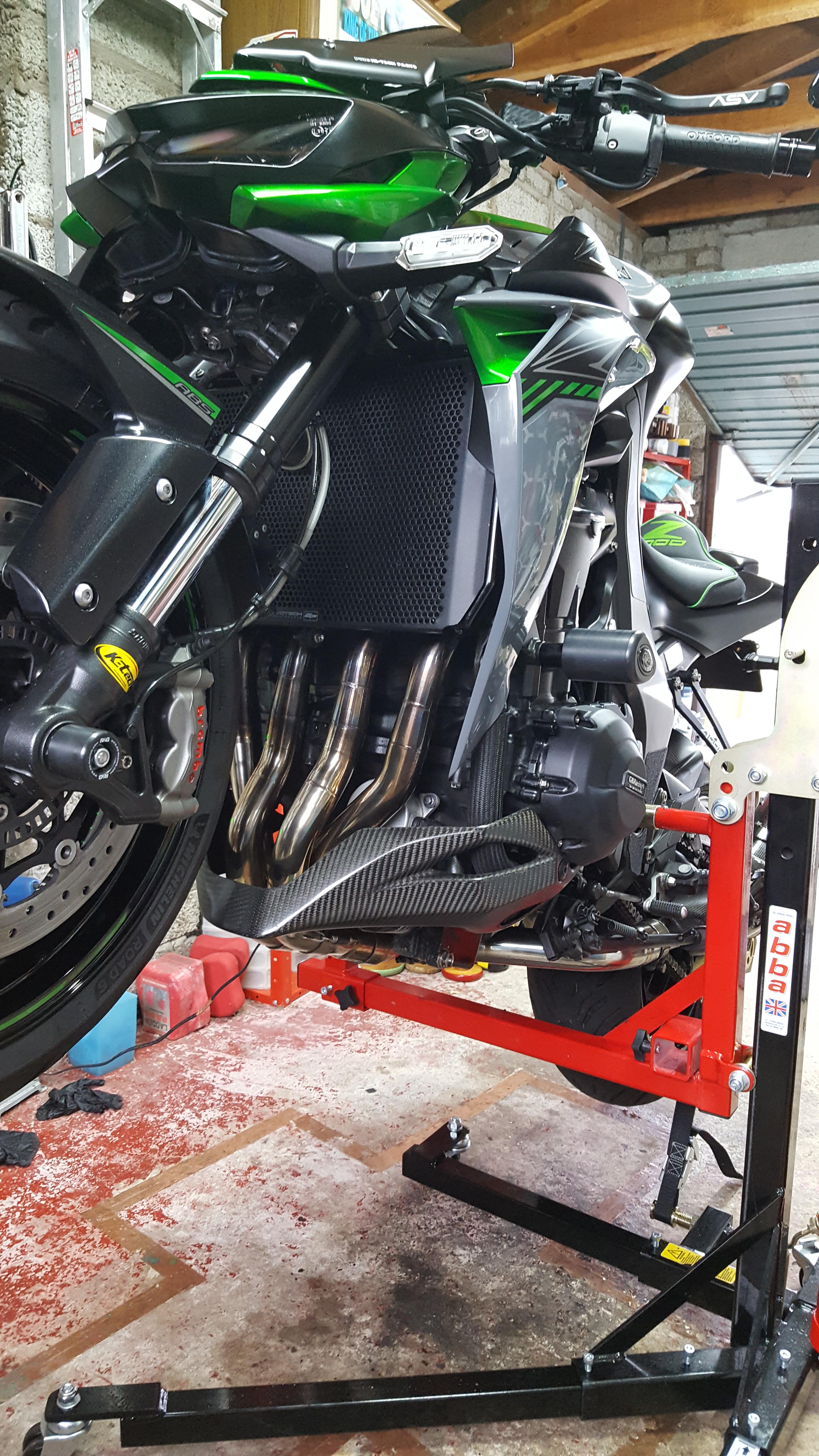

DON't feel too bad on yourself... we've all done things and thought "oh bollox, why didn't i stop there"Skub wrote: Sun Oct 23, 2022 6:29 pm Ok then,time for a fuck up admission.![]()
When I was lifting the bike in the wheelie position on the Abba Skylift I encountered a bit of resistance when operating the foot pump. I stopped and had a look around,but couldn't spot anything preventing the bike being lifted. With the wonderful gift of hindsight I should have stopped there,but I gave it another couple of pumps to see if I had imagined it....
What I failed to notice was the rear wheel had come in contact with the floor,so all the strain was being put through the swinging arm bobbin,which consequently tore itself off the swinger and will need welding on again. Most likely there will be heat damage in the course of the repair,so it'll need repainted too.
What.a.dickhead.
The swinger came out fairly easily and it'll give me the chance to lube the suspension bearings and swingarm pivot etc,while I'm in there.
So feel good about yourselves tonight,in the knowledge there are more stupid people out there...well,one anyway.![]()
Off to the welders tomorrow.
PS Apologies to Weeksy for the dirt under the Ohlins. I promise it'll be sorted and all ACFed before assembly.

Re: First new big bike EVER!
I contacted the good folk at Abba to explain what had happened,fully admitting my part in the event! Interestingly I recieved this email,which may be of interest should anyone have a similar model and use a Skylift.
"Hi again Davy, thanks for your email & explanation. That is very unfortunate indeed!
As it happens we don’t recommend use of the bobbin mount on all the late Z1000 models as Kawasaki has placed the bobbin position very far forward. This greatly increases the strain on the bobbin. That is why when you select the bike on the website no bobbin is offered. We actually put a warning on the Ninja 1000SX page as we had one customer have one fail before so perhaps we should extend the warning to all models".
"Going forward we would strongly advise putting the strap around the swing-arm itself rather than the bobbin".
All back together again. Swinger pivot and suspension bearings all greased up while I was in there. Drama over for now. I'll use the swinging arm from now on,no more bobbin action for me.

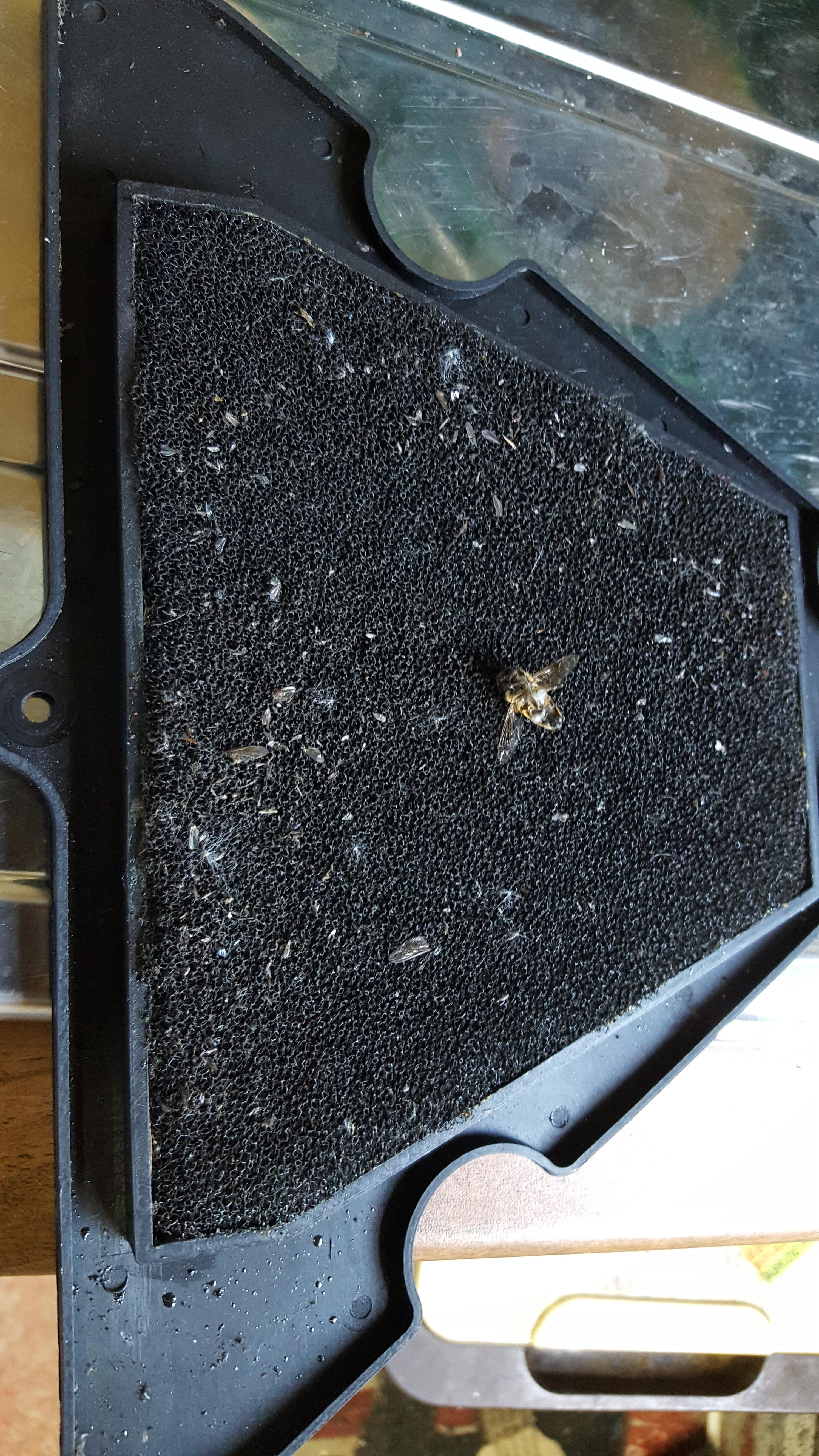

Pipercross air filter clean time. Not too bad for around 13k miles.

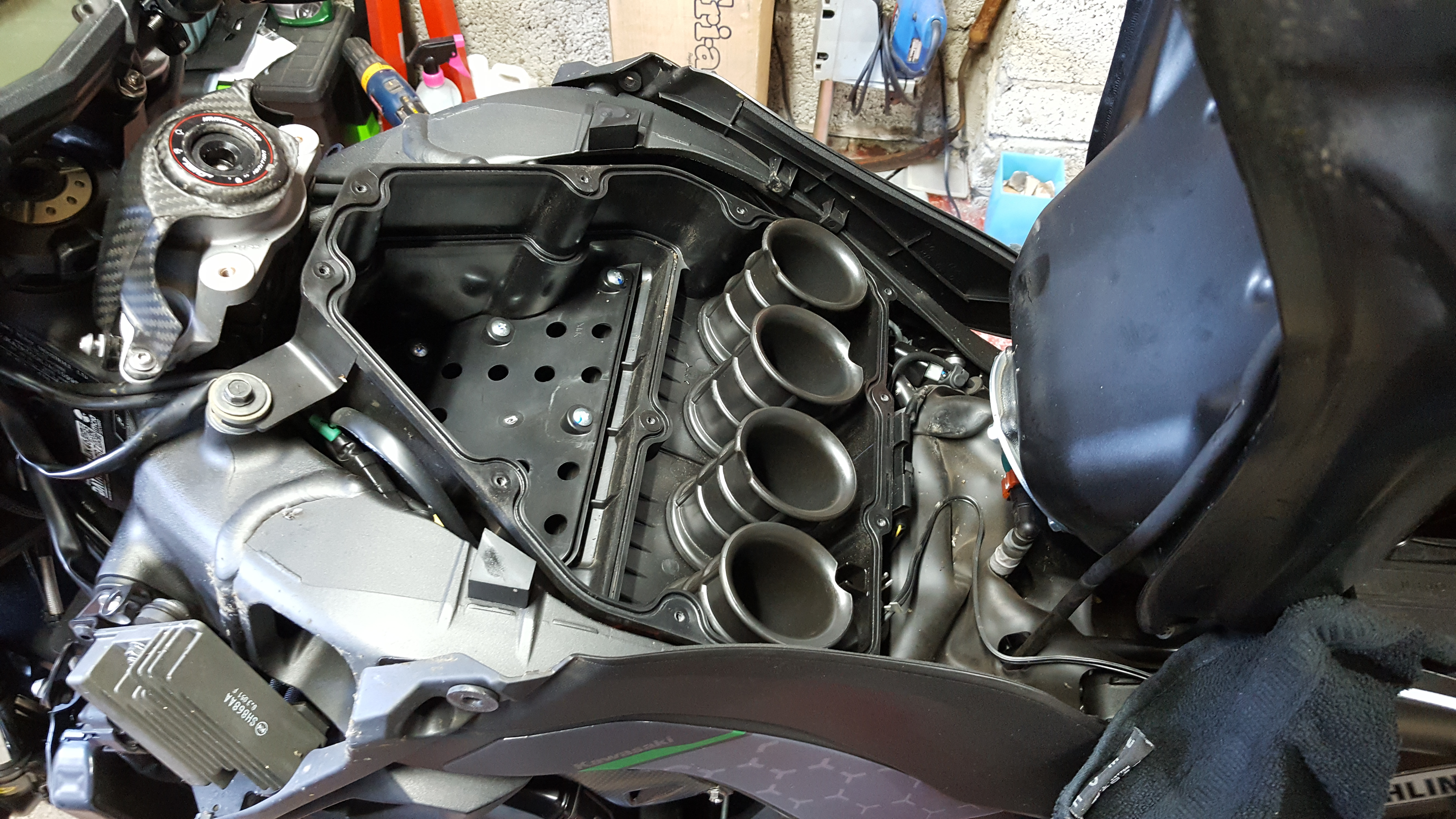

You know those times when you are doing a job/building something and everything goes really well?
That makes me suspicious.
I reinstalled the freshly cleaned air filter,buttoned up the airbox,put the tank back down and fitted the fiddly bodywork. It all went together like magic,not once did I encounter an obstinate or awkward part. By the time I had 3 screws left to put back,the feeling of dread was mounting.
Then I saw it.
One single airbox screw left in the tray.
Second time round,everything was a bastard.
Then I saw it.
