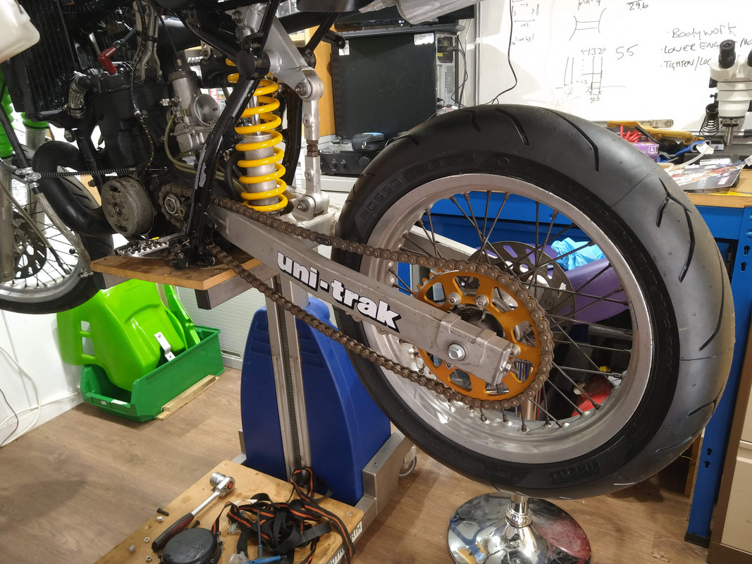

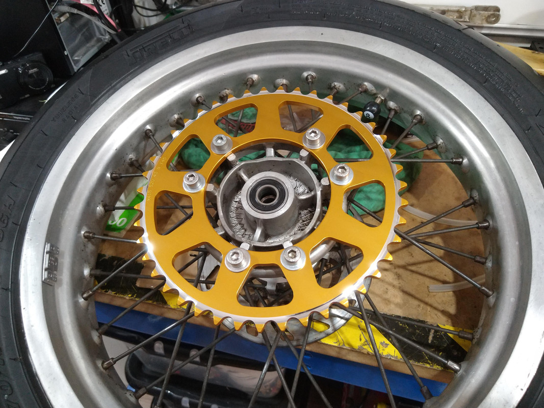

Re: The 10+ year KX500 rebuild thread
Sprocket arrived from Talon. I had to go down to a 13 on the front to get the best chain fitment, this gives a final drive ration of about 3.31.
And no, before you ask. It's still not running...
You'll be able to bump it/tow it now.
Vids pleeze.
Vids pleeze.
