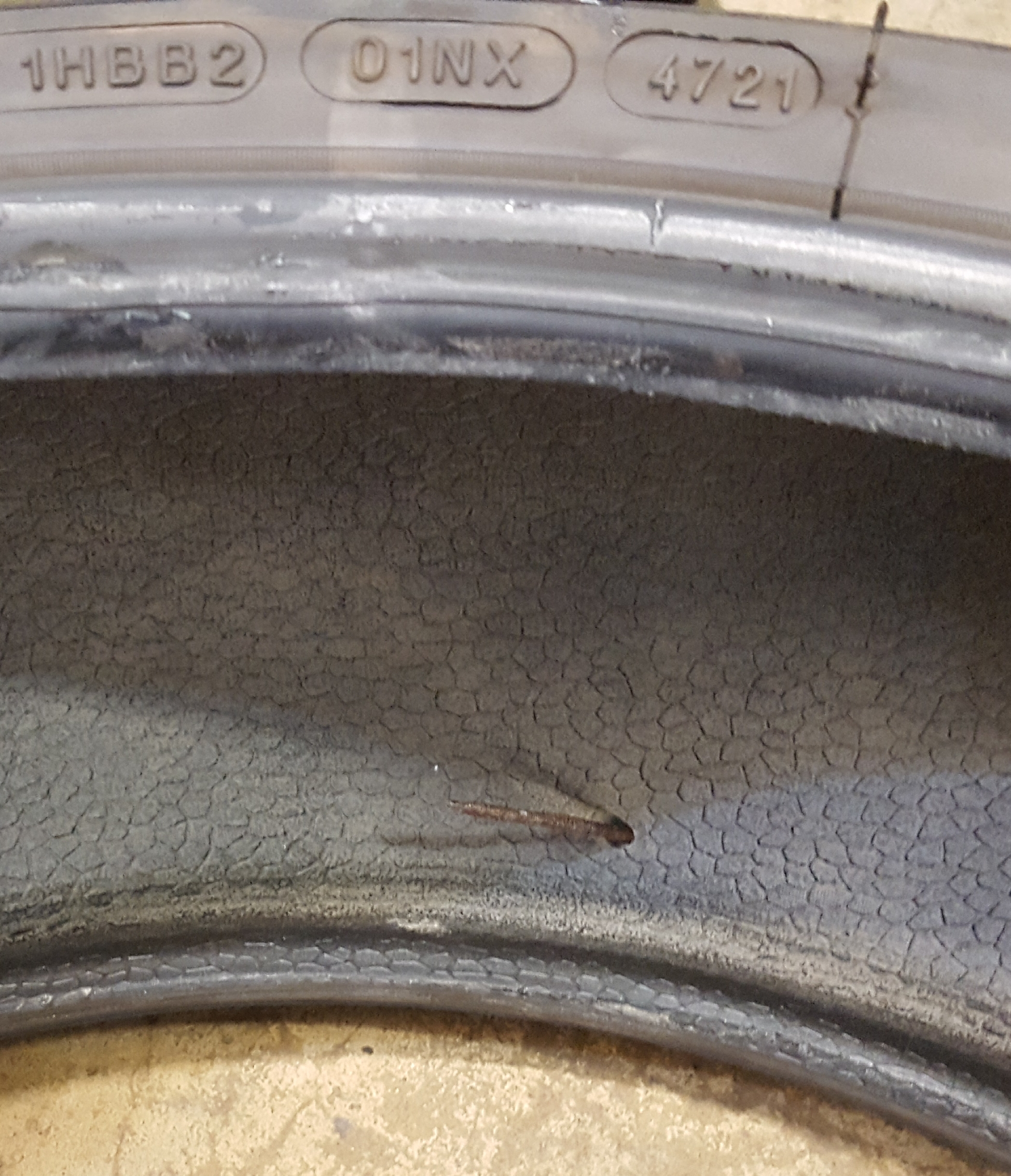

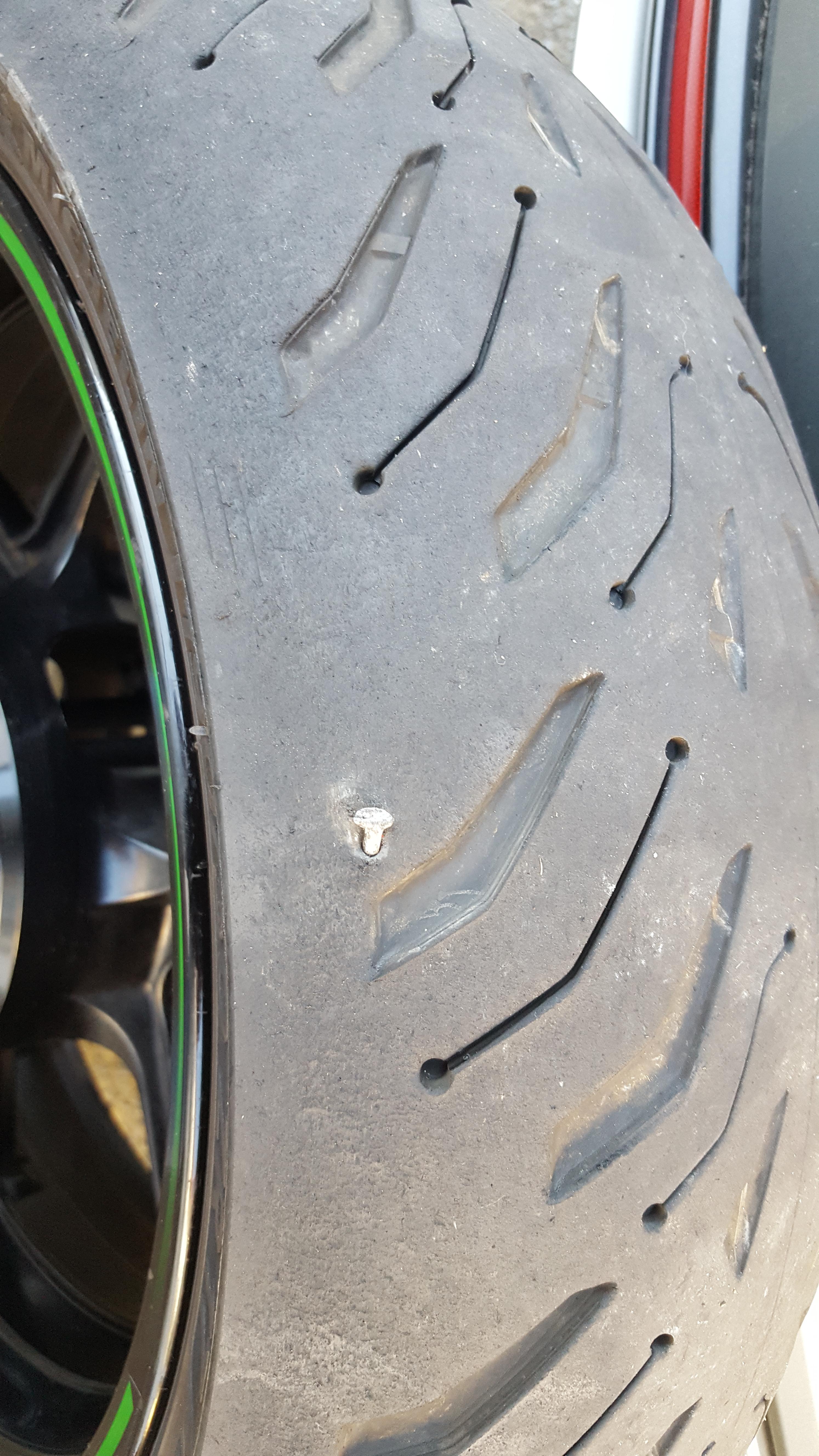

Mileage report on the rear Michelin Road 6 is fubared. I wheeled the bike out of the garage this morning and it didn't feel right. Further investigation revealed this. Not repairable as too close to the edge,so instead of heading out for a run,I had to load the wheel into the car and give the nice man £178.
3774 miles and I reckon another 500+ was possible,so not bad tyre life.

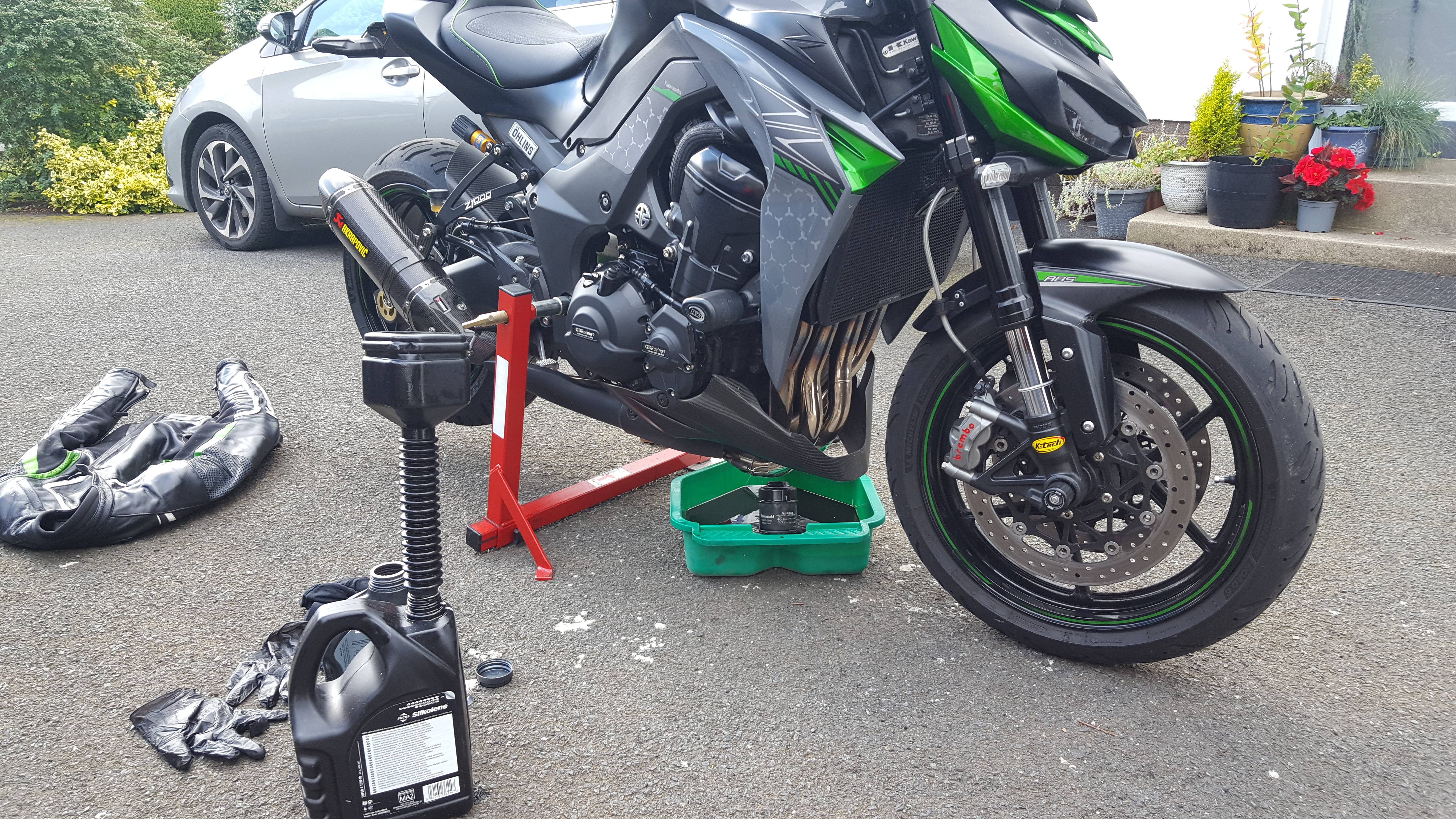

Great empty roads today,so I banged in a couple of hundred miles to take it up to 16k and oil & filter change.

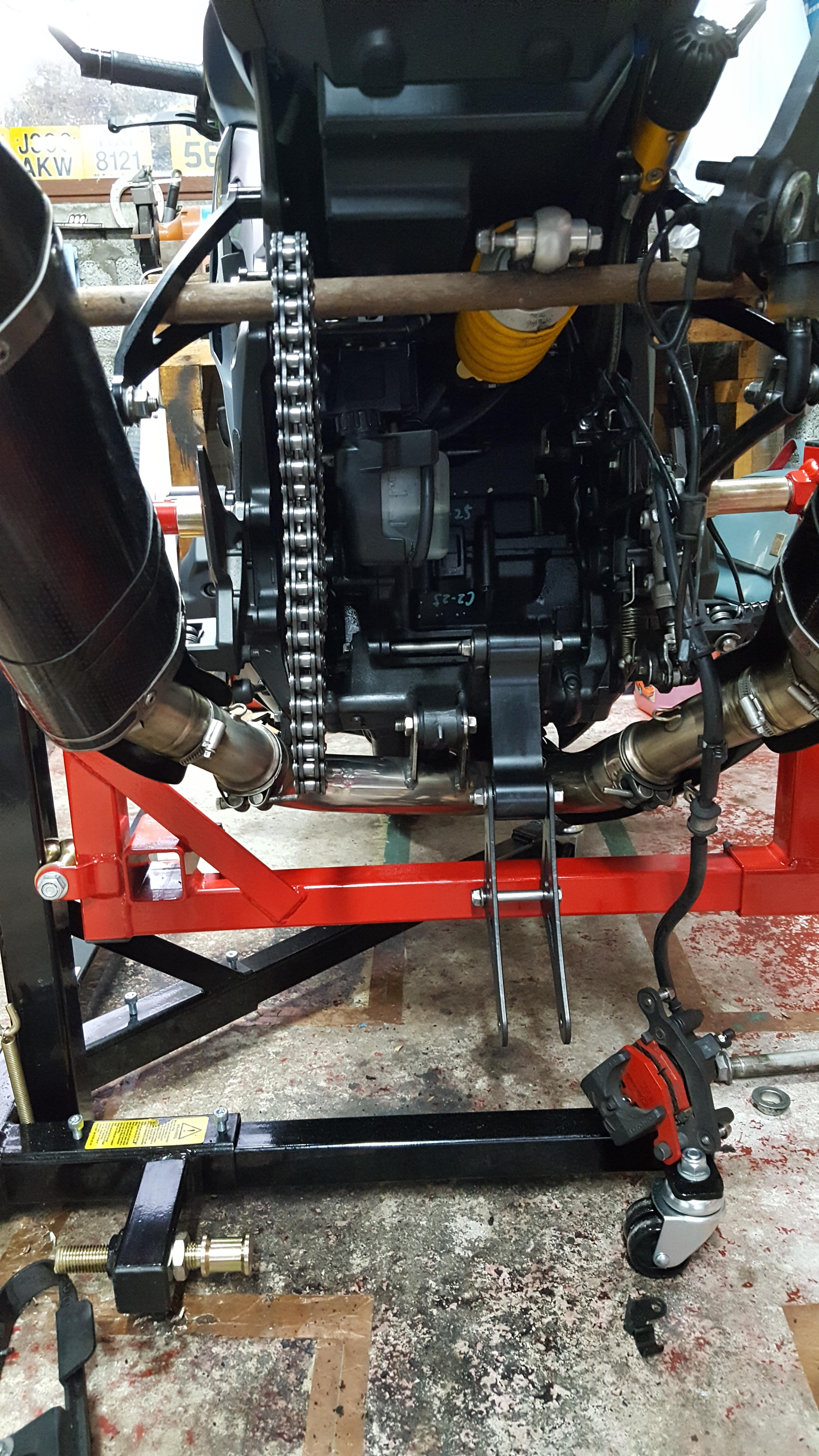

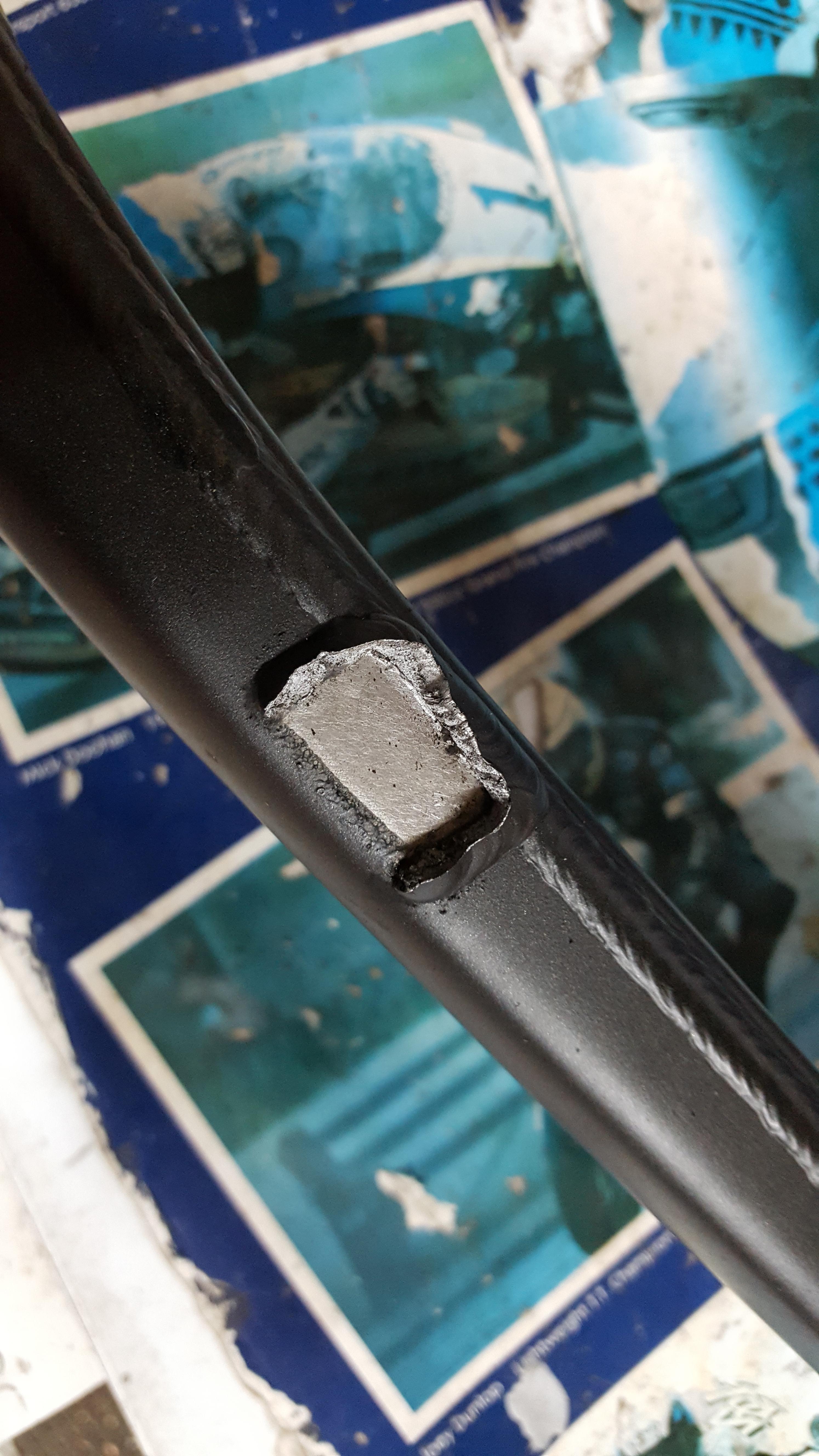

Ok then,time for a fuck up admission.
When I was lifting the bike in the wheelie position on the Abba Skylift I encountered a bit of resistance when operating the foot pump. I stopped and had a look around,but couldn't spot anything preventing the bike being lifted. With the wonderful gift of hindsight I should have stopped there,but I gave it another couple of pumps to see if I had imagined it....
What I failed to notice was the rear wheel had come in contact with the floor,so all the strain was being put through the swinging arm bobbin,which consequently tore itself off the swinger and will need welding on again. Most likely there will be heat damage in the course of the repair,so it'll need repainted too.
What.a.dickhead.
The swinger came out fairly easily and it'll give me the chance to lube the suspension bearings and swingarm pivot etc,while I'm in there.
So feel good about yourselves tonight,in the knowledge there are more stupid people out there...well,one anyway.
Off to the welders tomorrow.
PS Apologies to Weeksy for the dirt under the Ohlins. I promise it'll be sorted and all ACFed before assembly.
