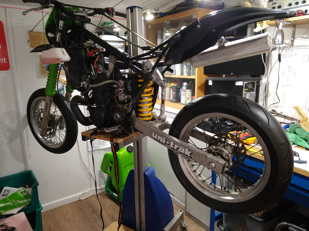

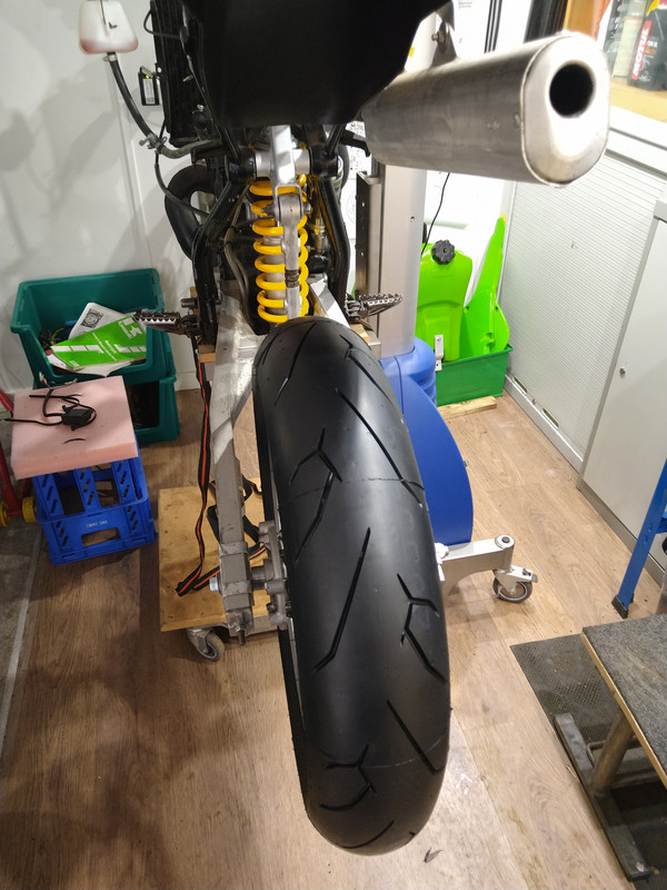

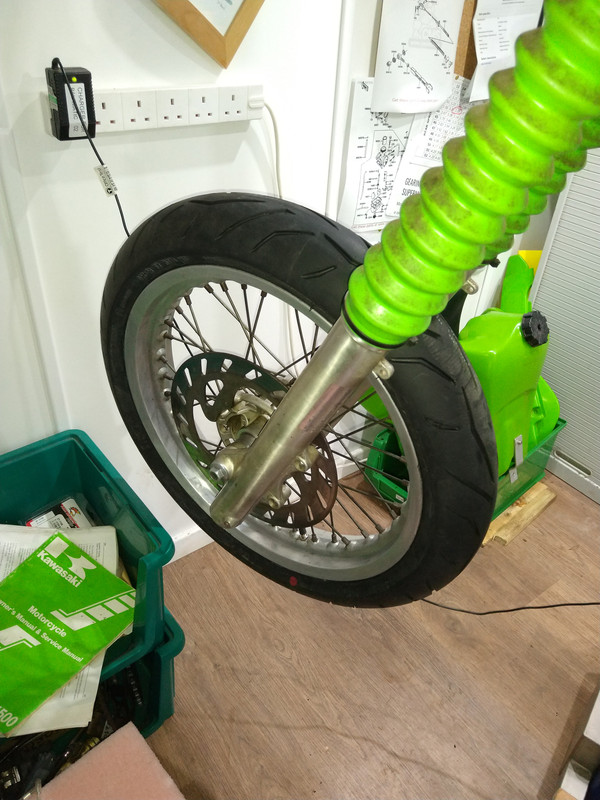

Got the tyres, tubes and rim tape fitted today.
Some more wiring tomorrow and continue to try and start it.

Potter wrote: Sat Feb 20, 2021 2:46 am When you said rim tape I shuddered and expected to see green tape around the rims, but ISWYM.
Oh hell no, I can't stand that tat!
GuzziPaul
Posts: 418
Location: Chelmsford
Has thanked: 59 times
Been thanked: 195 times
Re: The 10+ year KX500 rebuild thread
Post by GuzziPaul »
Them lime green gators look a bit manky next to the nice wheels and tyres.

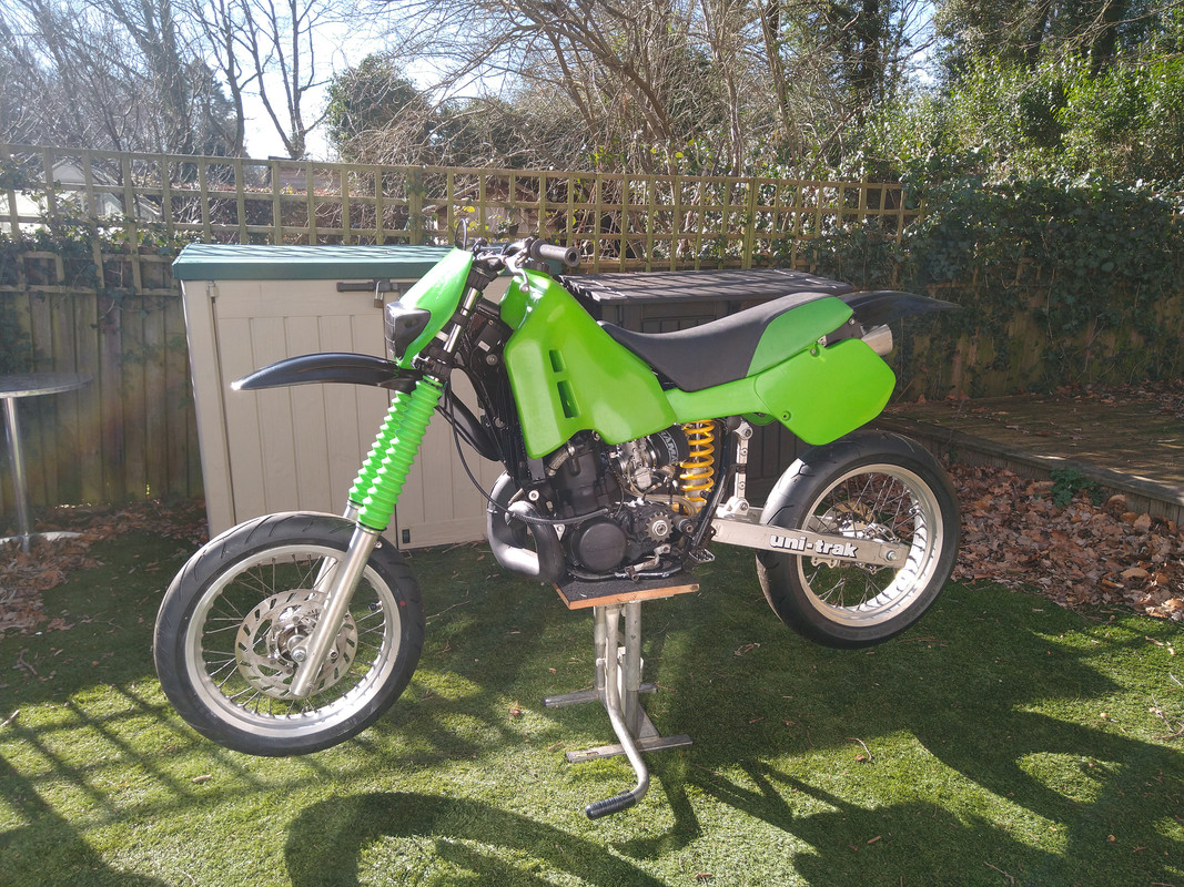

Because the sun was out I put it's clothes back on and gave it a bit of a wash.
Still not got it started though, it fires most kicks but only runs for a second or two at the most. I've had the carb apart (again) and checked the jet sizes are mixture screw are correct and it's got a reasonable spark. I guess it's just perseverance but I end up a sweaty mess and I've bruised the fuck out of the left side of my right knee after bashing it on the exhaust a couple of times. I'll be keeping the seat on there when I try again... :angry-cussingblack:
It's looking the part now man. :thumbup:
Get a tow and see if it starts.
derek badger
Posts: 1183
Location: Surrey Hills
Has thanked: 1091 times
Been thanked: 1756 times
Post by derek badger »
Skub wrote: Tue Feb 23, 2021 2:15 pm It's looking the part now man. :thumbup:
Put yer specs on you old git...notice something crucial missing from you plan?
Nidge
Posts: 537
Location: Oxfordshire
Has thanked: 684 times
Been thanked: 673 times
Post by Nidge »
derek badger wrote: Tue Feb 23, 2021 3:11 pm
Big enough balls? ;)
It's still on a stand?
Posts: 5463
Been thanked: 2730 times
Ignore him, he's just pulling your chain.
GuzziPaul
Posts: 418
Post by GuzziPaul »
Having only ridden CR and RM 250s, I reckon that will be quite silly when it eventually runs and has a chain connected.
G.P
Posts: 1948
Location: Wiltshire
Has thanked: 1994 times
Been thanked: 1283 times
Post by G.P »
Looks Ace Mr Badger. have you tried swapping the HT leads over? Its a common mistake. That and the cam timing.
If its not that, it could be that you've installed the wrong power band.
HTH.
:banana-wrench: :banana-wrench:
Posts: 3718
Has thanked: 1059 times
Been thanked: 1646 times
G.P wrote: Tue Feb 23, 2021 7:53 pm Looks Ace Mr Badger. have you tried swapping the HT leads over? Its a common mistake. That and the cam timing.
HTH.
Naah, I reckon its the starter motors too old and knackered.
Posts: 17506
Been thanked: 9497 times
It's the glowplug!
Posts: 5463
He might be more successful if he takes it off the stand.
