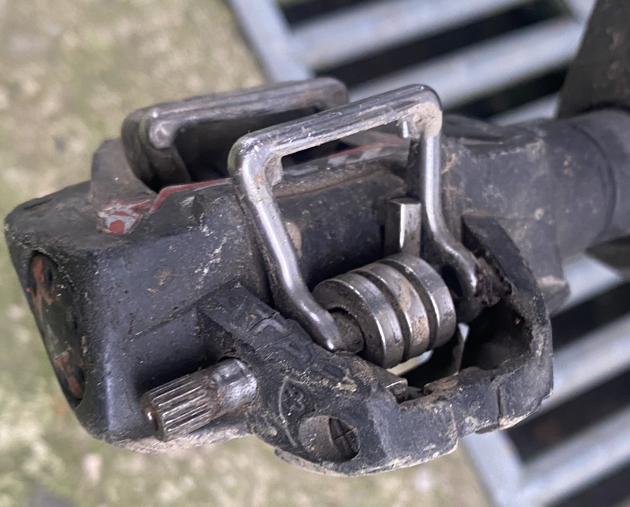

Riding home from the station this morning and one of my shoes wouldn’t clip in properly, thought I knew what it was so carefully pedalled home and on arrival my suspicions were confirmed, the spring pin had worked loose , nearly too loose as any further and the pedal explodes.
A bit of fiddling, pushing home and bodging with Sikaflex and hopefully good for a few more miles.
Posts: 26932
Re: What have you done to your bicycle today ?
It's not secured at the end? Or is it threaded on the other end?

weeksy wrote: Tue Feb 13, 2024 6:34 pm It's not secured at the end? Or is it threaded on the other end?
Nope, it relies upon the knurling holding it too the plastic pedal body, it works OK but as they age it becomes a weak point and the pin can work loose, shame as they are brilliant pedals for me.

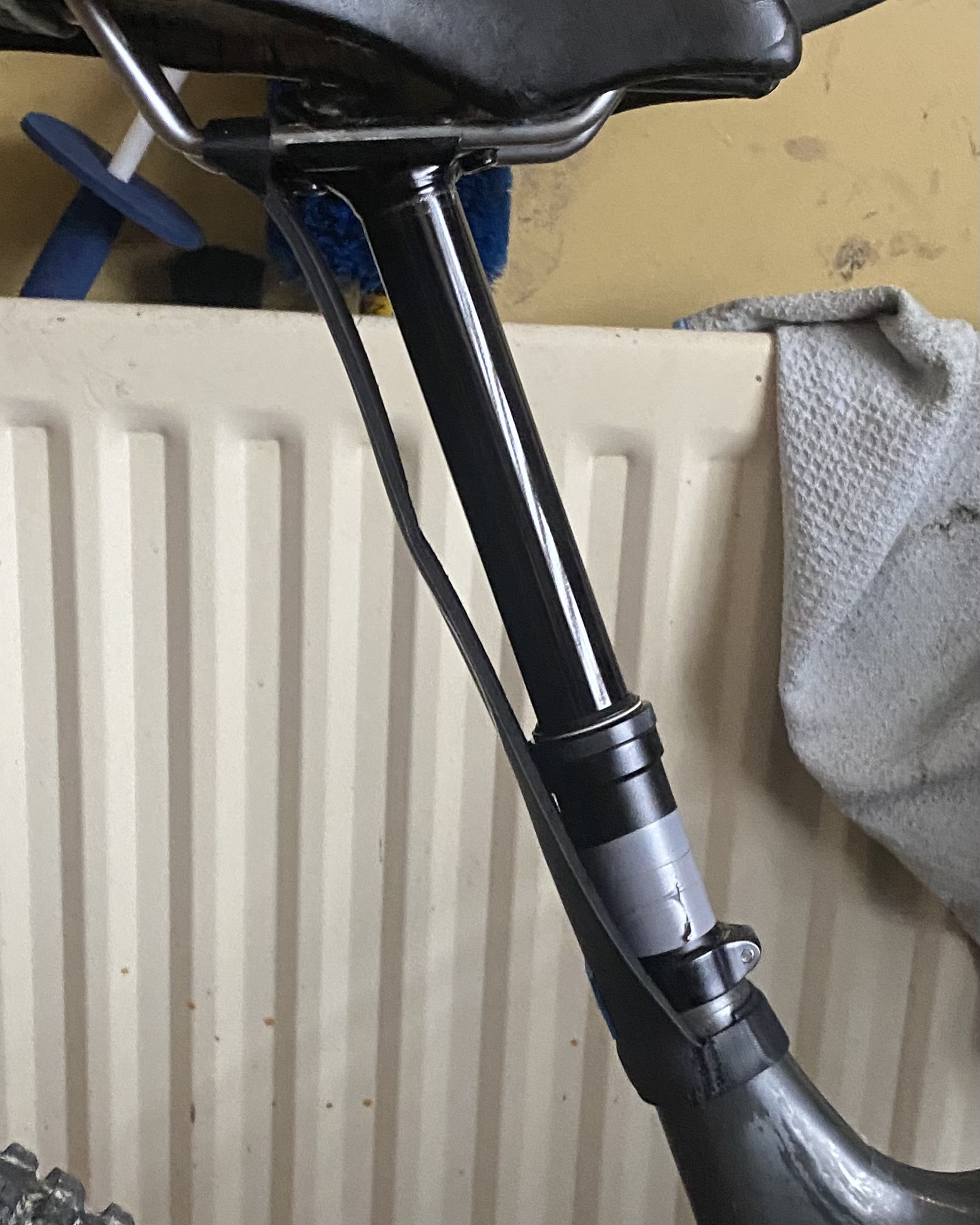

Fitted a new dropper post guard after I put the other one ina “safe” place last year and had to strip a rebuild the dropper the other day after a couple of months of muddy rides without it being fitted .
Posts: 26932
A what now?
Posts: 4435
Has thanked: 3644 times
Been thanked: 2502 times
One of these, helps keep the mud off the post.

MingtheMerciless wrote: Wed Feb 14, 2024 9:30 pm One of these, helps keep the mud off the post.
Does it actually work?
Posts: 4435
Yep stops the dropper stanchion becoming completely encrusted in tyre fling. It does get a bit dirty but nowhere near as bad as if you don’t run one.

Broken it, my pedal "fix" lasted two rides before the pin and spring ejected itself 12 miles from home (I suspect at the top of Firle Beacon). FFS. Now no one has either XC6 or XC8's in stock at a sensible price.
