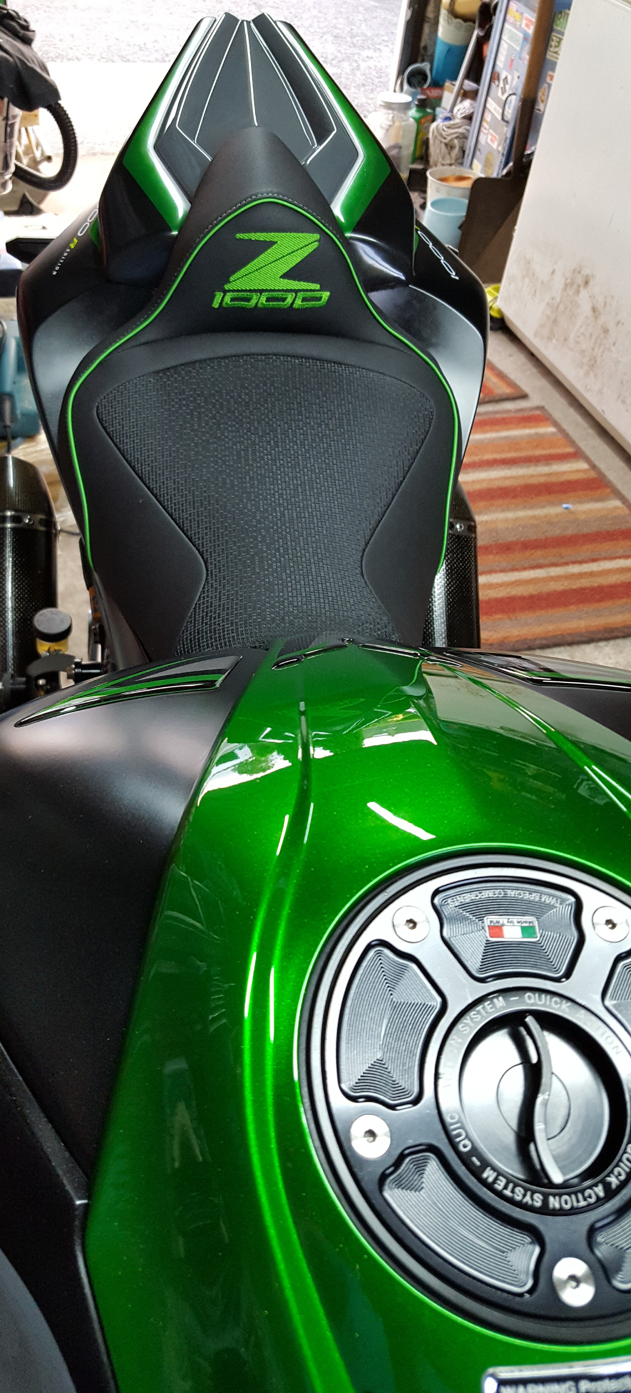

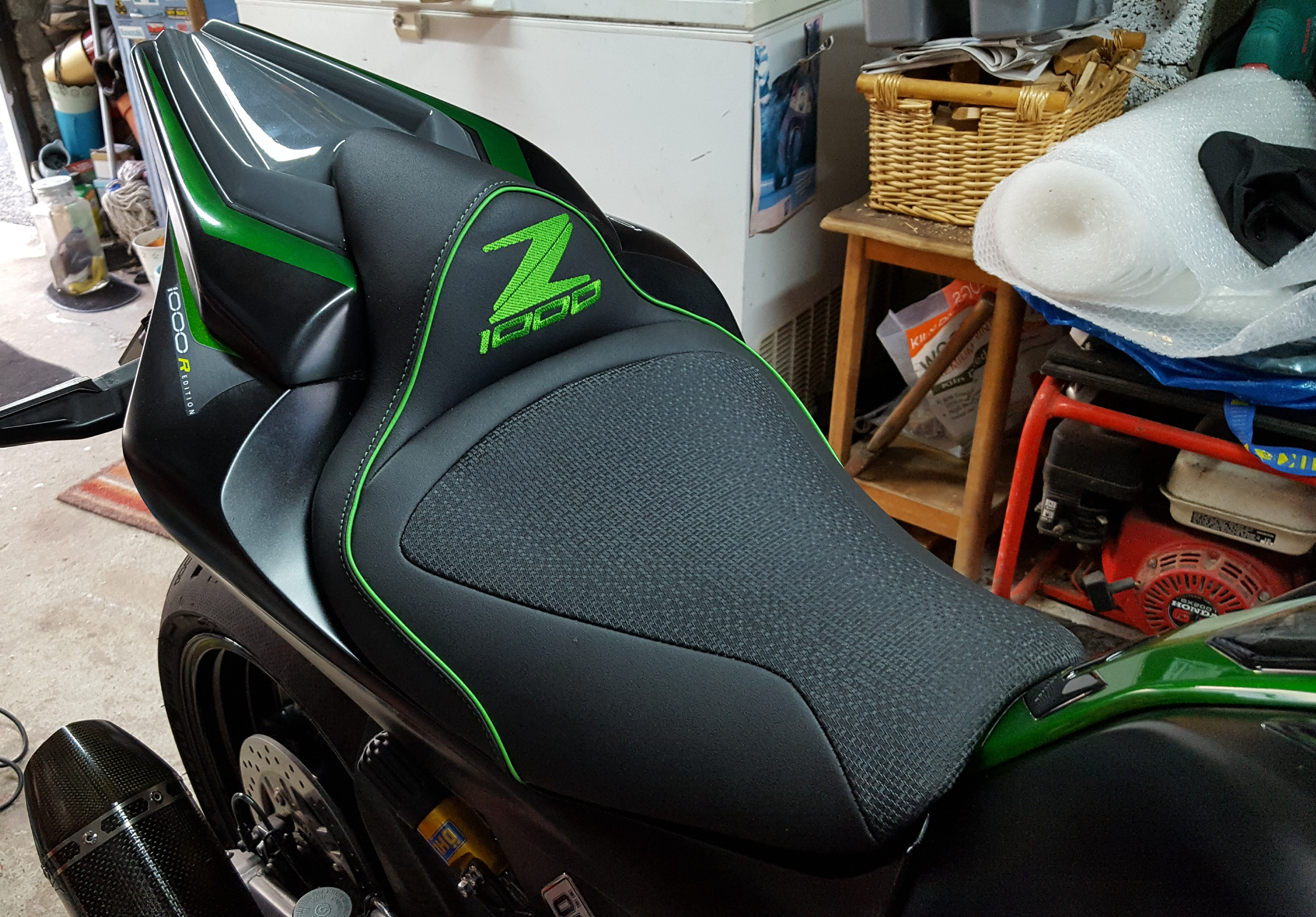

For anyone thinking of one,mine required a bit of fettling to fit the way I wanted. I've no use for a pillion perch,even though you get one,but if I wanted to use it,then it would need a lot more work to fit than the rider's seat. A bit disappointing,considering it's not a cheap item.

After some deliberation,I finally bit for a Bagster seat. Hopefully it'll be a bit more comfy over distance. Might save me waddling about in gel cycle shorts,like I've papped me trunks.
