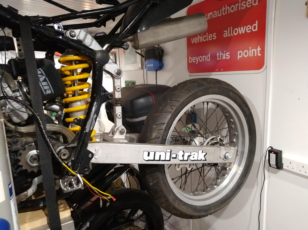

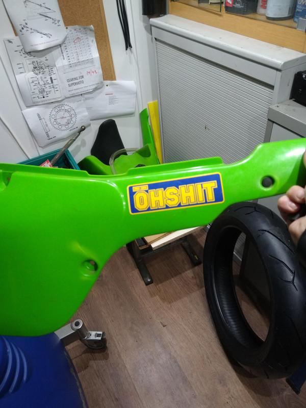

Today I removed the decals I put on years back with the exception of the the swing arm and a comedy one I quite like. I've got some period repo ones coming on the post and I found a set of rad shroud ones in the back of the shed that I might be able to do something with.

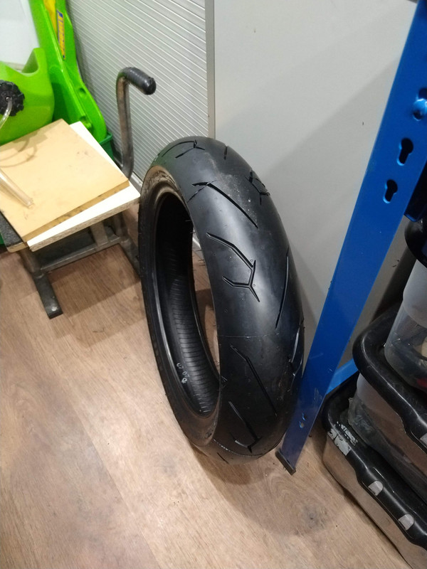

The first of the tyres turned up as did a pair of new Michelin inner tubes.

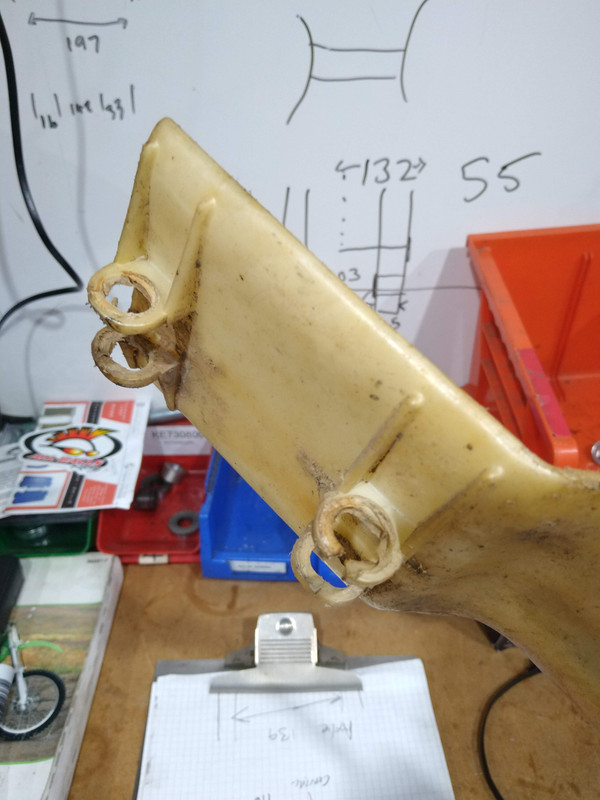

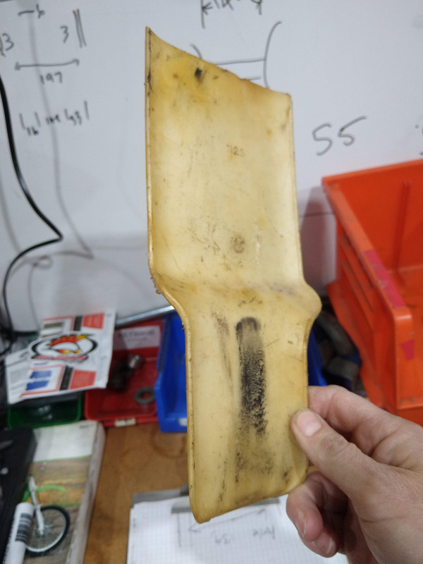

I need to come up with a solution for this monstrosity. It's the mud flap that attaches to the suspension linkage. Several of the mounts are split and it's ugly as fuck. Once again it's a discontinued part, so I either need to find something else to use or bodge it with penny washers.

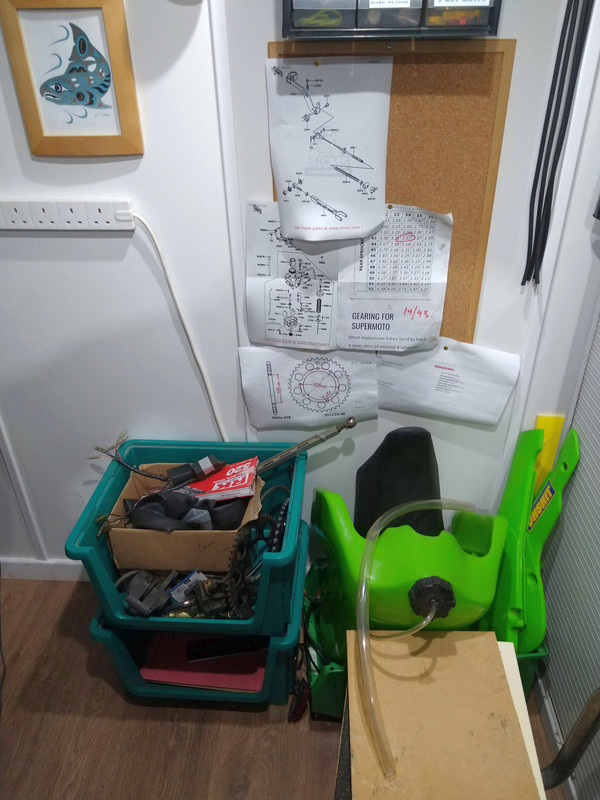

Parts ready to fit and the various schematics/diagrams I've been working from. A white board and a pin board have been very useful during the build. CDI is with DHL and should be with me next week and sprocket is ordered. Don't think there is anything else major outstanding at the minute, need to get a kill switch, pushbike speedo and horn but I've got all the other wiring materials to make the small loom. Might leave the lights until after the first MOT, but if things progress smoothly I'll take a look at fitting a dipped/high, rear and brake light.

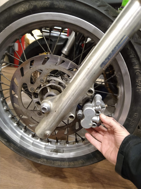

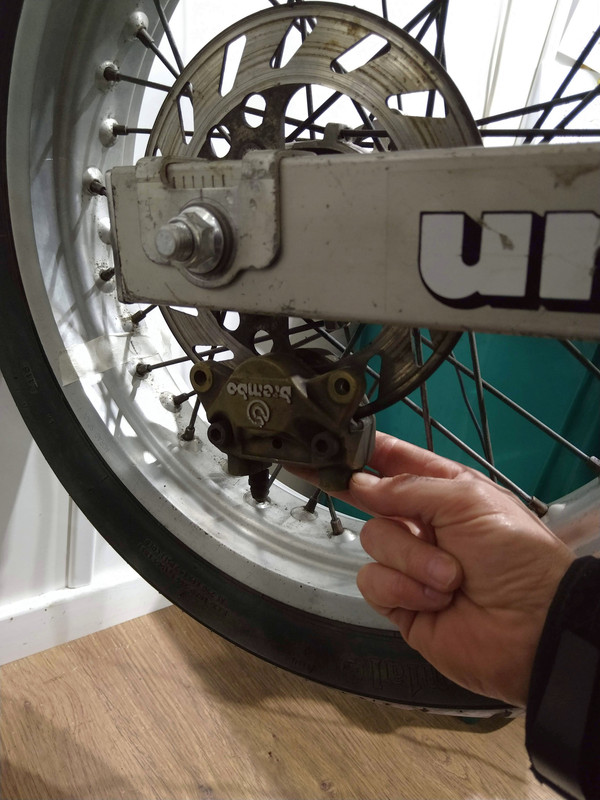

I think I've settled on the brake set up. Sliding 2-pot at the front, chose one with a flat mounting plate that I can take the pins off and attach to the bracket I fabricate. 2 pot opposing Brembo for the rear.

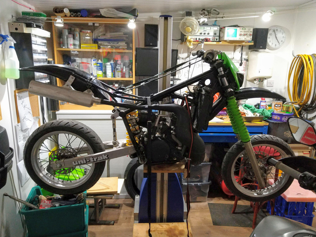

Front axle spacers now mocked up in plastic pipe so both wheels are central in the forks/swing arm and the dims have been given to Cheb as he's kindly offered to turn them up on his lathe. Top bloke.

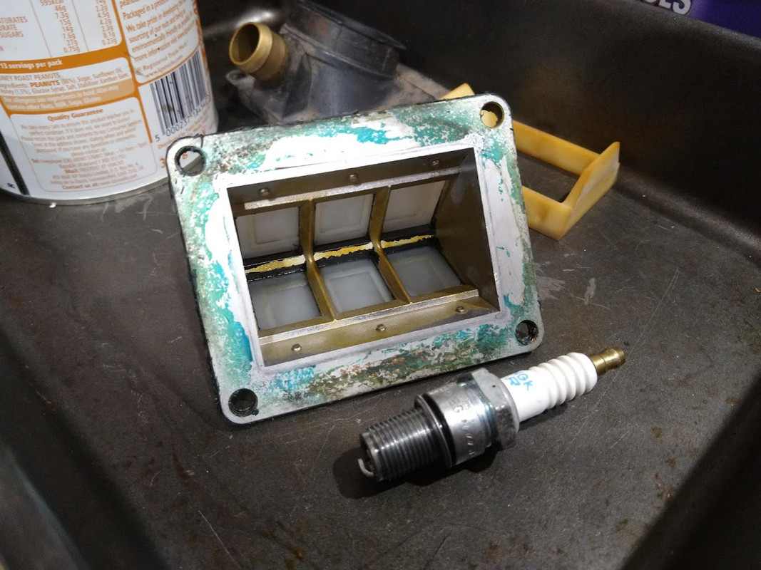

CDI unit arrived and is well made with the correct colour wires and terminal genders. Fitted it and it produces a decent spark, however I couldn't get it to fire more than a couple of times and then it wouldn't fire at all. Plug was wet so I suspect it was flooded, turn it over a few times by hand with the plug out and leave it until Saturday.
Same again on Saturday, and I give up as my right calf is fucking killing me. Sunday I take the carb off as I notice there is a puddle of petrol on the floor. I then take the intake boot off and the reed block. Fucking hell, I forgot how big the 6 petal Boysen reeds and the intake/transfer ports are!
Peering in with a torch I can hear the sound of premix sloshing about and have a think about how to drain the crankcases and remember I've got a Mityvac in one of the drawers. About 200ml came out! Looks like the needle valve on the carb isn't seating or the float is sticking so I've got the carb (and a spare one) in bits and will try and get it rebuilt today/tomorrow.

Replaced the valve and tweaked the float height. Seems okay now.

I ran out of patience and time last night when it lost spark. I'll be cleaning all earth points, trying a new HT lead and checking the stator again today.Potter wrote: Tue Feb 16, 2021 7:44 amSo does it run?derek badger wrote: Tue Feb 16, 2021 6:33 am Replaced the valve and tweaked the float height. Seems okay now.

Always, always, always try a new plug first.

I've got 2 new plugs. A BR8EG and a BR8EG, both have been in boxes for 10 years unused.KungFooBob wrote: Tue Feb 16, 2021 8:56 am Always, always, always try a new plug first.

Always, always check the wiring is connected correctly after you disconnect things when you've been drinking cider. The 2 x wires from the CDI to the coil and earth are B and BW. The two wires from the coil/kill switch are B and B...I've now marked one of them with white tape.derek badger wrote: Tue Feb 16, 2021 9:14 amI've got 2 new plugs. A BR8EG and a BR8EG, both have been in boxes for 10 years unused.KungFooBob wrote: Tue Feb 16, 2021 8:56 am Always, always, always try a new plug first.
