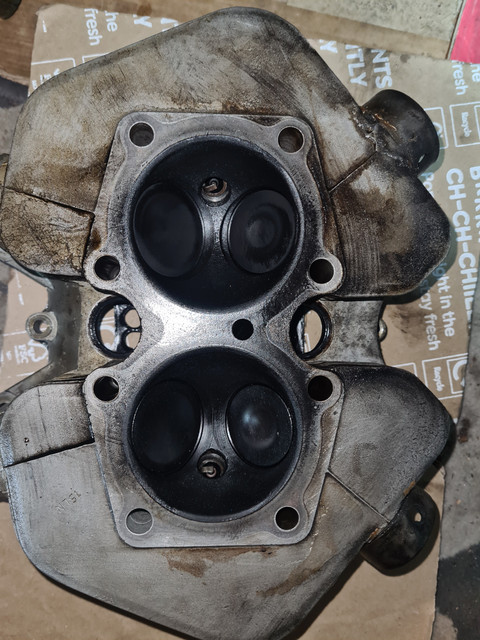

Cylinder head came off nay problem.
This is maybe 700 miles since it was last off and shiny clean. I always feel like reading pistons and cylinders (and indeed spark plugs!) is a bit like reading tea leaves.
This black stuff in harder than finger nail hard, but soft enough a bit of wooden dowel can shift it. Slightly concerned by the amount of black on the gasket faces on the cylinder head at about 3 o'clock, but see above comment.
The bores look lovely though, still got the honing pattern and the pistons move up and down with a really satisfying tsssskkk sound.
Rocker boxes and push rods are all shiny and slick moving, as well they should be after only 700 miles!
I tried to work out if the coils are OE Lucas but couldn't. They do proudly display the fact they were made in West Germany though, so that dates em a bit!

Are the block faces supposed to have that quite noticeable cross hatch pattern? The bores, yes, as the micro grooves retain oil, but Shirley the cylinder head/block sealing surface should be as smooth as possible? Those micro-grooves are simply providing a potential path for cylinder gases to escape, aren't they?
Please shoot me down in flames if I've got this all wrong, but that's how I would see it.
Re: Classic Triumph Bonneville
The bores are meant to have the cross hatch for oil retention...shoulda done a pic with the pistons 'down' really!
The sealing faces are meant to be smooth yeah. They pretty much are TBF, those lines are (I think) the original Triumph milling marks, you can see em but you can't really feel em. It's a result of machining the parts with something like this...

Hmmm, OK. But that would get my spidey senses tingling...
