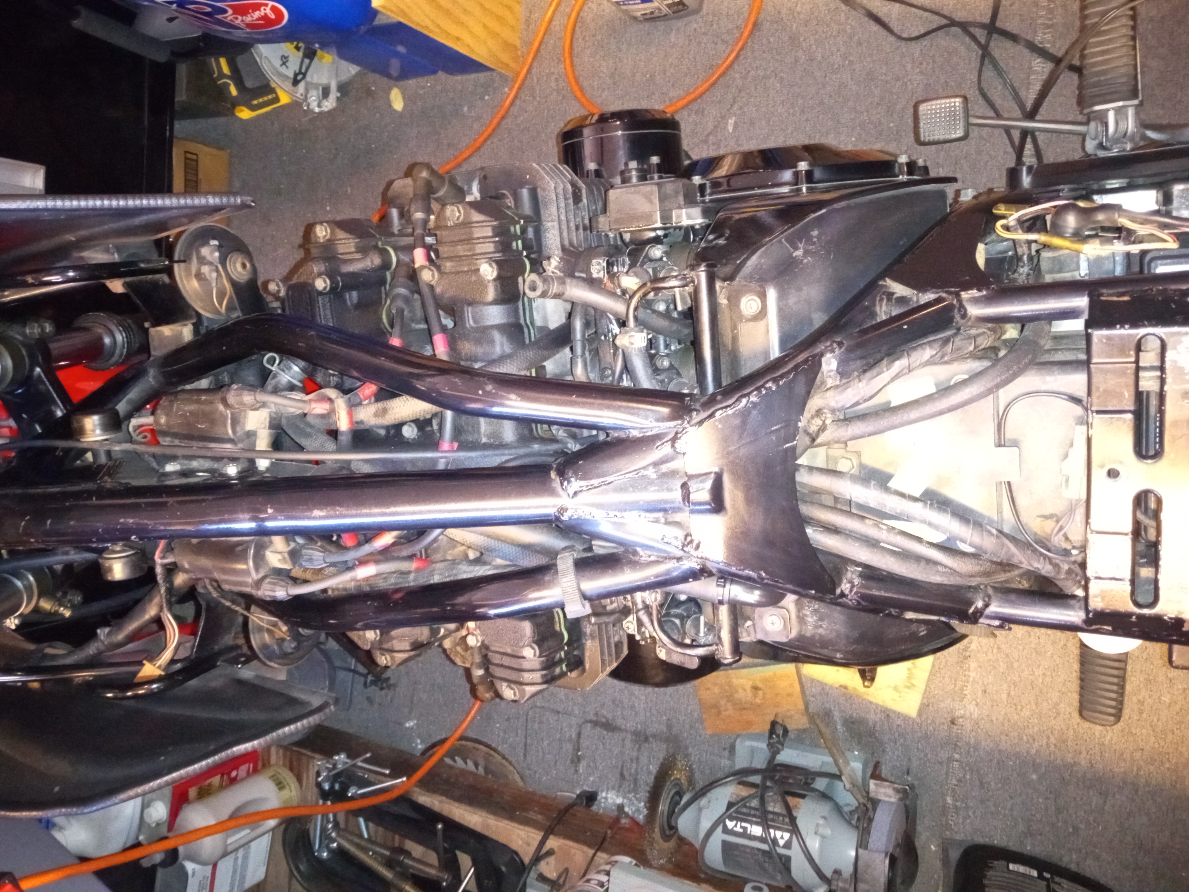

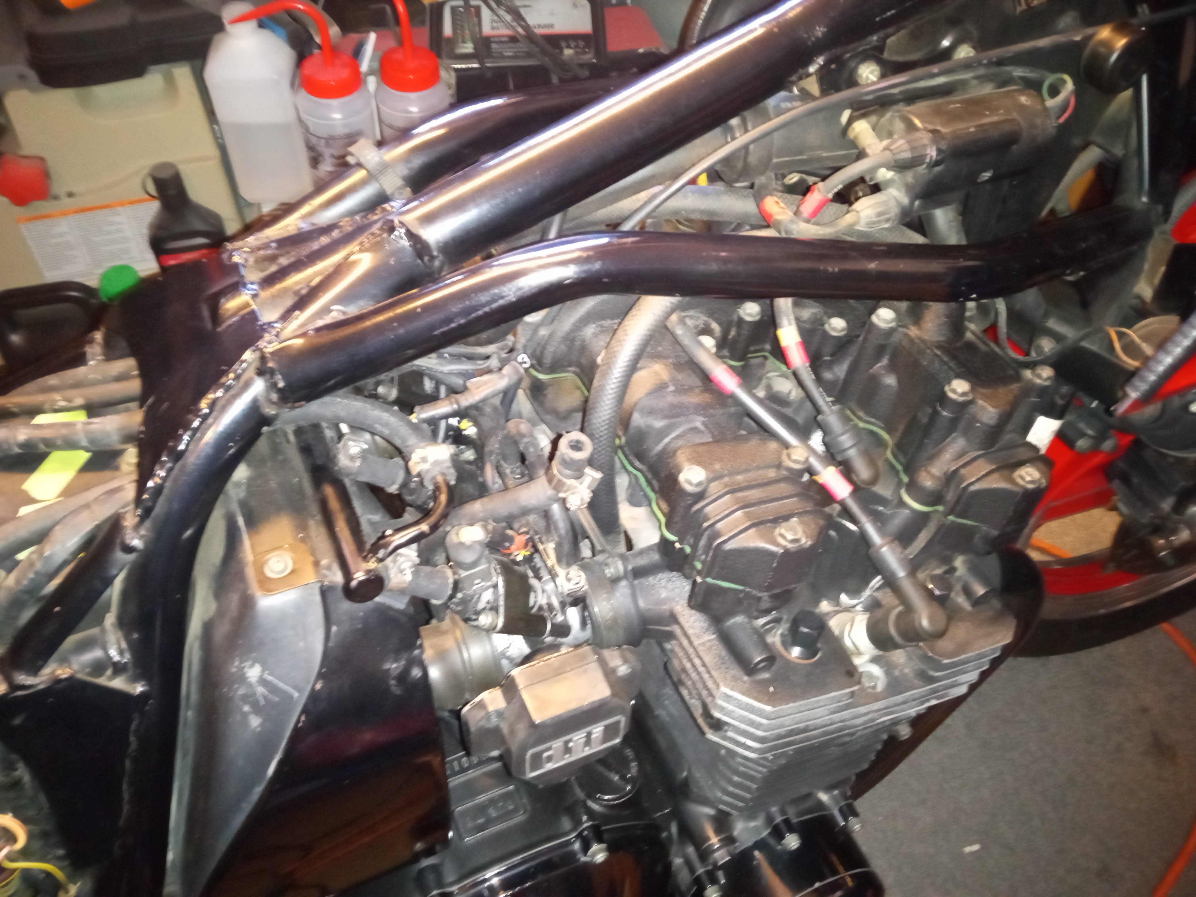

Re: '83 GPz1100-A1 Stuff.

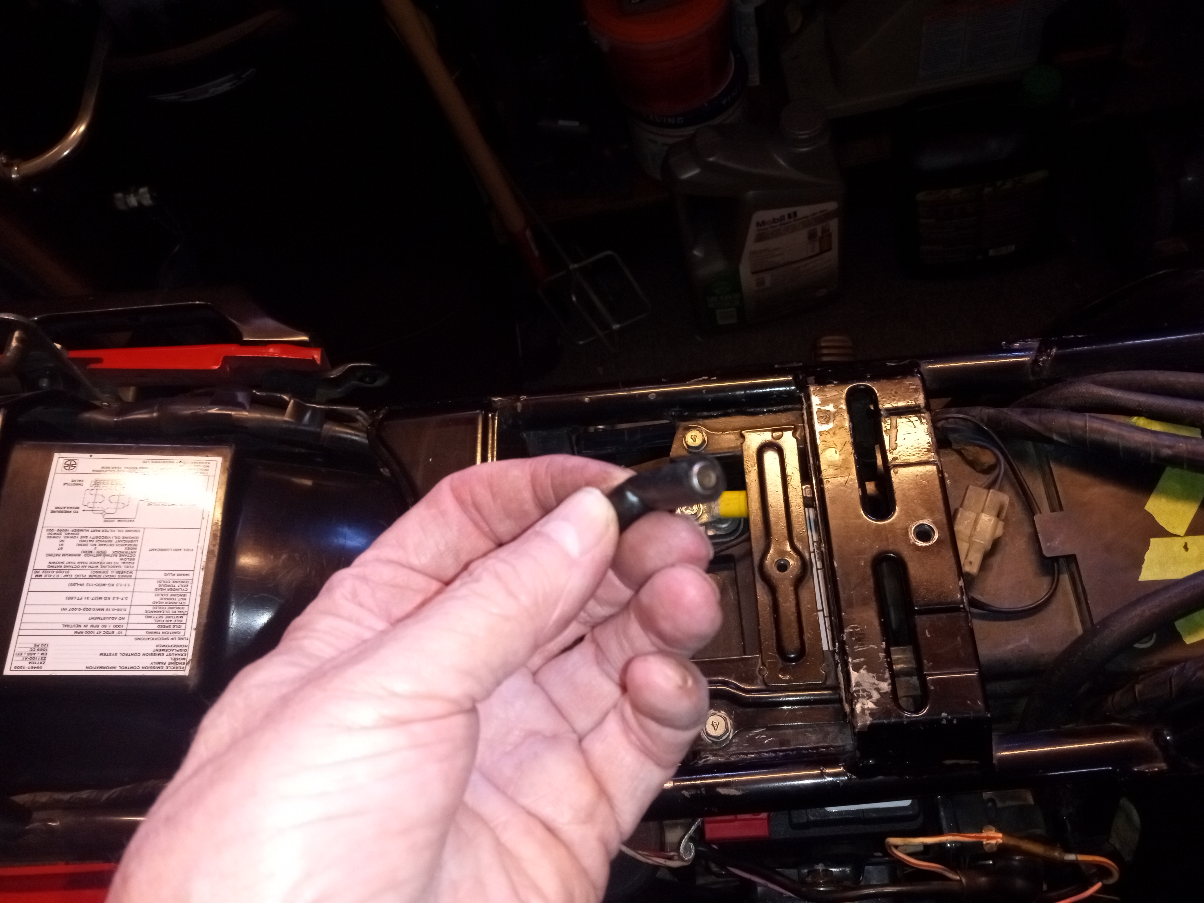

Went back out to the garage for another 20 minutes
Sorted that crossed HT lead deal on the #2-3 coil (middle pic above). Swapped out the half assed terminals on the battery tender leads for ones that actually fit the M6 bolts on the battery posts. Added wire wrap to tidy things up & shrink wrap on the new wire terminals
Took a look at the new (less than 200 miles) fuel filter, no clag/snarge evident. Also: fuel flowed fine when draining tank with the tap on either position.

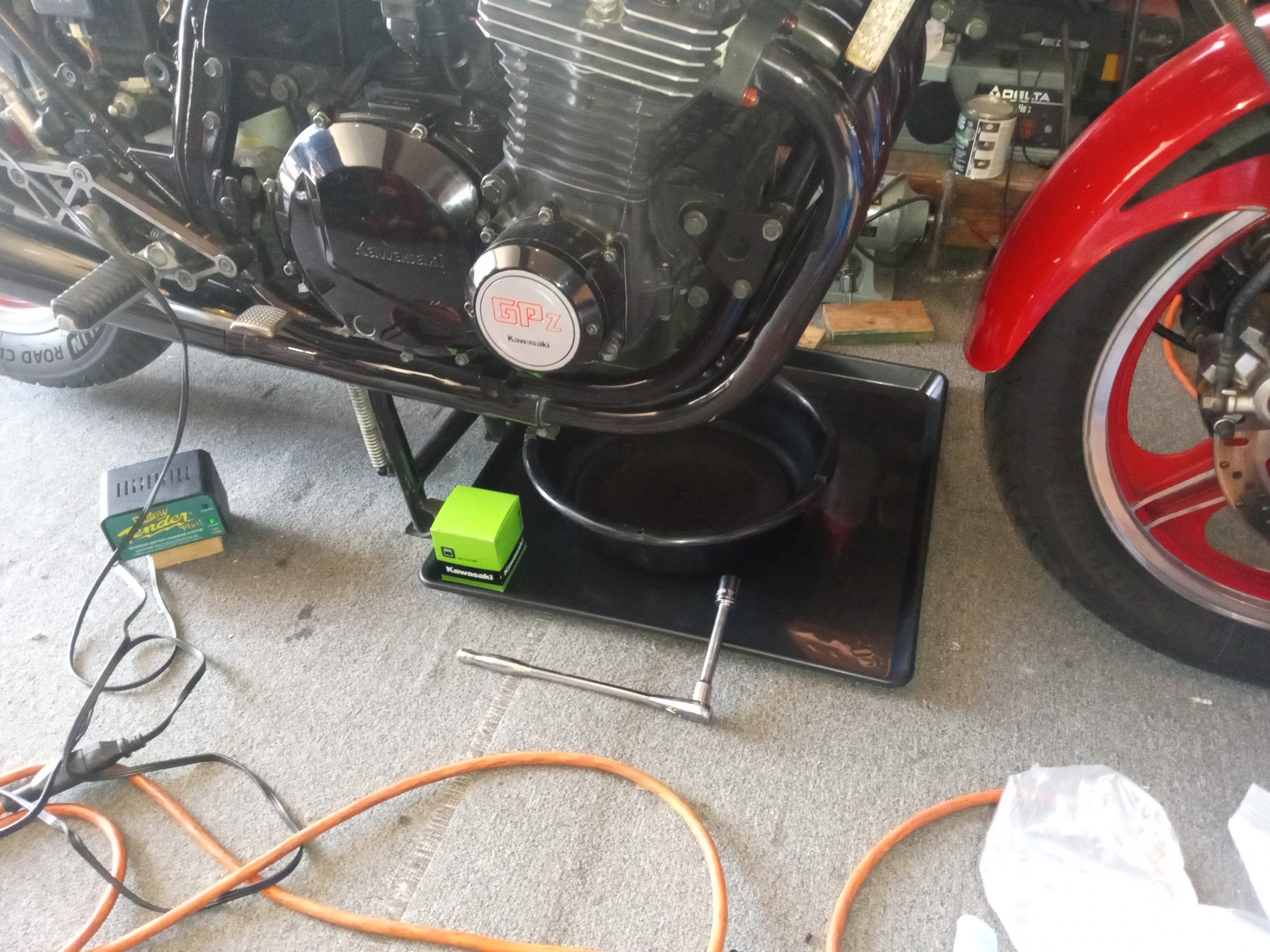

Oil change is progressing slowly, all I've done so far is put a drip tray near the bike (3 days ago). Might manage to put the bike on the mainstand today... No progress at all Thur/Fri as it was 101deg.
Progress!

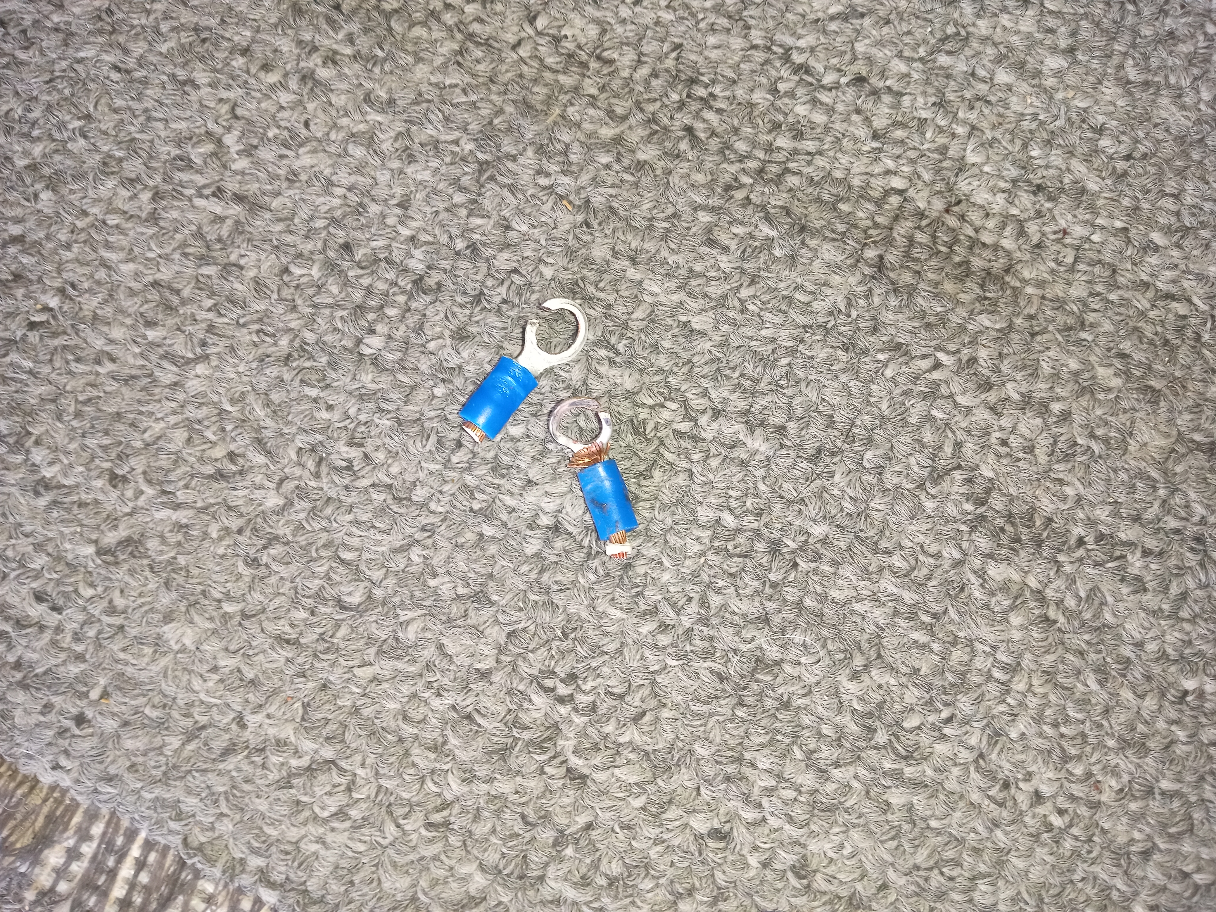

Two of the half-assed wrong size terminals I replaced. They were on the wires attached to the battery posts for the battery tender.
Removed the drain plug & dropped most of the (really stinky) oil into the pan, still have to pull the filter... (may even manage that today) I have a sneaking suspicion that the washer, cup and/or spring may be AWOL. Luckily I have spares.

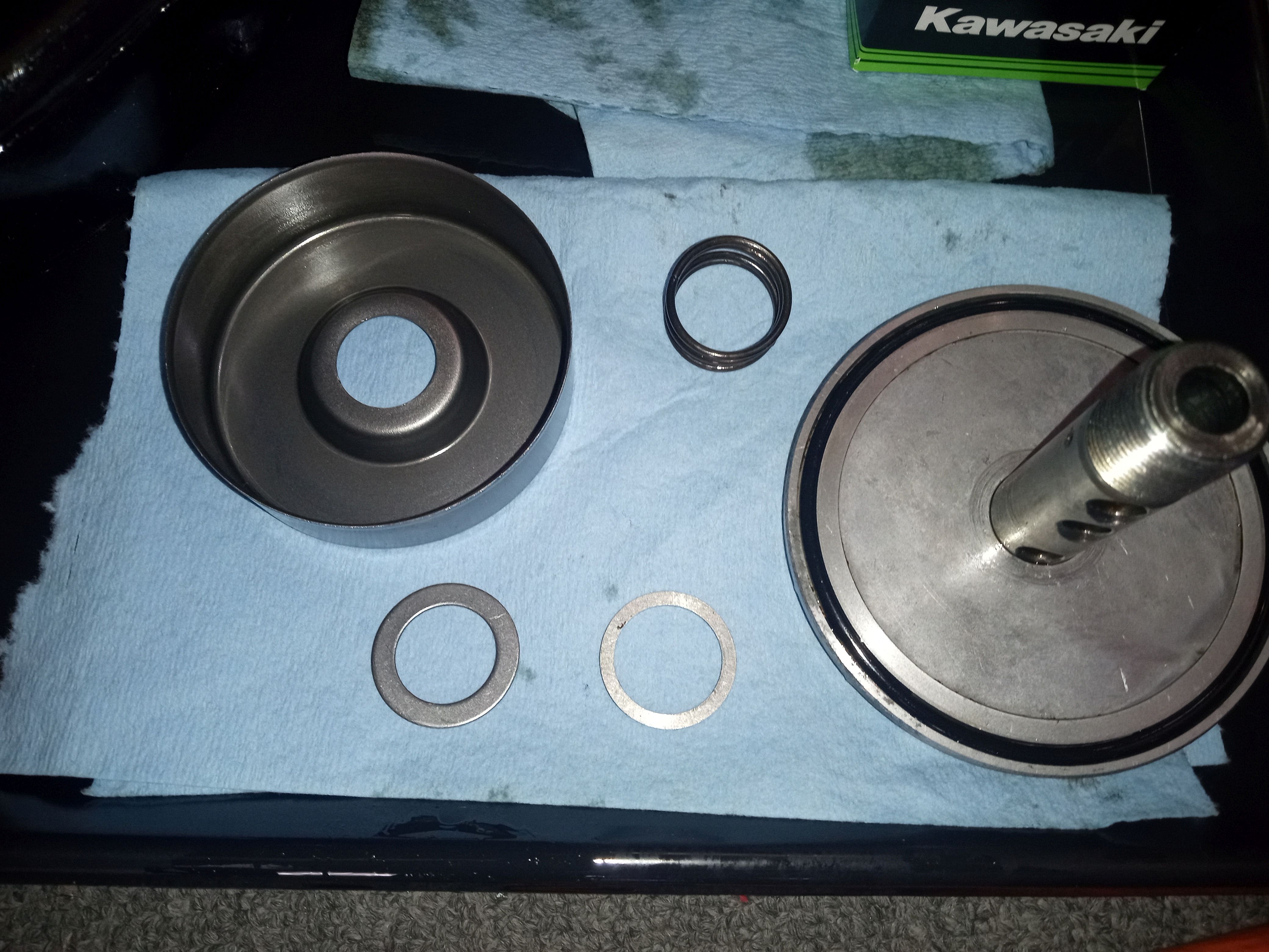

More progress!!
Dropped the filter. Cup, spring & a washer all present.. however, it was the wrong washer (right), I have the correct washer (left). I even remembered to wrap tin foil around the right side headers so they didn't get coated in oil when I loosened the filter plate (not an issue on the ZRX11 or ZX11). Put the drain plug back in the sump.
Filter plate was jet black with snarge, so the bike will likely get another oil & filter change after 1000-1200 miles

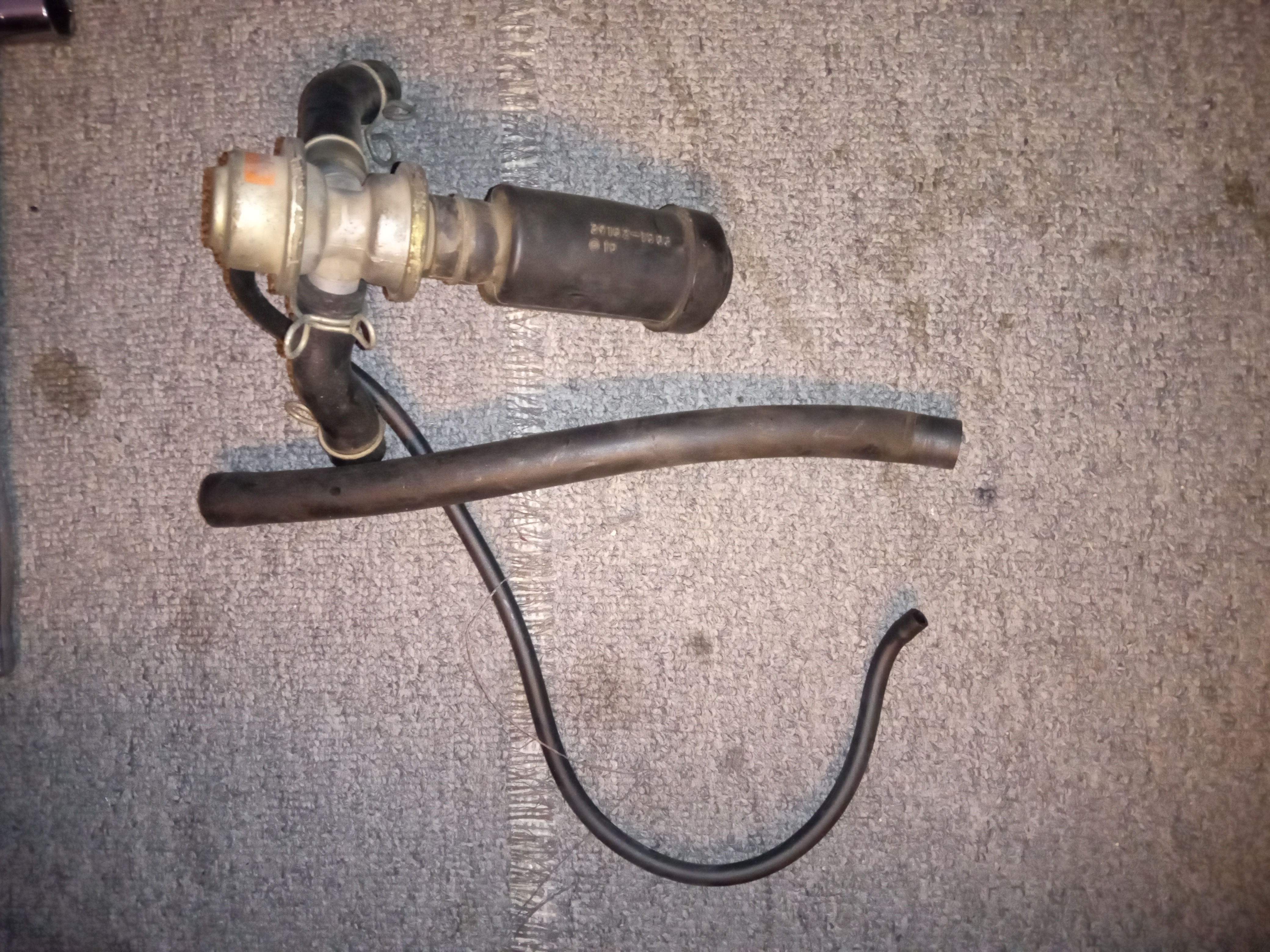

Will also remove the worthless smog system crap* while I have the tank off, need to swing by APE out by Willow Springs to get their spiffy block off plates.
*AKA "The Octopus"
*AKA "The Octopus"
- Posts: 9038
- Has thanked: 2287 times
- Been thanked: 2672 times

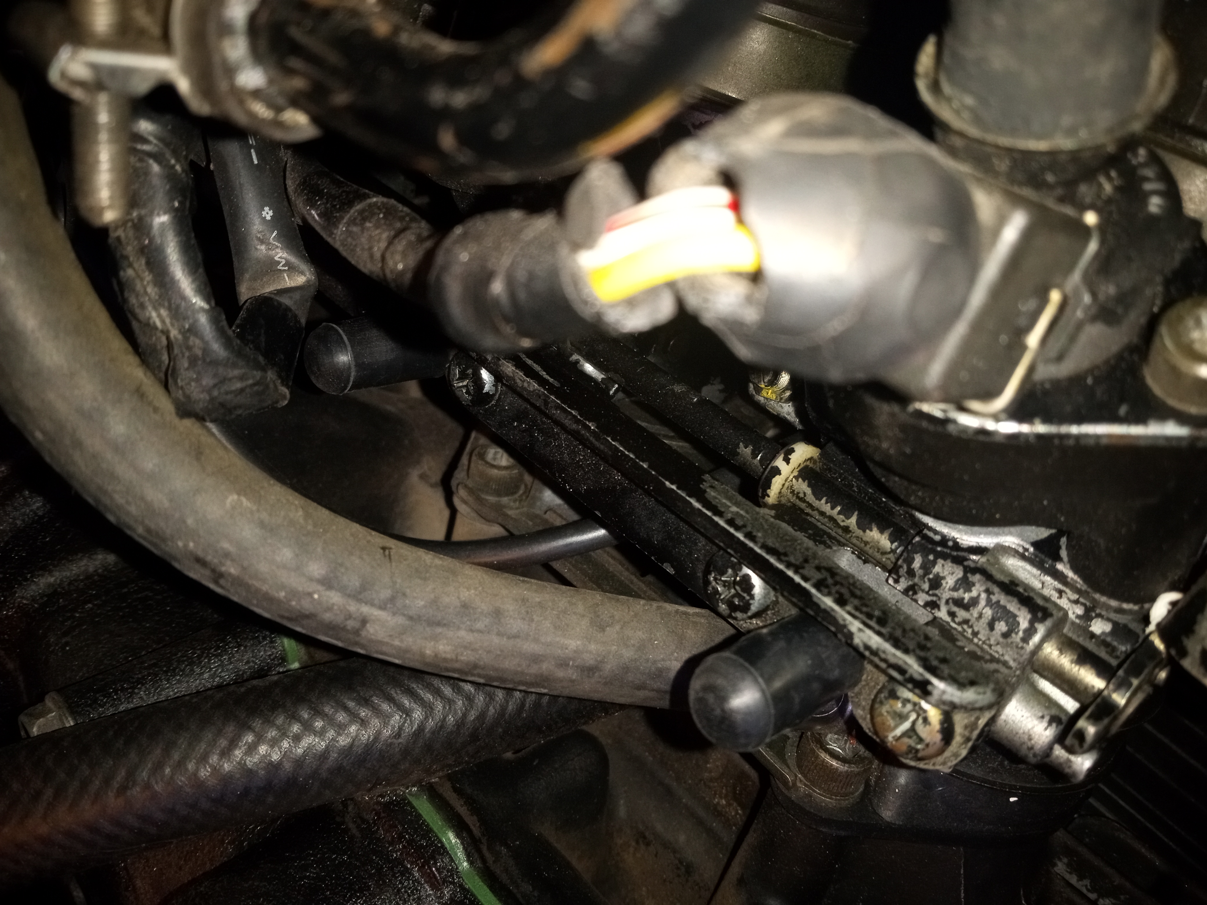

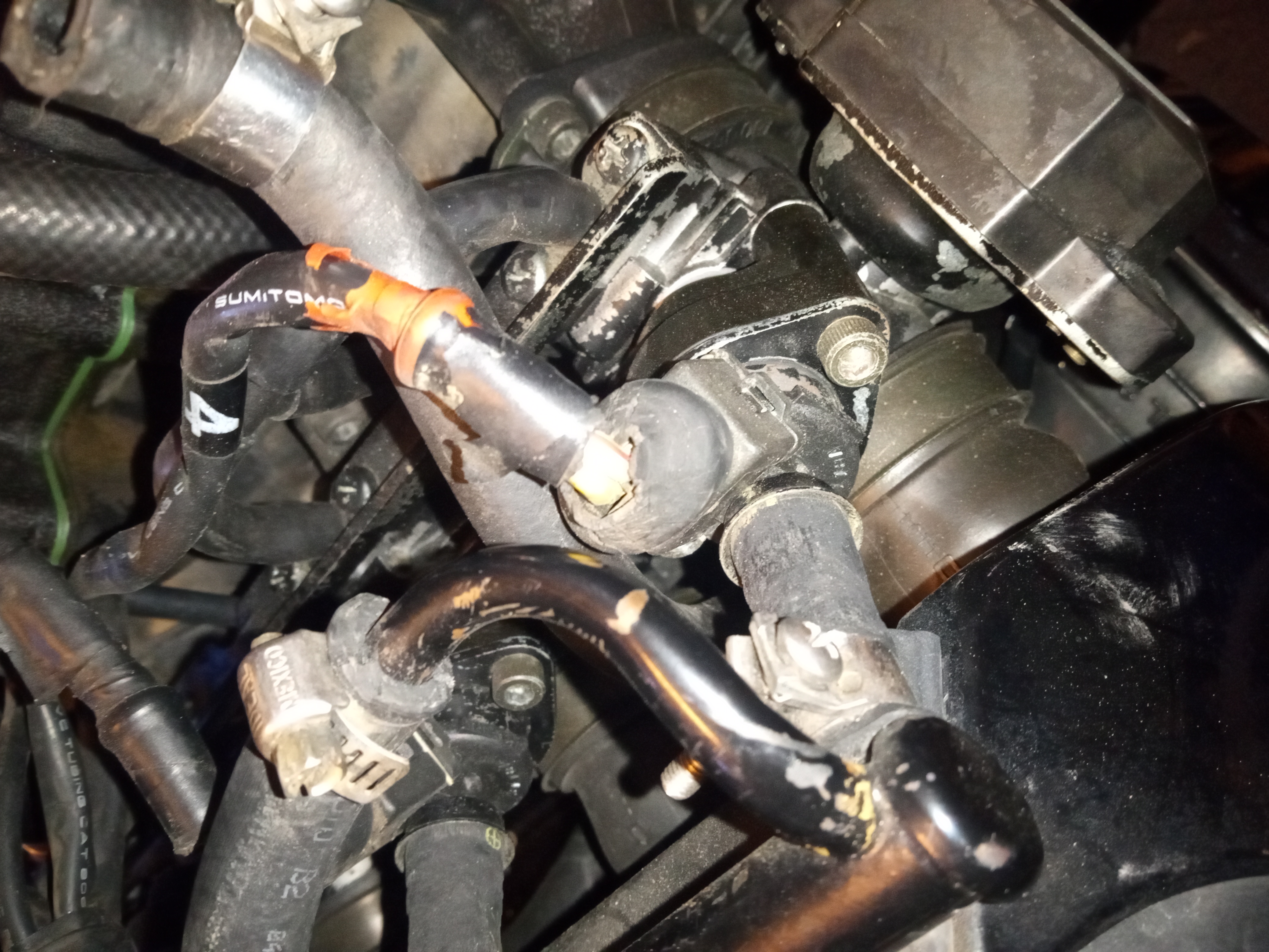

Oil filter assembly er, assembled & installed back on the bike, added oil, but can't run the bike yet to fill the filter.
Octopus is now off the bike...
Capped the vacuum line that went to the #2 intake (the skinny tube on the octopus) & capped the #1 cylinder spigot with a proper vacuum cap instead of the half-assed piece of tube with a screw stuck in the end of it. (#3 & #4 vacuum spigots T into the fuel pressure regulator). Previous half-assery:
Can't find the larger vacuum caps so I can block off where the long line goes into the airbox. Will look again later.

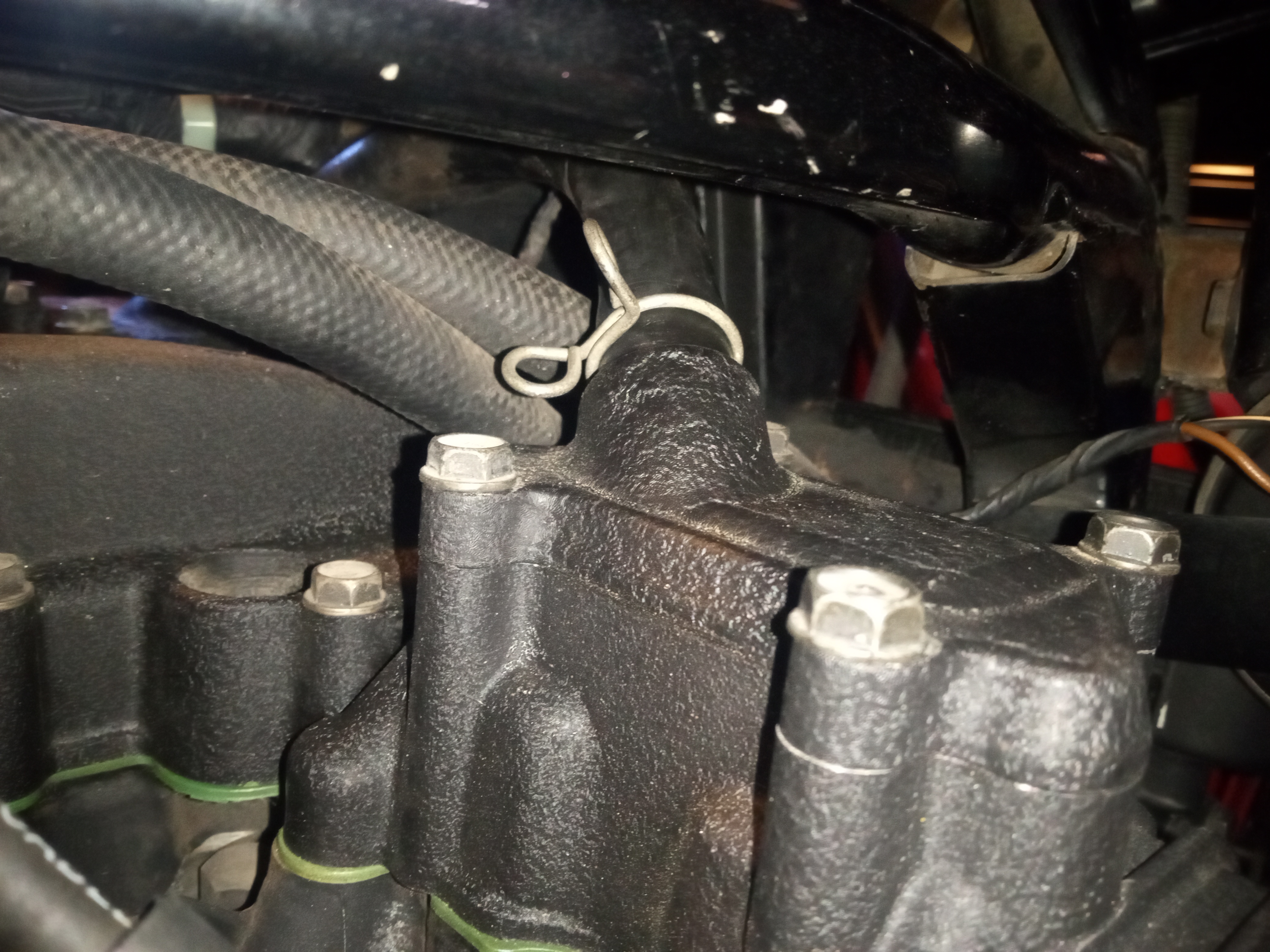

Snookered...
Called APE, they're out of the block off plates but doing another run in about three weeks. I'll temporarily use the long tube from the octopus to connect to two doodads on the cam cover to each other. It just needs to keep the dust out as there are one way reed valves in the cover that only allows flow in one direction.

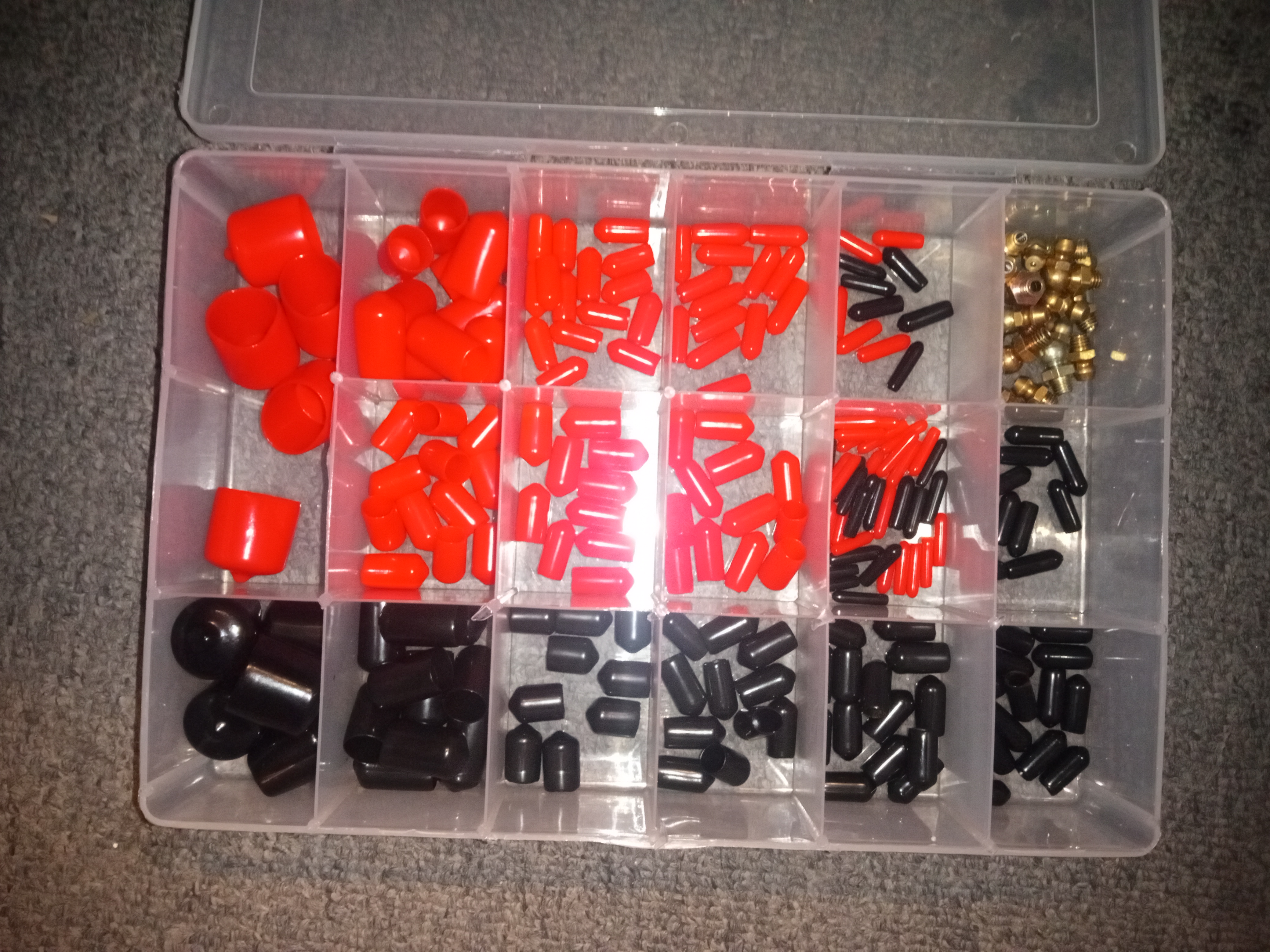

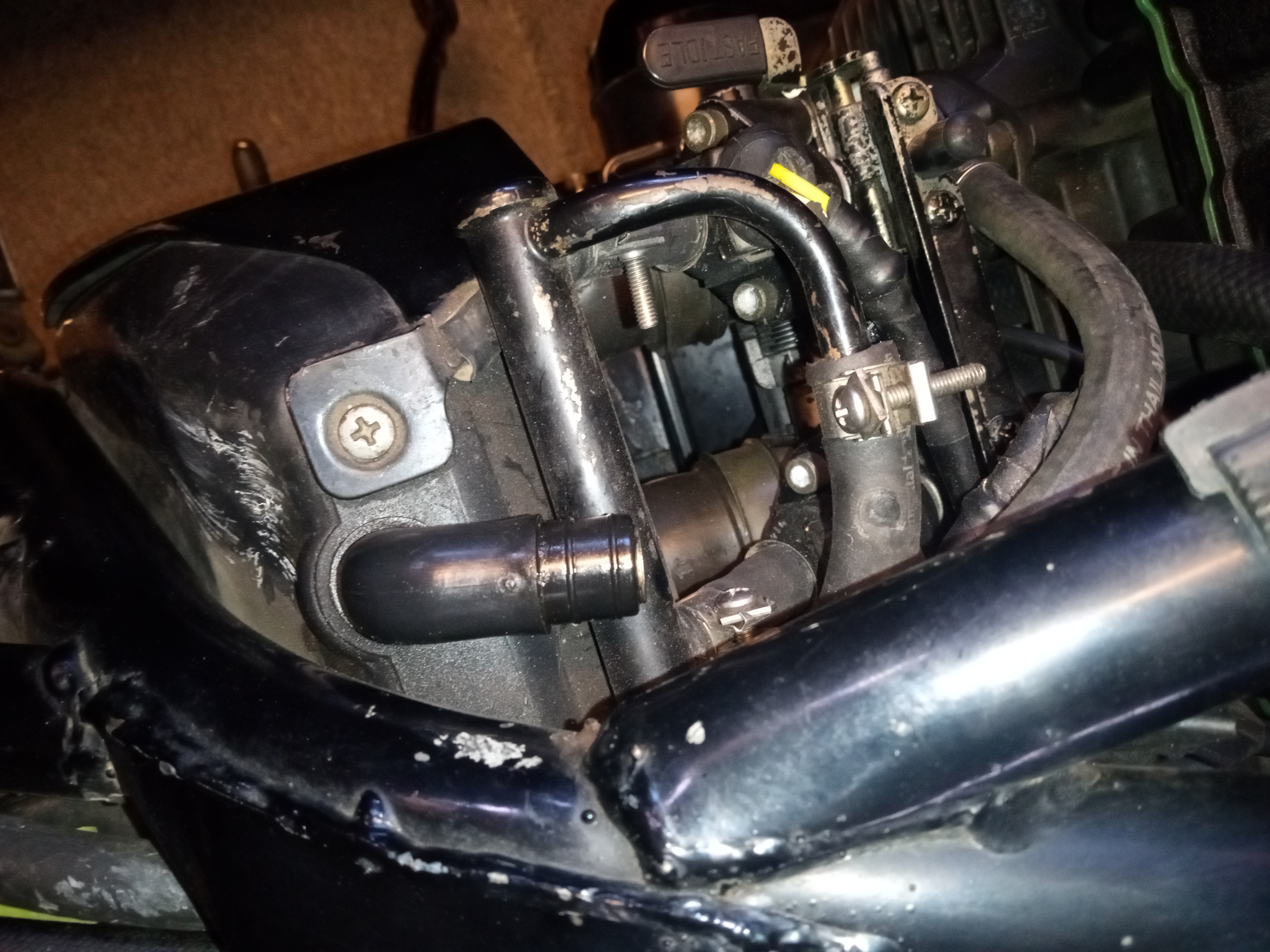

Snookered Part 2...
Got the two doodads connected WooT!! and found my other kit of vacuum caps etc
300+ in two kits....
Do I have the right size for the airbox connector? No, I bloody do not... I need one between the two larger sizes. Arse biscuits & buggery bollocks...
But did manage to stuff one of the smaller ones inside the connector on the airbox, so all good for now.
Probably should have used a red one.
Dropped by GhettoZone & picked up the correct size vacuum cap for the smog spod on the airbox. Job jobbed.
