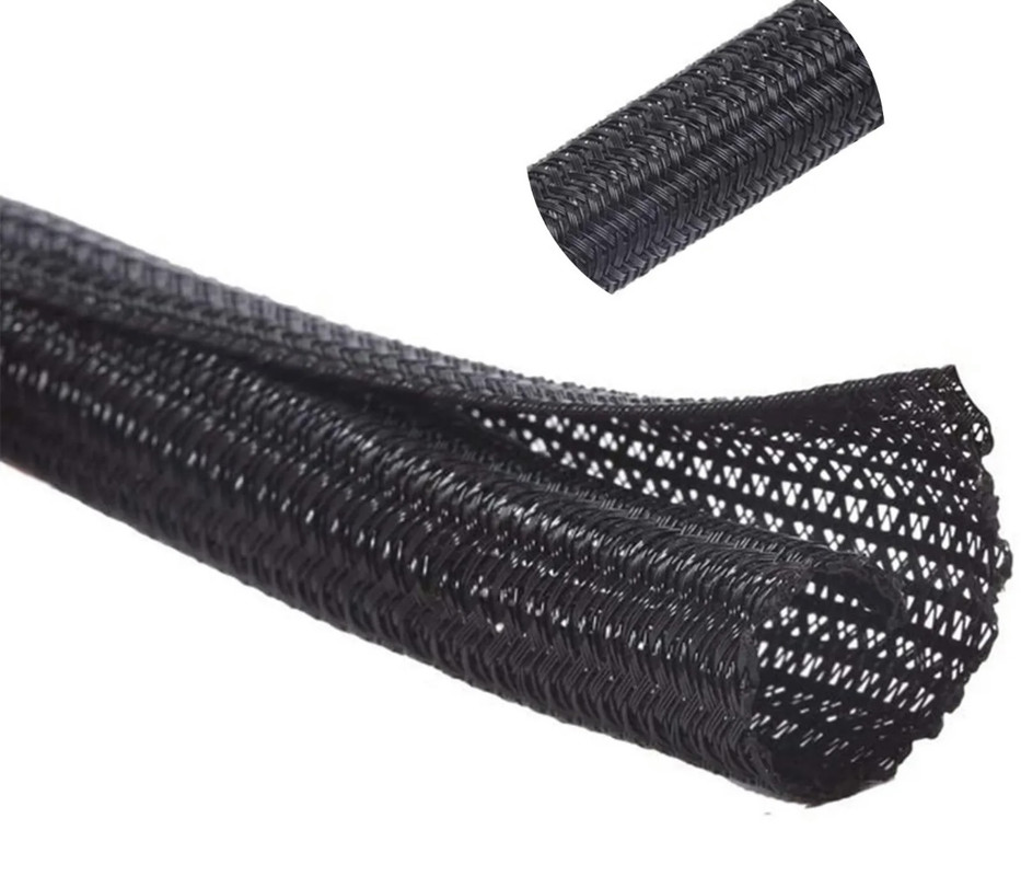

Or this sort of thing.crust wrote: Sun Jul 02, 2023 1:05 pm Rather than use sticky electrical tape why not use this:
https://hilltop-products.co.uk/ldpe-spi ... _g_c_pla__
https://www.ebay.co.uk/itm/225493296783 ... media=COPY
