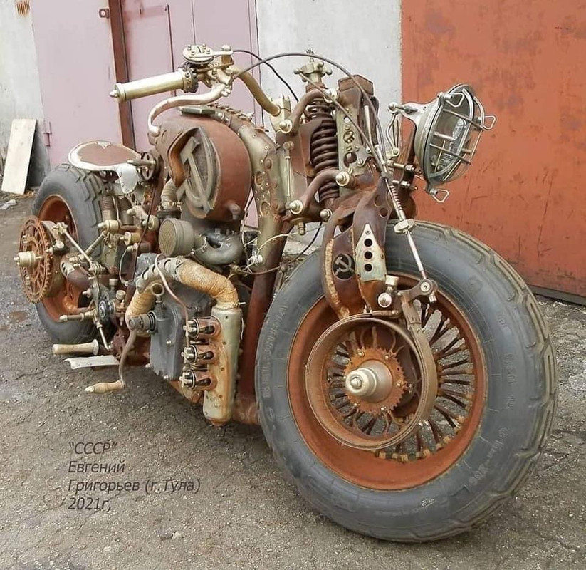

Re: Classic Triumph Bonneville
David wrote: Wed Sep 21, 2022 7:49 am Drum (internally expanding) are inferior to disc ( externally expanding)
You can have the best of both worlds.
Posts: 3189
Location: RoI
Has thanked: 1264 times
Been thanked: 1188 times
Post by slowsider »
:thumbdown: Brown seat.
No bar-end mirrors tho' :thumbup:
