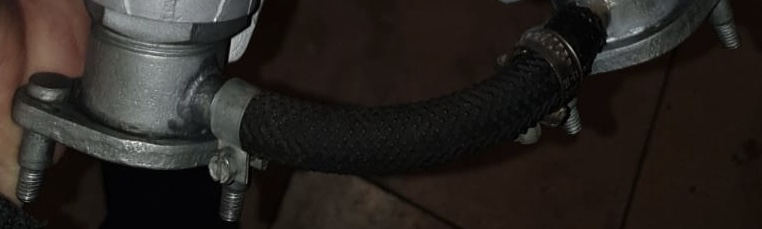

Not with Mikunis, you have to take the top of the carb off to adjust them.mangocrazy wrote: Sun Sep 18, 2022 11:08 amCouldn't the old fag paper trick be employed here, in the manner of finding when contact breaker points open? Might be better than lollipop sticks. And crabs...Le_Fromage_Grande wrote: Sun Sep 18, 2022 9:01 amThat's how you balance Mikuni Smoothbores, 4 of them, it doesn't work very well.Mr. Dazzle wrote: Sat Sep 17, 2022 10:46 pm Twin crabs.
There're no vacuum ports or anything like that, to balance em you stick er....sticks...under the slides and eyeball em to see if they move in synch.
Alternatively (and this will probably be regarded as heresy) couldn't you drill and tap the carb bodies for vacuum take-offs?

Do it by ear and feel.
Set the tickover on both slightly higher than normal, then adjust the cable on one one way then the other, you'll be able to hear and feel when both cylinders are even.
On my BMW the engine smooths out and the front mudguard stops wobbling.

I’ve found, through trying all the various methods, that vacuum gauges or manometer is the best way to adjust the throttle stop screws and to get synchronous opening of the throttle slides.crust wrote: Sun Sep 18, 2022 9:57 pm Do it by ear and feel.

Using a proper tool rather works better than sucking your teeth?
