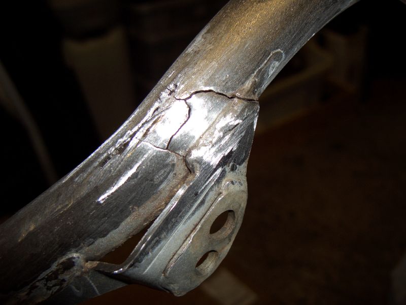

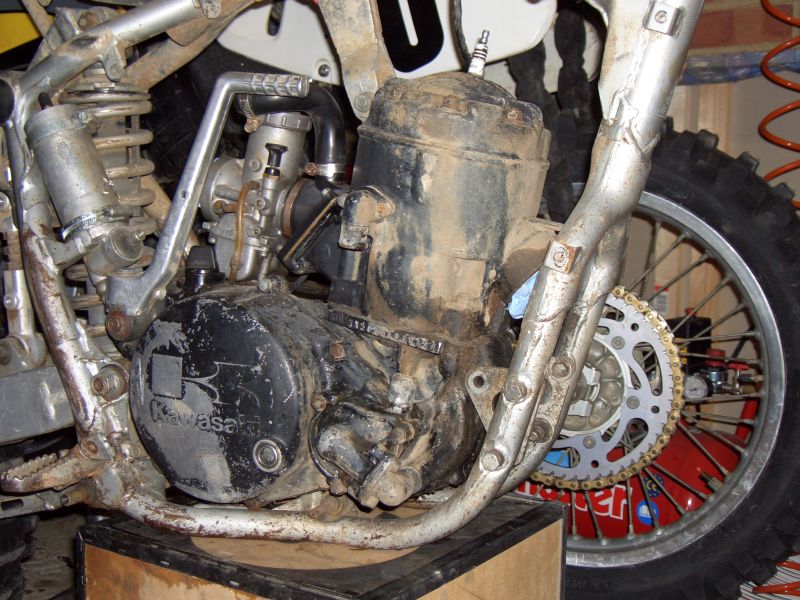

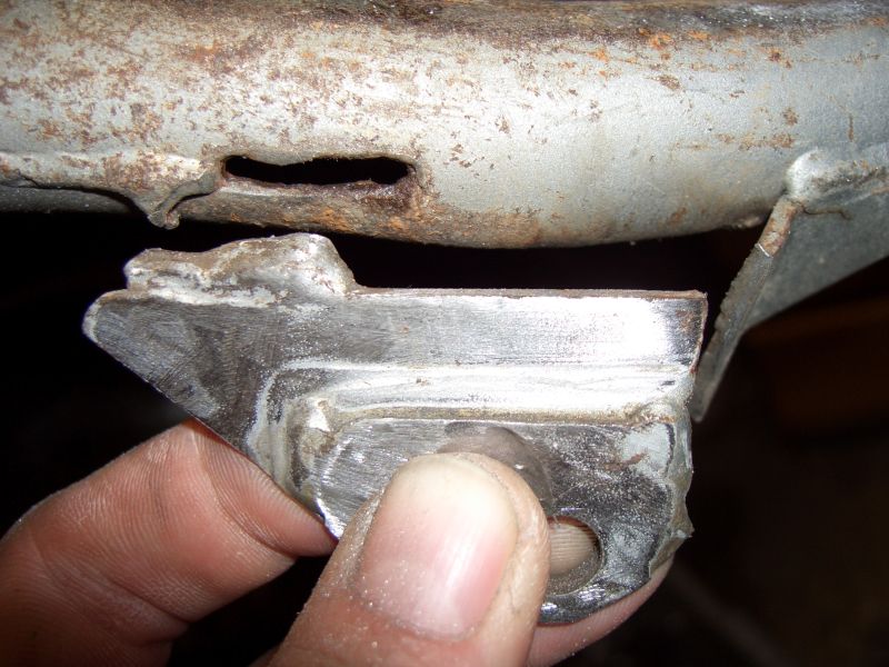

demographic wrote: Sat Jan 23, 2021 7:02 pm I can't remember what carb the older KXs have, mines got the standard Keihin PWK39 D shaped slide but does yours have a PJ carb?
On about bits that break theres stuff on Youtube about the gusset kit that adresses some of the parts of the frame that break. It's aimed at the 88-2004 frames but still gives a good insight into what issues they have.

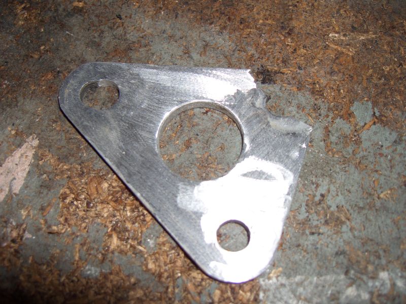

Realistically the main issue for mere mortals is the the expansion chamber bracket behind the coil.
Also Sandblaster and KX Guru have done some good Youtube vids.
They all break eventually.

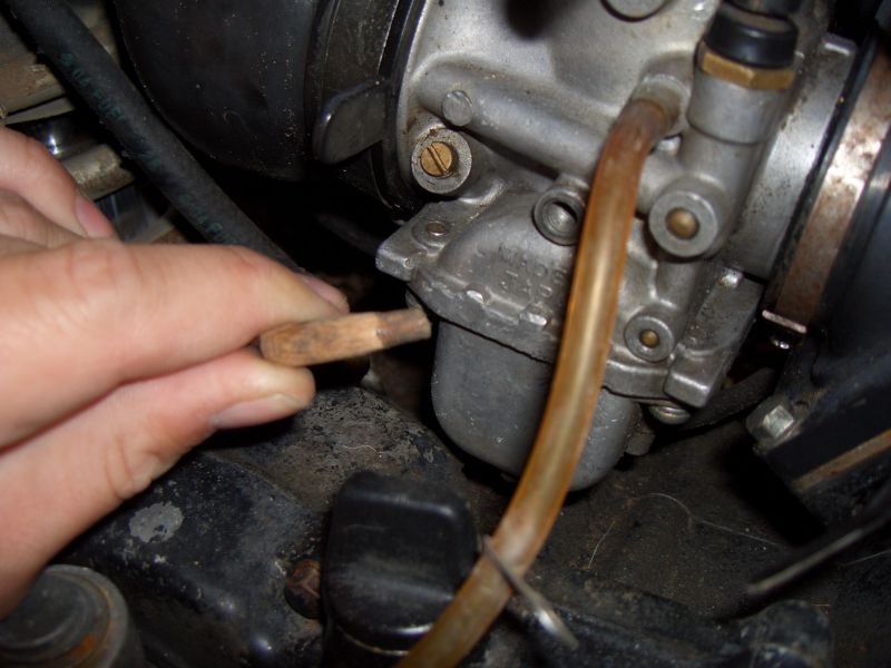

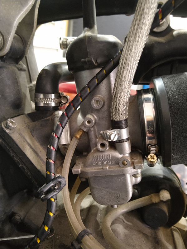

It's a Mikuni on mine with a round slide. I've got a choice of two. The one that came off the bike was in a shite state, someone had rammed a wooden peg in where the mixture screw was... I'll strip down the replacement I bought (currently on the bike) and give it a soak in the ultrasonic tank and a blow out with the airline.
As for cracks...it was properly fucking abused and unmaintained when I got it, but the mount for the spannie looks remarkable sound and so does the rubber mount.

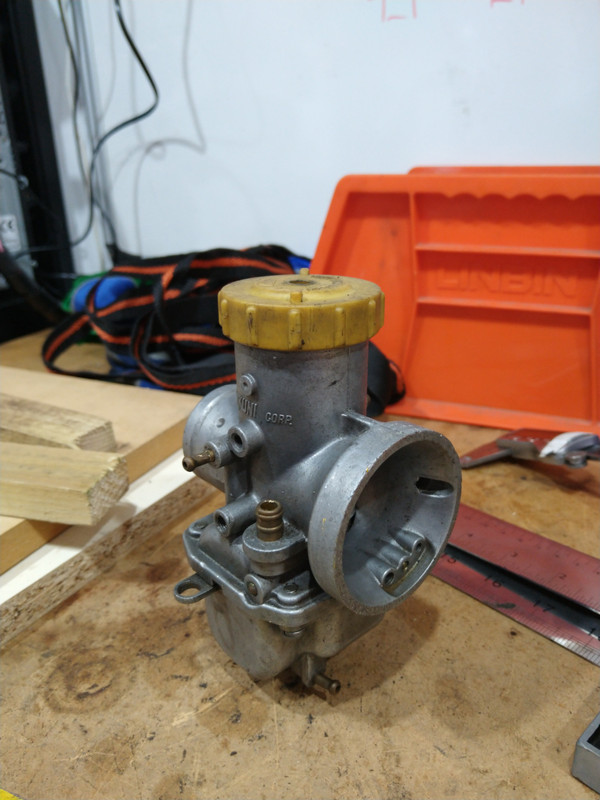

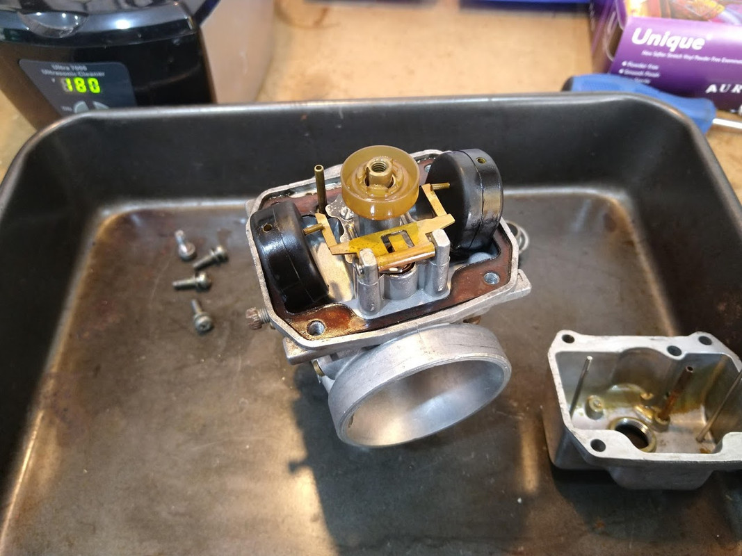

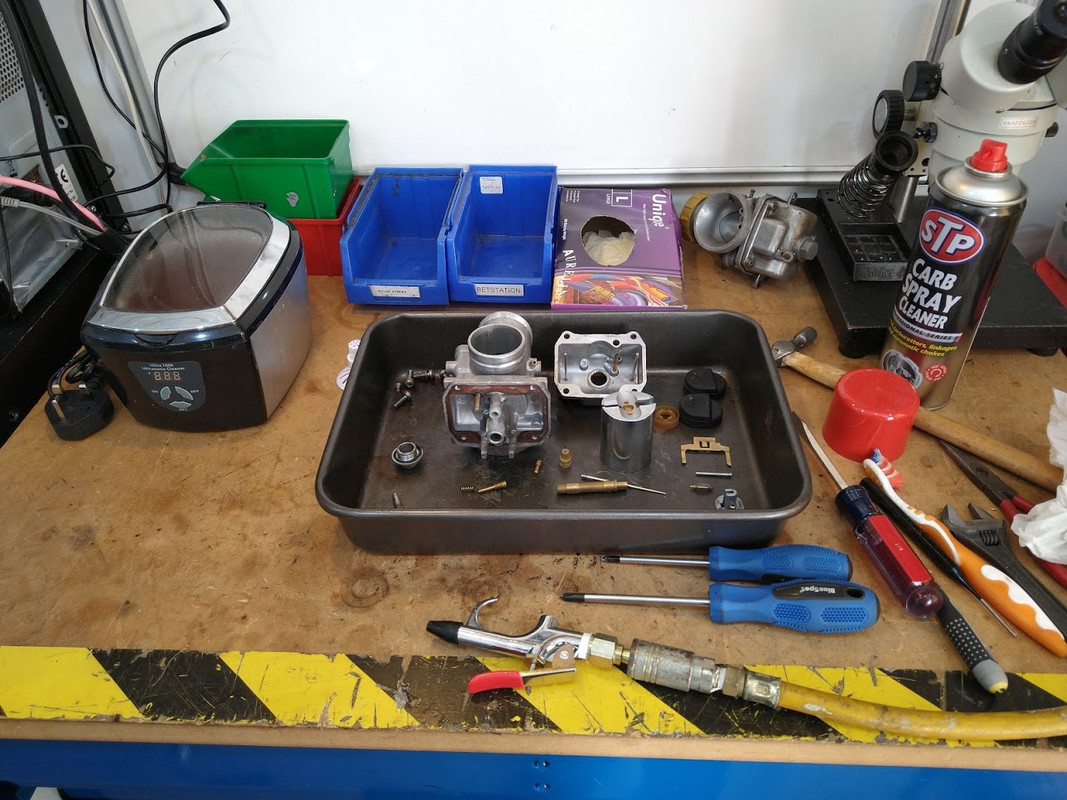

Carb stripped and cleaned. Reassembly after lunch.

List of things to sort...
  • Get it to run for more than 10 seconds. The carb is clean as a whistle so I need to check the ignition timing next. Also, my right leg is fucking killing me now...

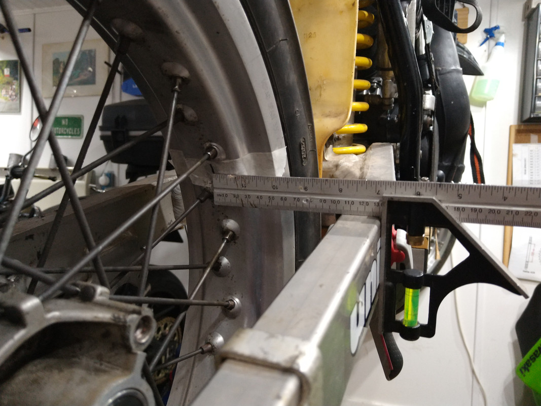

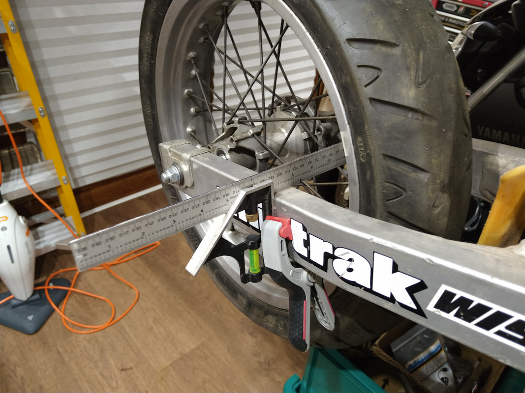

Axle and top hats fitted to sleeve it down for the 15mm bearings. I'm now knocking up dummy spacers out of plastic pipe.
6-8 weeks minimum lead time for a custom sprocket (520 pitch, 43 teeth on the PCD for this wheel) as all the firm's I've contacted are waiting for blanks.
Aluminium and steel ordered for various brackets and mounting plates. CDI being made in France, should be here in a couple of weeks.
