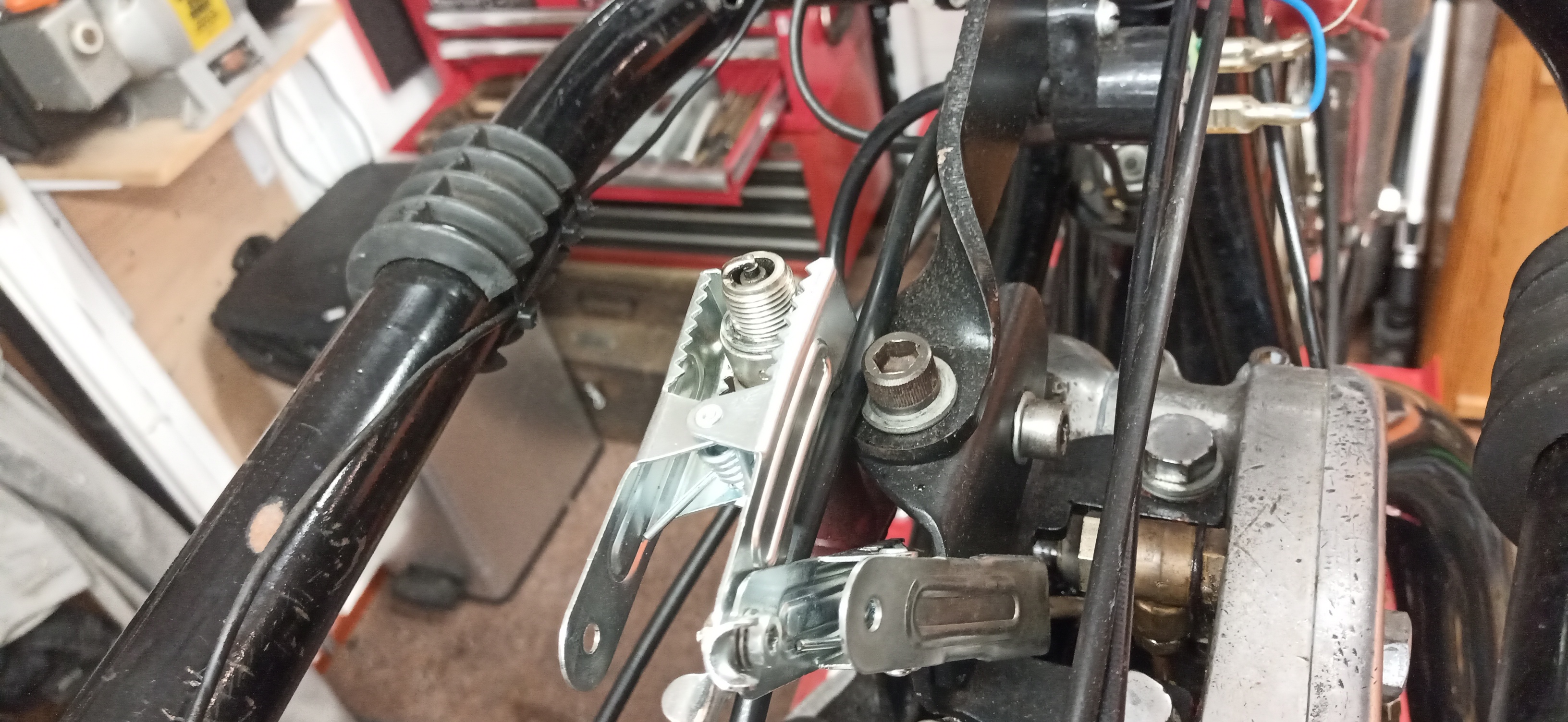

I'm going to be continuing to tear down the head: slowly: This is the first time I've delved this deep into this engine, and the last time I stripped a head it was on my first bike: my Mum's V50 Guzzi, and I had my Dad helping me (that was ..... err... IIRC I was 18....). I also like to clean and examine every part as I go - to check it's condition and to fully understand how it fits into the whole: so it tends to be a slow process.....
