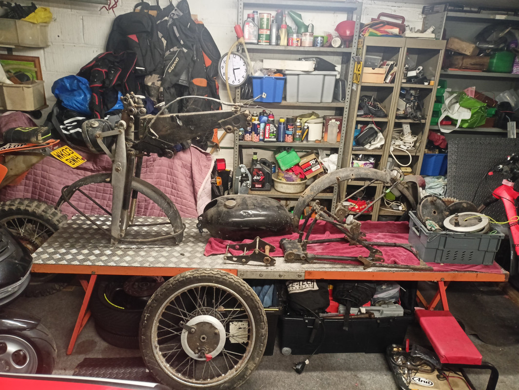

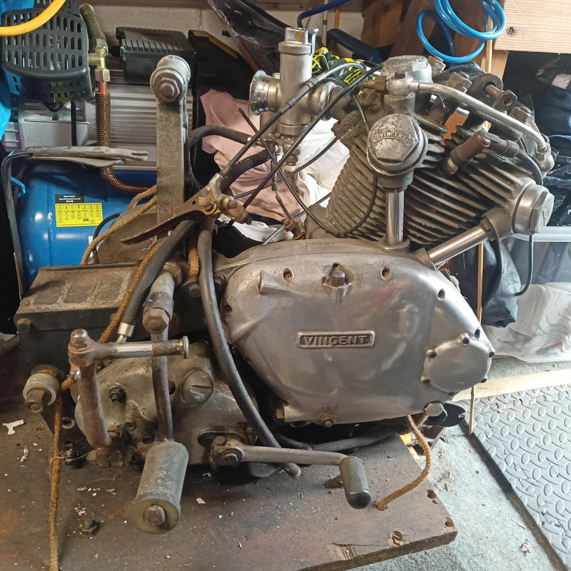

And that’s pretty much where we are now- I’ve done nothing at all to any of it since it came into my possession apart from changing the name on the V5 , so the engine has still not been apart and it hasn’t been started for 40+ years , but as of today, it still turns over nice and freely and has seemingly good compression.
It has suffered a bit from all those years exposed to the elements, but all considered, it really isn’t too bad externally at least, has fared much better than the cycle parts, as may be seen in the pics below.

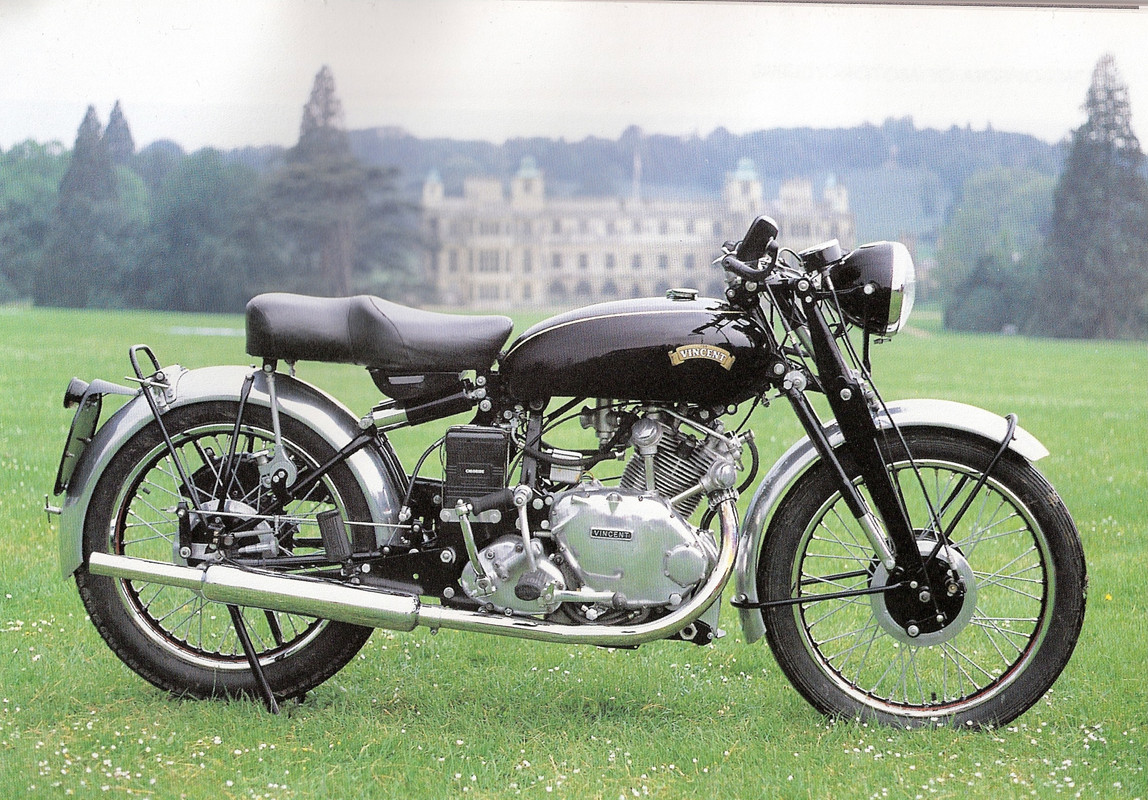

And for balance, this is exactly how I intend it to end up looking-
I think that almost all genres of Vincents (Series D excepted :wtf: ) are really beautiful things, both to look at, and from an engineering point of view.

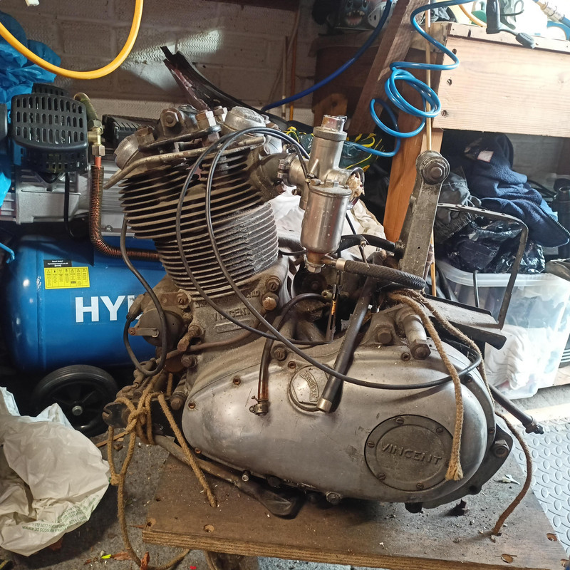

As for the engine and gearbox, that needs completely stripping, inspecting, blasting, and re-assembling with new parts where required, and quite likely a fair bit more- by that I mean machining and re-bushing /sleeving certain parts, and hence I’m currently mulling over whether to send it to a very long established Vincent specialist for them to refurbish lock, stock, and barrel, or tackle it myself.
I have a lot of my Dad’s old imperial spanners and sockets etc, and Vincent special tools so am sorted to a degree, but as anyone who has ever built a similar age engine to this one will appreciate, unlike current stuff, it’s typically not just a case of simply replacing parts, there is often machining and shimming etc required.
I’m almost certain that it will be the case here in the area of the crankcases where the oil pump lives, and possibly main bearing housings too as that is a known weak point after big mileages, albeit mainly on the twins as far as I can gather- there are modifications these days that solve both of these issues, but they involve machining of crankcases and crankshaft, something that I neither have the tools or expertise to do.
And someone who is building these every day will very likely spot things that I won’t, and arguably do a quicker / more complete and far better job than I would, but by not building it myself I would sort of feel that I was copping out, and also missing some of the pleasure, so we will see….

Well, first off, I’m going for a, err, loose and dry assembly of the complete bike with what I have, in the condition it is currently in, as far as I can, with the sole objective of being able to make lists of:
1. Missing parts (right down to every correct nut, bolt, and washer) that I don’t currently have and need to obtain
2. Parts that I have but which aren’t serviceable and need to be replaced.
3. Parts that I have that are serviceable but need blasting and painting or plating
4. Engine & gearbox plan- hmmm, still to be decided
