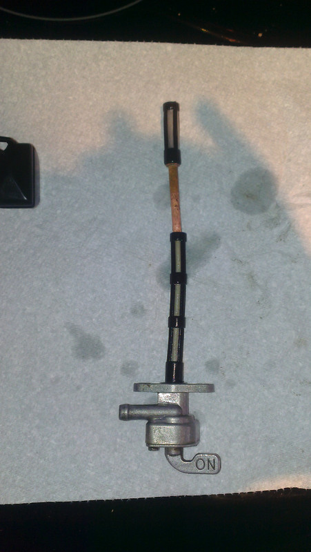

Below is what leaving shitty E5 cheapo unleaded in the tank of my KTM EXC for about 9 months did to the fuel tap
And for reference, this is what is should look like , and did after a few trips through the ultrasonic bath.
Unfortunately, the Carb took a lot more to sort out
