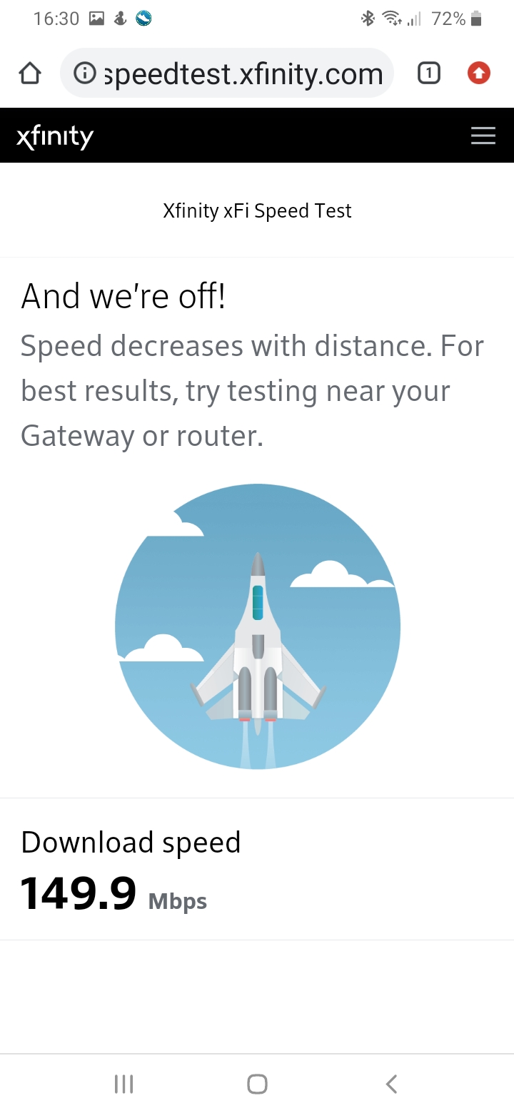

I'm a bit confused why we get better reception via wifi than ethernet. The TV and laptop both show 90 ish via cable, but WIFI is 50% more.

That's unusual, to do speed tests accurately you need to have everything else turned off that could use your bandwidth.
Part of your Ethernet may be stuck on 100Mb with the rest matching that speed, I'd still use Ethernet as that's plenty of speed and more stable than WiFi.

Yorick wrote: Mon Apr 05, 2021 4:39 pm I'm a bit confused why we get better reception via wifi than ethernet. The TV and laptop both show 90 ish via cable, but WIFI is 50% more.
@Yorick - The limit on your wired devices ( both wired and wireless are actually called ethernet, they are just using a different transmission medium), is 100Mbps (million bits per second) hence why you're only seeing 90ish -it's not " better reception" it is down to an IEEE standard speed that defines the rate that the information is transmitted at.
On your wired connections, this speed of transmission between your TV/Laptop and the router is hence 100Mbps, but your wireless will likely be operating at 154Mbps or possibly more dependant upon the age/spec of the router and network adapters in your wireless end devices.
In practice for a home user the 100Mb limit of your wired connections will not make any perceivable difference to you unless you are constantly downloading very large volumes of data- the network the other side of your router (ie Movistar and onwards) in reality will usually be the limiting factor, as you will be competing for / sharing that bandwidth with many others.
