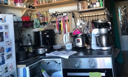

Really not picky at all - as you can see from the photos below!! LOL I managed to get a full length piece of work top (2.5m??) for about 15€ and it is a 'work in progress' to find out how to make the kitchen work best!!

Really rubbish pictures!!
Right now I'm just going to use an offcut from the original work surface, so will need a join where the FridgeFreezer is at the moment. Plan is to put the acquired fridge there instead and get much more work surface and also be able to use the sink better!! :D It'll need a cover over the cut side (which will have to be curved to make sure I don't impale myself on it regularly!!) as well!
This end will need a 'cover' as that has been open since it was originally cut/built

For a bit of scale, the are of the kitchen surfaces works out at just 149x149 cm - tichy!! :D

Being picky, that sink is going to be a problem. Unless I am mistaken the 'join' in the worktop runs through the sink, and unless your washing up is a lot more careful than mine the water WILL get into the join and in time that will cause problems.

Cousin Jack wrote: Thu Feb 25, 2021 8:13 pm Being picky, that sink is going to be a problem. Unless I am mistaken the 'join' in the worktop runs through the sink, and unless your washing up is a lot more careful than mine the water WILL get into the join and in time that will cause problems.
That's one of the reasons I'm treating this worktop as sort of temporary!! It wasn't sealed properly and whilst I've tried to make it ok, I'm not convinced and the damage would have been done anyway!!
