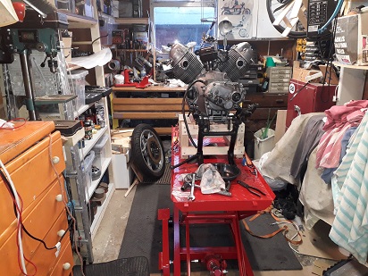

I've got this one, https://www.ebay.co.uk/itm/191920885348 ... =28&chn=ps I don't have a lot of room in the garage and its stored on its side when not in use. It is short and narrow, unlike the picture your not meant to rest the rear of the bike on the ramp. With the Le mans on the centre stand and the front whell in the chock the rear of the bike from just behind the stand is floating in the air with the ramp removed. To get the Le Mans on I have a 500mm long bit of 18mm ply which I bolt to the front and support with two car jacks. Wheel the bike on, front wheel onto the ply and then pull back to get it on the centre stand an off the wood.
For the Tuono it is the other way round. The wood goes between the ramp and the bench part and I use an ABBA leveling platform to make the bench wide enough for the ABBA stand to sit on. Pulling the bike formard onto the stand gets the fron wheel into the chocks and the back wheel up in the air off the ply.

I can also recommend thse Halford Floor Mats https://www.halfords.com/tools/garage-e ... 36870.html You can see them either side of the ramp in the picture above. You don't need to drag something around the floor to kneel on and they keep your feet warm as well when on a cold garage floor.
I don't have them where the bike stands normally go but the bench above is sat on them and they do bounce back once removed. I bought another pack recently as I'm WFM in the spare room which has laminate floor. I've got three mats in a " T"at my desk, to keep my feet warm and protect the floor from the wheels of my office chair wheels. better than a rug and they will be transfered to the garage when this ends.
