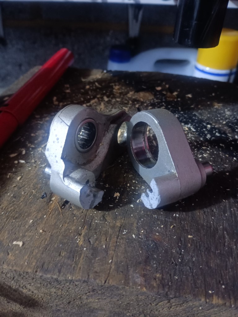

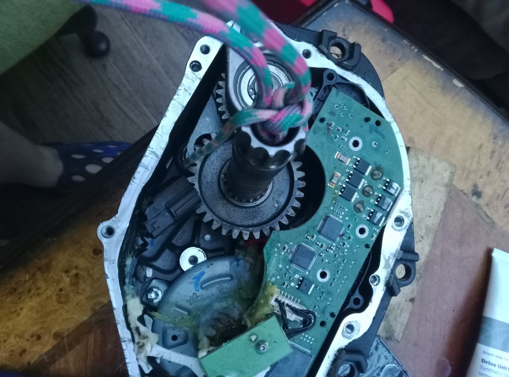

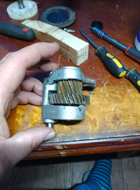

Next would be to fit the new bearings in the gear cluster which is this thing:
But you'll remember that I got a little enthusiastic to try out the new press and I twatted it:
Performance Line Bearings sell new holders/castings for £24 P+P and fitted my new bearings as part of the service so I kinda cheated on this bit. The key learning point is that you need to use something, possibly a 19mm socket, in place of the actual gears so that you can fit the bearings.

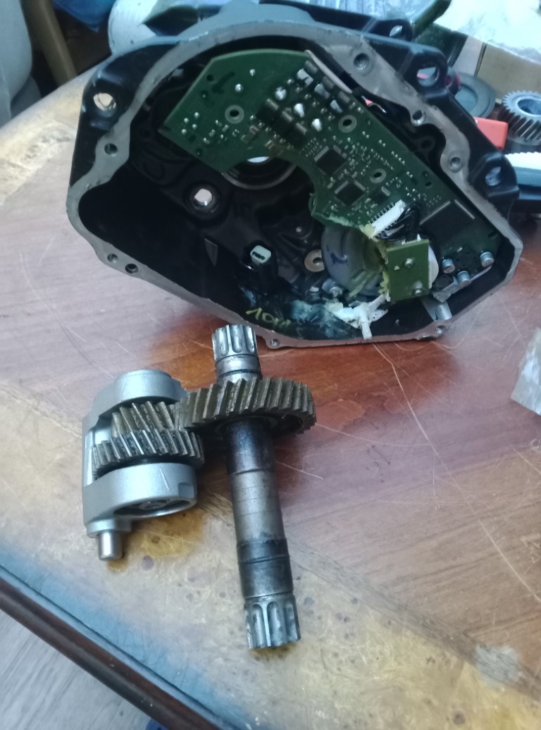

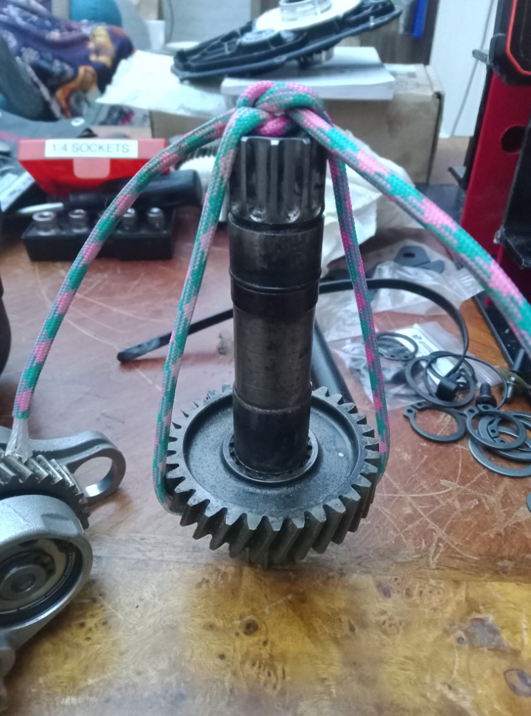

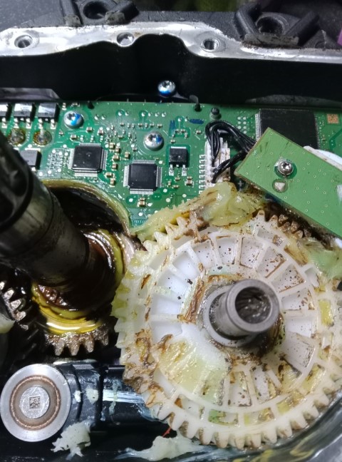

With the new bearings in the gear cluster and the LHS crank shaft bearing installed, next is to to fit the gear cluster and the crank into the motor. This is quite tricky because the two, independent parts have to be fitted at the same time and to do so requires a bit of careful jiggery so as to not damage the PCB.
I was struggling to keep the main gear on the crank shaft as I tried to navigate the gear under the PCB and the crank into the bearing aperture, even resorting to using some paracord to help:
No real success and I was getting very frustrated so headed off for a cuppa. As the kettle was boiling I remembered the bundle of circlips - yep, you've guessed it, the main gear should have been held in by a circlip on either side. In my relief at working out the problem I forgot to take a photo.

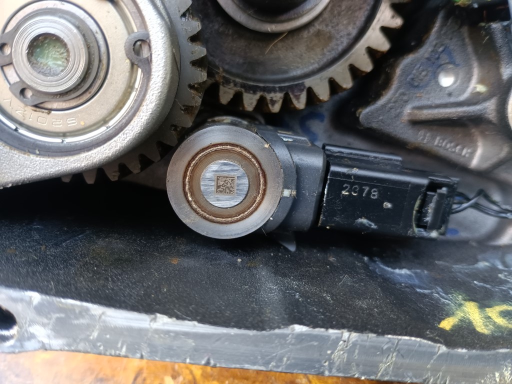

Once the crank is in the bearing it'll likely need a few taps with a soft-faced hammer to seat it fully home. Bear in mind where you're hitting with the hammer - if the are you hit deforms you won't be able to re-install the crank arms. Once the crank is seated remember to install a new circlip:
Next is to re-install the torque sensor:

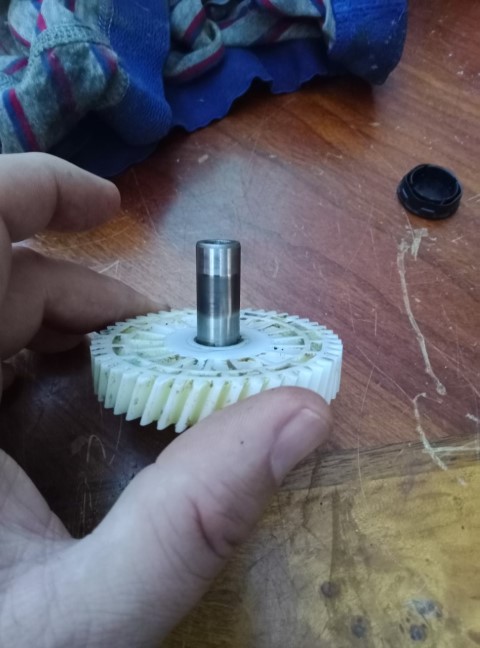

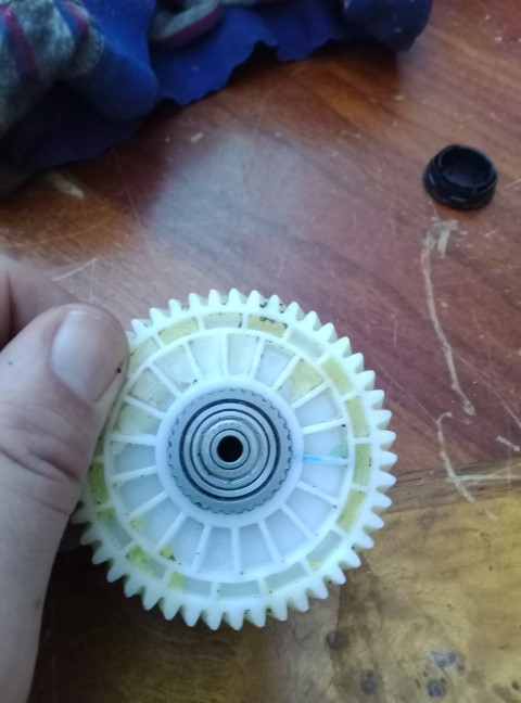

Next up is to install the new transfer gear. Again, I cheated slightly on this because this came ready assembled in the kit so I didn't have to mess around with the cup bearing:
Beancounter
- Posts: 1126
- Has thanked: 3126 times
- Been thanked: 684 times
Re: Bosch Performance Line CX Gen 2 Strip Down

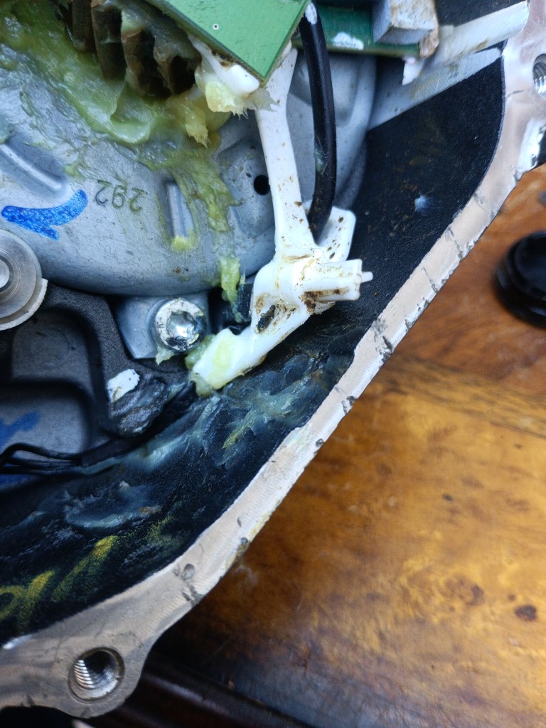

Before installing the transfer gear you need to make sure the thin black wire/cable is correctly routed behind the white plastic clip and the white clip is not dislodged - it easily moves when you're lifting out the PCB and trying to remove the main motor gears.
You can then install the transfer gear - this is my old one but you get the idea:
Once in place it will help when re-fitting the RHS casing to the motor.

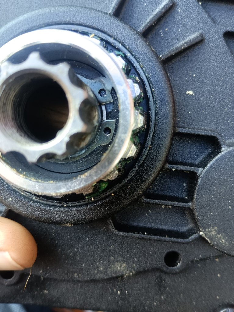

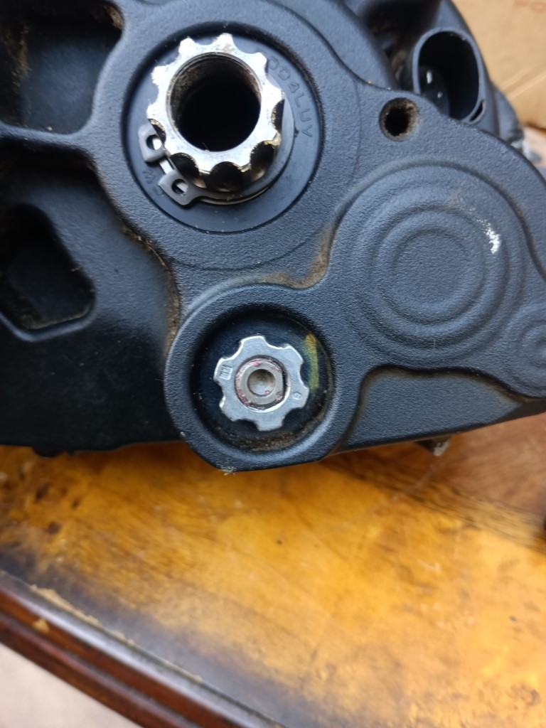

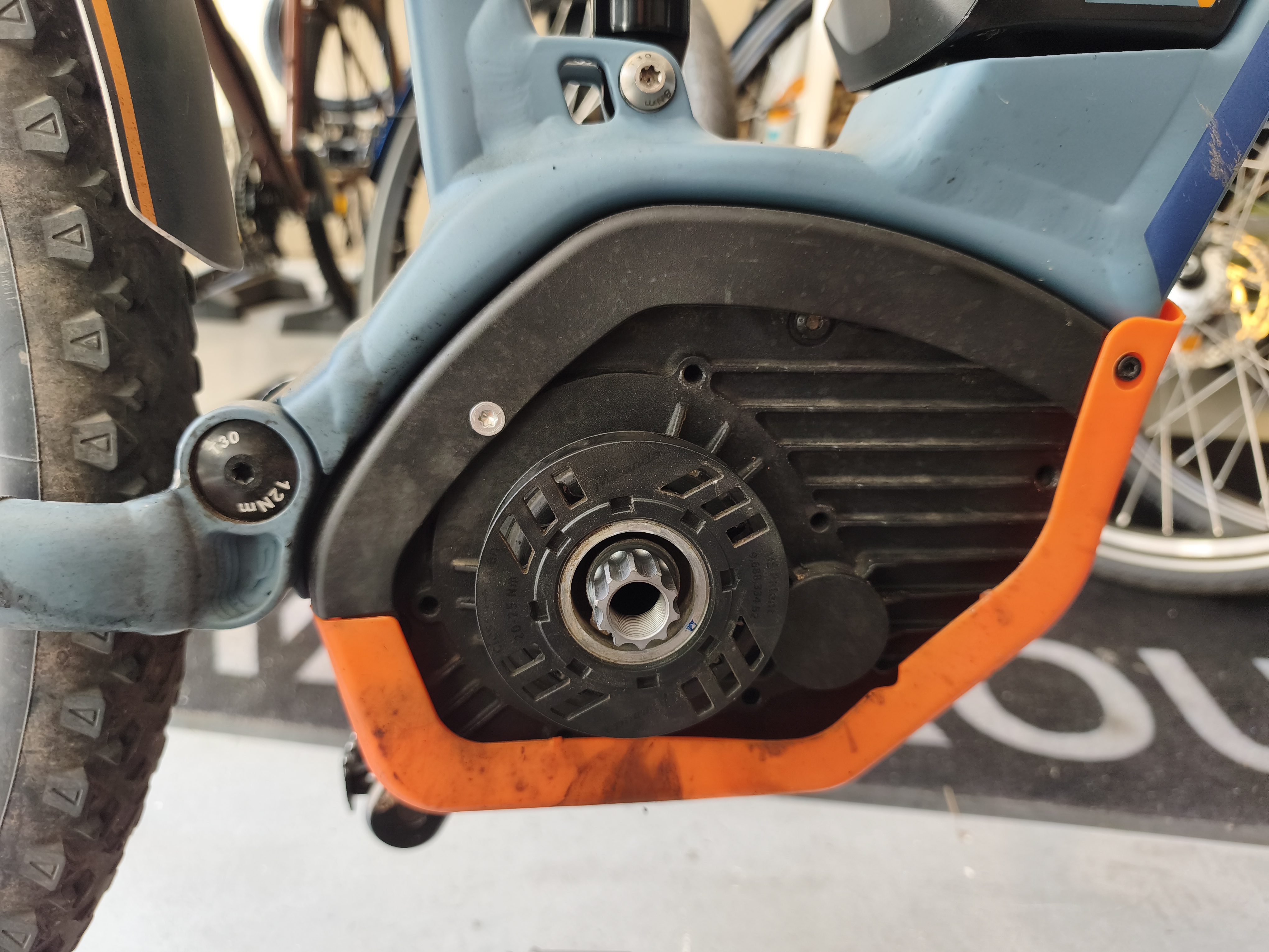

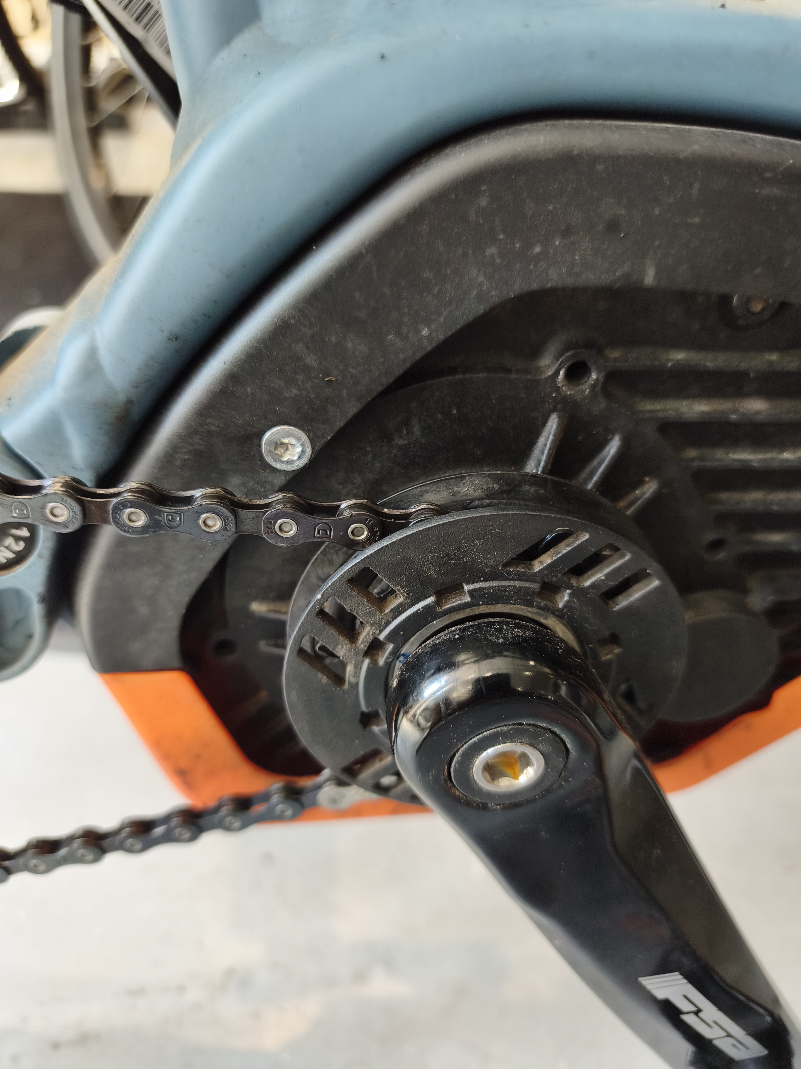

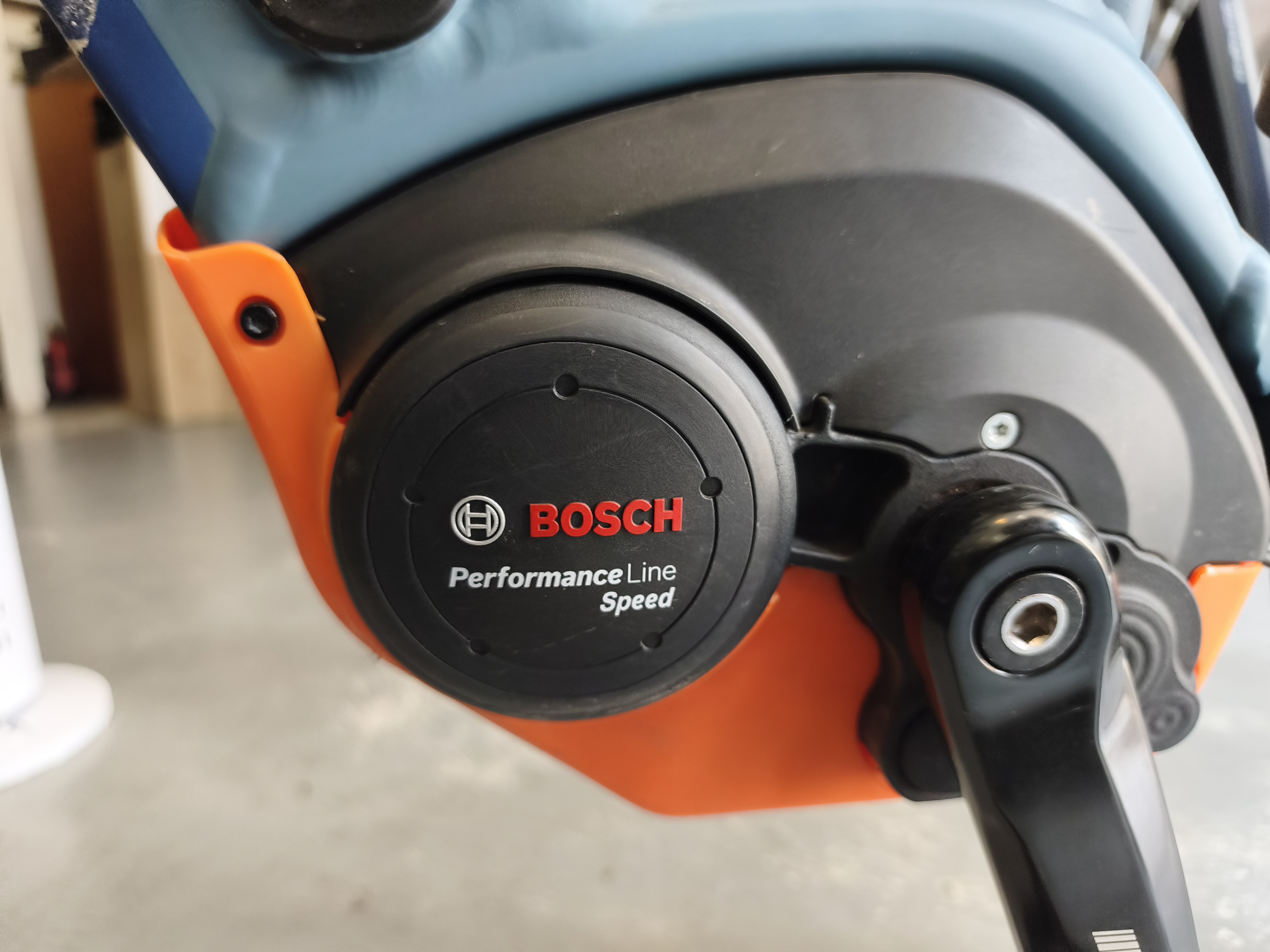

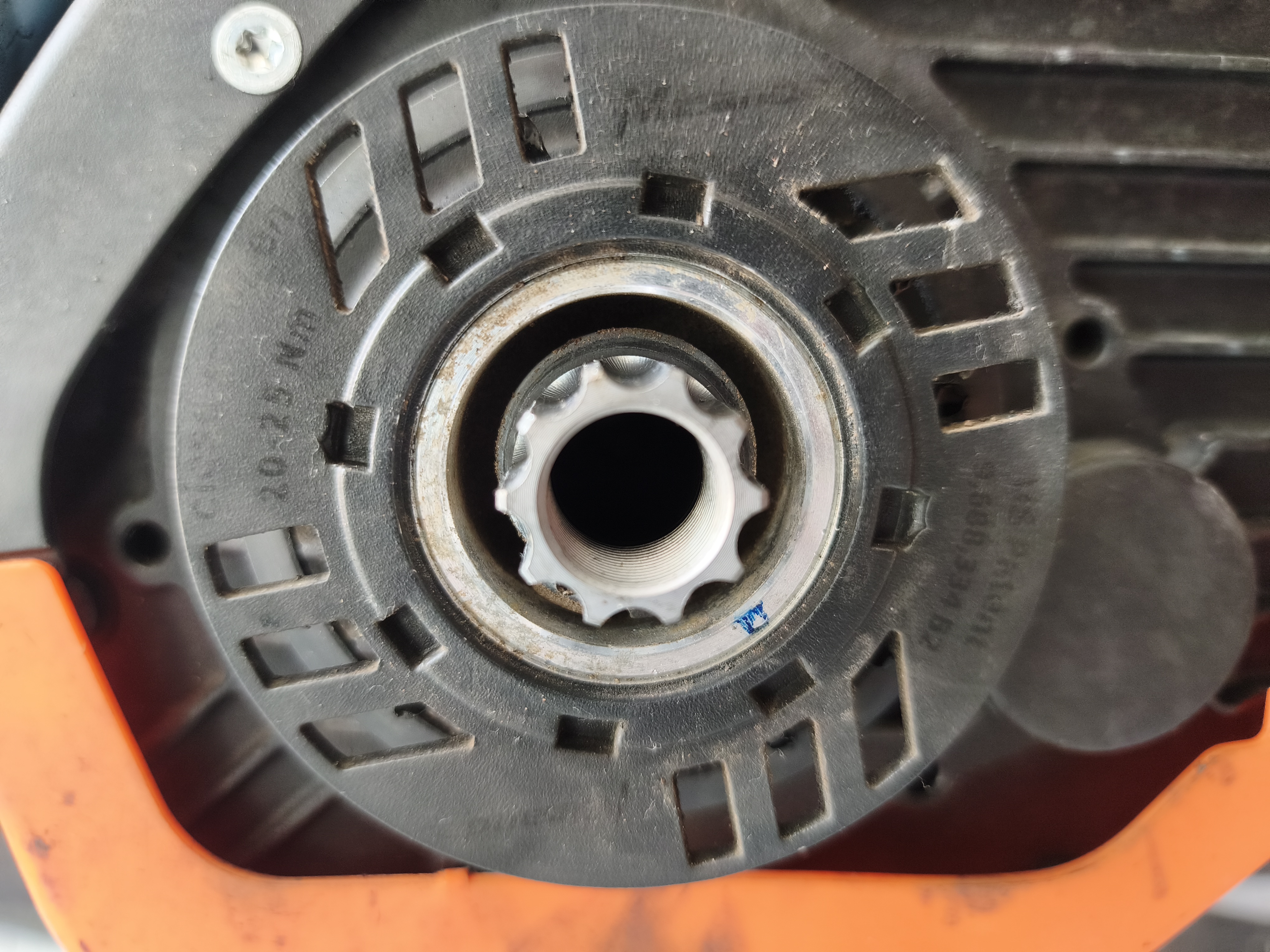

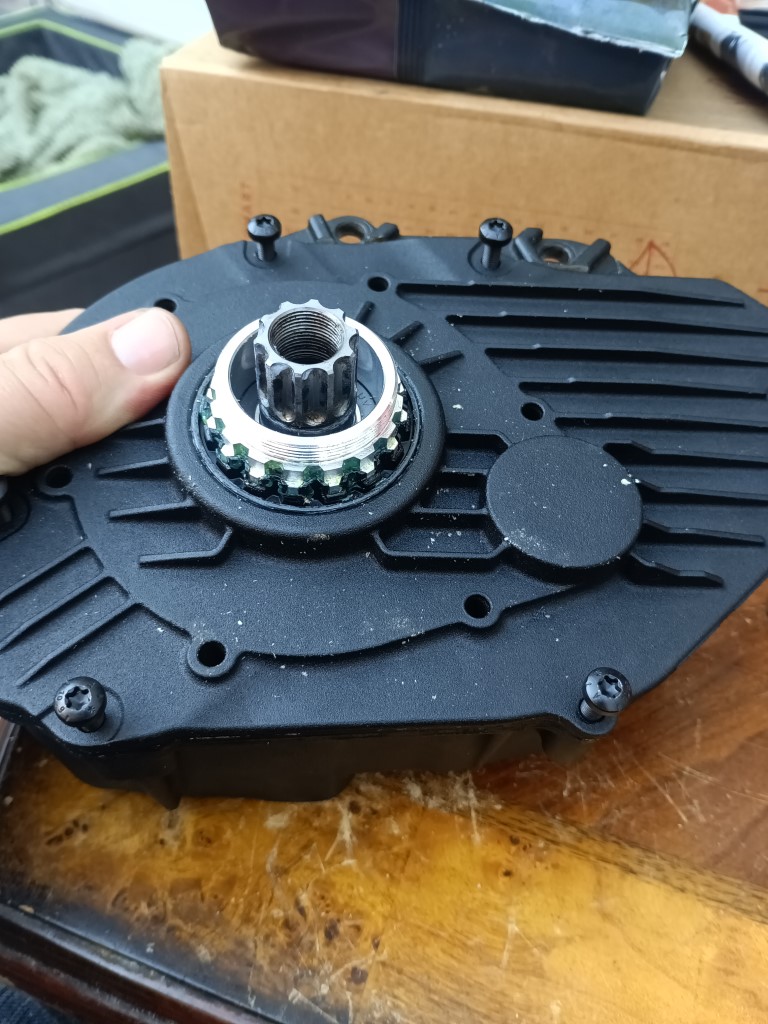

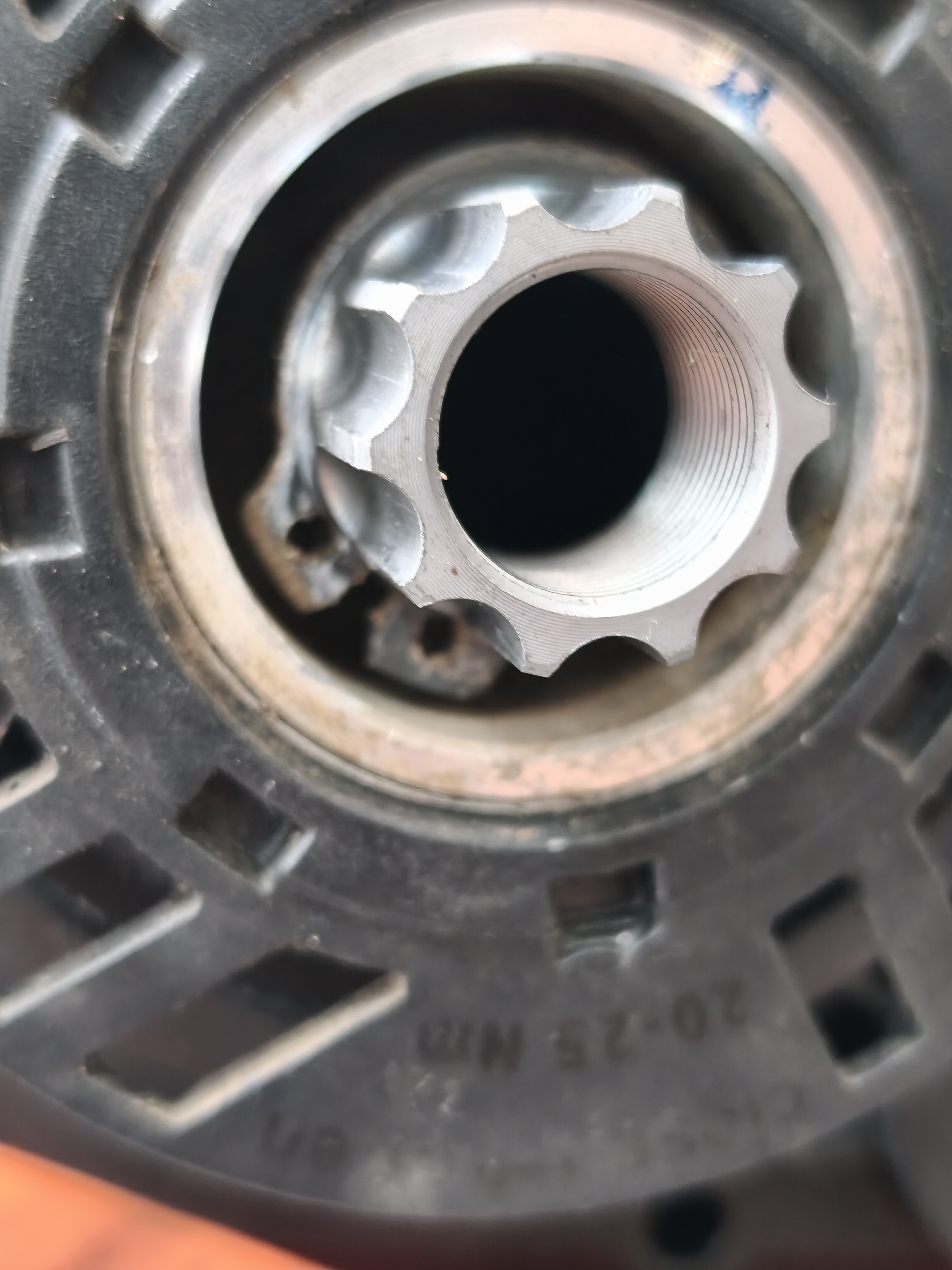

Hi everyone,
I'm a bicycle mechanic and I'm stuck on a Bosch Performance Line Speed Gen2 fitted to a 2019 Centurion Lhasa.
The bike is completely original and has never been opened or modified.
I'm replacing the drivetrain because a new 11-speed chain skips on the front 17T sprocket under load. The rear cassette and derailleur work perfectly, so the problem is clearly at the motor sprocket.
Here's the issue:
Left crank removed.
Right crank removed.
No visible Bosch lockring.
The two small holes behind the splines rotate freely (they appear to be part of the freewheel, not a lockring).
The sprocket has absolutely no axial play.
It won't pull off the shaft.
Has anyone dismantled this exact FSA/Bosch Gen2 setup?
Is there a hidden retaining ring, a pressed-on carrier, or does the motor have to be opened from the inside?
Photos attached.
Thanks in advance.
Here's the issue:
Left crank removed.
Photos attached.
Thanks in advance.

Taff
- Posts: 1467
- Has thanked: 334 times
- Been thanked: 1191 times
The sprocket lock ring is fitted on the outside if that ring, it had castlations on the outside and needs a special tool to undo it, which is only a couple of pounds on eBay.
Im pretty sure it has a left hand thread , and you'll need the non drive side crank arm fitted to contract you when you're undoing it.
Loads of videos on YouTube.
