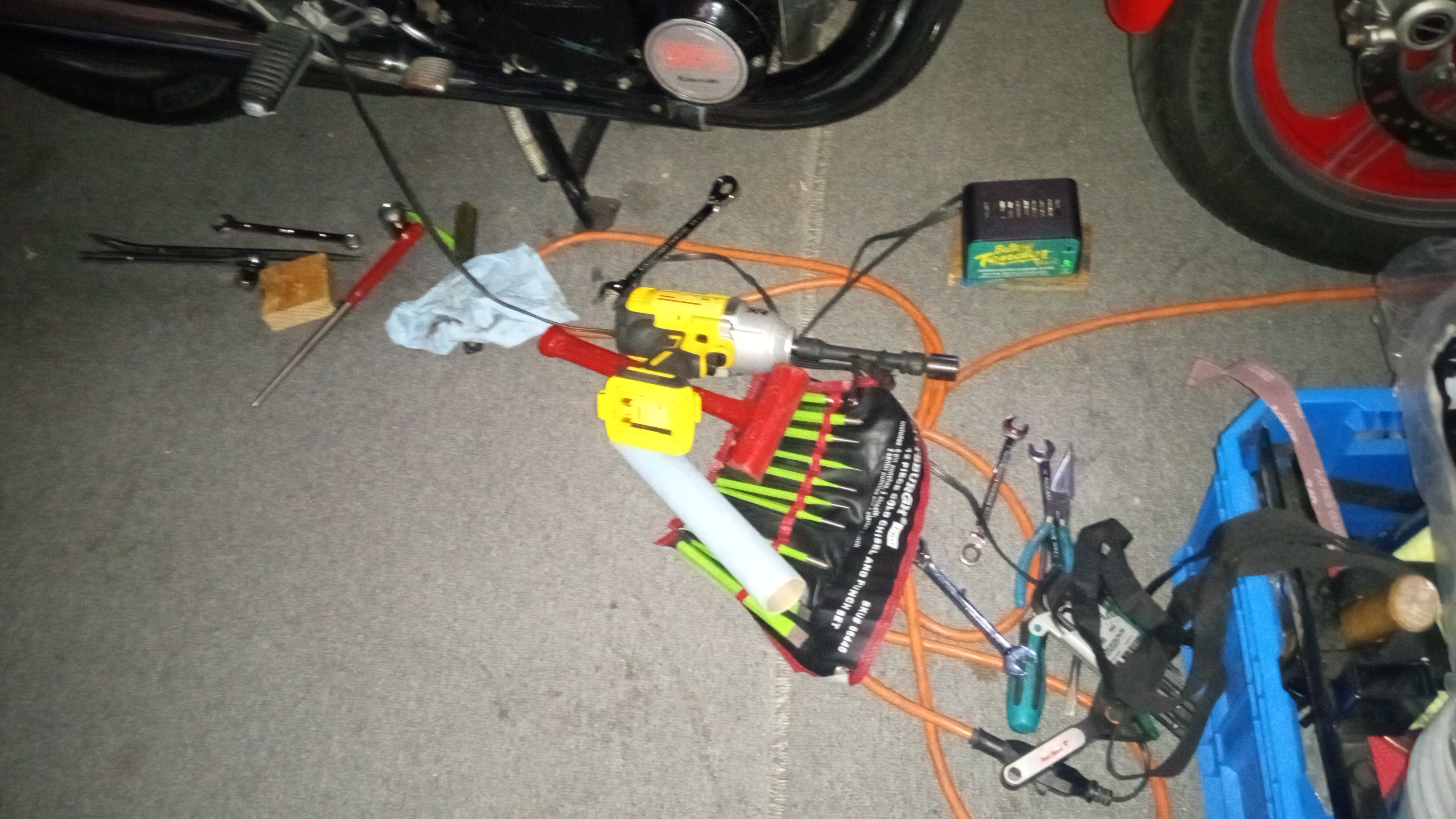

Gave the creaky UniTrak bearings/bushings some fresh MolyB/Graphite grease. Sounded like an old barn door when I sat on it & backed it out of the garage. Thought it might be a ball ache to service... no idea why, as I had the exact same shit apart on the ZX11 a while back.
Took just a few minutes. Needle rollers were drier than a nun's chuff. No corrosion & everything easily wiped clean with a paper towel. I even found a piece of wood the ideal thickness to support the rear tire at the right height so the lower shock bolt just slid in. All gooped up now & ready for the next 43 years
Just need to final torque the hardware. No more creaky

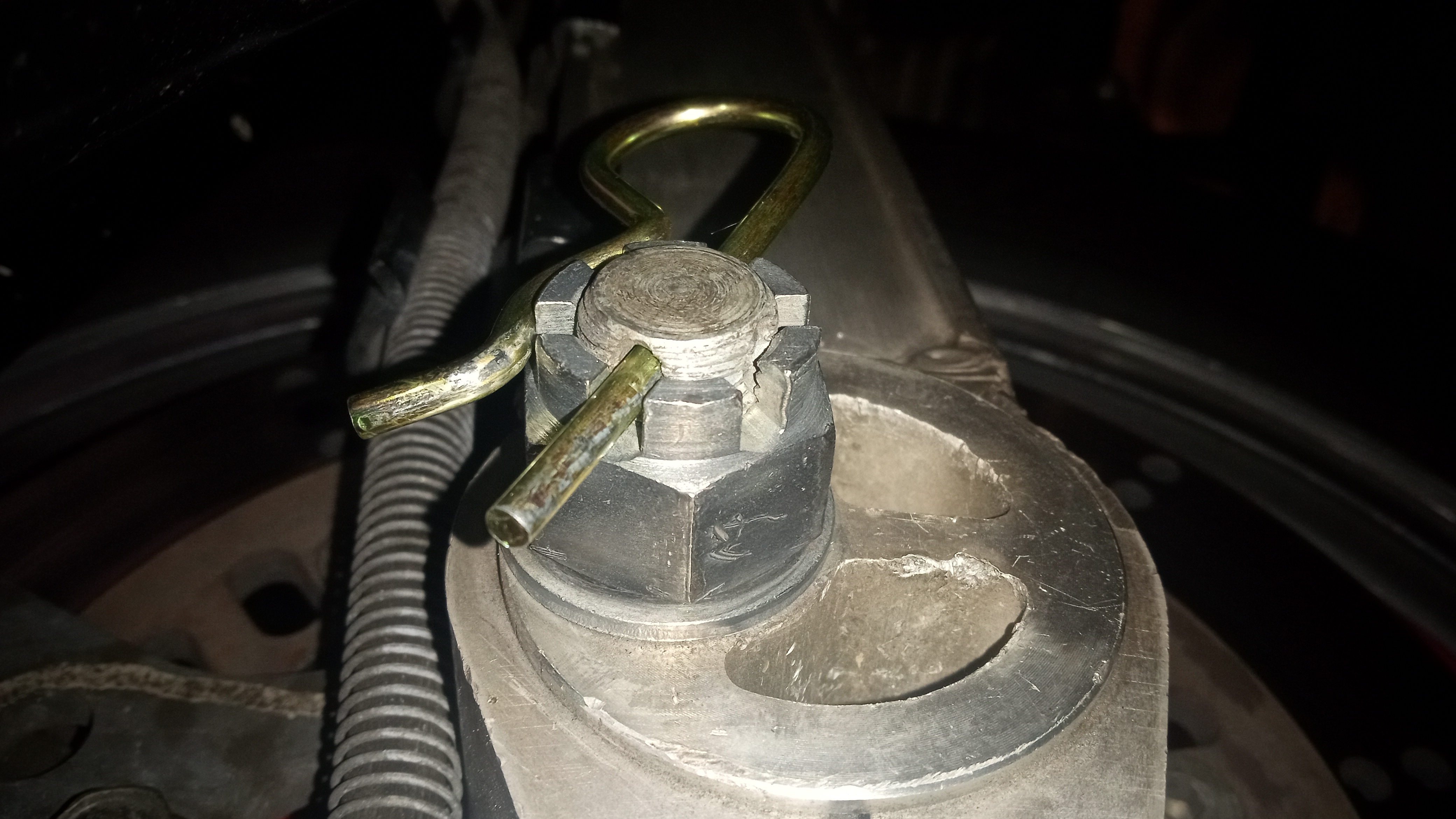

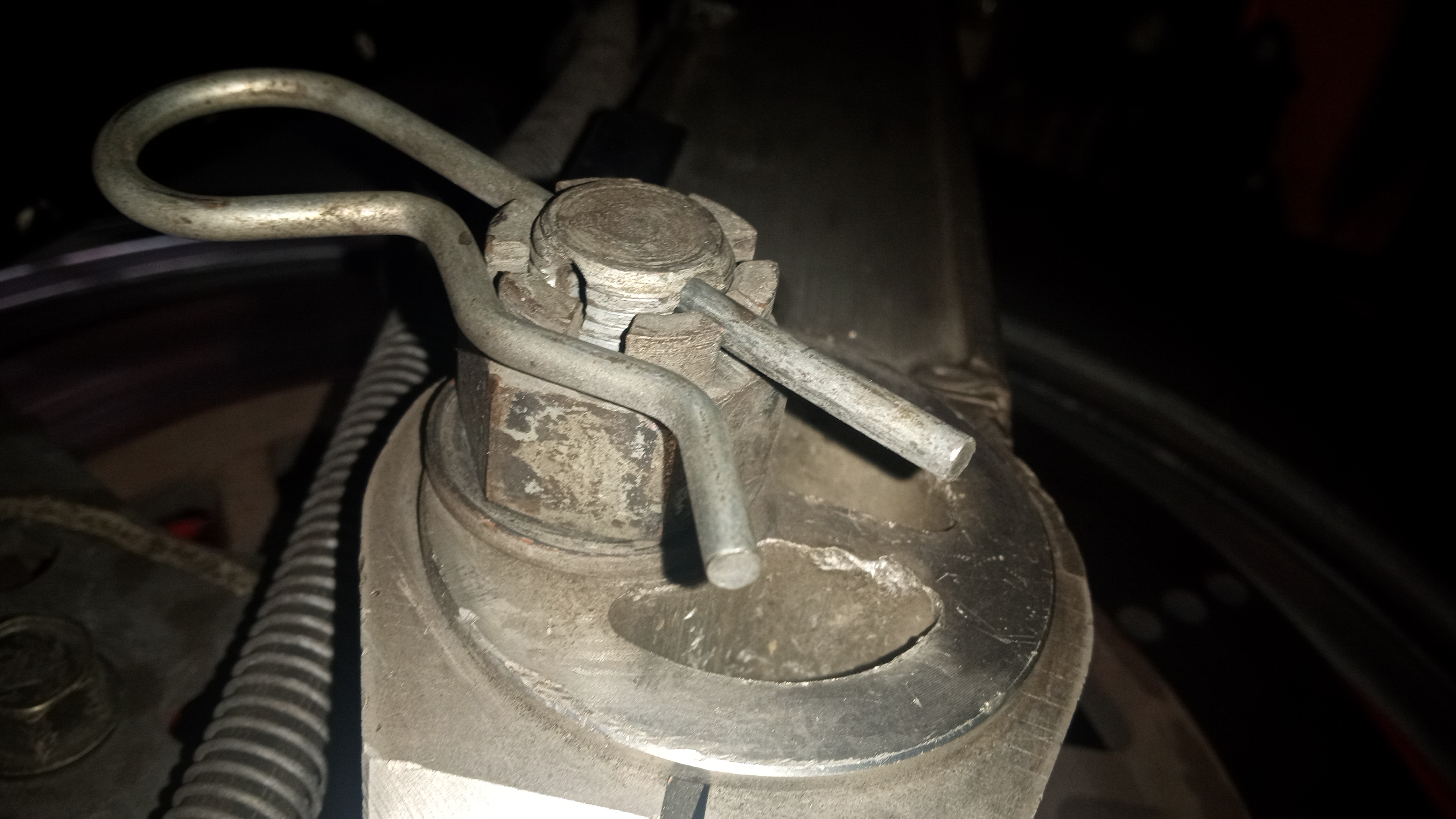

Another HUGE project today...
Before:
After:
& yes, it's just as tight as before, but I rotated the axle a tad so the spod I stuck in the hole on the other end was up/down instead of fore/aft to get better leverage to prevent it turning while I tightened the nut.
Before:
After:

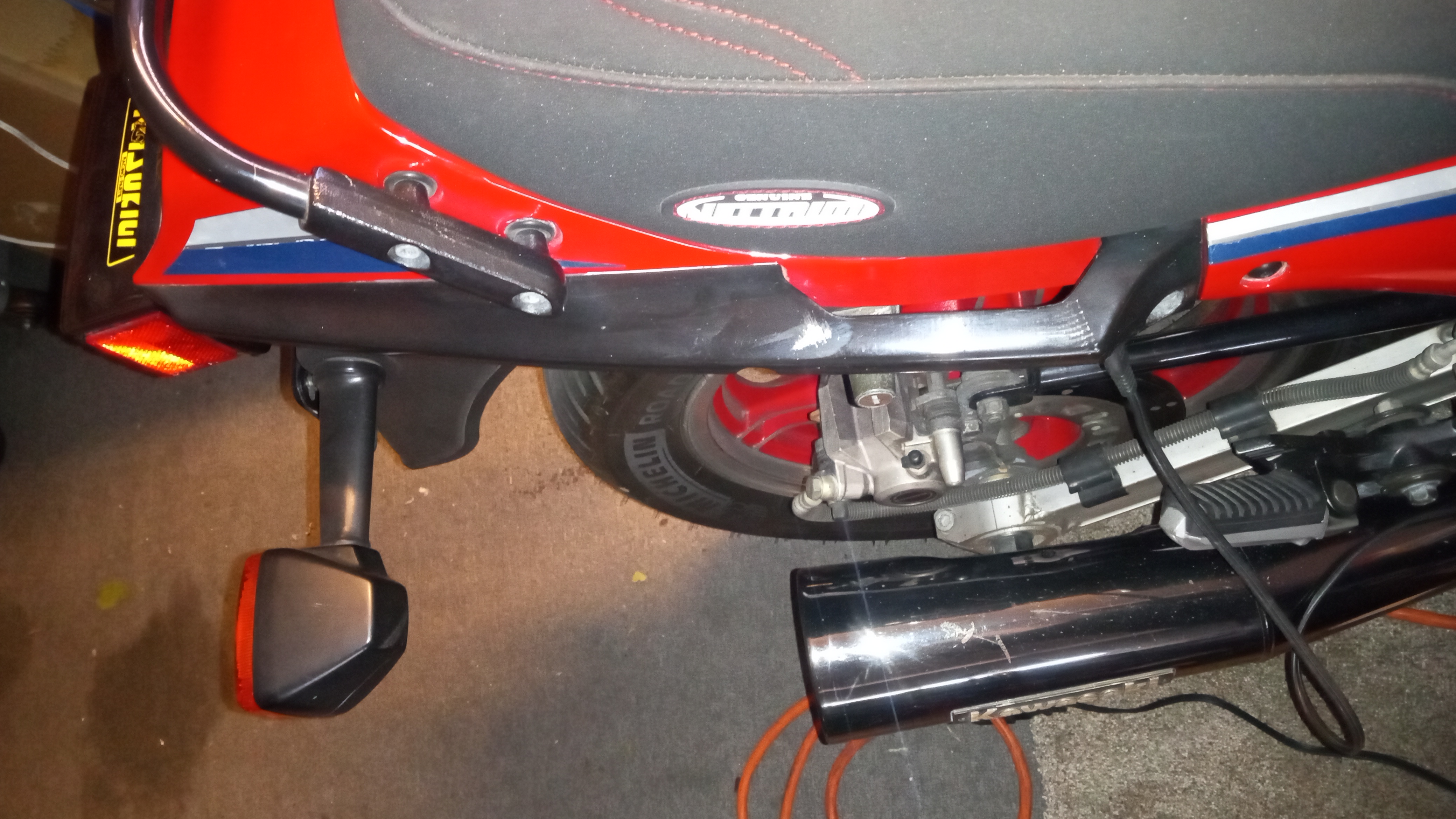

Spiffy refinished strakes on the GPz11
There are two M8 allens & 3 screws on each side...all allens present, but one side had one screw, the other had two. Luckily I had spares from the extra set I bought.

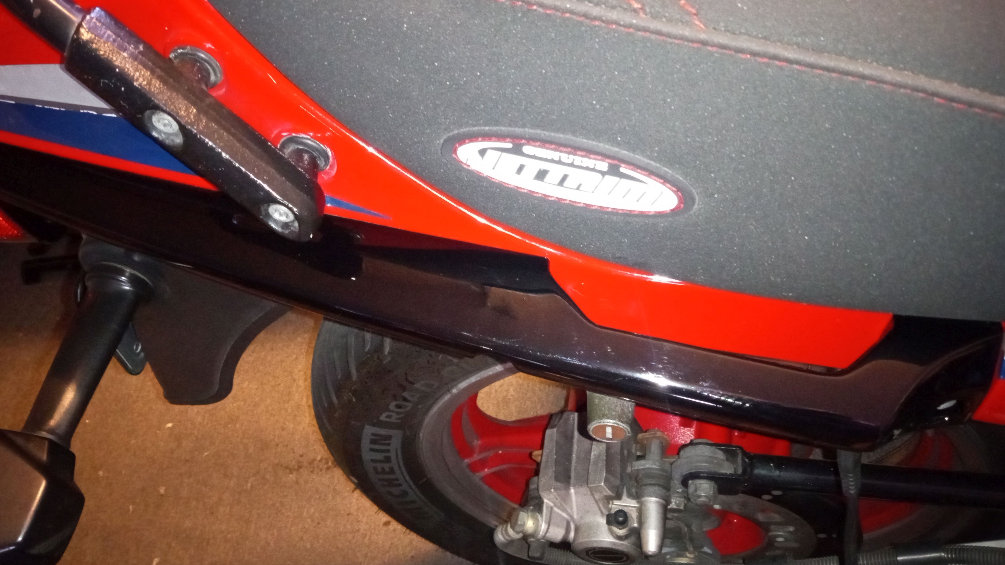

Re: '83 GPz1100-A1 Stuff.
That's better. Those aren't scratches, just some strange reflection. Already too damn hot to work in the garage at 9.30am...
