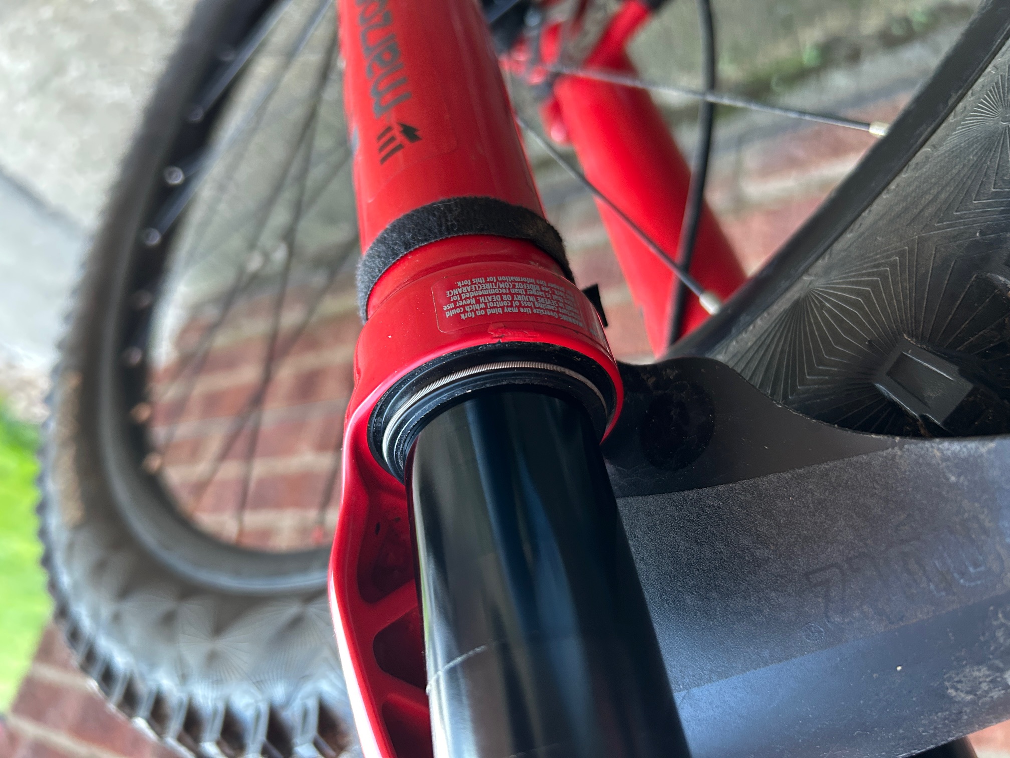

I've managed to find a happy place with this bike - the forks still buzz if you lift the bike quickly after putting the front wheel down but now for normal riding they're fine. Embarrassingly for me, the knocking through the bars wasn't the headset or the forks - my light bracket had play in it, so every bump the light was moving about 2mm. Fixing that made everything feel much nicer.
The dropper is playing up with a little sag but I'm not sure I've not caused that as I've been messing with saddle height.
Otherwise just a nice injury to a fork lower (just above the sticker), looks like it's taken a stone, either that or it's falling apart!

Numnut wrote: Tue Mar 17, 2026 3:14 pm I've managed to find a happy place with this bike - the forks still buzz if you lift the bike quickly after putting the front wheel down but now for normal riding they're fine. Embarrassingly for me, the knocking through the bars wasn't the headset or the forks - my light bracket had play in it, so every bump the light was moving about 2mm. Fixing that made everything feel much nicer.
New rear tyre incoming for the drier weather and it should get a few months not entirely covered in mud.
