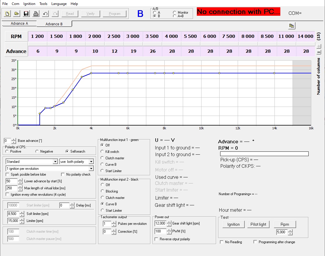

How did you determine your advance curve? Do you use tps? You map to mbt or just copy the old ecu?

porter_jamie wrote: Wed Dec 31, 2025 5:56 pm How did you determine your advance curve? Do you use tps? You map to mbt or just copy the old ecu?
Ultimately running the bike on a dyno will determine the best setting!. At the moment I have the standard map from the Otom NC450 CDI and can switch to the base Nibbi racing map which I intend to experiment with. I am using an Nibbi FCR39 carburettor that has a TPS but the Ignitech dccdip doesn't have an input to use it. I might purchase this Ignitech race CDI which does.

porter_jamie wrote: Wed Dec 31, 2025 7:21 pm Min timing for best torque
Thanks for reminding me, I expect to keep advancing the ignition timing until torque stops increasing then back it off slightly

Dave G wrote: Wed Dec 31, 2025 7:43 pm
assuming you are not det limited

Need better weather before I start modifying map B but that's when the fun will start.

The engine in the Cabby is a Zongshen NC450S which is also fitted to to the Kove 450 Rally. A stepped woodruff key is available for the Kove which advances the timing by 4 degrees and apparently gives good power gain but poor starting.
https://www.kovepower.com/store/p312/Jo ... key.html#/
As a starting point I'll probably advance the timing by 4 degrees from about 2000rpm up to the 12000rpm limiter. Hopefully not modifying the lower rpm will mean no starting issues but I will need to keep an eye on the overall engine temp,
Red is current B Map, Blue is proposed B Map.

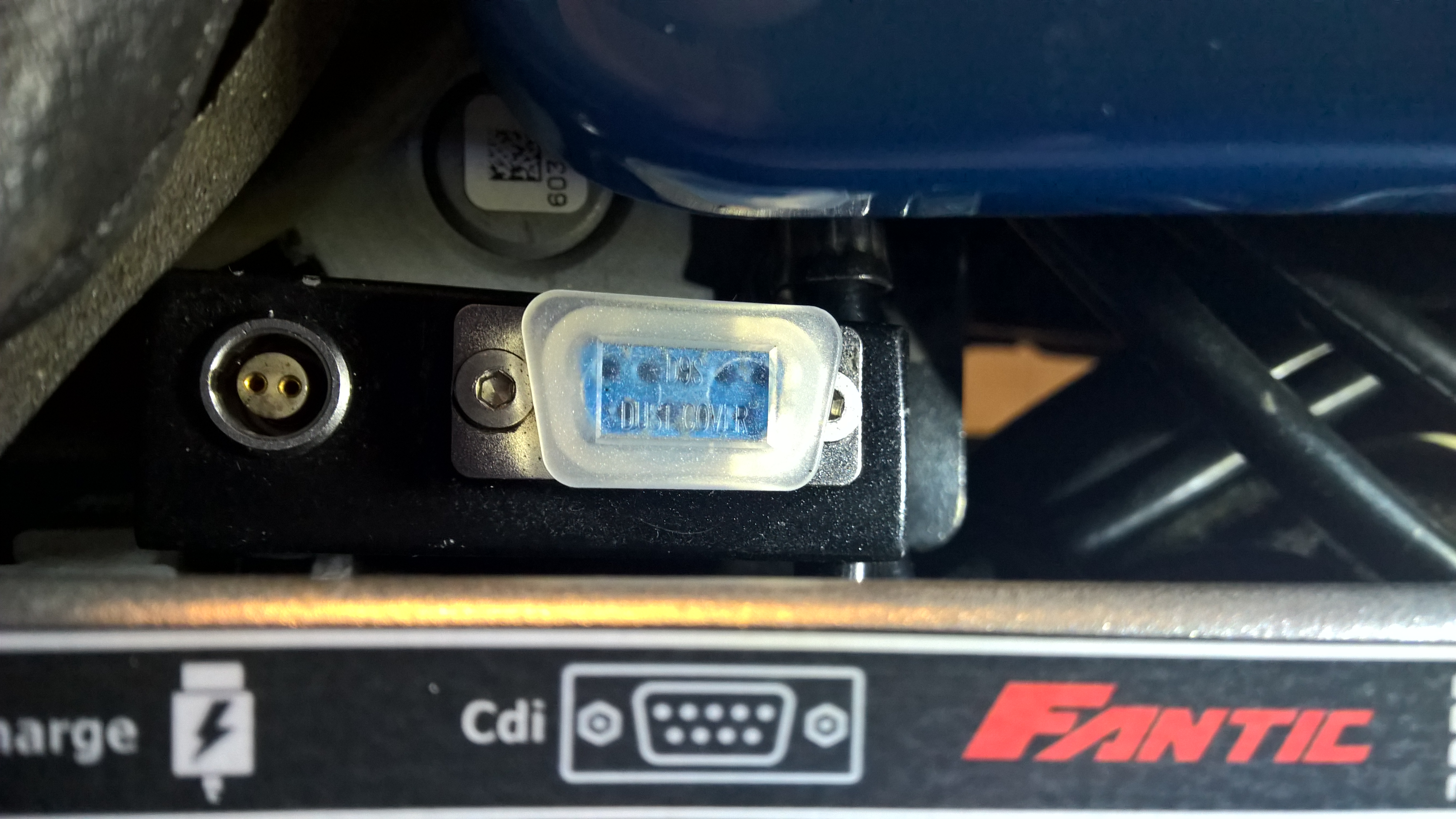

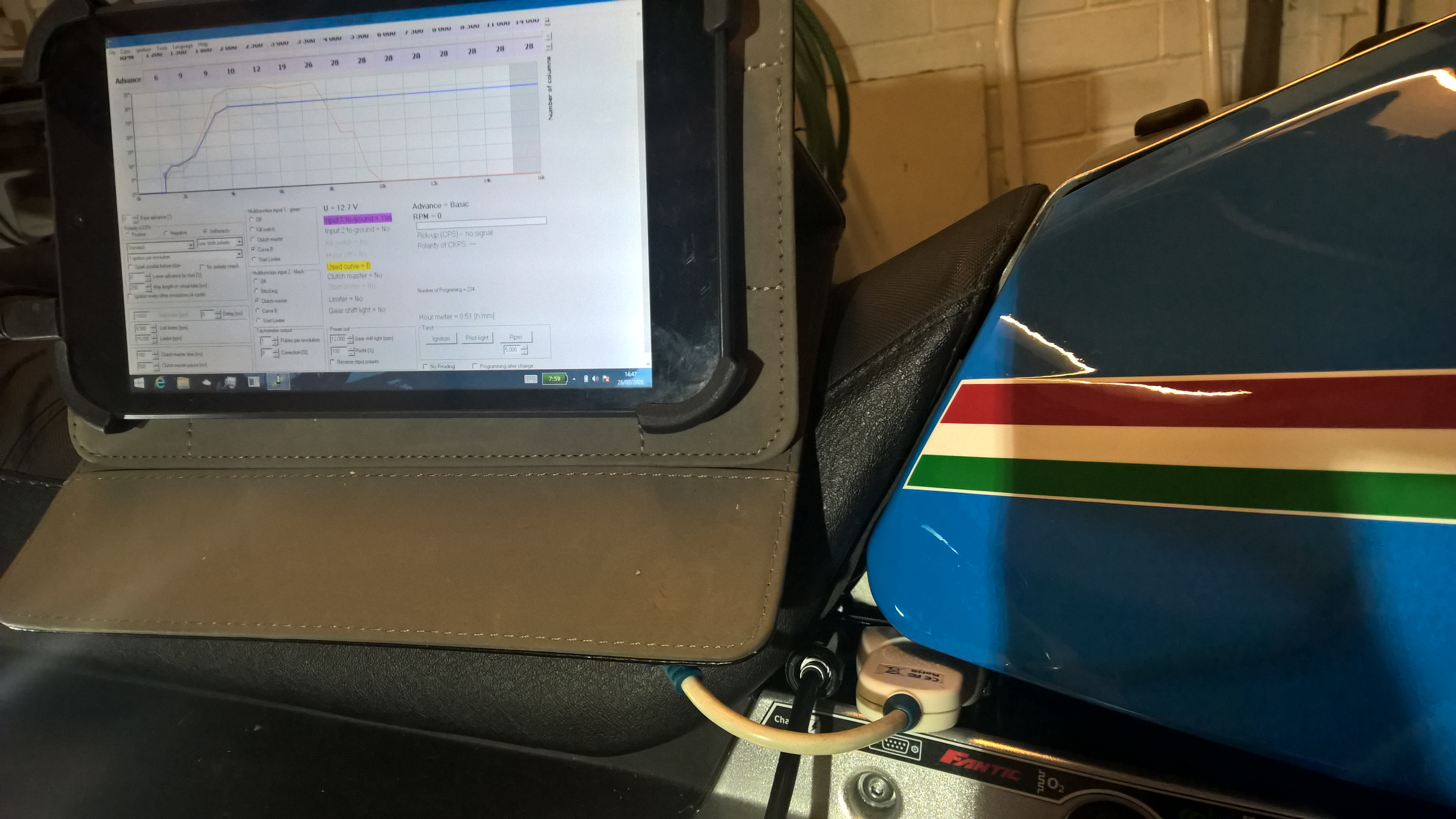

Just added an extension to the CDI port so that I don't have to remove the seat each time that I need to access it. This is what I did.
