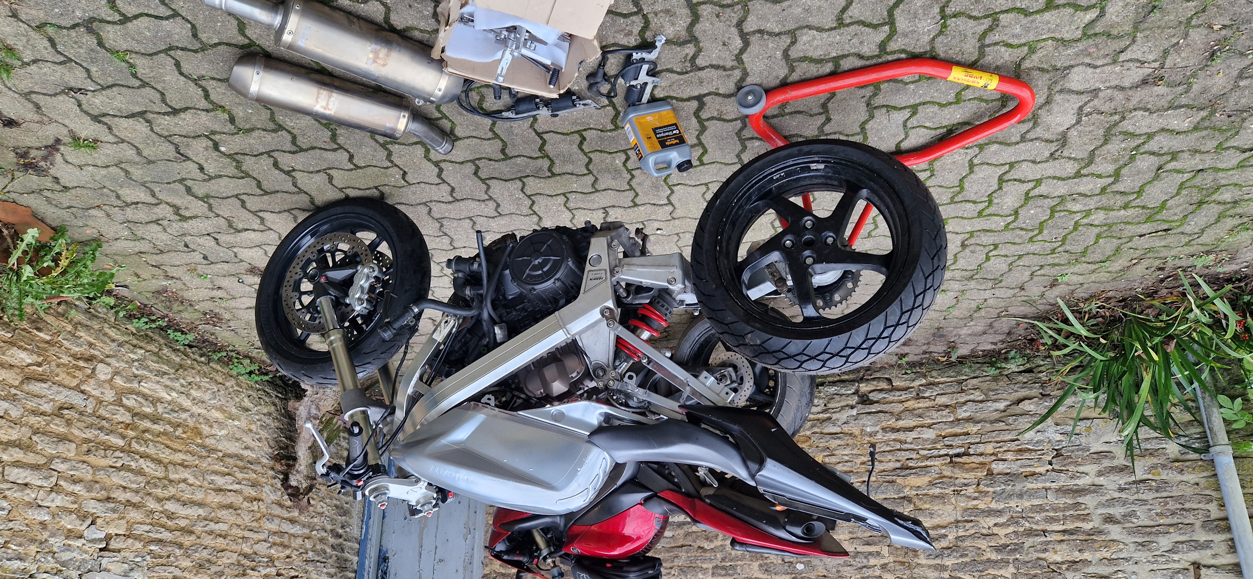

Jaysus....I'd had this as an idea for several hundred decades, then just as i was going to sell a bunch of parts & bin the rest johnnymac tells me the bike is in the spirit of ldc. For those that don't know, it's a ride from land's end to john o'groats on June 21st - one day, budget bikes, no motorways.
It's debilitating, it's the cannonball run. It's fucking stupid. But it raises massive amounts for cancer research. Last year £136k, so it's become the largest single event fundraiser for cancer research.
Anyway, the hawkati is stupid too - a hawk (like a bros) with an Aprilia mille engine and a bunch of non standard parts with me using angry grinders and hammers to make other bits to hold it all together.
Sample pic...

The strange thing is the engines are so similar that it's a natural fit - both 60 degree v twins. The top rear engine mount is almost identical and it took just slicing a bit off the front frame spars to get the front sprocket in the optimum position and then make up some new mounts. I started a while ago and worryingly have done a short vid each time there's been any progress- basically being some kind of media tart to garner a bit of support when the cancer research fundraising pages go live.

Fitting a Rotax V60 lump designed for use with a conventional swingarm into a Honda Hawk chassis fitted with SSSA just ups the ante even further! Top work and I have faith, brother... :D

Hoping (haaaaa!😂) to have it running & road legal by the beginning of may. Just gotta keep going at it in small doses in between biblical deluges because my stable is smaller than a single garage and too full up to do much work unless outside.
I was going to do Absolutely Fuckall today for once but the class of 26 started their wattsapp group so I lurched outside and had a go at matching up header pipes, mid section & exhausts. Moar work is definitely needed but I got a ballpark fit. Clearly needs a bit more angry grinder work to give better ground clearance, Clarence
