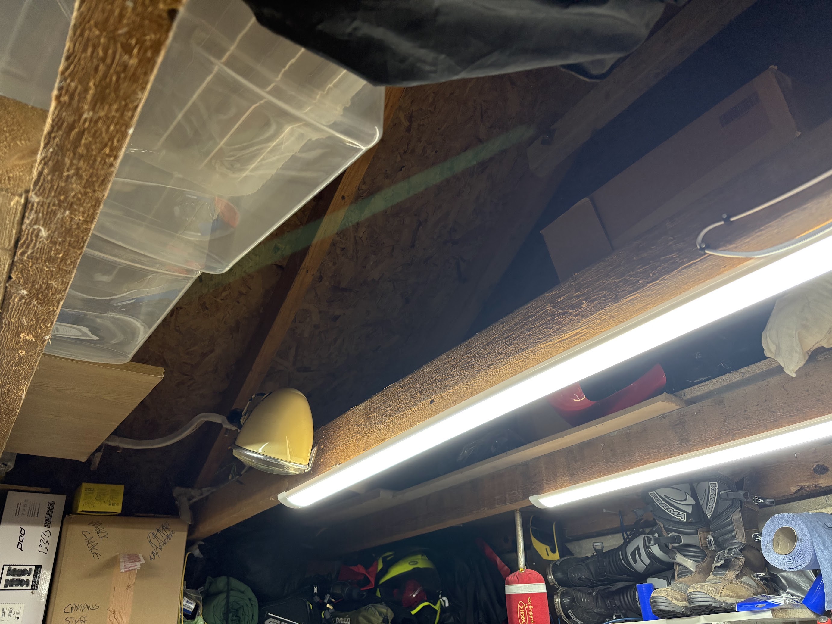

This is obviously not the greatest picture but it gives an idea of what we have...
I want to put some of that cheap loft board up in the roof of my garage for storage. The joists are attached to the rafters, and the resulting triangle sits on top of the walls of the garage. The joists hold my weight but deflect. What do I need to do to make this suitable for storing boxes of stuff, some reasonably heavy... boxes of paperwork for example.

We do have stuff up there atm, and it's still there, but given that I want to stick a load more boxes up there, I'm not convinced the strength is there.

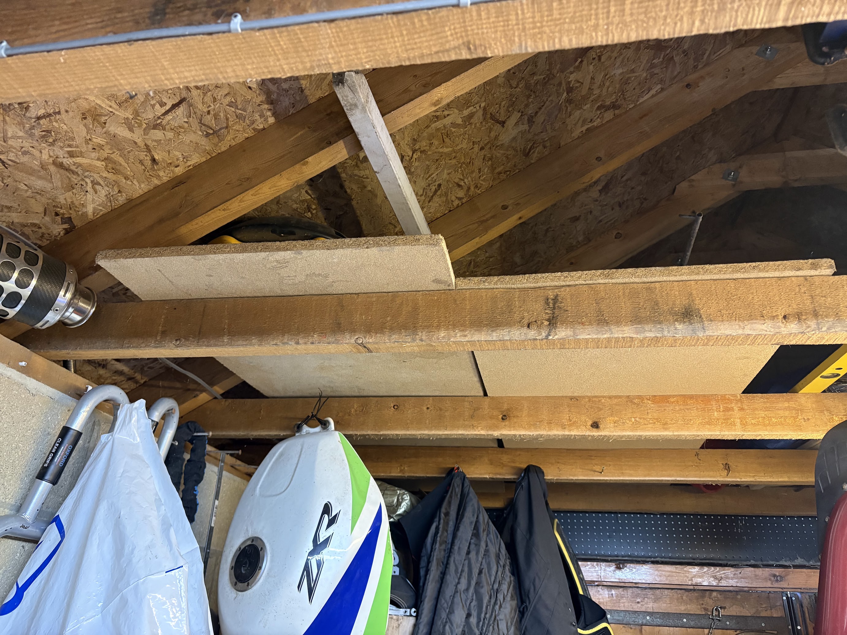

More images that are a bit clearer...

Same as mine. Same thickness, no issues

You can easily swing off the joists. Probably 100 kilos
Doubt you'd be putting much more onto each beam?
I wouldn't have thought so... that would be by far the easiest path, just chucking boards up there I mean.

if 1 joist will support your weight, say 100 kgs, just make sure your boards span 3 or 4, and don't put anything more than 200 kgs in one place.

You could double up on cross beams if you're still a bit unsure. Looks like you've got wall plates that you could easily fix more cross beams to. That would give more piece of mind, but is probably unnecessary unless you're planning on sticking serious numbers of boxes up there.

The best options involve reducing the span of the joists (horizontal sections) as this will reduce them flexing under load, there are plenty options to stiffen them up such as:
Adding strut(s) from the joists to the rafters (pitched roof sections), that way the entire truss it’s carrying the load. It might be worth adding a collar tie (length of 4x2 screwed parallel to the joists) fairly high up from rafters to rafters (helps stop them splaying under loads and add a strut vertically from joist to collar tie
Glue and screw 6” wide strips along length of joists to stiffen them up but you’ll lose some head room
Glue and screw 6 x 2 timbers to one side of each joist, supporting the ends on a ledger plate screwed/bolted to the walls
If it is just about peace of mind, then add extra strength where the heaviest items are going to be stored, such as:
Add gallows brackets / diagonal braces under each end of the joists bolted to the walls
Glue and screw loft boards across the top of the joists, in strips down the length of the garage and distribute the weight evenly
Add gussets ( 18mm ply) cut to brace the intersections between ends of joists and rafters
