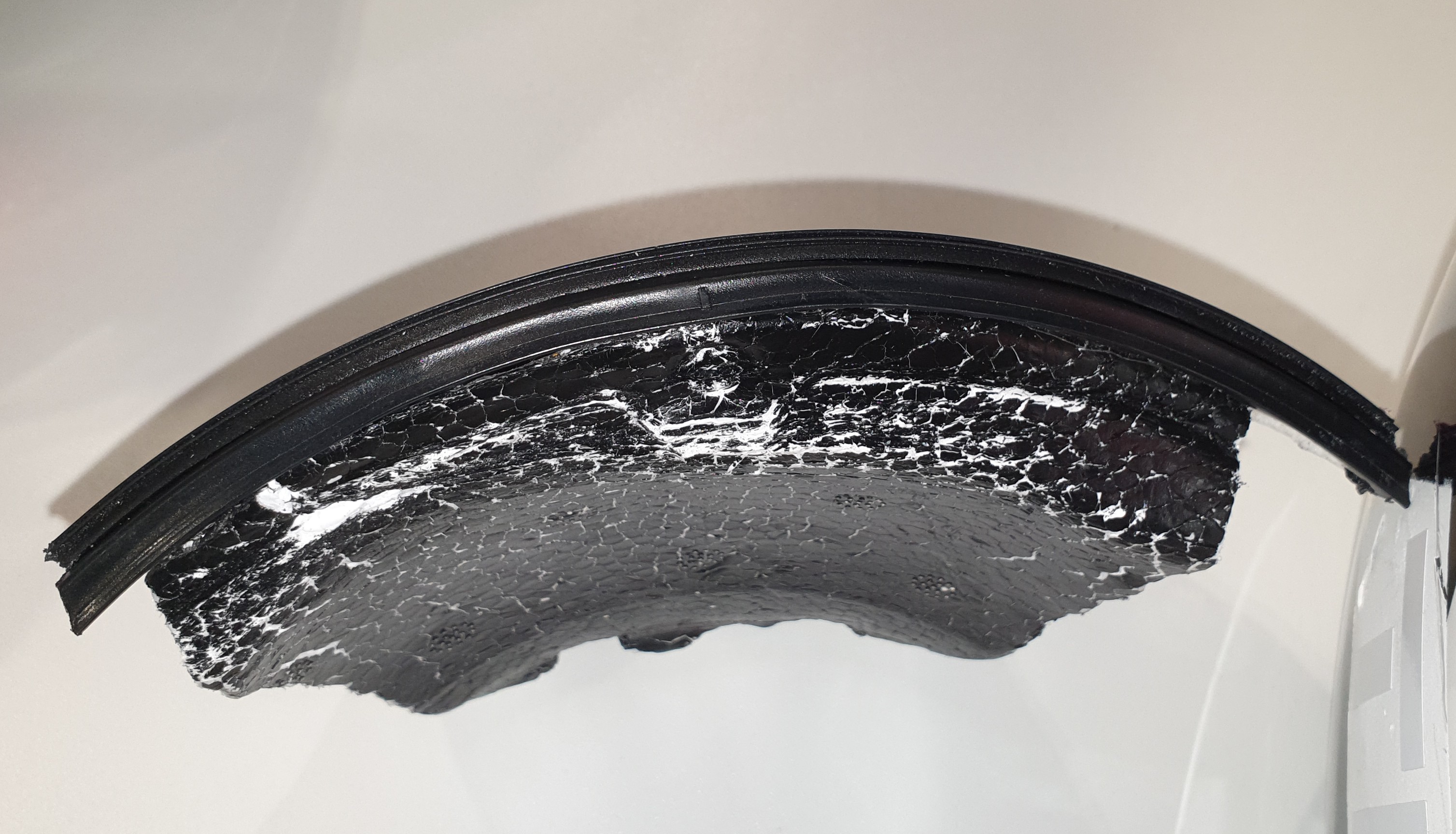

If considering getting a helmet checked (only UK company I know of is the https://m.facebook.com/HelmetUK/ , Google lists them as 'temporarily closed), ask how they check and verify that the impact liner isn't compromised.
An inspection (X-ray, laser scan, whatever) of the shell isn't sufficient.
This pic is of a section of a helmet that had been SHARP tested (was on the stand at the 2023 bike show).
No visible damage to the shell - but look how the impact liner is compressed.

The only reason I was thinking about it was that Arai (or maybe Shoei) had a stand at the TT grandstand a million years ago offering to check lids - absolutely no recollection of what they planned to check, but if I still had the pretty Shoei, I would be looking into it - but as I don't, I probably won't bother now!!

Horse wrote: Sun Aug 17, 2025 12:37 pm No visible damage to the shell - but look how the impact liner is compressed.
This is always a problem with structues like this, it's an even bigger problem on fibre reinforced composites (e.g. glass and carbon fibres, like lots of helmets use).
What tends to happen is the inside surface gets damaged, sometimes it sort of 'explodes off' on the side opposite to where the impact occured. It's a big problem on aircraft and the like 'cause you can't tell if something's been whacked but it might have a load of damage on the inside. Even various NDT methods struggle to detect it.
