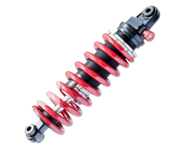

I've made a couple of changes to the Tiger recently - front and rear suspension. The stock suspension was okay, a little bouncy but even with the preload would up I was using 50-60% of the available travel. The rear shock had rebound adjustment but I couldn't feel any difference whereas the rebound adjustment on the front was more like an on/off switch.
First was to fit a Shock Factory M-shock. At £390 I guess this is at the budget end of after-market shocks based on the price and the fact it is combined rebound/compression adjustment. I opted to do without ride height adjustment given the Tiger is tall enough for me - I know that's not what ride height is primarily for but I'm happy to sacrifice a bit of weight over the front in return for actually being able to swing my leg over the seat. Fitting the shock was a doddle, took about 30 minutes and didn't require any special tools.
Shock Factory.jpg (34.75 KiB) Viewed 237 times

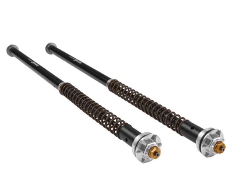

For the front I was toying with the idea of fitting a K-Tech SSK fork piston kit but whilst these are a cheaper upgrade at circa £200 they are not a DIY fitment so you have to pay for the labour charges at an approved fitting centre. I spoke with Brook Suspension for the best part of half an hour and decided to go with an Andreani Misano cartridge kit. At £571 it was only slightly more expensive than the K-Tech with fitting. One cartridge does rebound damping and the other does compression damping.

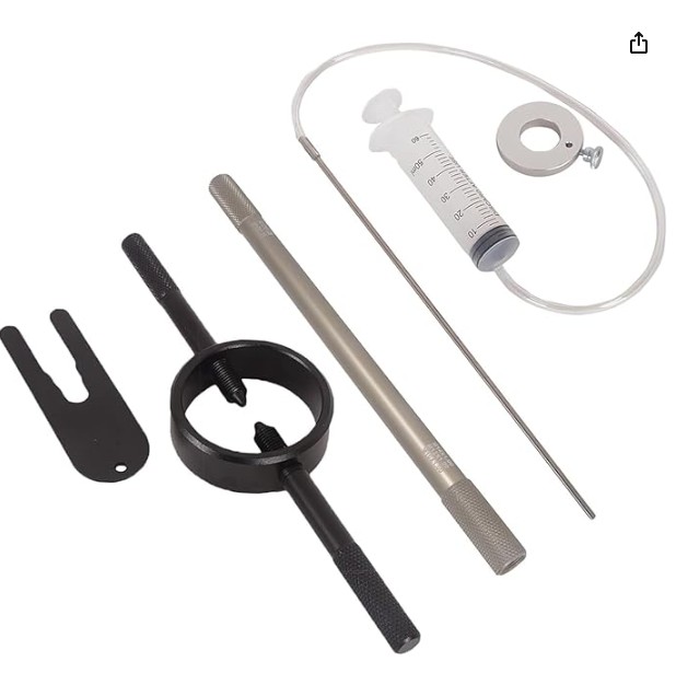

I was advised the job would be easier with some tools:
  • a syringe for setting the air gap - fill the fork leg with oil, set the rod to what the air gap should and suck out the excess, no need to mess around with a ruler.
    a damper rod bleed tool - this screws on to the top of the damper rod so that you can extend/compress it until it's filled with fork oil. You can use a pair of pliers instead but this works better and makes the job quicker and cleaner.
    Spring compressor tool - this collar fits around the fork leg with a 'finger' on each side to hold the fork spacer allowing you to put pressure on the spring and accessing the lock nut securing the fork top in place. In theory it's supposed to allow one-man operation but I wasn't working alone (thanks @maccecht)
Oldbones - Fork Oil tool.jpg (39.49 KiB) Viewed 237 times
The Misano cartridge is pretty much a straight replacement for whatever's in the fork leg and fitting is therefore quite straightforward, the only real problem being the threaded inserts at the bottom of the cartridge are an M10 x 1.25 pitch whereas the bolt from my fork leg is an M8 x 1.25. Brook Suspension sent out the correct insert quickly and FOC. Swapping the insert on the rebound cartridge was easy enough because you could get a screwdriver through the cartridge so as to hold the cartridge in place. The compression cartridge was slightly more difficult because you could use the screwdriver method. Instead some heat was needed to break the blue thread lock on the insert.
The instructions from Andreani aren't the best either but that didn't hinder progress.
Both the shock and front springs are weight-appropriate. The difference with both fitted is quite literally night and day. I'm not riding any quicker and I still don't really know what the suspension is doing but the bike feels more stable, more confidence inspiring particularly in corners with the bike holding its line better, more comfortable over rougher surfaces.
Not cheap upgrades but I plan on keeping the bike and having replaced the suspension on my other bikes I know it's worth it.
