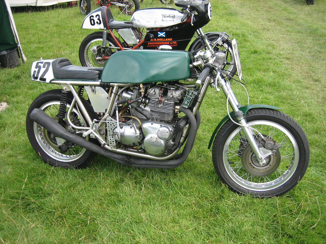

Reminds me of a Trident I saw at Barbon hillclimb a few years ago, think that was listed on the programme as a Metisse.
I'll fire some pix of when I get time.

Ha, took a while as photo hosting has been dicking about but here we go.
