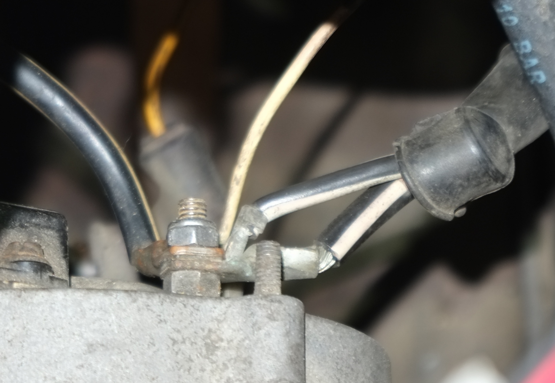

I'm pretty certain that I'm guilty of a self-inflicted problem here. Following your advice given above I first checked the positive battery leads and found that the main supply to the starter solenoid was solid and not in contact with any metallic elements other than the solenoid terminal. Next I checked the black/white lead to the aternator and I think that is where I made my big mistake when bolting everything back together following the last round of works. In the picture below there are three chunky black/white cables all bolted to the same (upper) terminal post on the alternator. I believe that the heavier of the three (on the left of the picture) is in fact an earth strap and should be connected to a lower binding post which has a nut fitted to it, but has no cables attached.
Certainly it appears that I've created a major short by bolting an earth and live cable to the same terminal post. See what you think, but that's what it looks like to me. I really don't know what I was thinking when I did this - my only excuse is that a) all the cables are the same colour and b) I was left completely unsupervised...

Yes I think you've got it and tracing the cables will tell you for sure. Only the Italians would use the same colours for live and earth wires but are you sure that the lower of the black and white cables isn't too close to that stud too?

roadster wrote: Sat Oct 05, 2024 12:04 pm Yes I think you've got it and tracing the cables will tell you for sure. Only the Italians would use the same colours for live and earth wires but are you sure that the lower of the black and white cables isn't too close to that stud too?
The other end of the black with white trace cable to the left is bolted to the block just above the sump, so very obviously an earth lead. How I missed this when reassembling is beyond me - probably in a rush to get it all buttoned up.
The apparent proximity of live cables to an earth stud is a bit of an illusion due to me using a telephoto setting on the zoom lens. In reality there's at least 20mm between them, plus there's a rubber boot to be fitted to the live terminal post.
Agree about Italians and cable colours - both live and neutral battery cables are green, FFS.

Undo and remove the monochrome wires,attach battery, then 1 by 1 touch the wires to the pole to see which one sparks, simples!

I'll try that, but the clincher was really that the other end of the big B/W wire is bolted firmly to the block just above the sump, so can only be an earth. By process of deduction the other two wires are live, seeing as one of them comes direct from the battery. I still don't understand why I didn't use that reasoning when fastening the various cables when reassembling.
